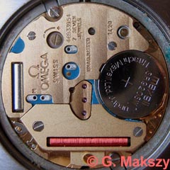

Omega used the 255.xxx series of Eta quartz movements with the Omega symbol and caliber printed on the gold plated brass cover over the circuit board of their calibre 1420. Had the original circuit failed, it might have been replaced with the generic Eta equivalent circuit, and the brass movement cover omitted. Or perhaps The whole movement might have been replaced with the Eta calibre. Only real difference is the marking, and the Omega calibre looked fancier.

Without your having posted a picture, my reply was made having had to assume what movement is in the watch. Here are two pictures, one of the Omega 1420, and the other of the Eta 955.411. These are interchangeable. Try posting a picture of the mechanism so we can eliminate all this guesswork.

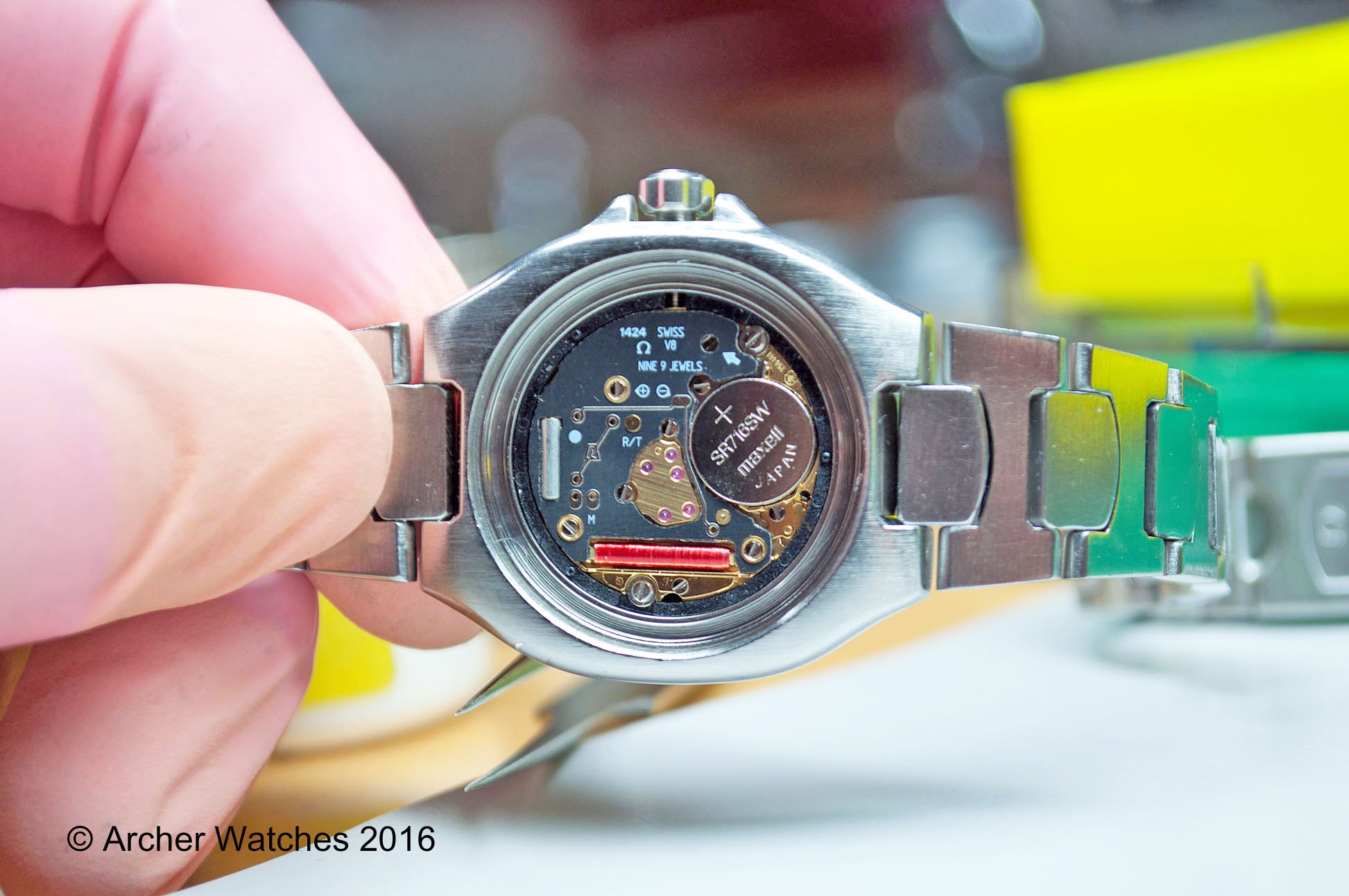

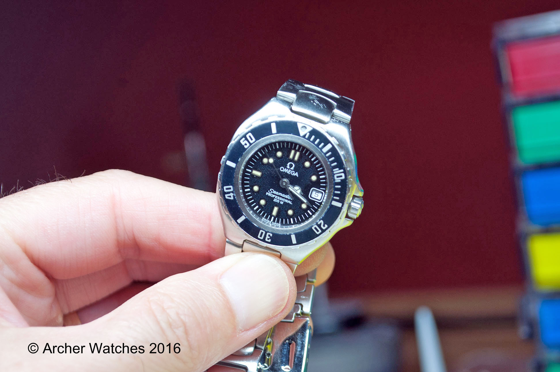

Okay so if it's a pre-Bond at 34 mm, it's probably something like this:
Ref. 28805000, and will have a Cal. 1424. No brass movement cover, but the Omega symbol and caliber will be on the circuit:
Cheers, Al
Cheers, Al

Yep, that's it. The movement though isn't the Omega marked one, must be the ETA. Thanks for your assistance!!
Well, could be a full movement swap if something went wrong, or could be that just the circuit was changed...
Cheers, Al
