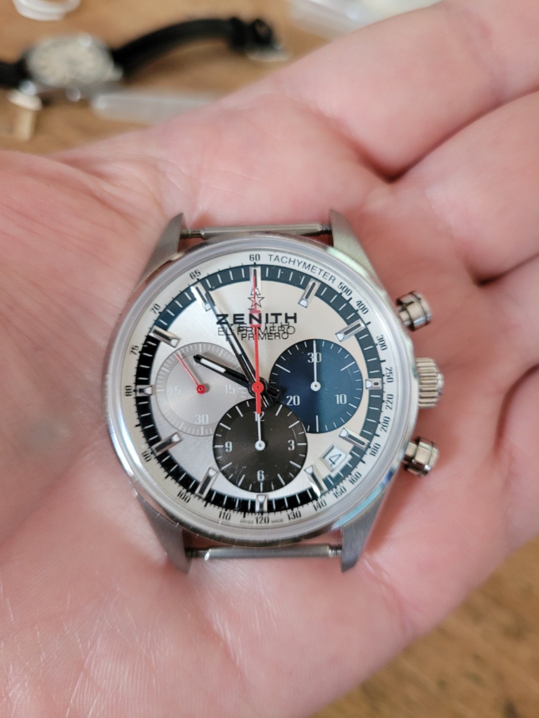

Hello folks,
I'd like to have a little help concerning a 38mm chronomaster. I had a 400 movement aside and found a Zenith case and dial for a very decent price. So I decided to make my own chronomaster with some custom hands.

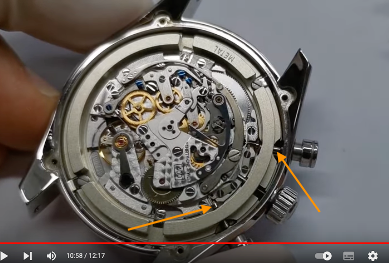

My problem is that I had not thought of the length of the pushers. So the case pushers don't reach the movement ones. I don't understand if there are different screws length on the case itself.
I saw a service video on youtube and it looks like there's a mid part between the movement pushers and the cas ones.
any help appreciated.
thanks

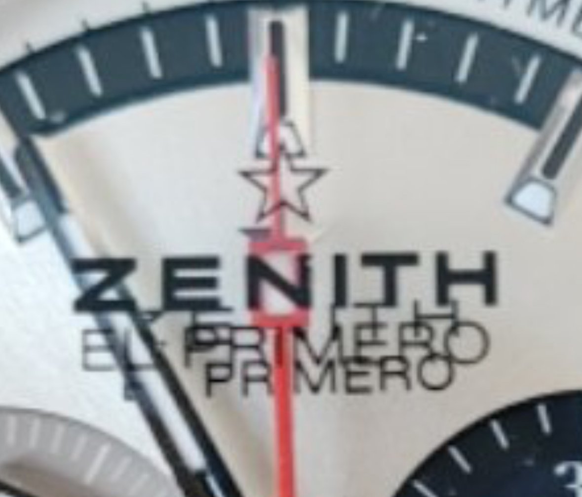

I don’t have anything to add, but I am wondering what is going on with the dial text. It even looks like it is written on the hands.
6,418
31,477
Looks to me 2 sets, on the glass and on the dial.
1,889
2,286
It's just printed on the sapphire. I will remove it.
6,609
26,776
I have no idea why I hadn’t considered it being a sticker 🤦 I need more coffee ☕
6,418
31,477
Wasn't this supposed to be a reply to @Dan S post as he brought up the sticker? Isn't there also a brand that actually print the name and such on the glass because the dial isn't suitable?
1,889
2,286
there are actually some Zenith watches with the font on the crystal mainly skeleton ones and I really like them.
PS : I"ve corrected my so many mistakes in my initial post ;-)
