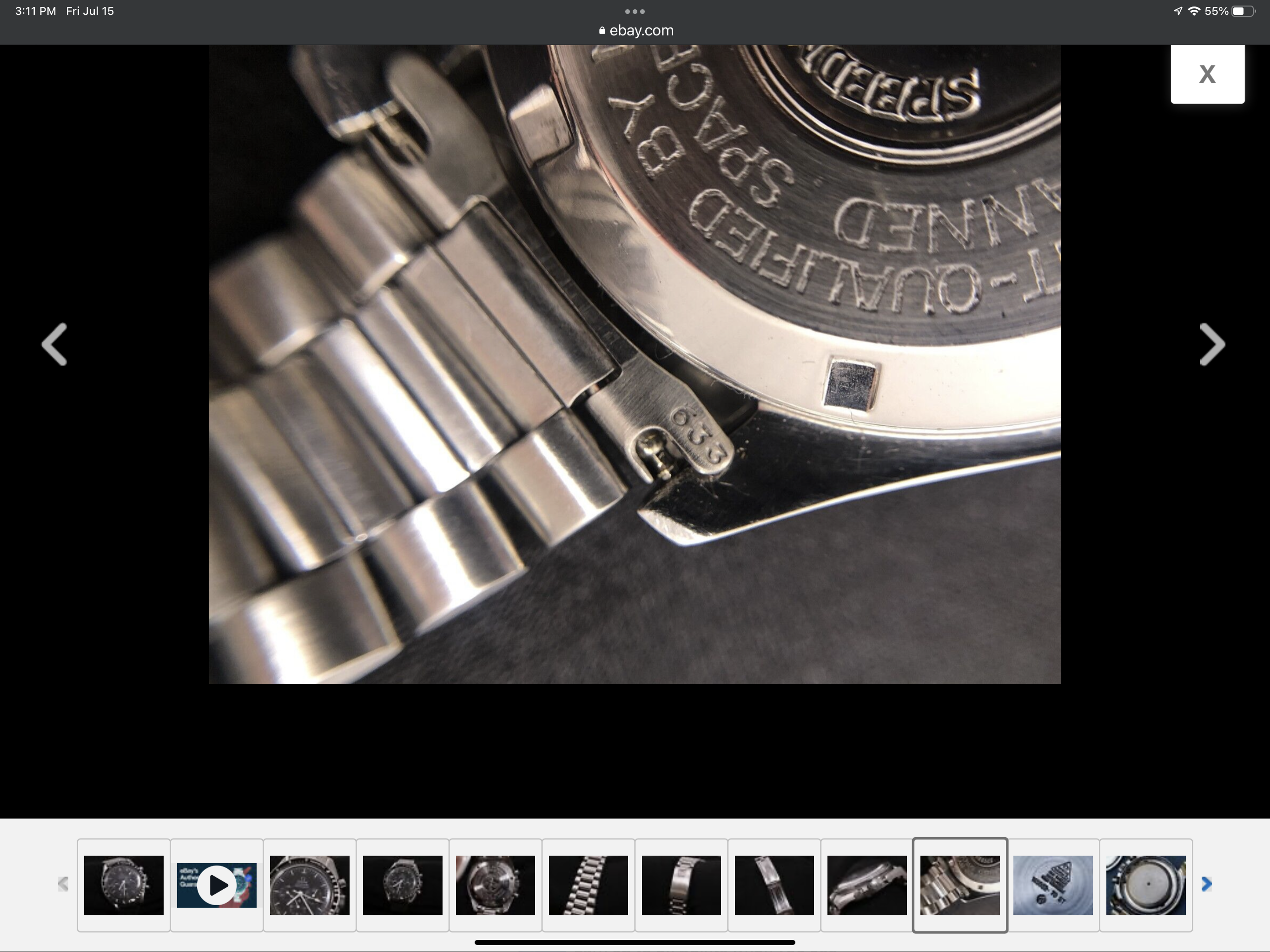

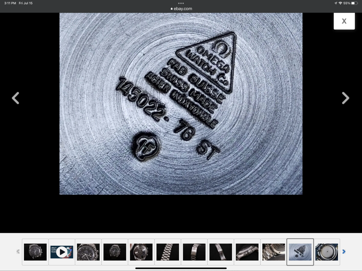

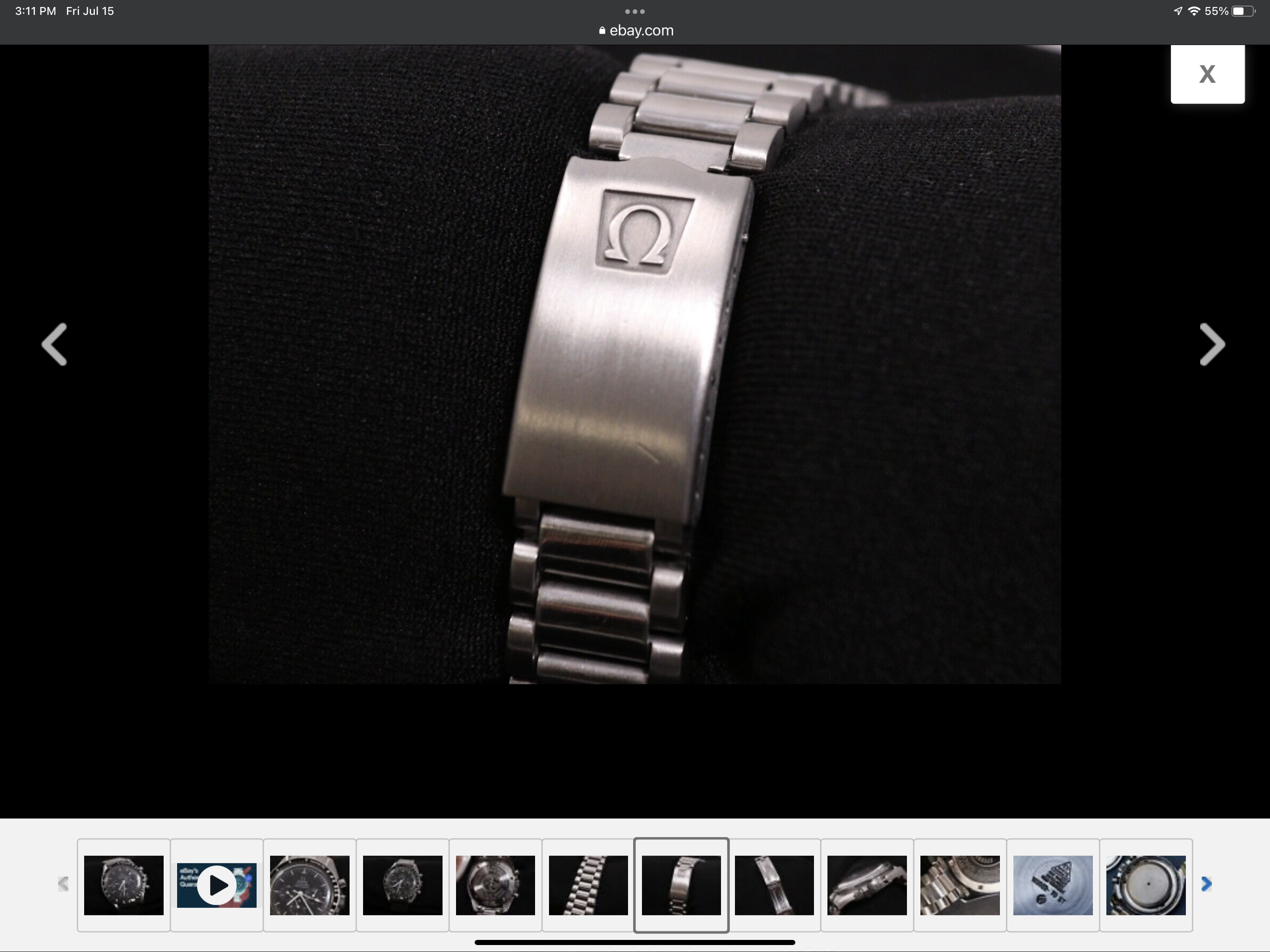

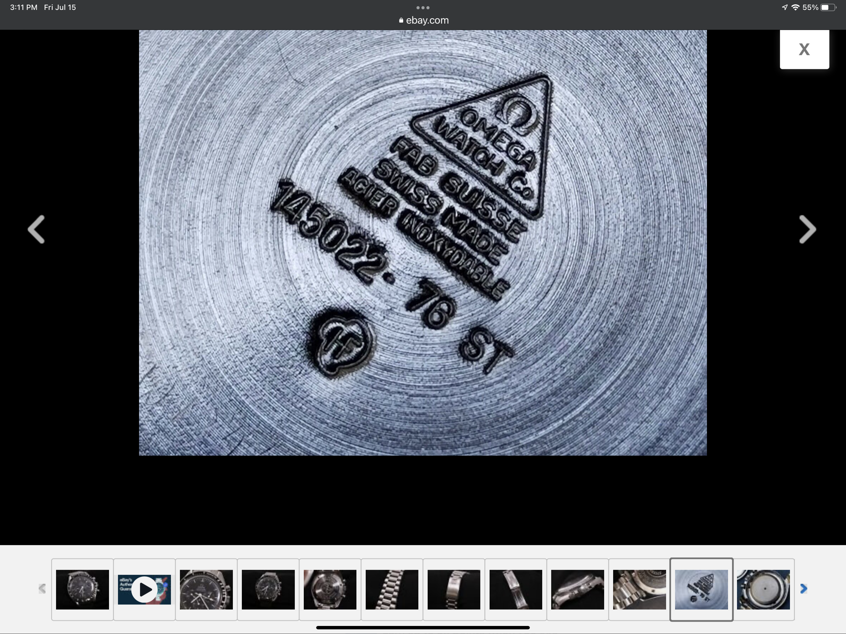

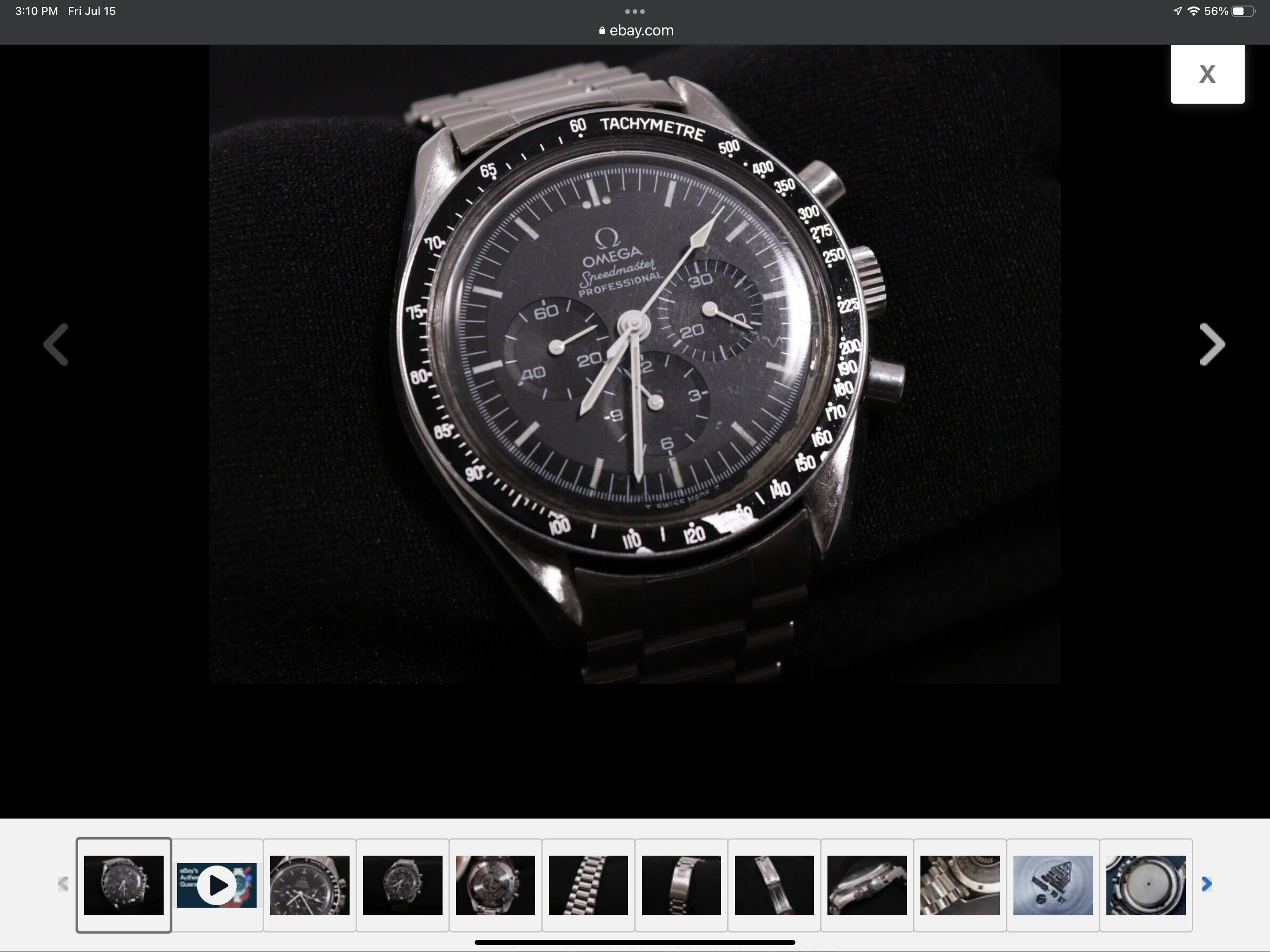

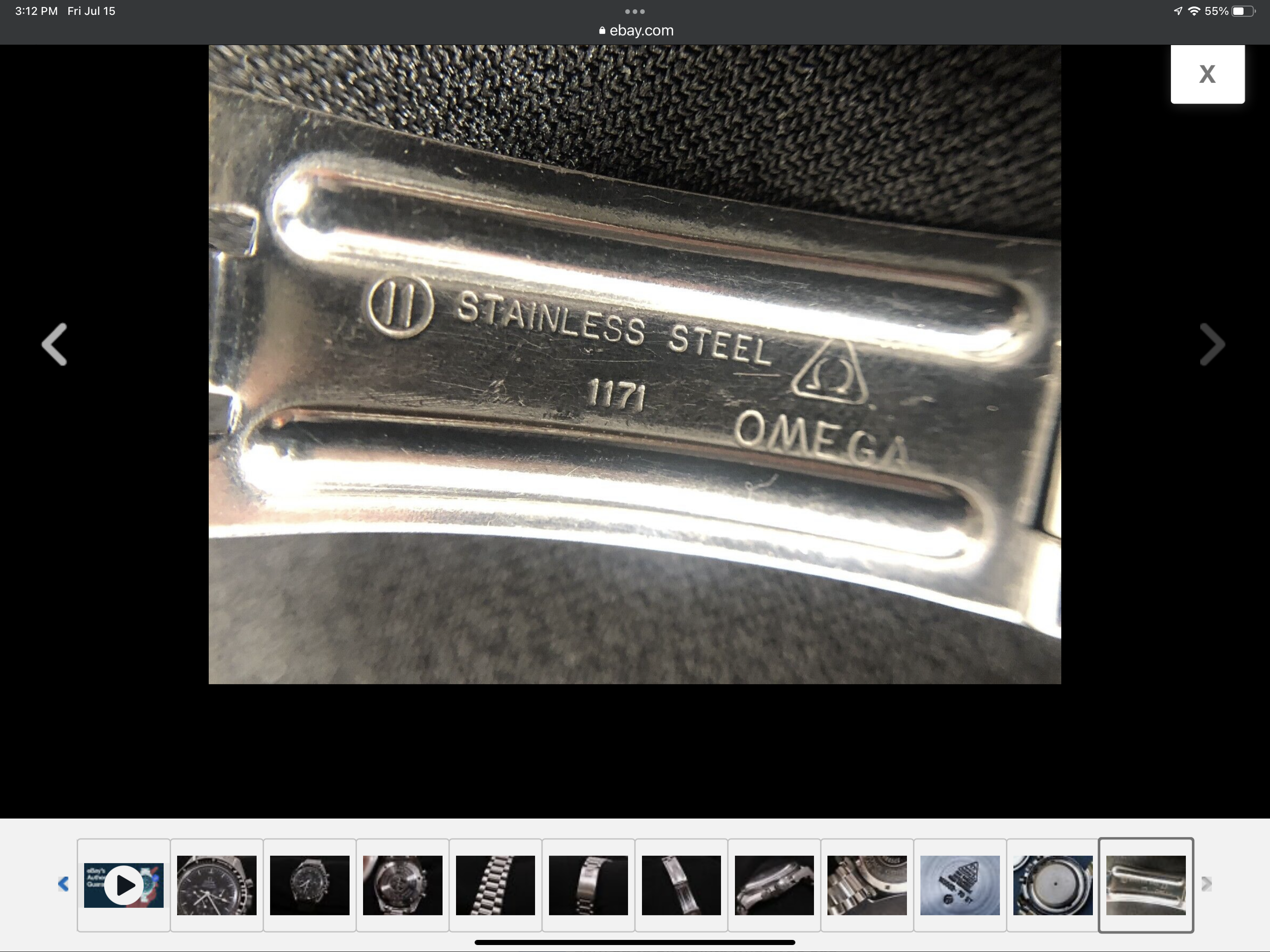

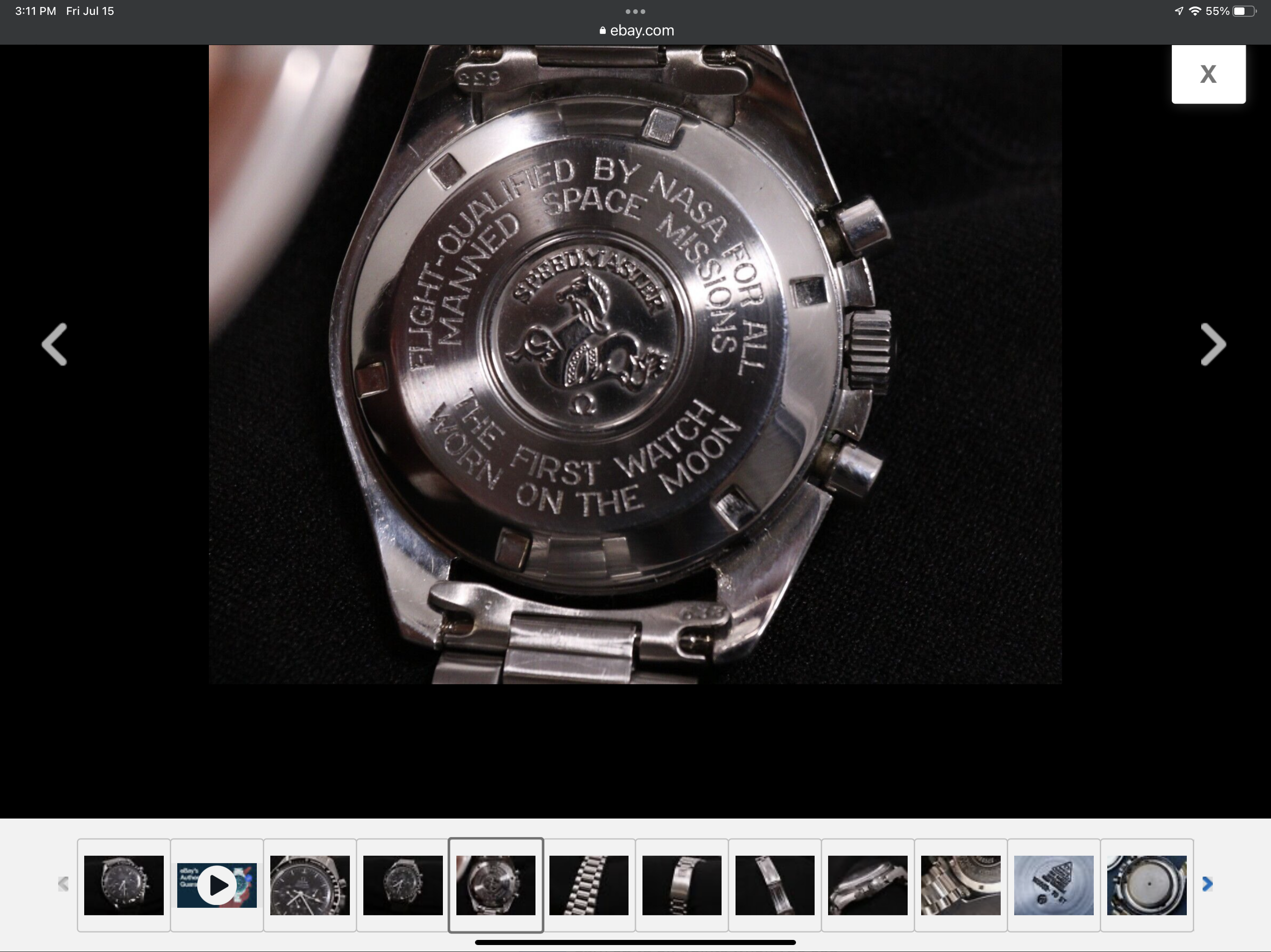

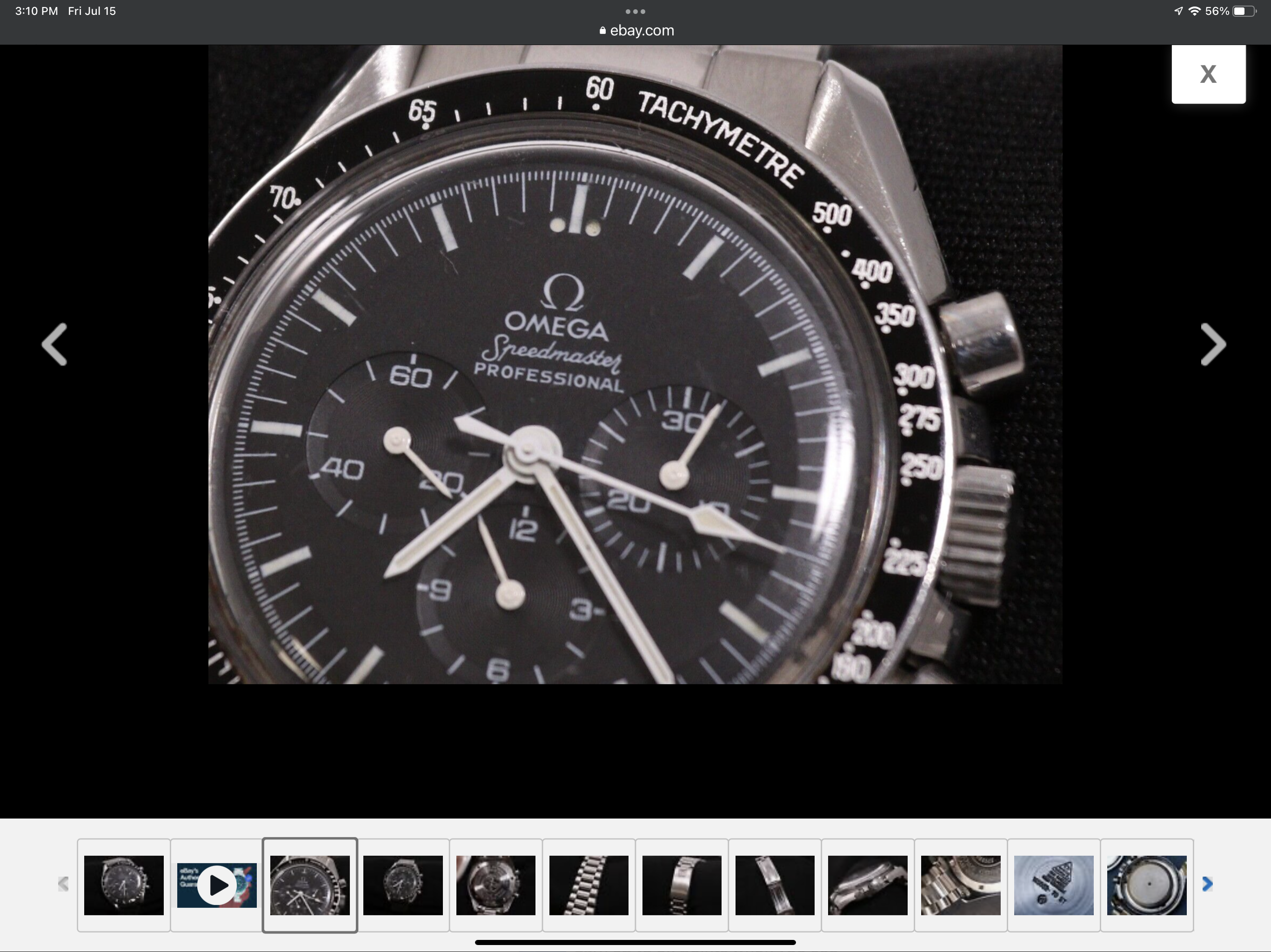

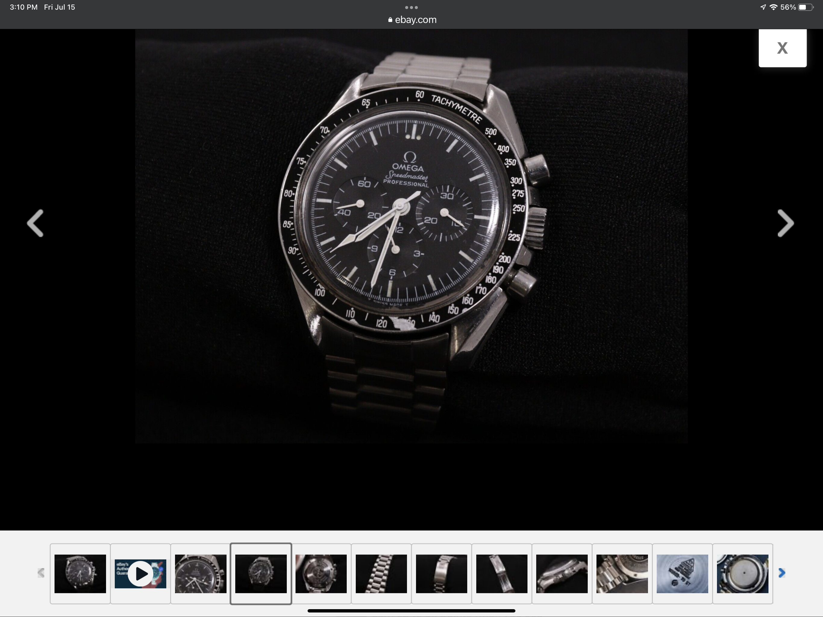

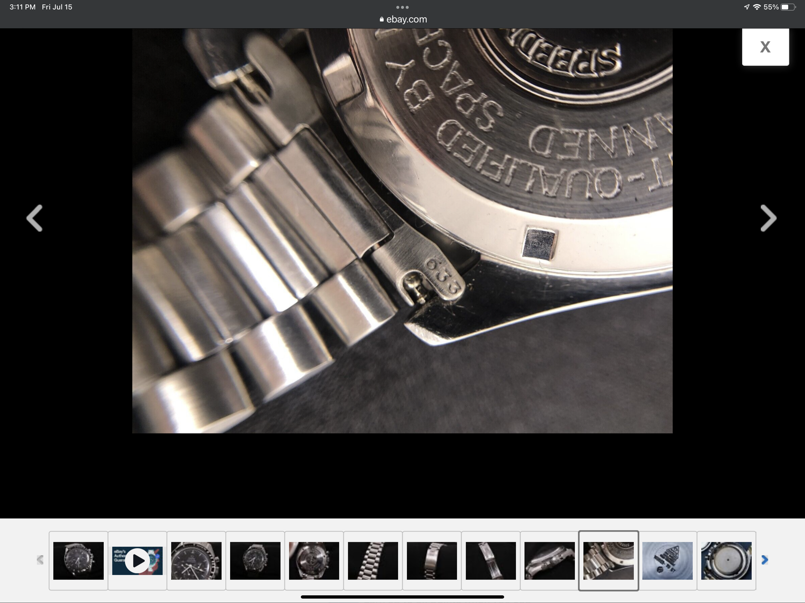

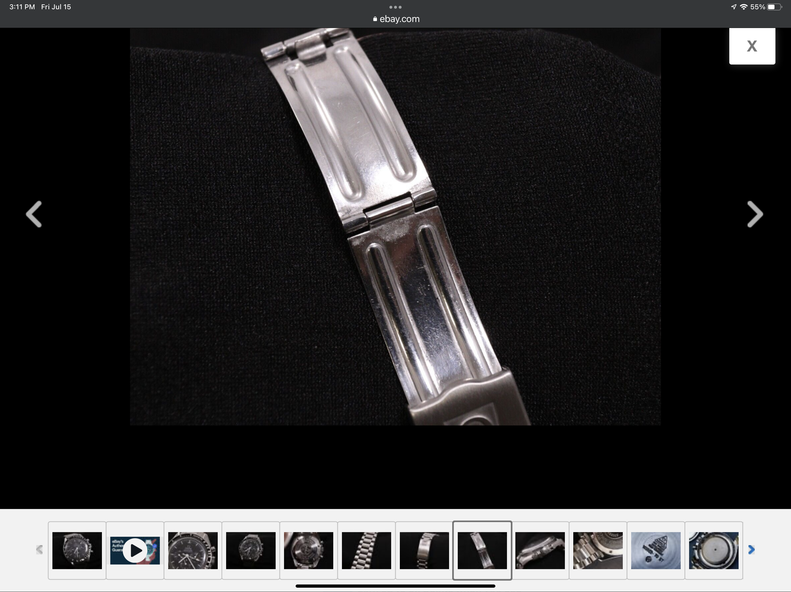

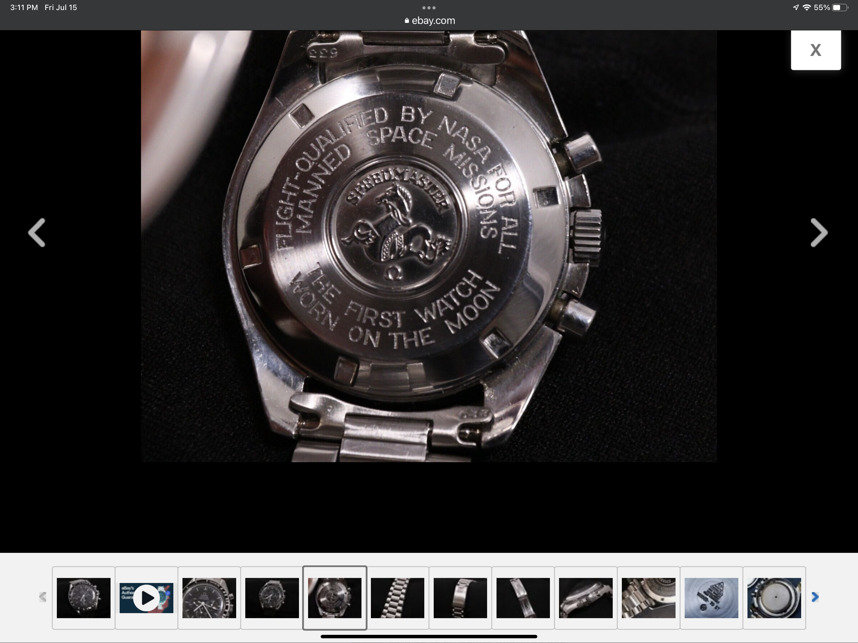

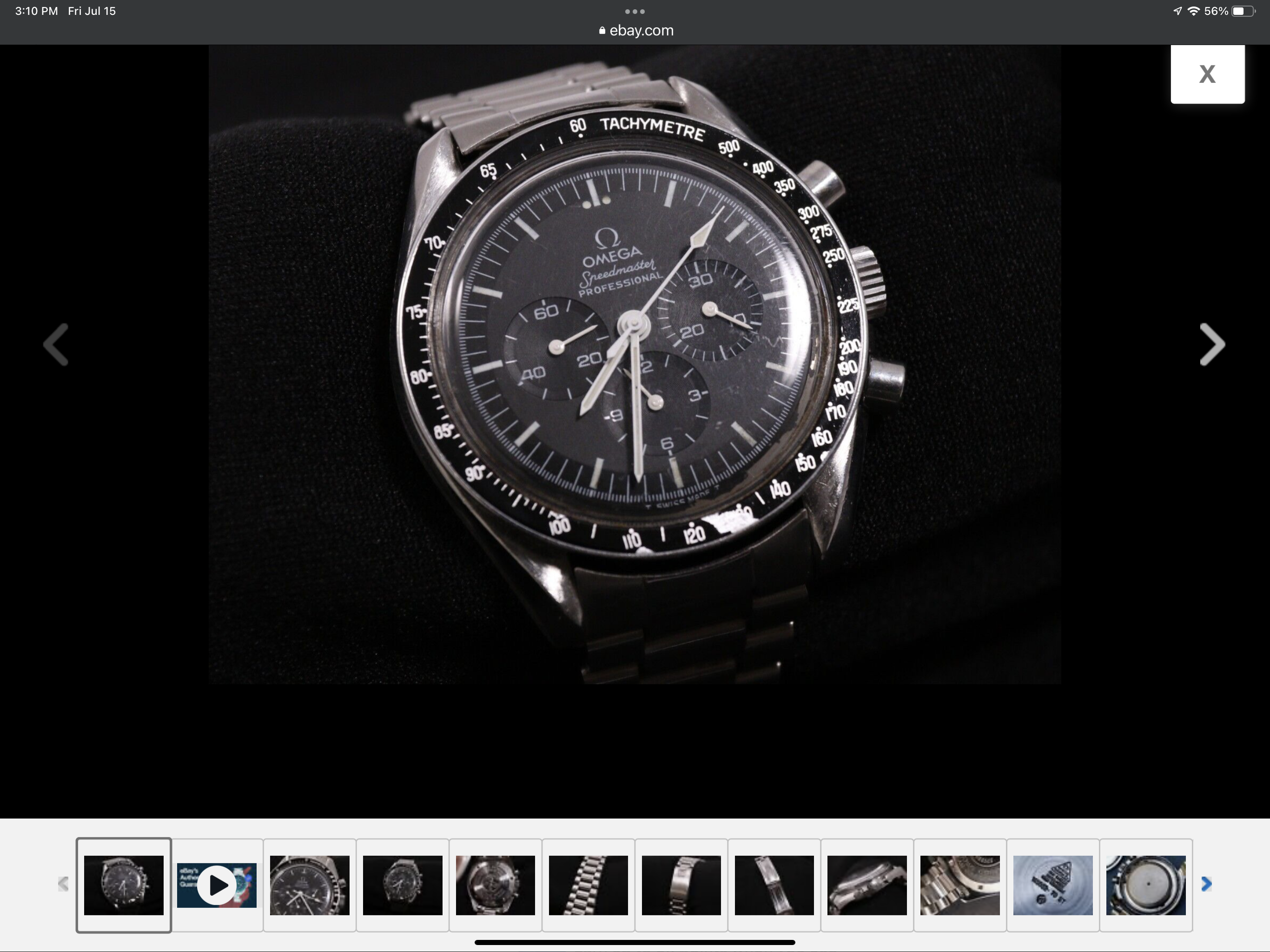

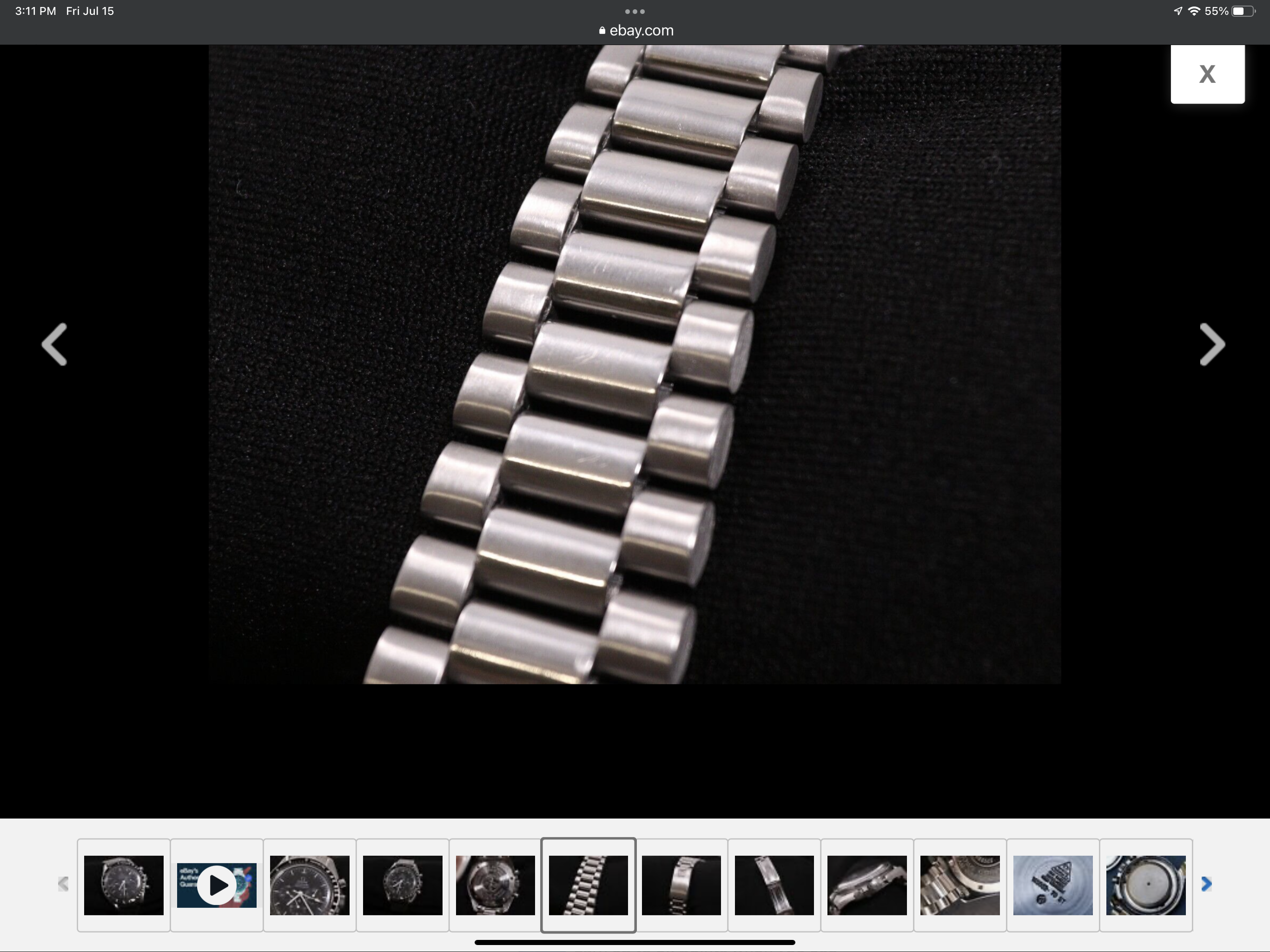

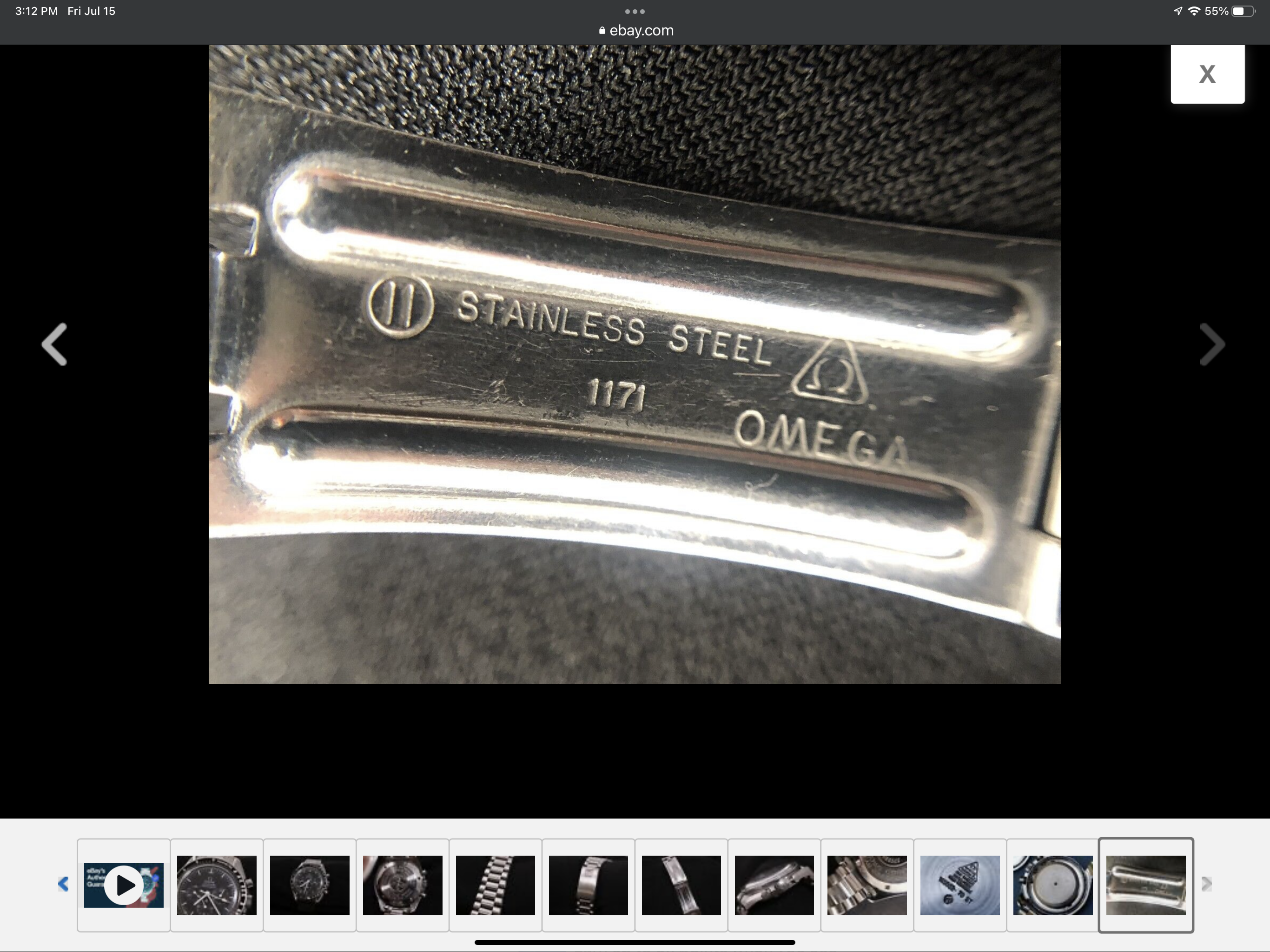

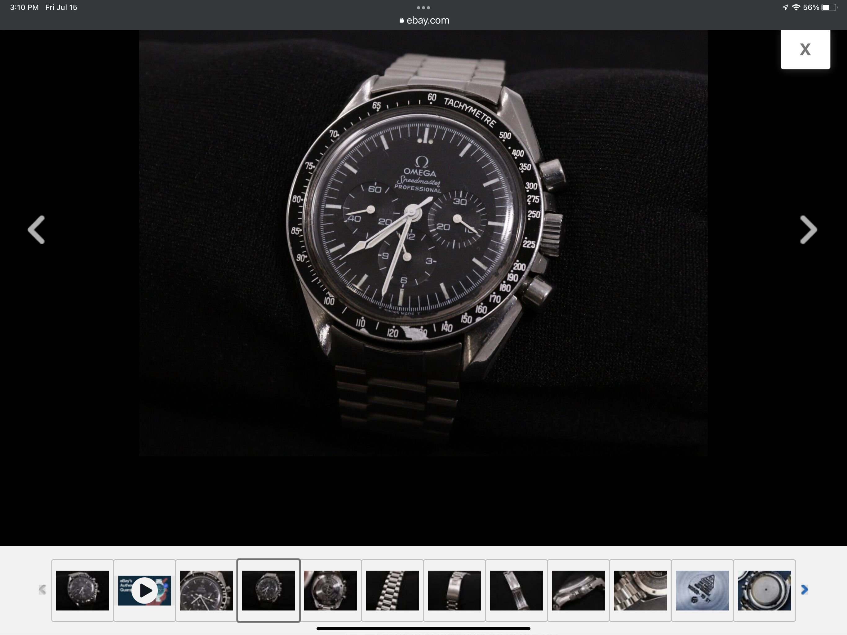

Hello everyone. I fully admit I’m no expert and I know many of you are, which is why I’m posting. I bought a 145.022-76ST recently. As a matter of fact, I haven’t even received it yet, so these pics are from the listing. It appears like a good example of a vintage Omega to me, I feel better that it is sent to an “Authenticator” who examines it before sending it to me. Listing describes it as “found”, I spoke to the seller and it was someone’s watch who passed away, you know that old story. Anyway, looking to the forum for opinions. What is original, what is not, the deal I got, etc. I paid $3500. Clearly has a large chunk of black taken out of the insert/bezel, and black flaking on the dial on the edges nearest the bezel. No pics of the movement, the seller had a watchmaker supposedly take these pics and for whatever reason (hope not a really bad reason) no movement pic. Listed as running and functioning. Looking forward (I hope) to your thoughts. I know that leaving it original is typically the majority opinion; maybe replace the insert with aftermarket and keep the original? I feel like that white chunk is an eyesore that will bother me. No service history, so would get it serviced.

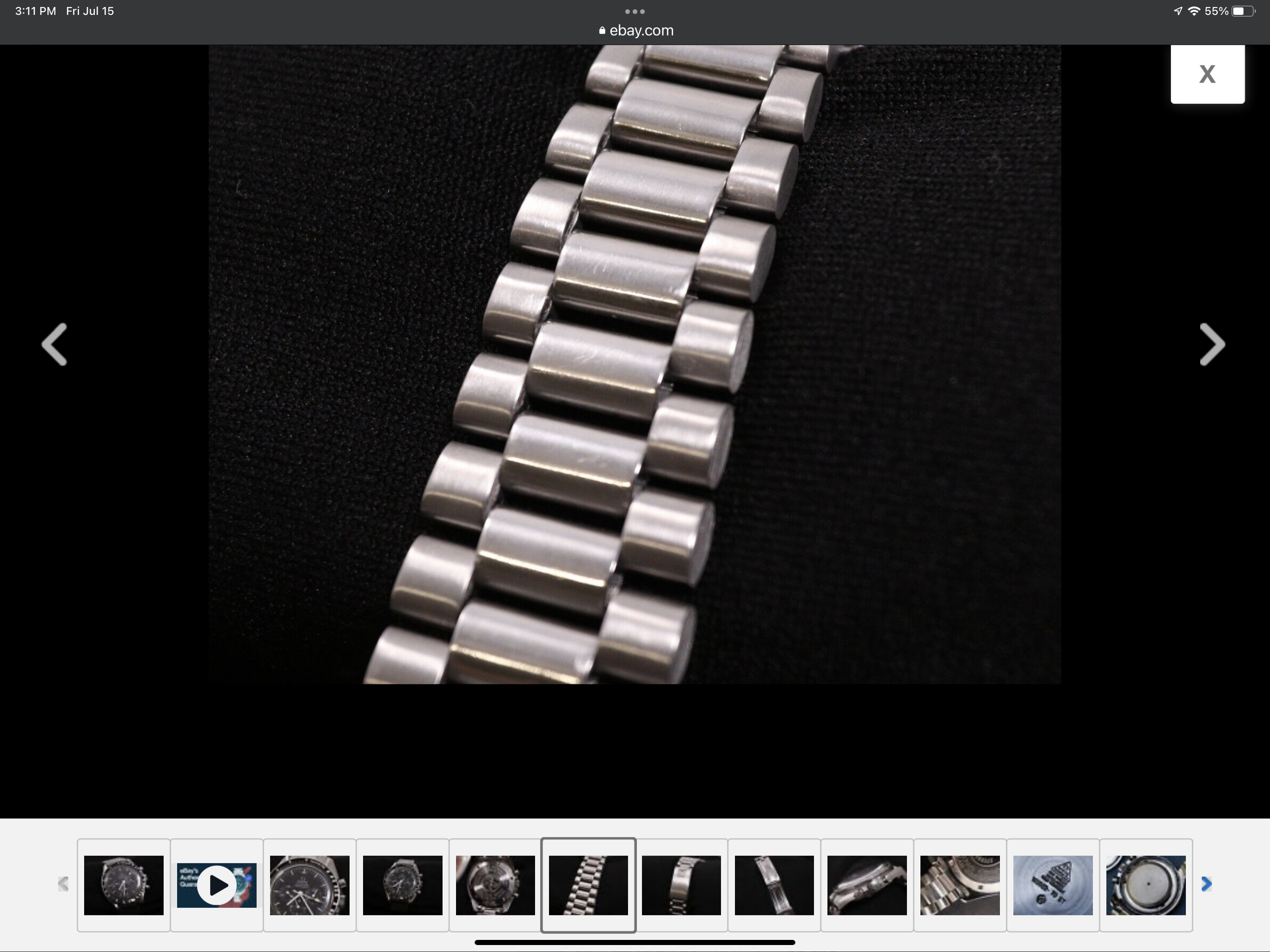

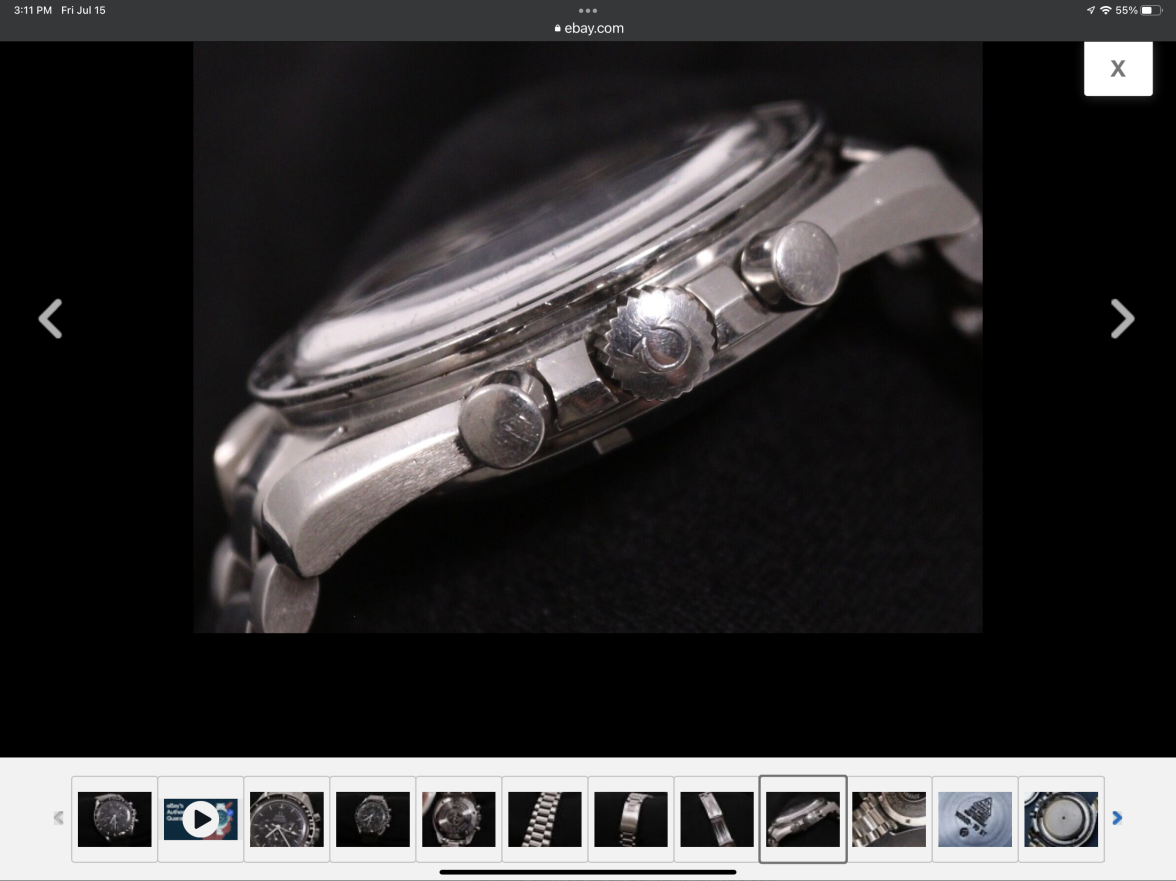

Hi!
This clearly is a well-used Speedmaster, which isn't necessarily a bad thing, by the way...

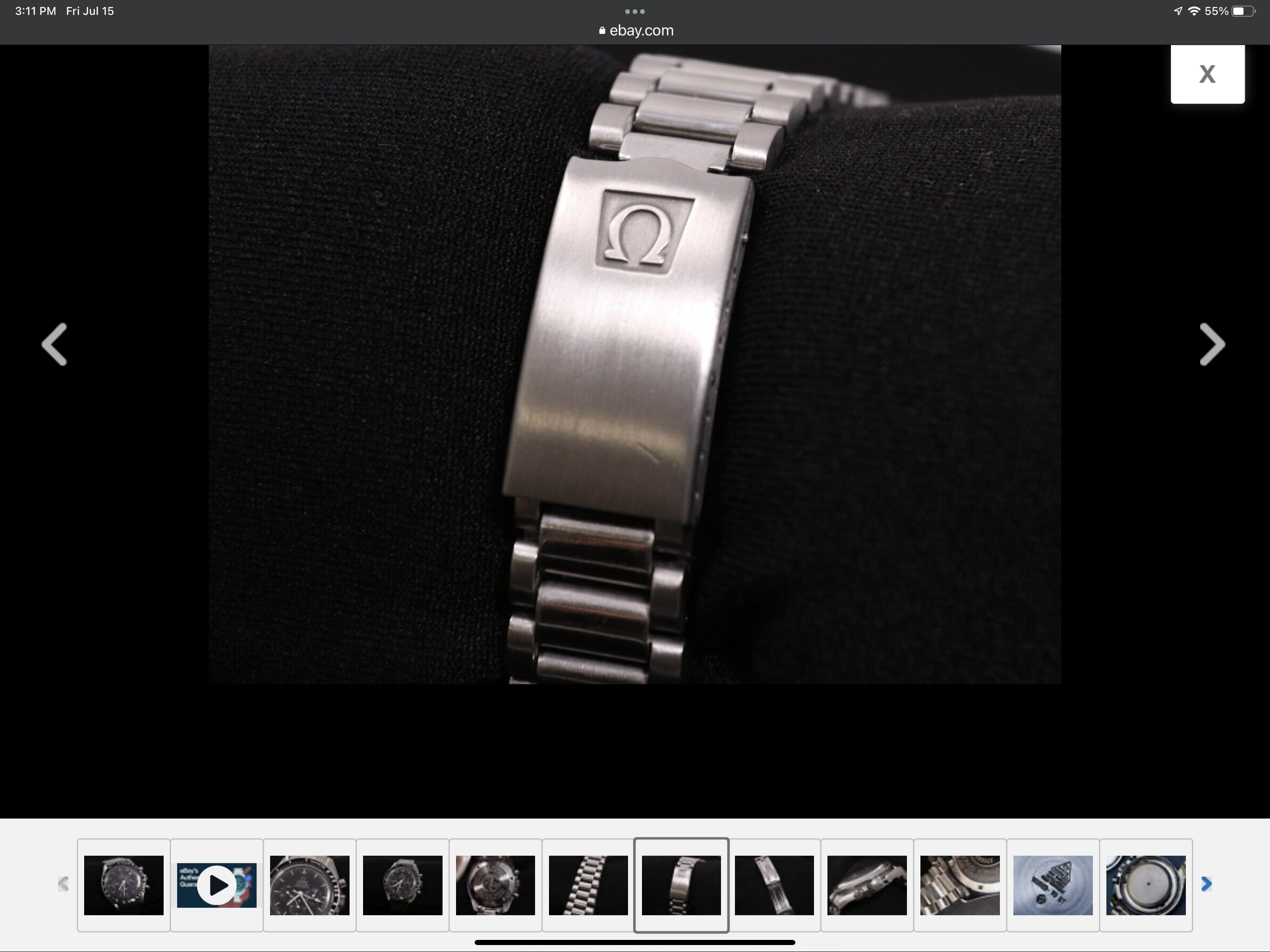

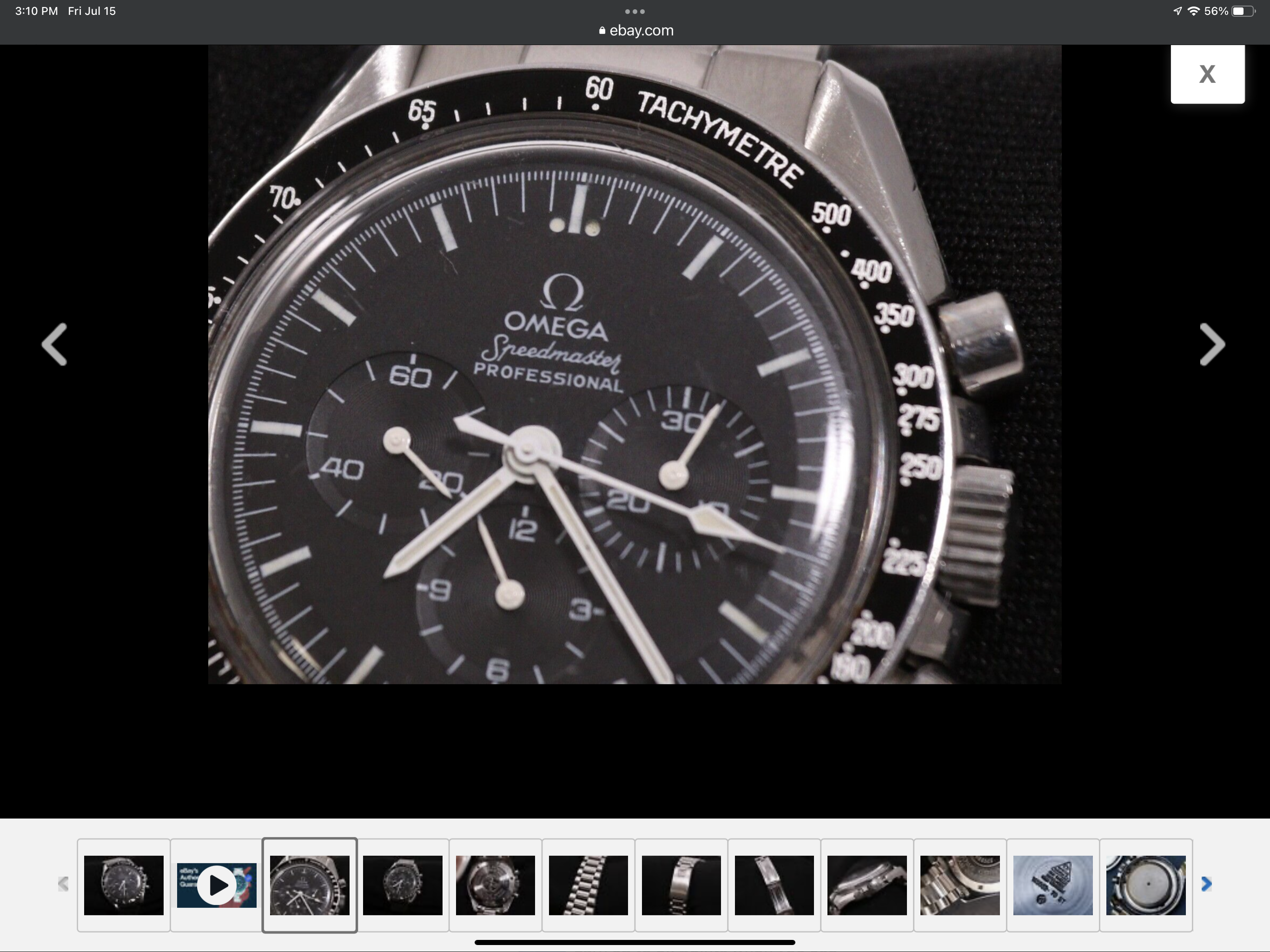

Apart from the issues with the dial and bezel you've already spotted, there's a few more things to consider. For starters, the chrono seconds hand is certainly not original. Not only does it have a bit too short a tip; it is also of the wrong, earlier, type (drop-end rather than square end) and likely a service piece. Next to that, the case is rather soft, which can be the result of nearly a half century of wear, of course.
On the positive side; it does come with a possibly correct and certainly vintage 1171 trapezoid logo bracelet. All in all, I would not say it is an absolute bargain, but it could make for a decent daily wearer at a rather modest total cost. Most important is that you're happy with it yourself!

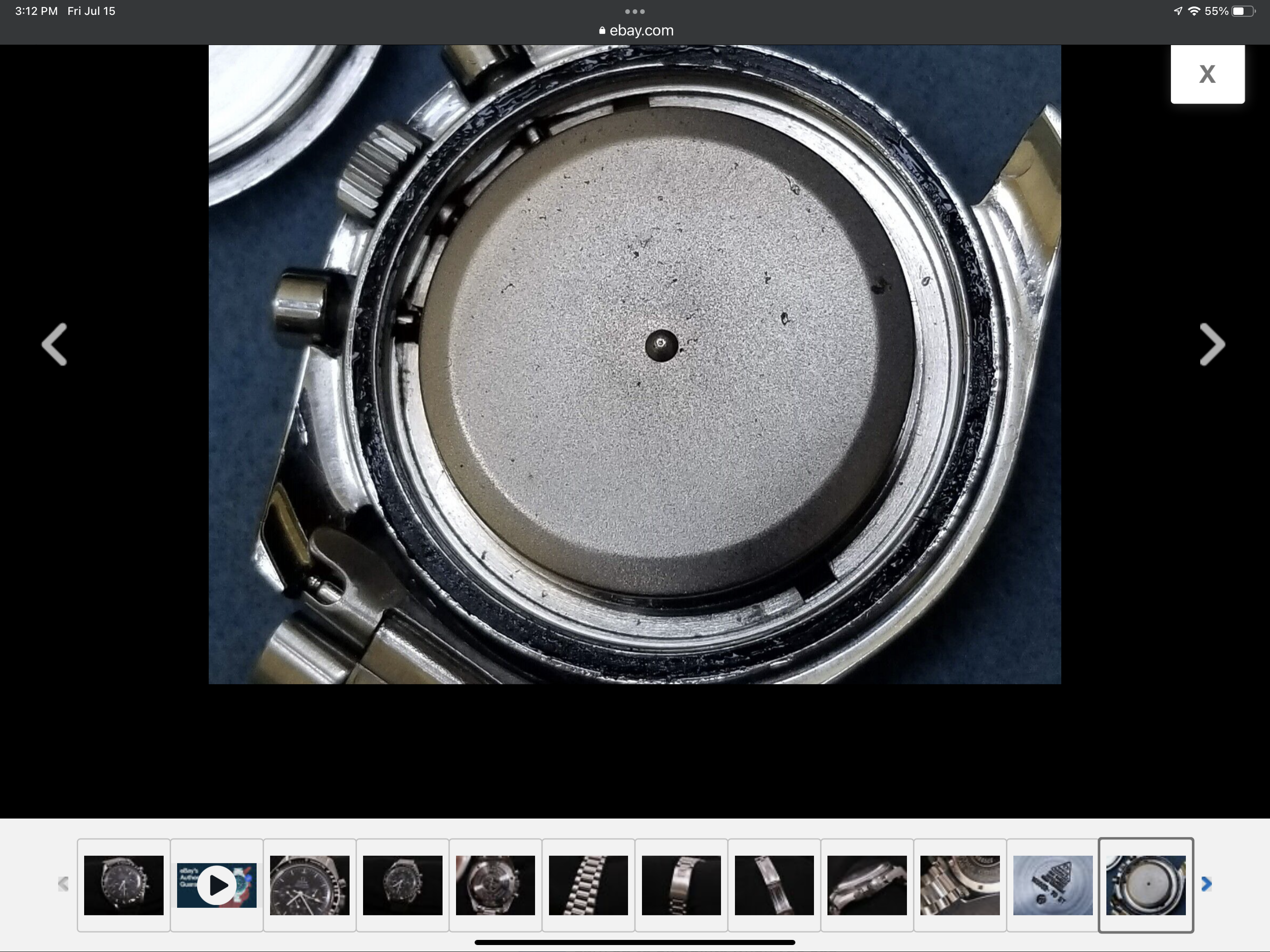

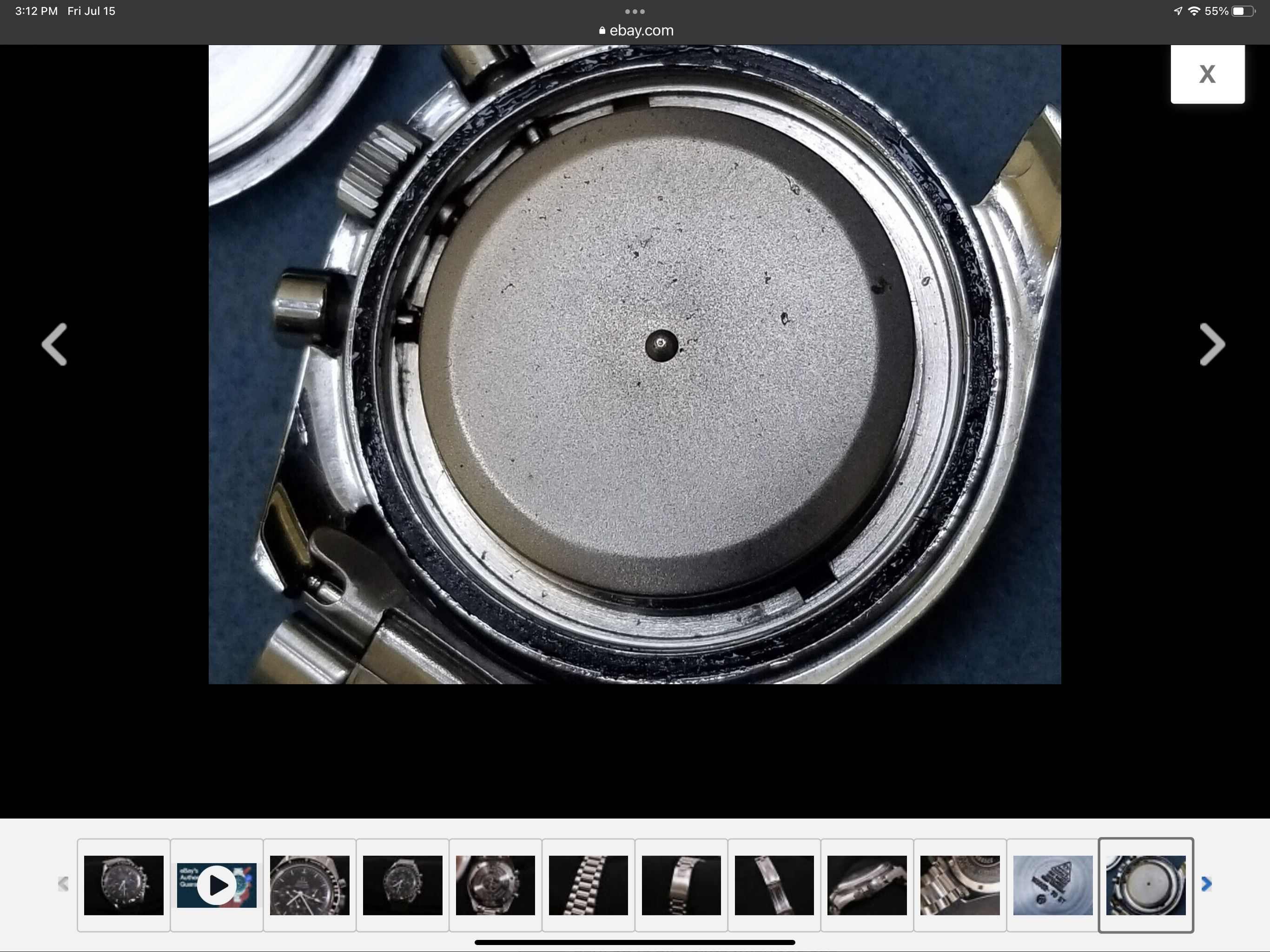

Below average condition, but I guess the price isn't crazy including the bracelet. Hopefully there won't be any surprises inside. It's strange that no movement photos were included given that the watch was obviously opened.

If this were yours, would you look for a period correct bezel insert? I'm trying to educate myself, have been studying 😀, I believe this is the correct bezel (dot next to 90, serif 70, no accent over the E, tall letters) -- and the dial-- just let it flake?

I'd also wonder about there being no pictures showing the chronograph at zero in addition to no movement pictures since, as mentioned, it was clearly opened. You should have factored a proper service and repair cost into whatever price you felt comfortable at. The authenticator's scope is so very narrow and does nothing for me. I purchased two used Speedmasters listed on eBay many, many years ago in much, much better condition so it is (was) possible to successfully purchase a vintage Speedmaster on eBay. I asked many questions and spent months preparing for the purchase, however.
Well, I think I would be after a better, matching, bezel for this one. The type of the one currently fitted is period correct, so you know what to look for. 😉 Be prepared to pay around 500 USD/EUR for one in good condition. It wouldn’t be my primary concern, though.
As to the dial; you’re lucky. As the minutes track still seems untouched, I would definitely consider the dial salvageable and know of others who’ve had similar issues corrected. You’ll need an expert to do it though! James Hyman worked a miracle in a similar case I’ve had in hand.
Summing up things based on my own response and others, I would go through the following steps:
1. Have the movement checked
2. Based on that and whether you like the watch in hand; decide whether to keep or return
3. Consider your options concerning the dial and hands and only thereafter:
4. Hand it in for service including the parts in the shape you’d like them to be in. (The bezel is the only part you could simply decide to swap later on, post service, hence my last step is sourcing one…)
Hope this helps and that you’ll enjoy this watch.

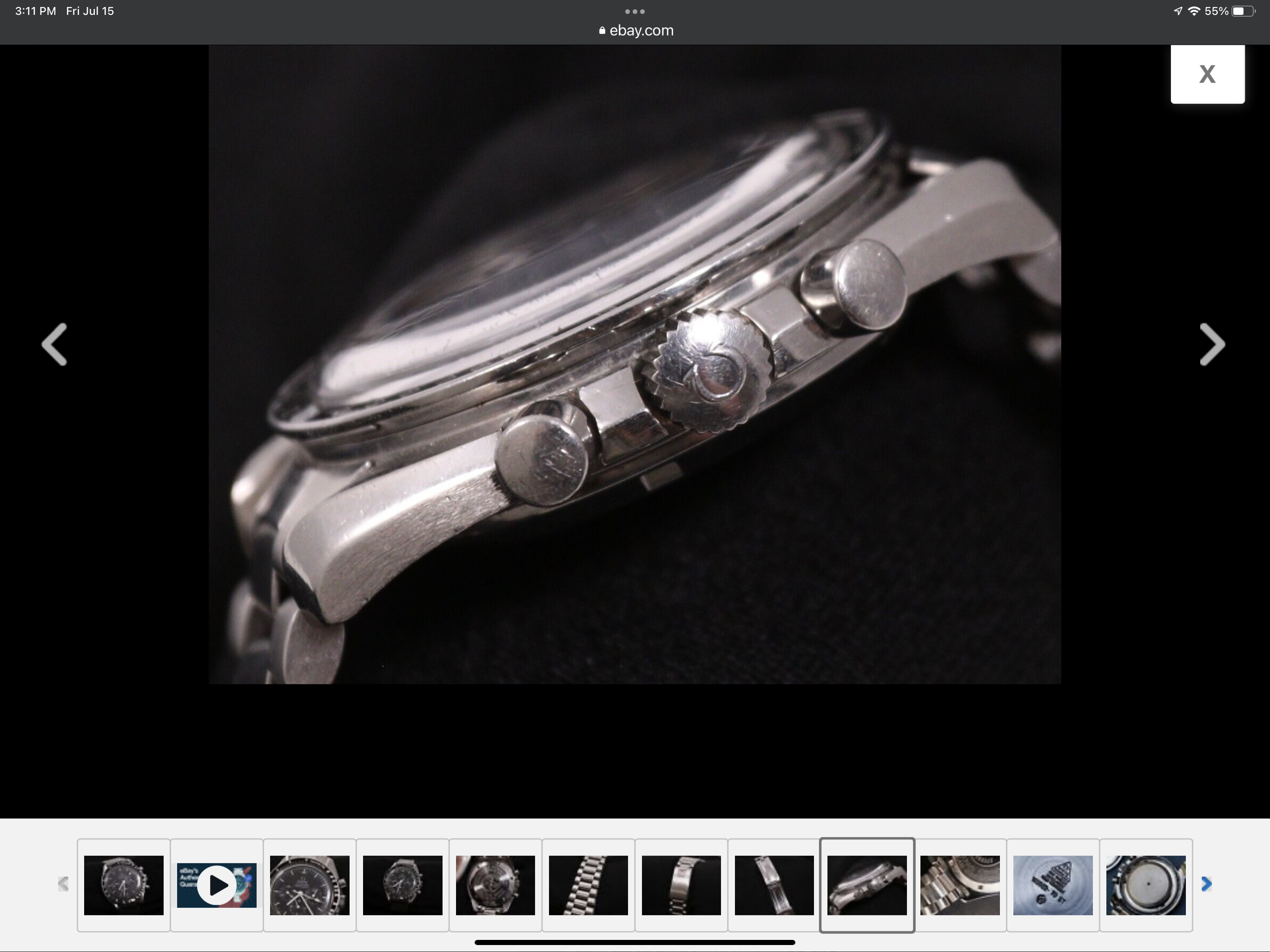

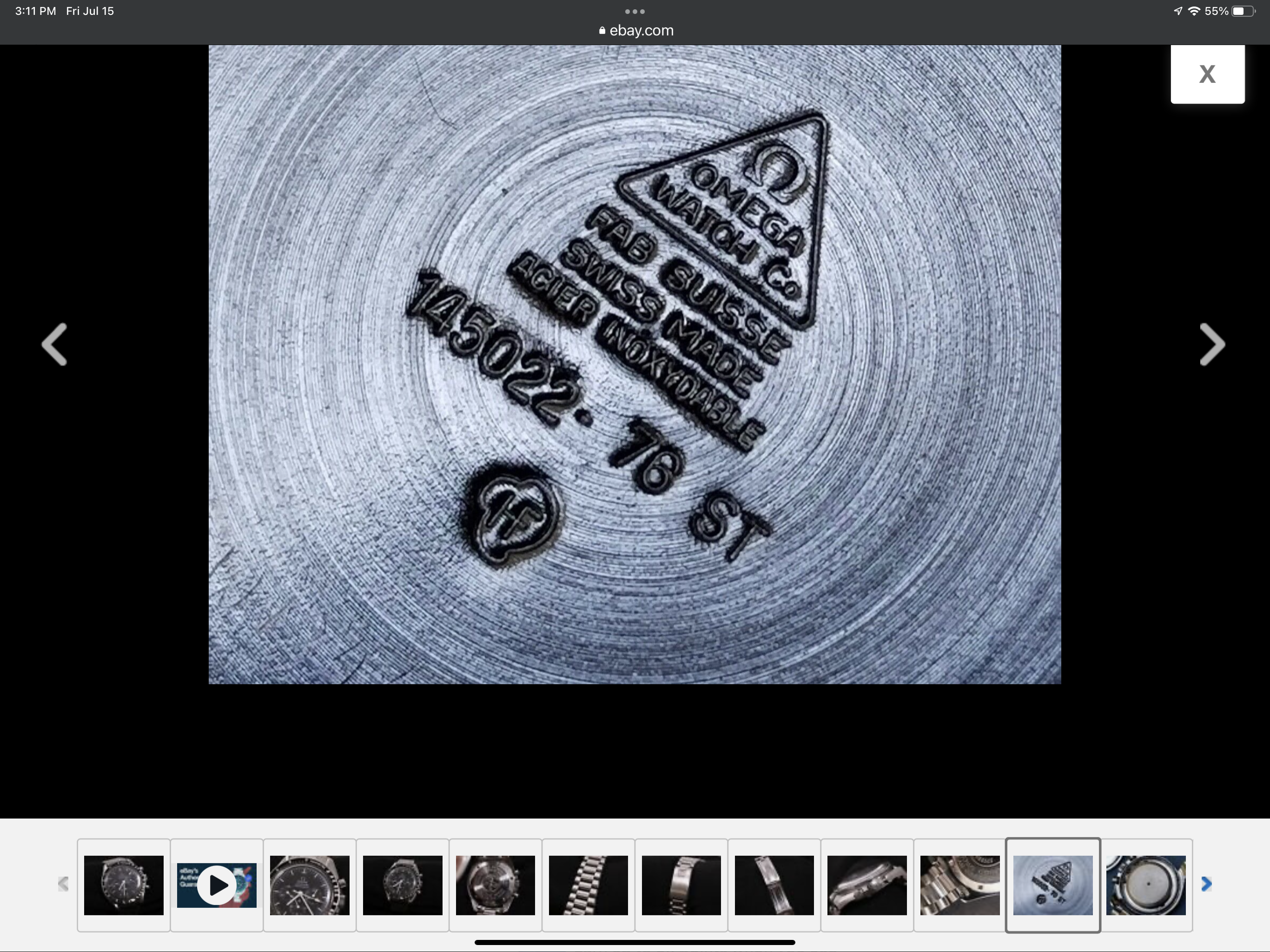

As the resident expert on the -7x watches, esp on the -76.
dial is post Sept 1977 delivery. Hands as noted are not original.
bracelet oddly is a period correct 1171. well…. At least the buckle is.
case is oddly way to good of condition to match the bezel. Look at the inner gaske seats… zero deterioration, zero wear… so explain that dial and bezel.
if this has a 39m movement Id be very surprised.
My guess is there was a pre moon that needed the bezel. Case might be an NOS service case which got the movement from the matching trashed case donor? That dial went to the mid 80’s.
