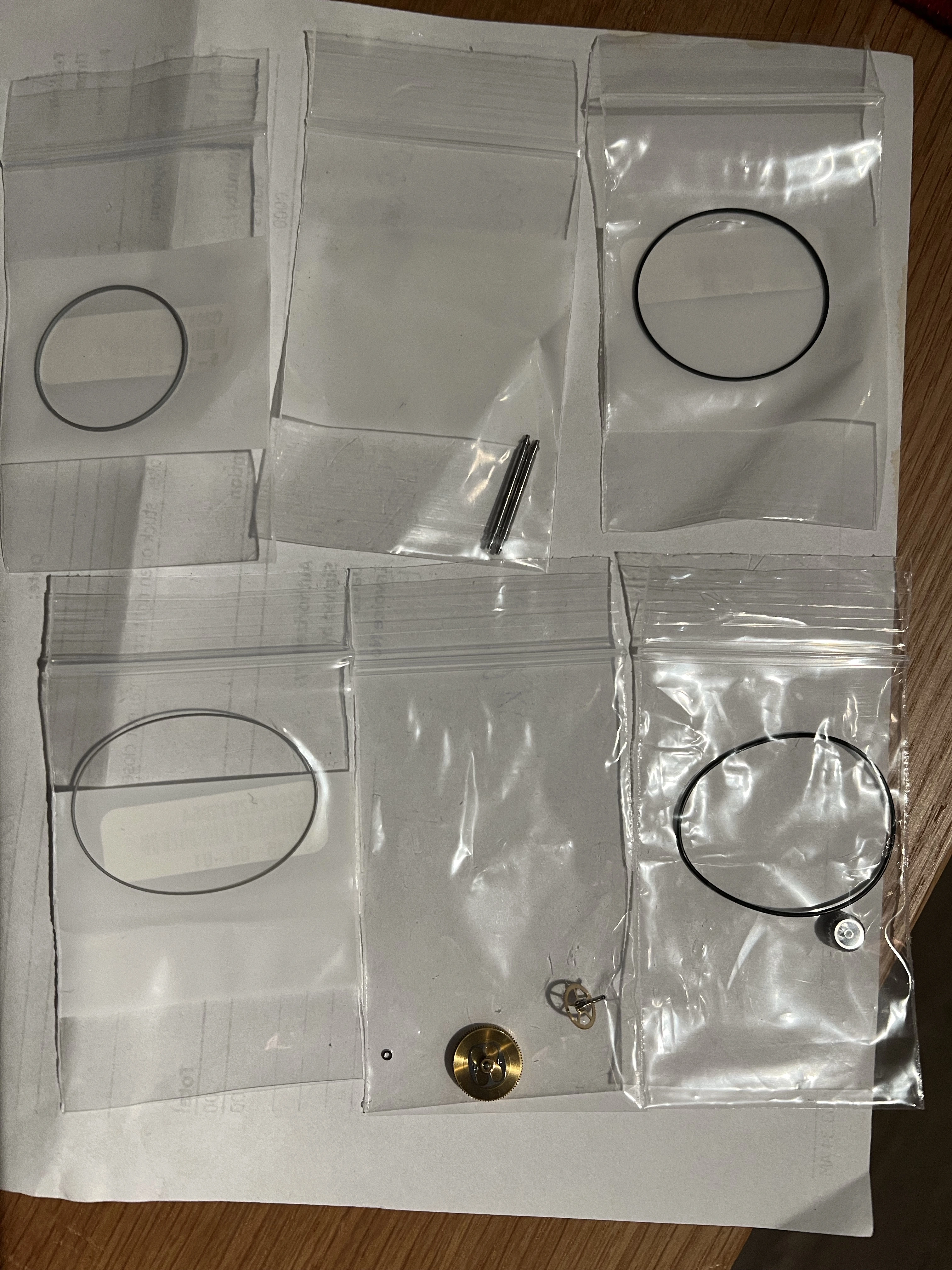

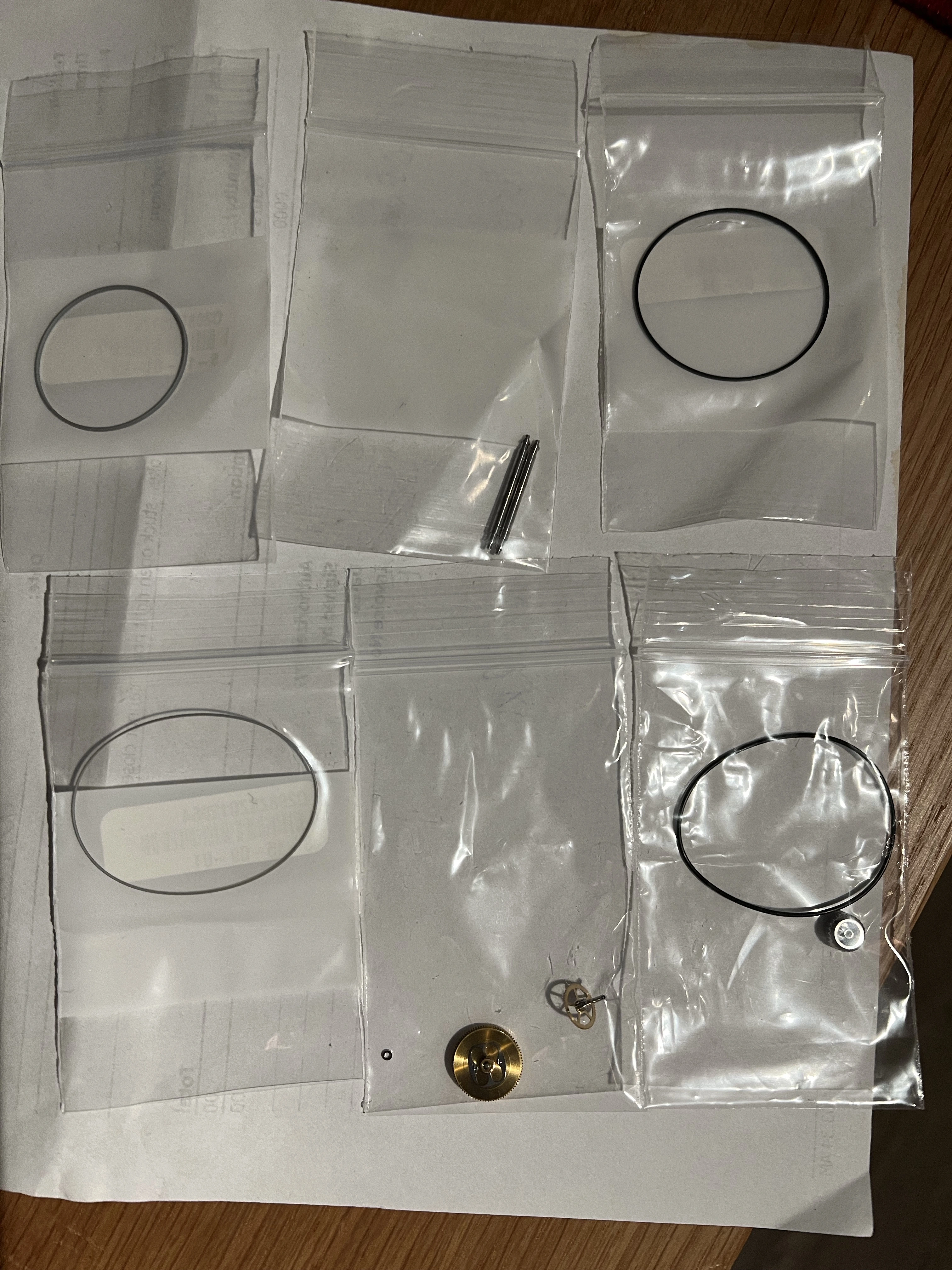

The watch has received a full service. Looks like they replaced the center wheel, a bushing, plus the entire mainspring barrel. Also, all the seals, the spring bars, and the crown...
Could it be the issue that was first reported on the A11 50ss?
Omega has made a modification to the 3861 movement by changing a bushing in the movement to a replacement made of a different material, and has also altered the recommended oiling procedure to remedy the issue. Within a short period of time all new 3861 movements should have that change implemented from the factory and any that do have issues should be covered under warranty and will likely be upgraded at the time of their first service.
I did not know about that issue, but I would have thought that one this new would have had the new part. Anyway, It's back and I am happy.
Can't tell without seeing a macro of the center wheel.
Thanks for all of your advice on these. I can take a super zoomed picture of it and post that.
