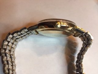

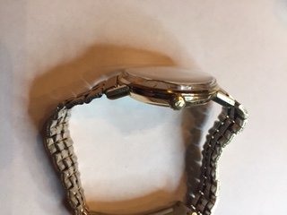

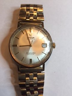

Gents-- A newbie here but interested in this thread. I just inherited my fathers Seamaster Deville -- not a collector piece-- but it's awesome and something of his I'll wear. It was an engraved company reward watch -- had no idea Dad made the $250,000 sales club in 1967... It does not have the original Omega crystal and the crappy replacement hadn't aged well. Does anyone know what size/description replacement crystal I can use and source. It's a 563, serial# 24237060, in a Ross case KM6292 w/gold finish. Much obliged,

Thanks for getting back Ross. Some pics. As mentioned not original crystal -- appears to be missing a tension/reflector ring -- and has a nice crack... It's a front opener -- not sure that was just the Ross cases or prevalent on all the Seamasterr Devilles. Plan to replace crystal and put on a nice leather band. Just looking for the correct crystal/source. Thx for taking a look and any advice--
