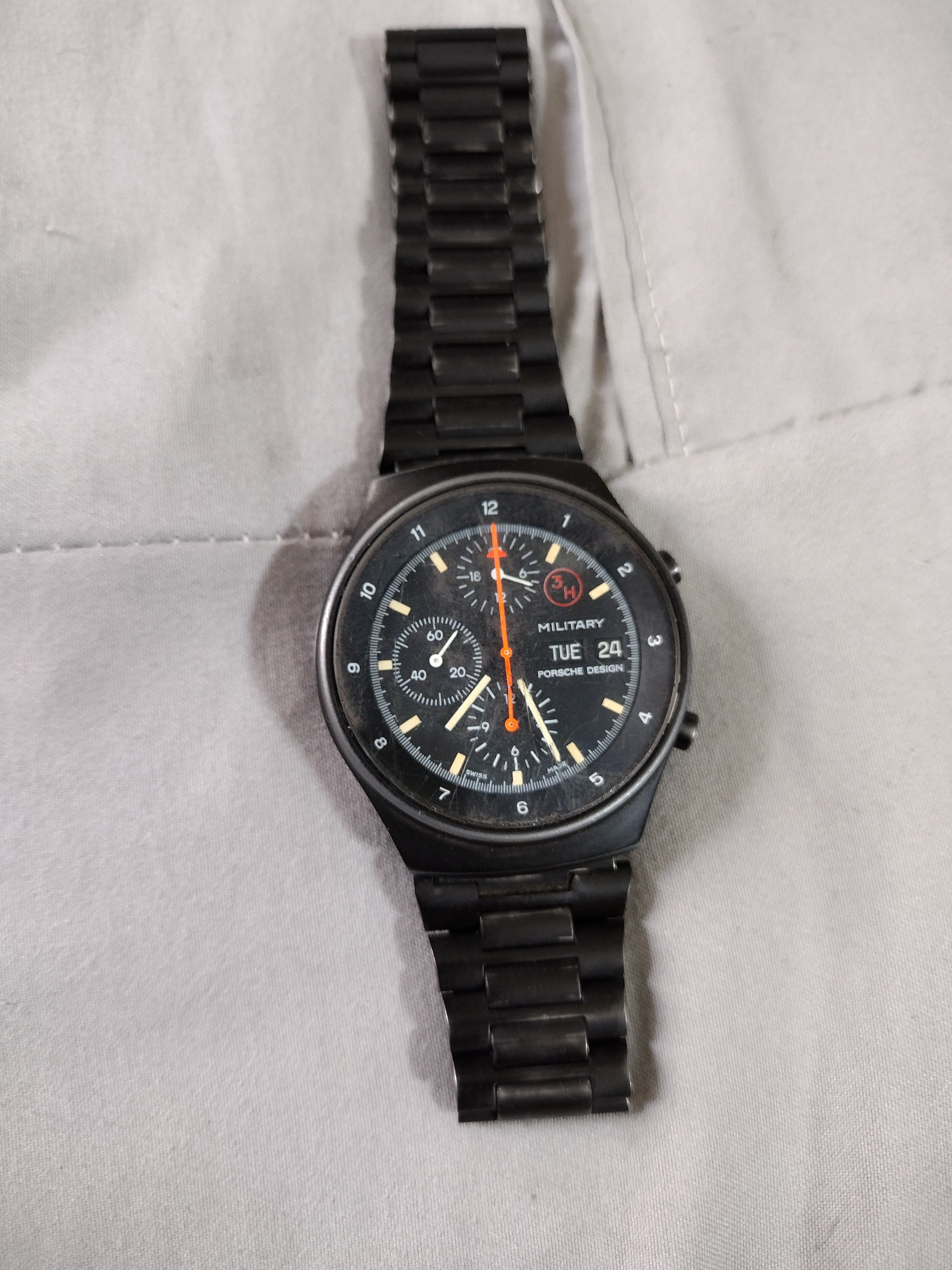

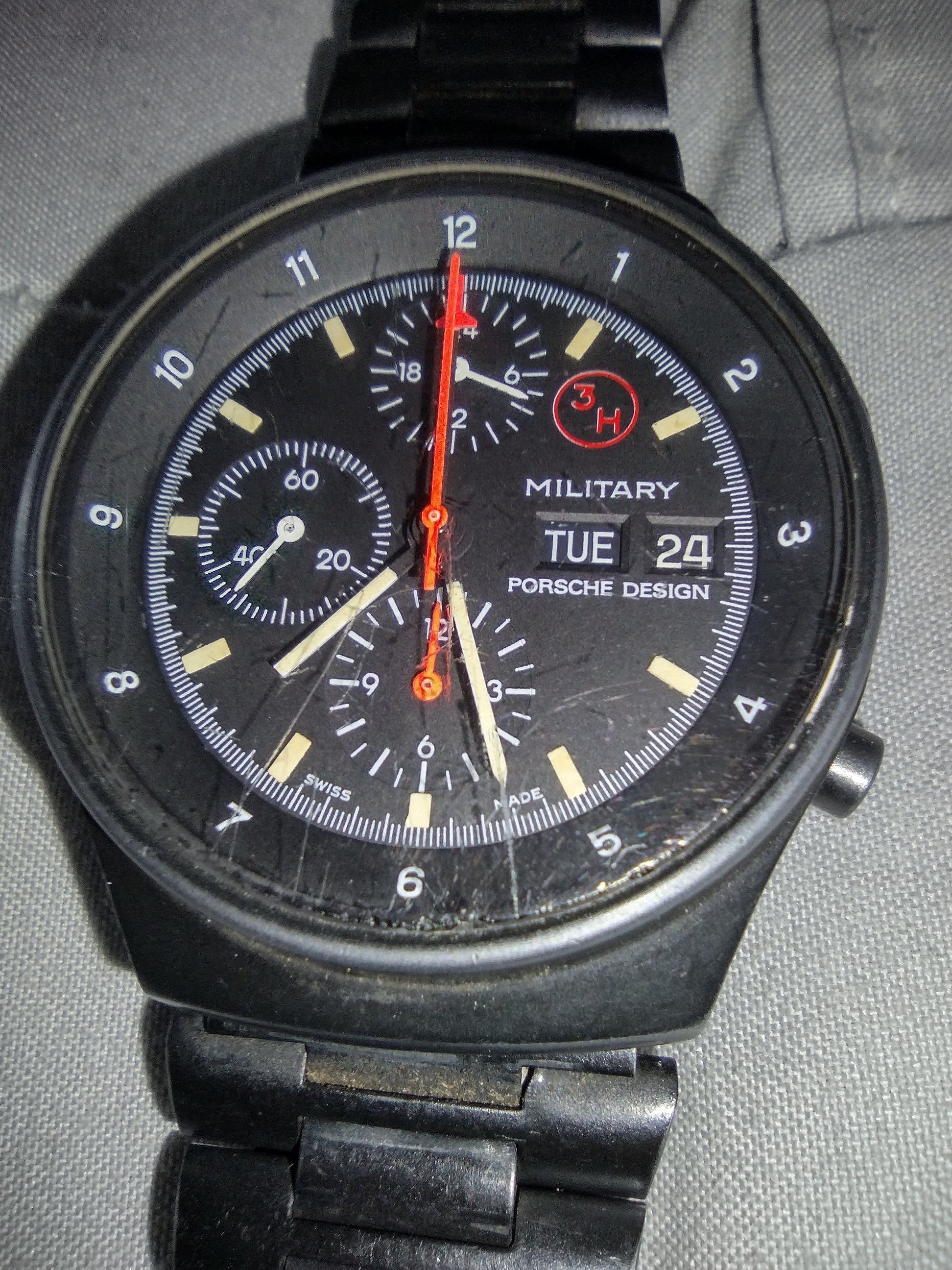

So I was crossing a busy street and in the grass on the center median I see a watch. When I picked it up I had a little weight to it and thought maybe it felt like a quality watch and then I seen the Porsche design on it so I did a Google search and when I noticed the price, I figured it had to be a replica and someone bought me a nolex when they was in China once so I know that they have some really good replicas ..but from all the reference pics from a website I seen compared to the one I found, I am not seeing anything that is different to my eyes. I don't know much about watches though. Anyways I have a few questions about it. First off..Is it real authentic piece?...secondly ..is there a serial number and a database that I could search to see if it has been reported stolen or missing? If it is original and not reported stolen, do you happen to know where to get a crown for it? Does anyone suggest I should do anything about trying to polish out the scratches on the back piece or the glass? What would be the best way to go about selling it? How much do you think I could get out of it in the condition it is in? And would anyone here want to make an offer? Any other additional information would be appreciated .

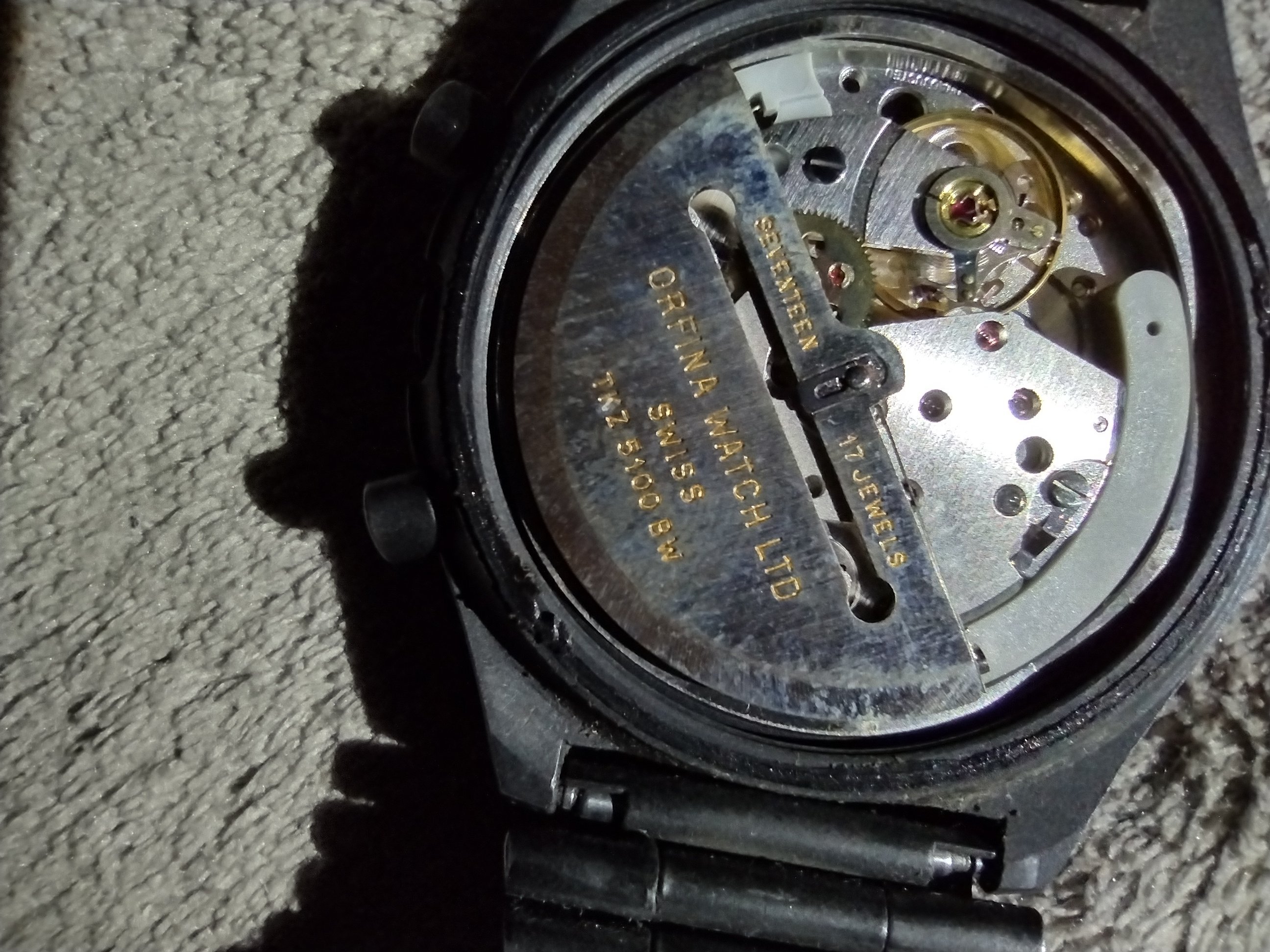

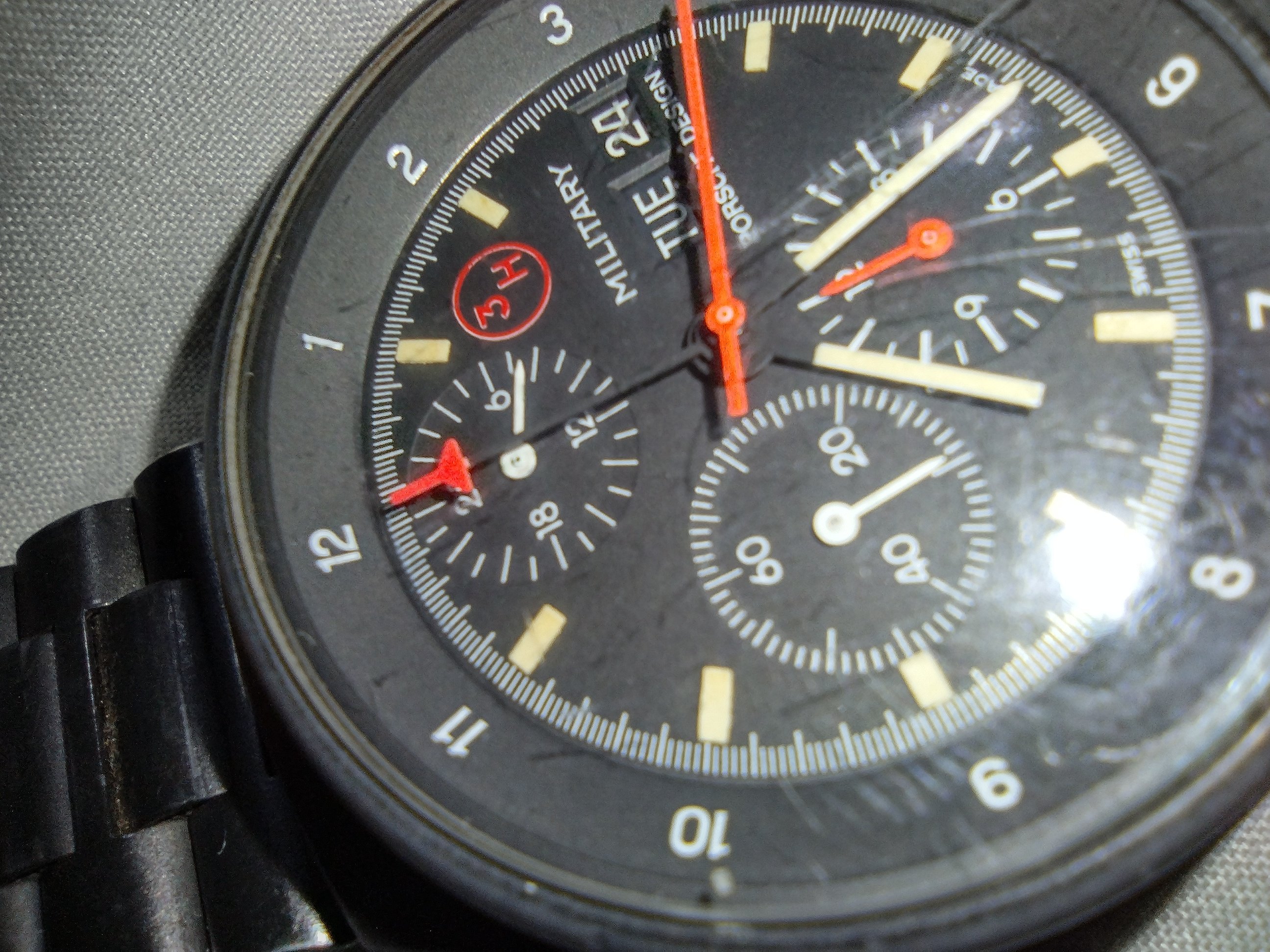

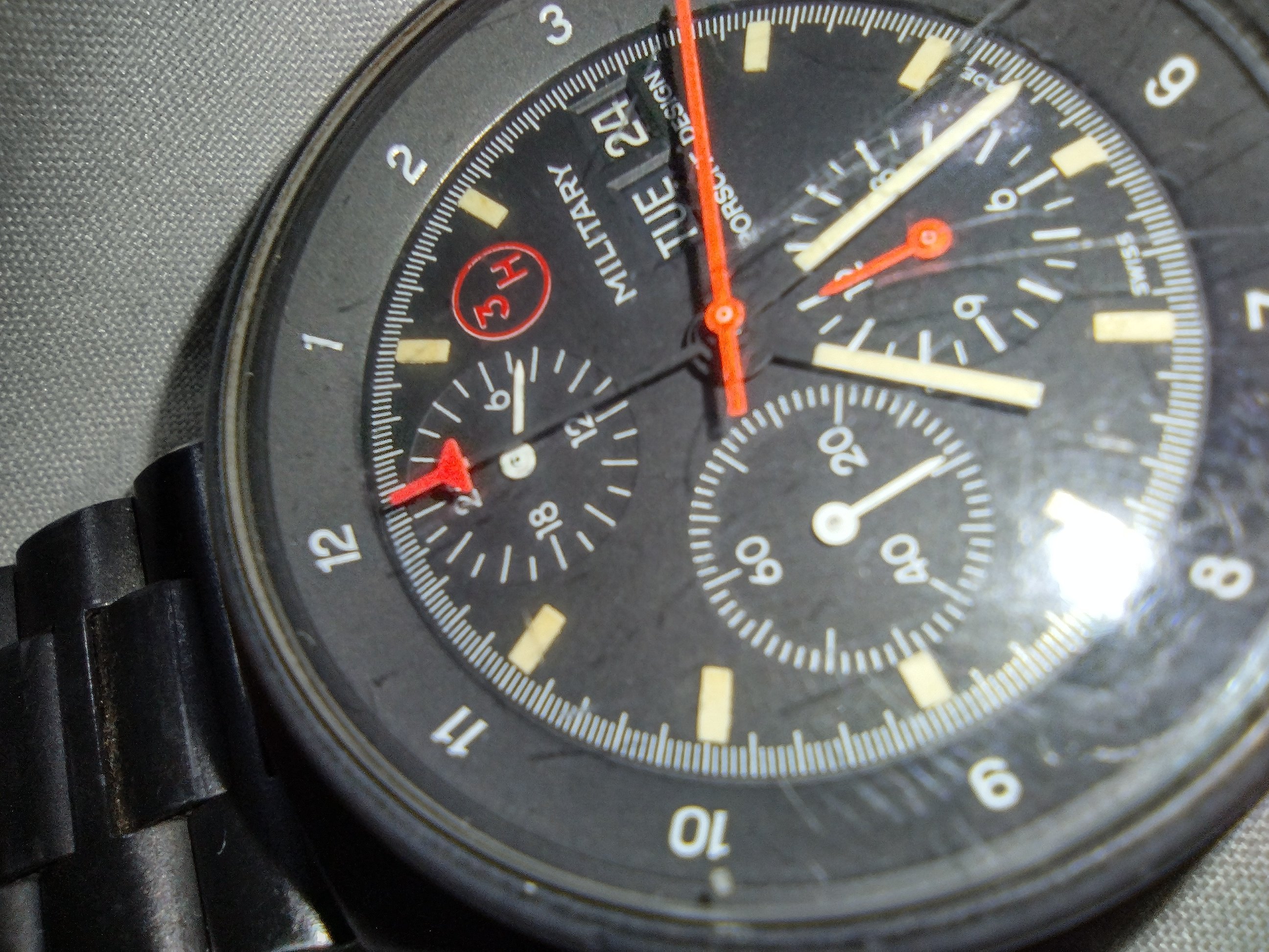

No data base. Should be from the early 80's. Caliber 5100. Markings correct. Not issued to a specific military unit. Glass , glass seal needed. Only a Watchmaker should replace that. Crystal has an inner anti glare coating. Crowns with PD/Orfina logo available. Stem needed as well. Inner distance ring under the spring appears to be missing. Black case ? Black bracelet? We have all parts for these. Value? This here is not a vetting service. Ask your local Pawn broker, how much he wants to give you. eBay next. Service for these movements quite expensive. And that's it in a Nutshell.

Not a bad watch…pay for a service and a new crown and you have a nice watch…
Try selling it in the condition it’s in your lucky to get $200
Service it your getting closer to what you saw on google when you looked it up

Looks legit to me and worth several times more than said above as is. All you'd need to do to see if the member above serviced it is give him the serial number. That should start with 040 but you have it hidden by the rotor. It doesn't appear to be engraved into the upper automatic device bridge seen through the rotor slot, so that lends legitimacy Would be informative to see the outer case back.

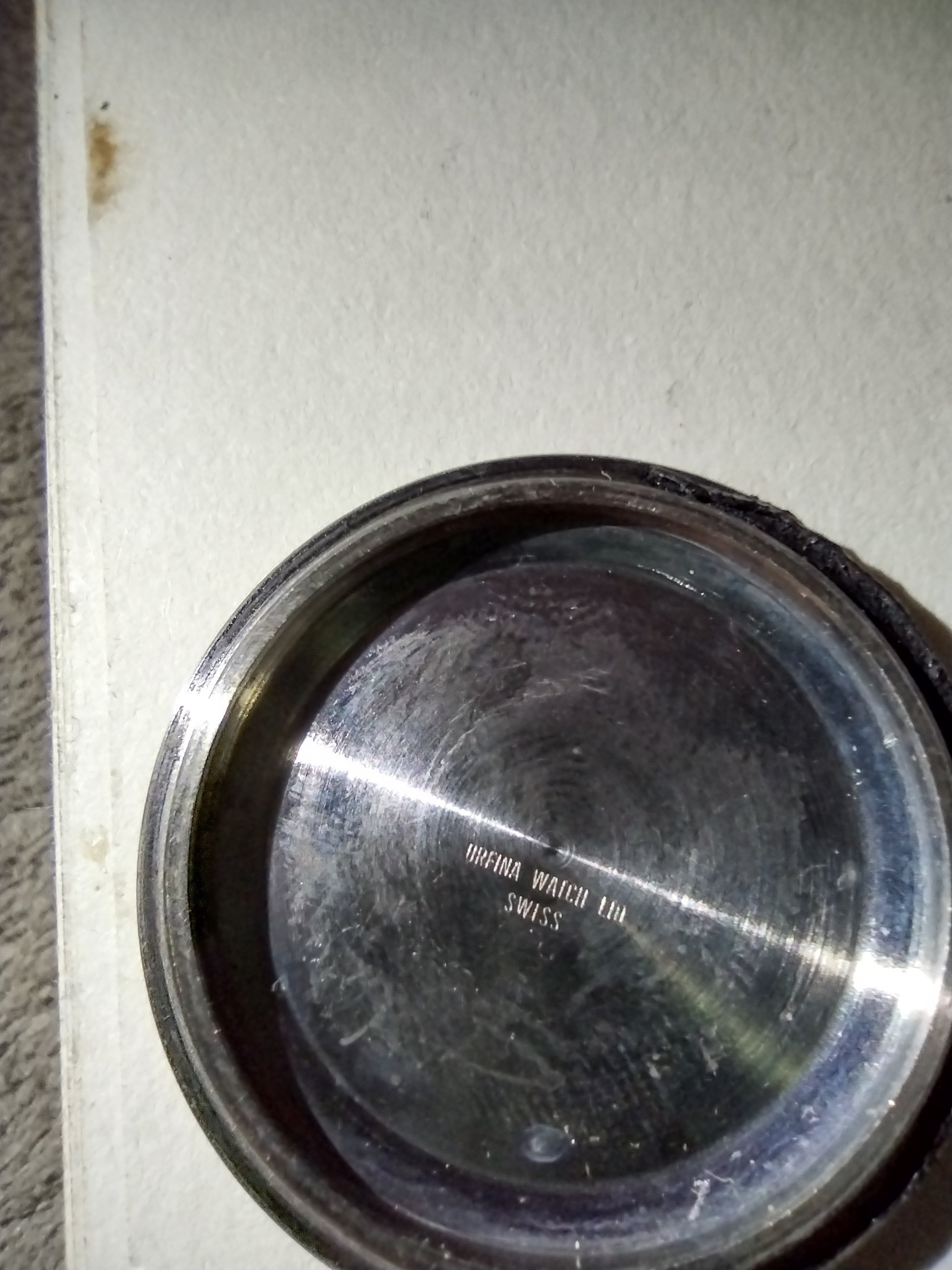

$20 says the outer case back is scratched like a tree in a bear park from old mate opening with a pair of scissors….

Apparently the OP is long gone.... but we're still here. If you (OP) spin the rotor half way around there should be a small, circular recessed area with a sticker in it having the serial number (if it has a correct movement). Assuming you've exhausted all attempts to locate the hapless owner🙄, the parts you need are readily available (crown, winding stem, movement spacer ring, crystal and gasket, even a correct new case back if needed) to make this proper. All are fairly affordably priced save for the case back. The hands look great and I don't see any issues with the dial. Get those parts and a service and you'll have a fine wearable and collectible watch.
I actually was able to get it off by hand....caseback is still scratched like a tree in a bear park
