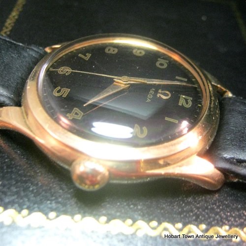

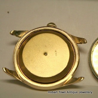

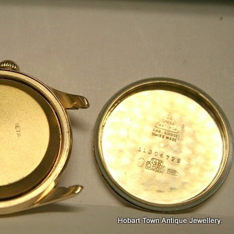

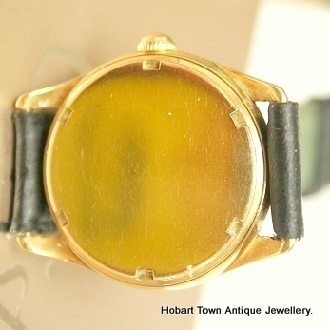

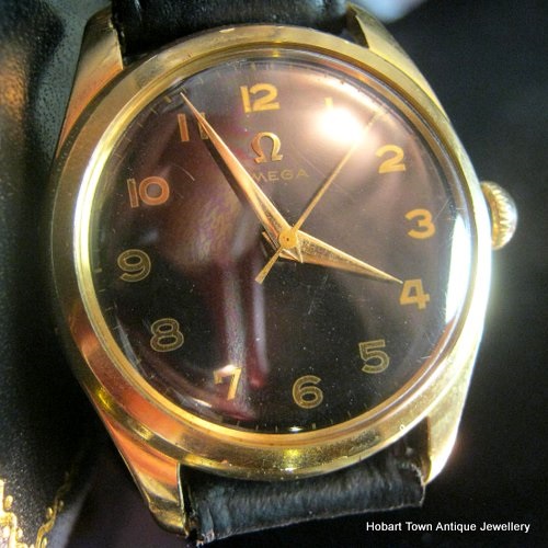

I have been offered this allegedly "unique" Cal 420 Omega - it is a 33mm, solid 14k Gold case and apparently there is no others like it around - the interesting thing about is the antimagnetic cover.

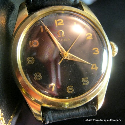

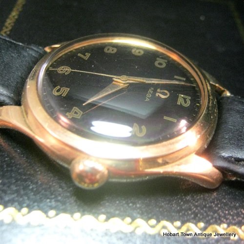

It has a black dial which is stated as 100% original (is that true do you think) - looks beautiful but I cannot see any "Swiss Made" at the bottom edge of the dial?
The Seller (who recently passed away RIP) cannot be asked questions so I am dealing with his lovely daughter who has given me written permission to post this Thread and the photos.
Is the watch all it is cracked up to be?
Looking forward to your expert comments and feedback!

If it's truly unique, then it's going to be difficult for anyone except for Omega to tell you with certainty. The best we can do is say whether or not it looks plausible. Who exactly is claiming that the watch is unique? The daughter? Is she an expert? What is "Hobart Town Antique Jewelry"?

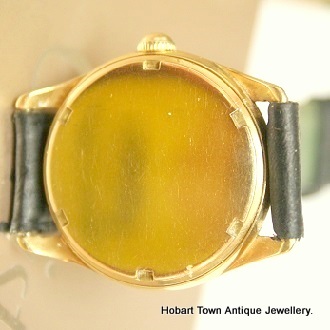

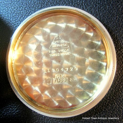

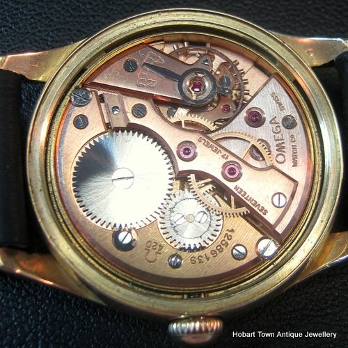

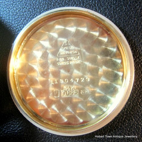

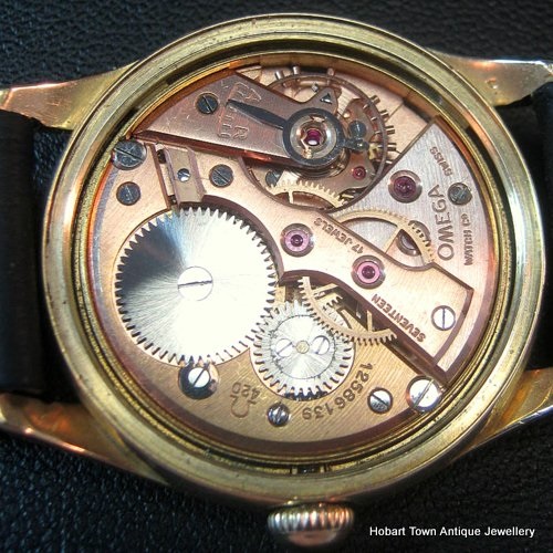

Given the caseback number and the serial number, I’m guessing the movement and the case didn’t leave the factory together.
(Typically, 40’s Omegas have a caseback serial number instead of a reference number and that caseback serial number is always higher than the movement serial number, right?)

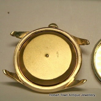

Hopefully the antimagnetic cover is iron, and just gold plated. A solid gold dust cover wouldn't help very much with magnetism.

14k case made by Omega? I guess not that rare for the period... I see a few others with a slightly differnt case and 14k (even a 9k??)
Watch circa 1950 not for the US market.
No swiss made...
Dial looks a little early in style for a 1950's watch that is more mid 40's and earlier, not out of the question though, but you tended to see more detail on post war watches.
Same case in steel? and crown here

Well, it does seem to be a Spillman Case. Putting aside the ridiculous description, it's worth a hard look. Price is ridiculous of course, but I'm not ready to say it's fake.

There are many serious collectors on this site, including Achim, and the exaggerated description of that watch, especially with words like "rare" and "prototype" tend to provoke strongly negative reactions and great skepticism. Such descriptions are almost always very bad signs about a seller, and typically cause us to look away immediately. Not only is the hyperbole offensive, but a claim of uniqueness basically means that one can't verify the watch by doing research. 99% of the time, a unique watch is not legit.
However, you would be buying the watch, not the seller, and there's always the possibility that there could be a decent watch hiding behind an obnoxious description. And occasionally rare watches are real.
