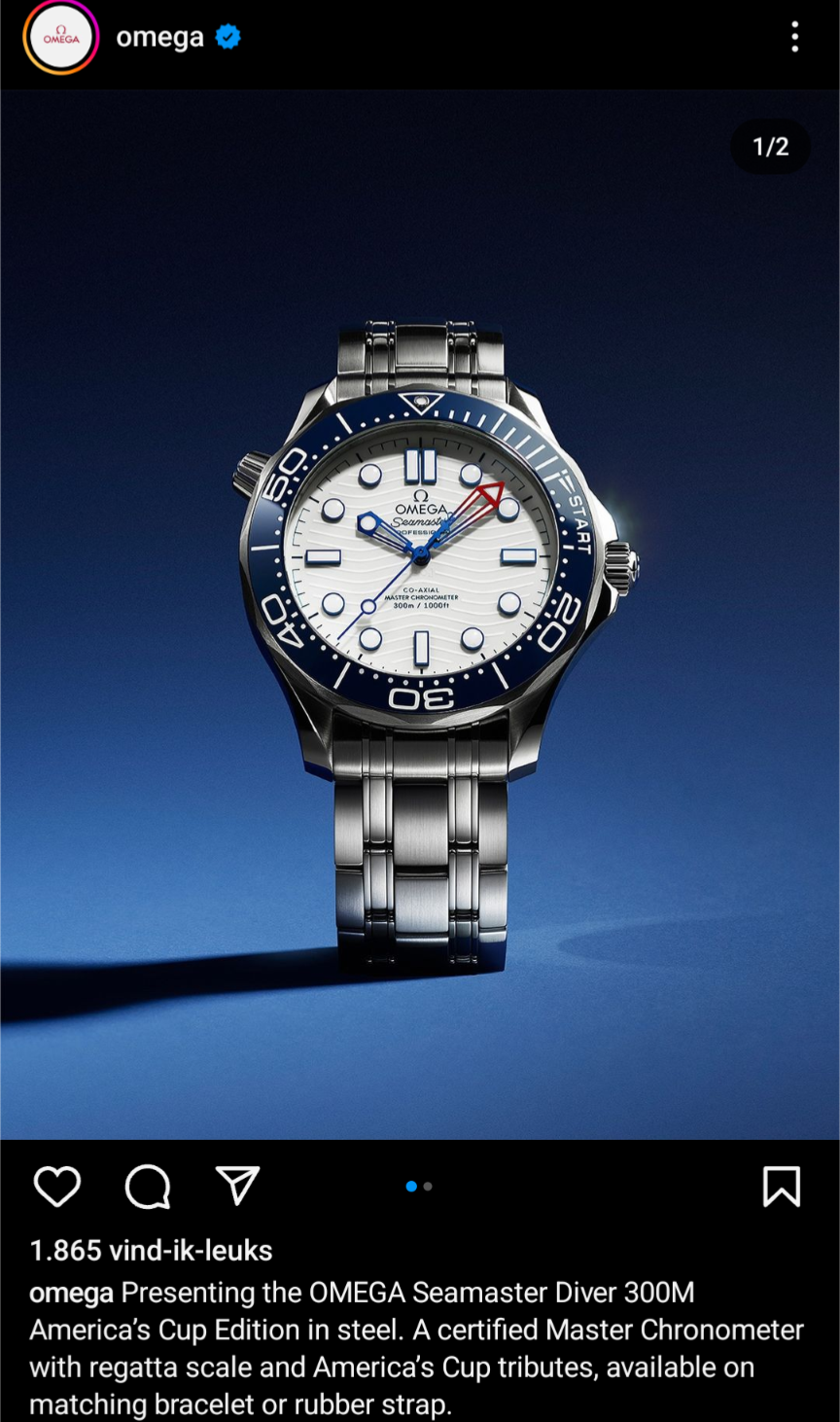

Possible new 300m spotted on Daniel Craig
193
331
A new no date SMP just got released
I don't mind the day one mind, but I have to recognize that this picture shoes how the absence of the date makes the watch more attractive.
