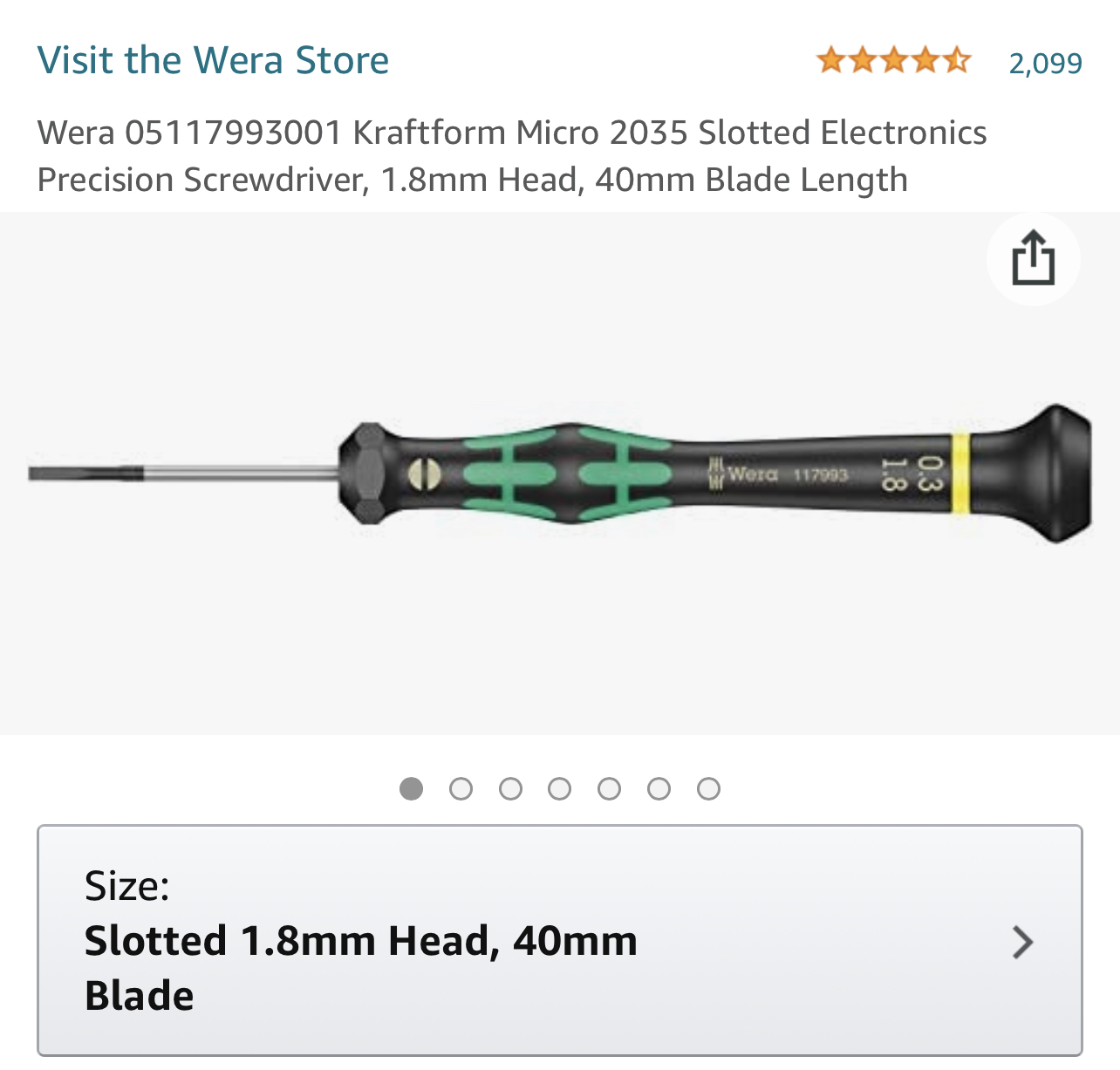

Sorry guys, wrong link. This is the screwdriver I was talking about. 1.8mm slotted.
Is 1.8 mm the correct size for ALL Omega bracelets?
I can only speak to the SMP 300 and Planet Ocean bracelets. They take 1.8 mm.
