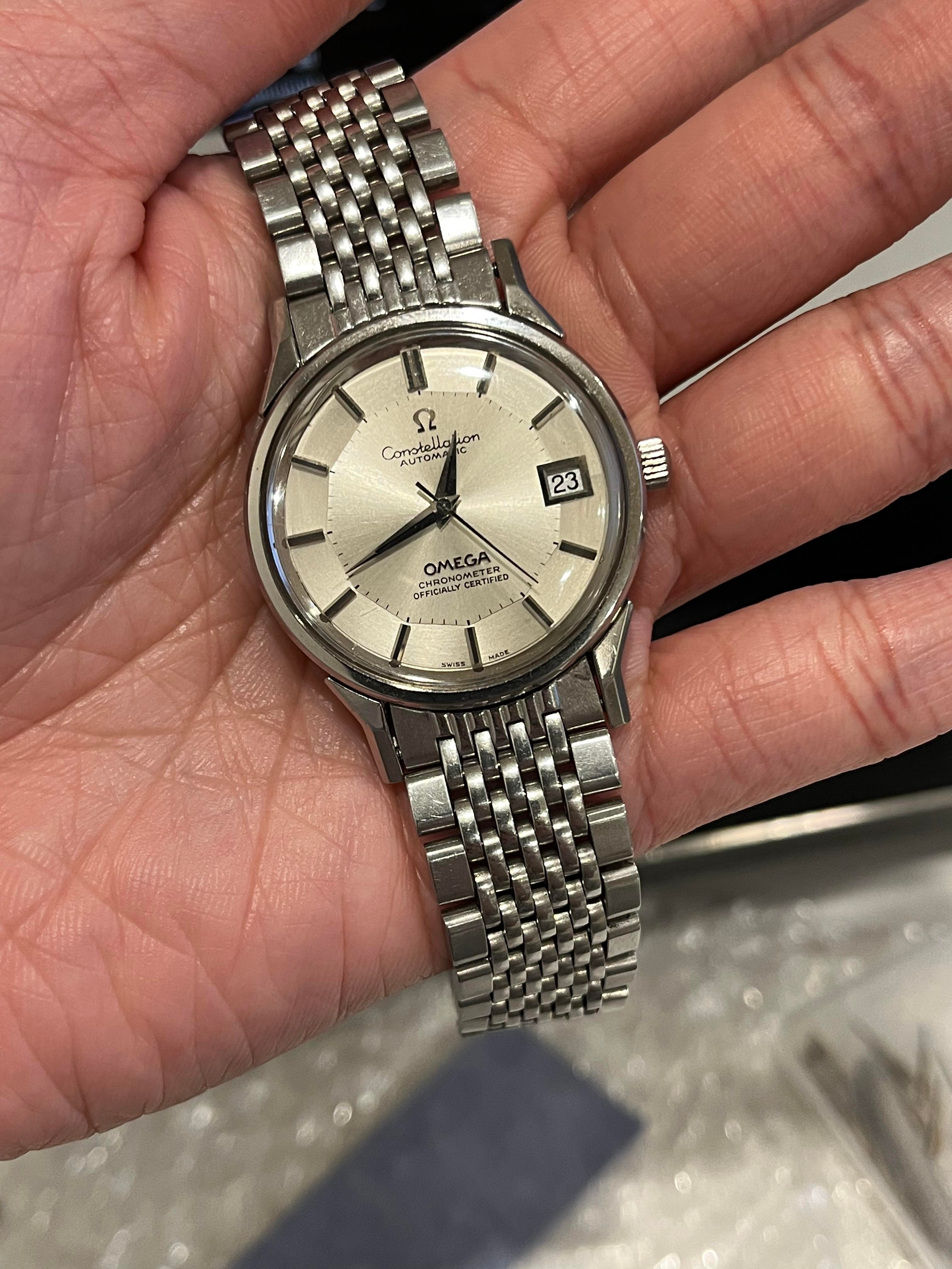

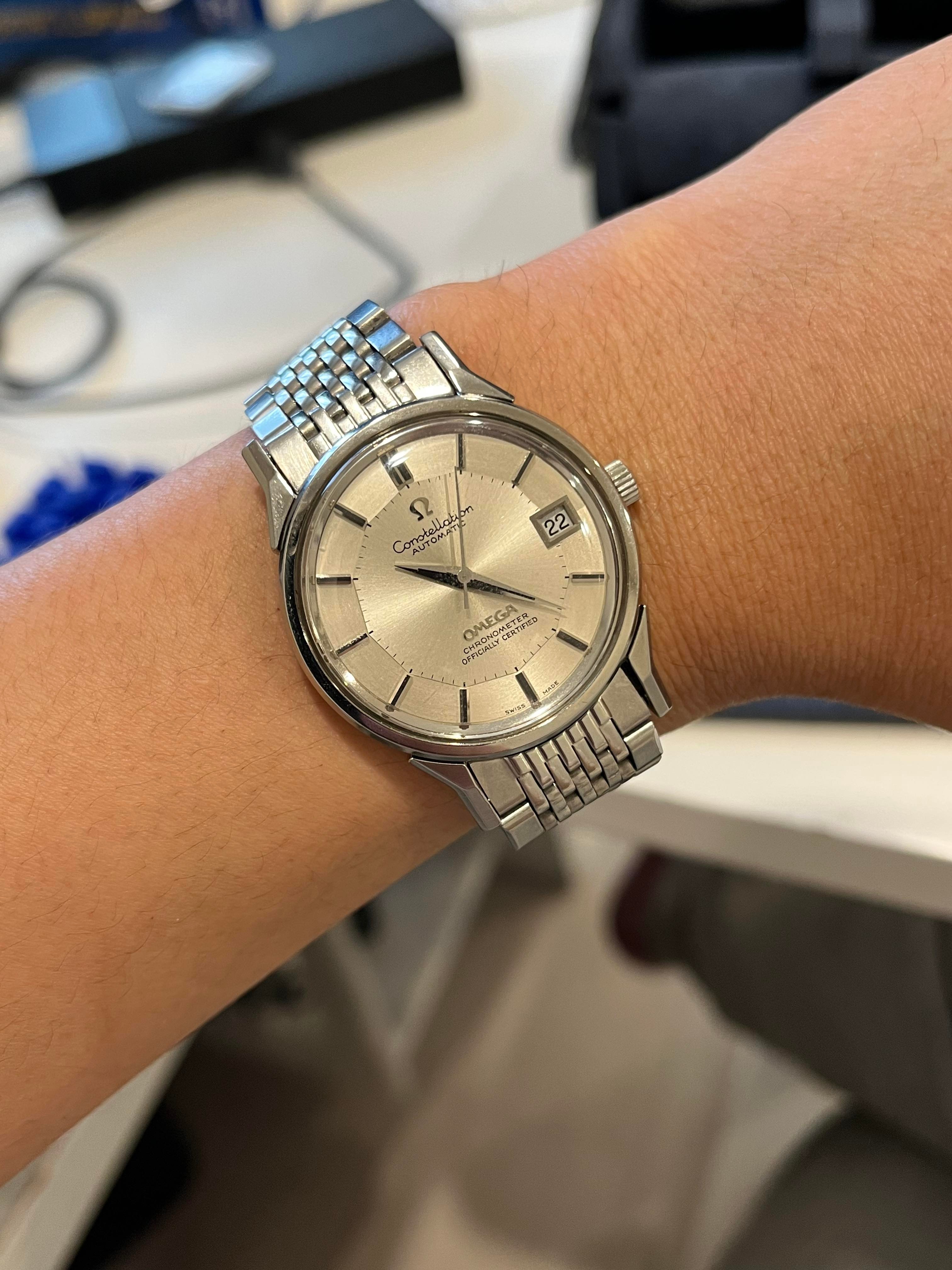

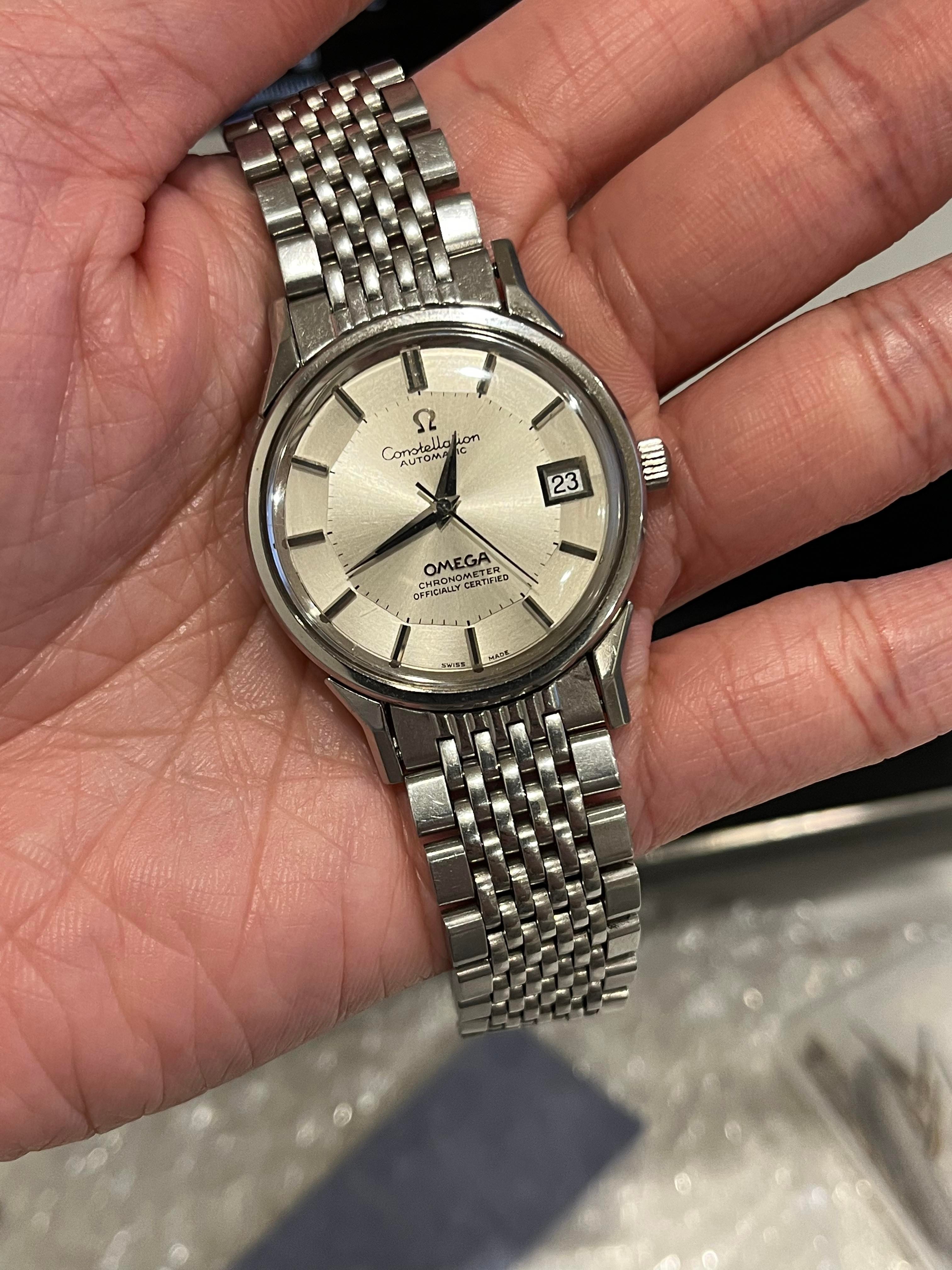

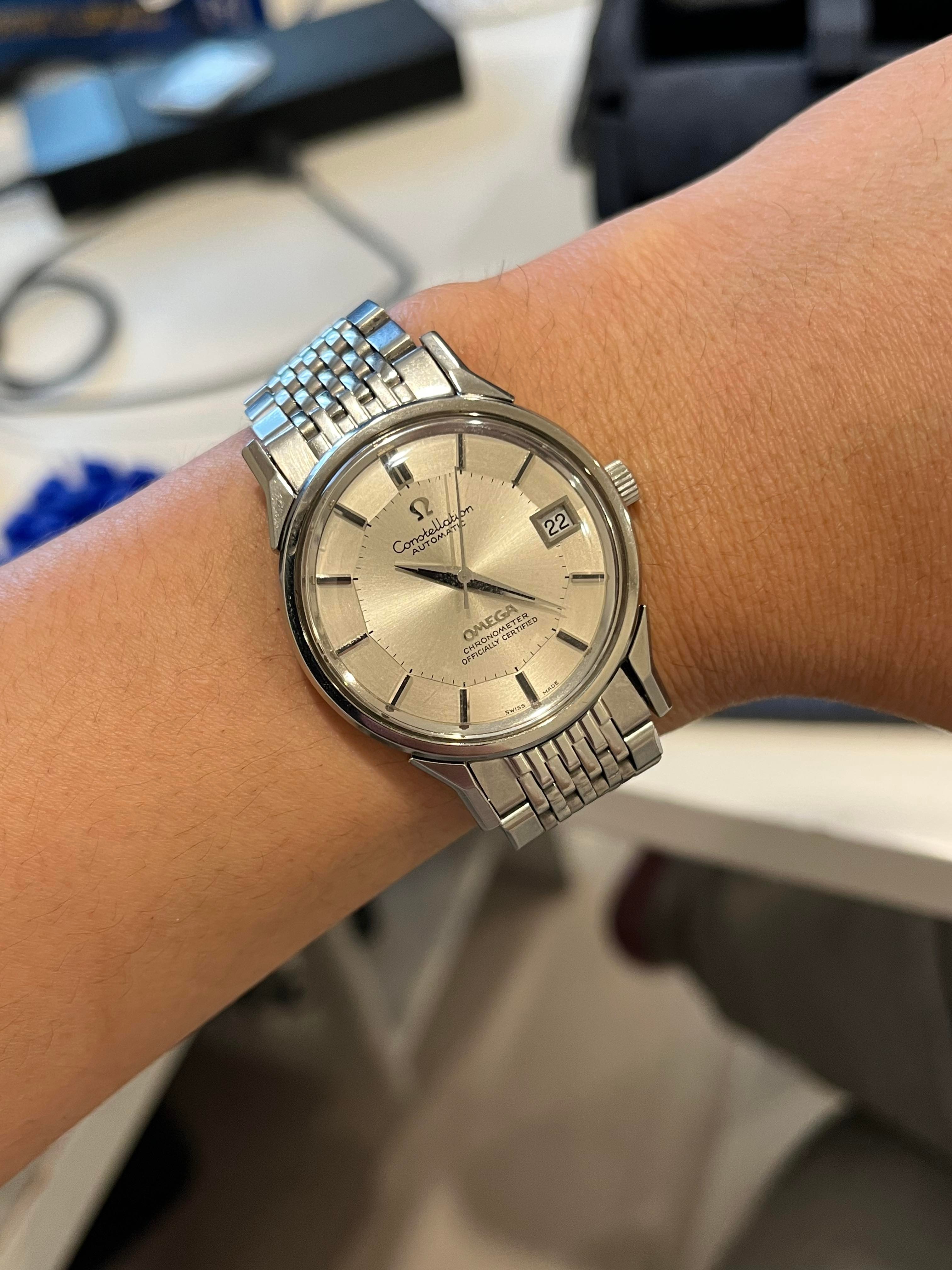

Finally managed to size it thanks to the suggestion by @janice&fred 馃榾
This one comes with 570 endlinks but I wonder if there is a better end link ref out there specifically for the Connie dog-legged case?

I think the 570's are the best fit as the older 70's can be very loose.

It looks like one of those end-links may have been filed down, or perhaps the lugs are bent. I'm a bit surprised at the gap on the 6 o'clock side.
106
111
You're right, it was stiff when I put it on too so I took it out, opened the end link a bit and now it's all good. I noticed the gap as the end links measure a tad smaller than 18mm (~17.8mm) and the lug is a tad more than 18mm (~18.2 mm)

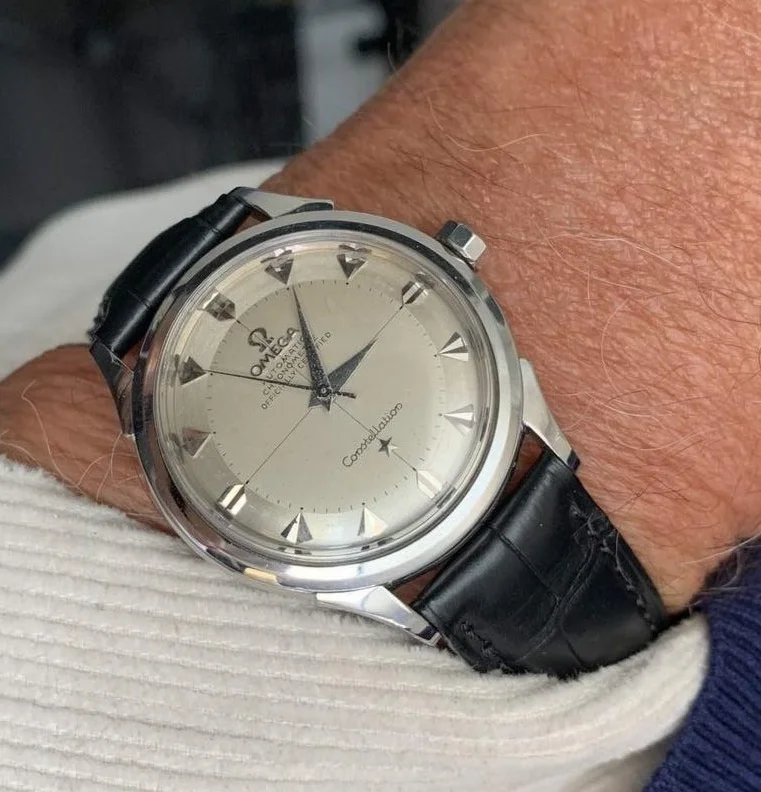

Congrats! I from now on will definitely go for BoR.

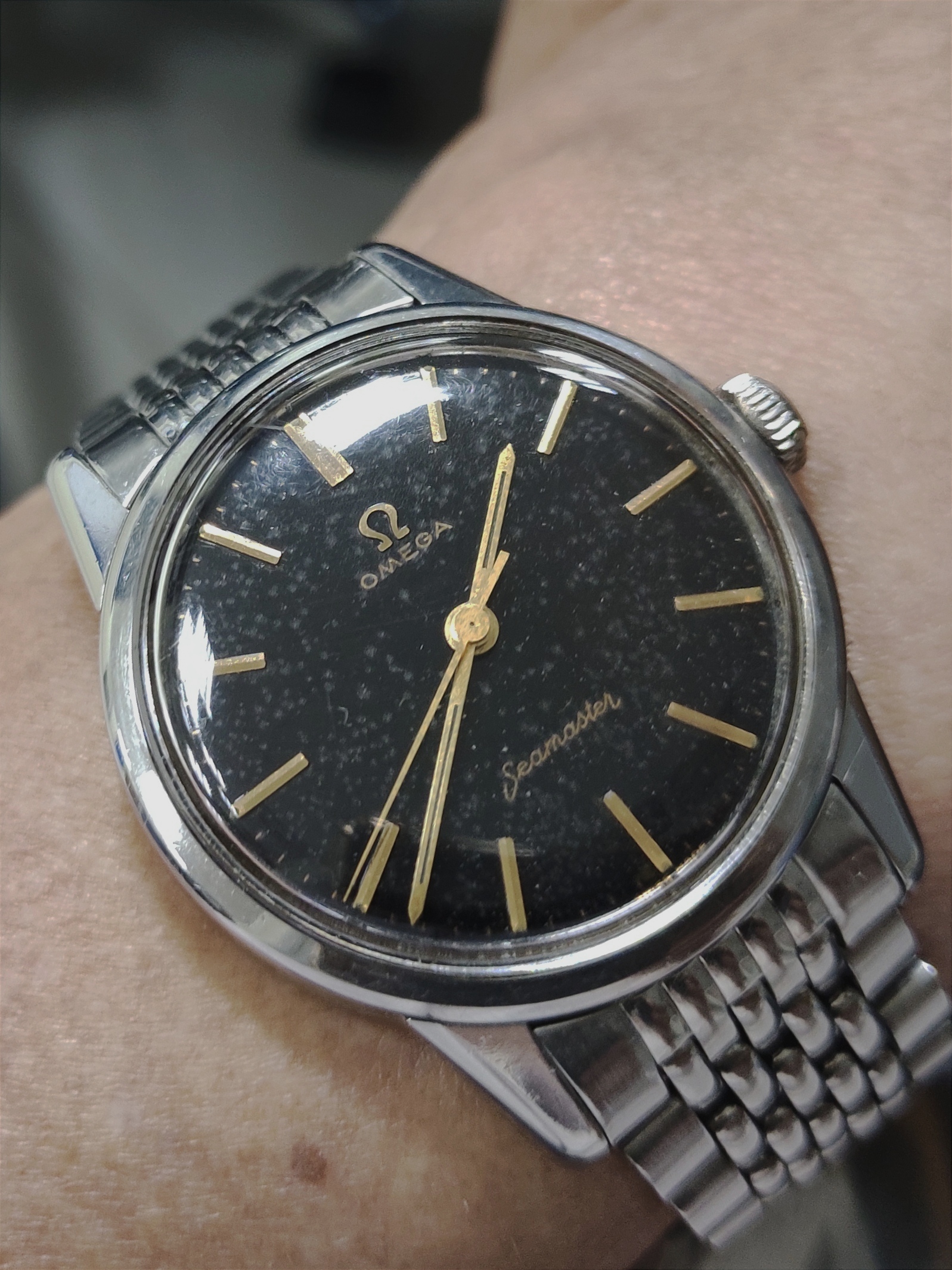

My (less desirable) 14390 before and after...
4,593
10,813
Less desirable? Says who? Some prefer Constellations and some Seamasters. Your watch is a stunner!

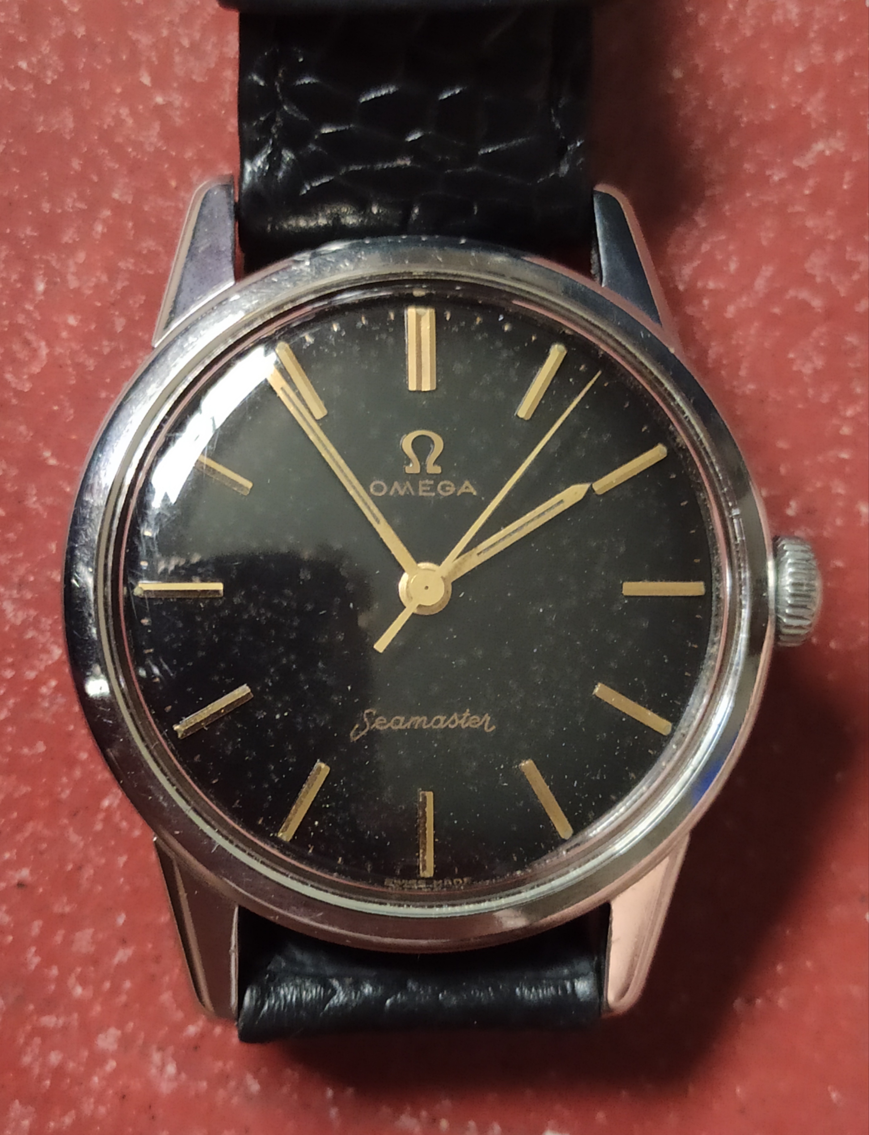

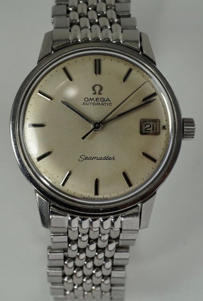

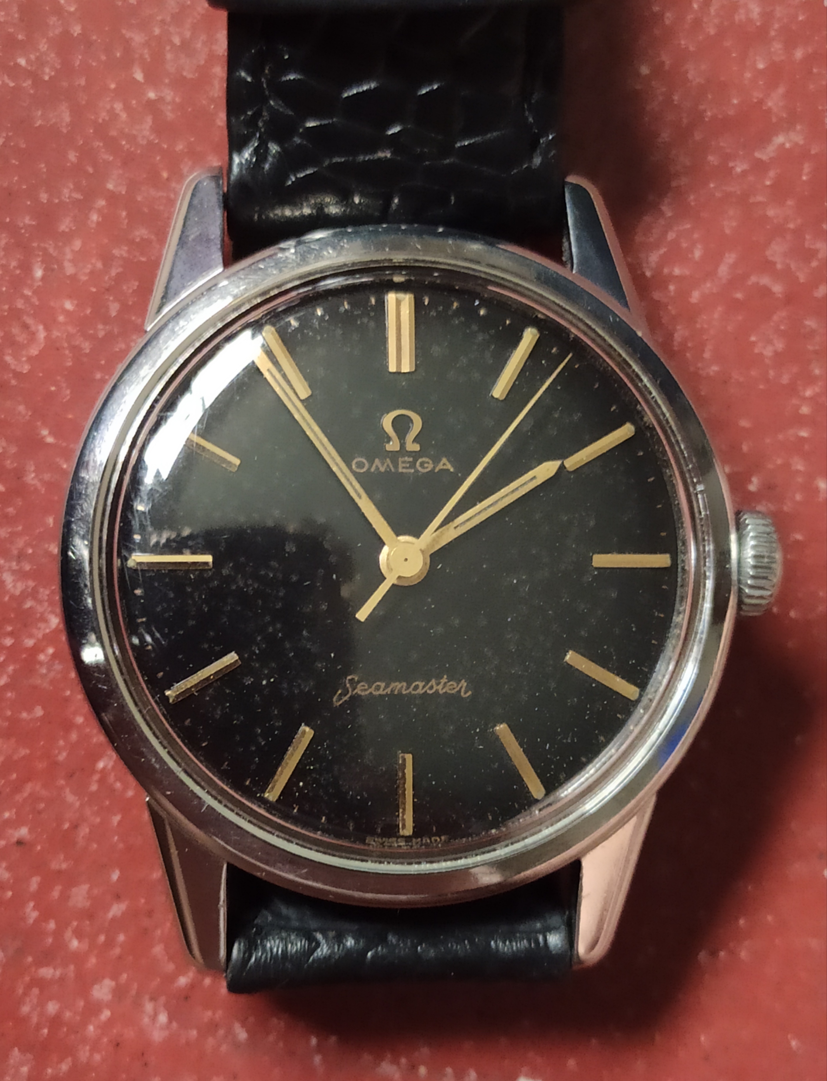

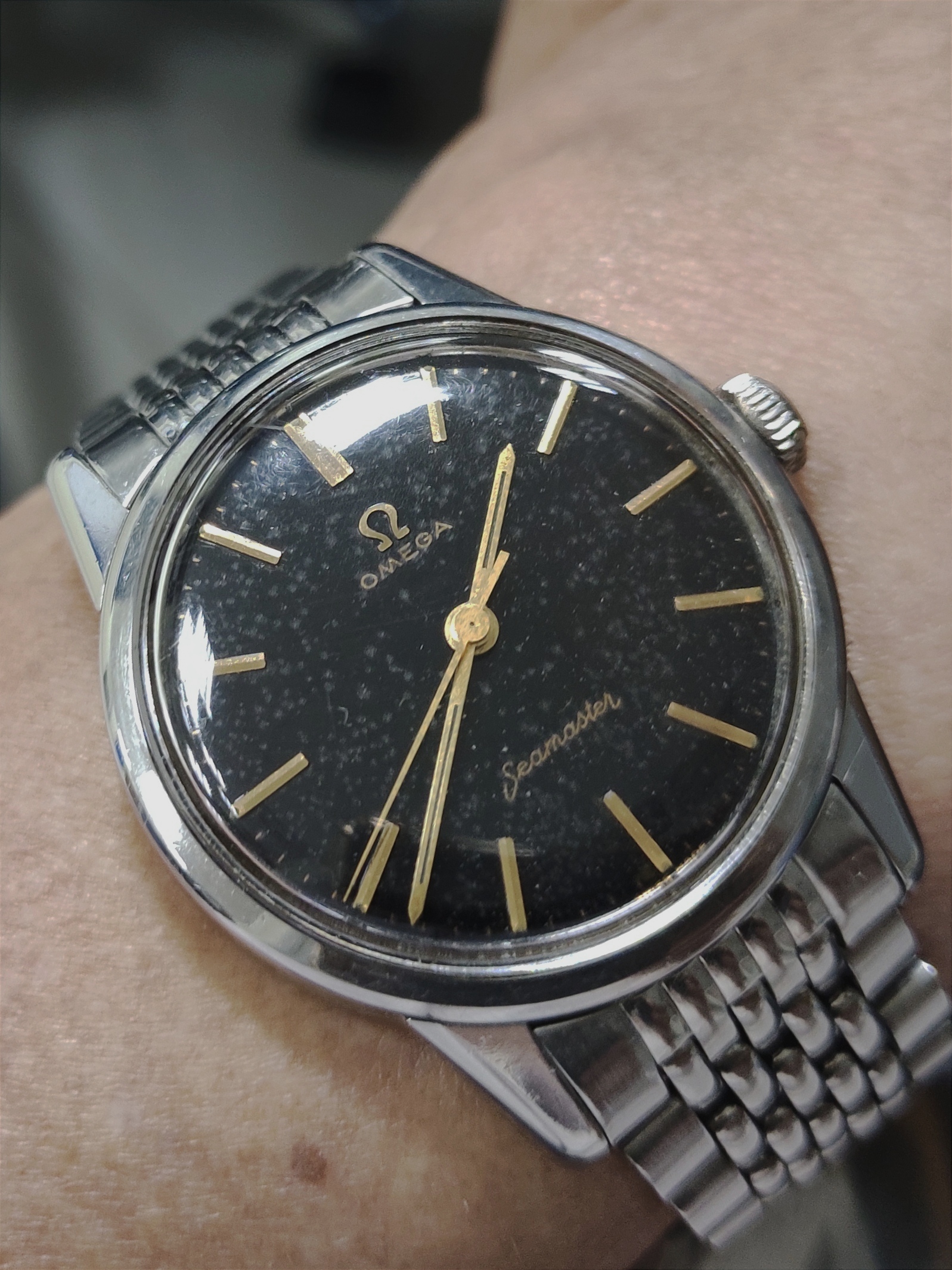

I recently bought a '67 168.005 dog leg and shortly after a '52 Seamaster : the latter came with a (supposedly) original 1036/11 - 7 rows BOR.
I've put the BOR on the Connie : but it doesn't please me : I believe the #11 end link does not match the dog leg,, which probably is best fitted with a 9 row 1037/570 . To me, the 7 row BOR looks better on a Seamaster (shape of the legs ??) ;
So I am probably going to hunt a decent 1037/570 for my Connie.
anybody has an opinion on that please ?
13,538
23,486
Yes the earlier 5 row BoR isn鈥檛 correct for a Dog Leg case. They need the more modern looking and flatter 7 row

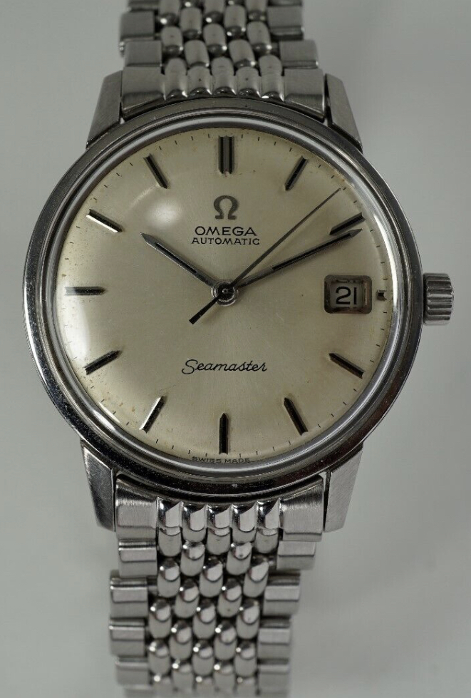

Yeah, thought so as well ; one more point : I realize that on mine, and most other Connies fitted with a BOR, the end links do not align perfectly flat with the ends of the legs : in other words, the end links tend to bend down as compared with the sharp end of the legs : normal, or is an end link ref more adapted ?

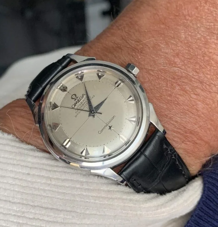

Hello. Which BOR is most suitable for a 1954 stainless still Connie or were they not used?
