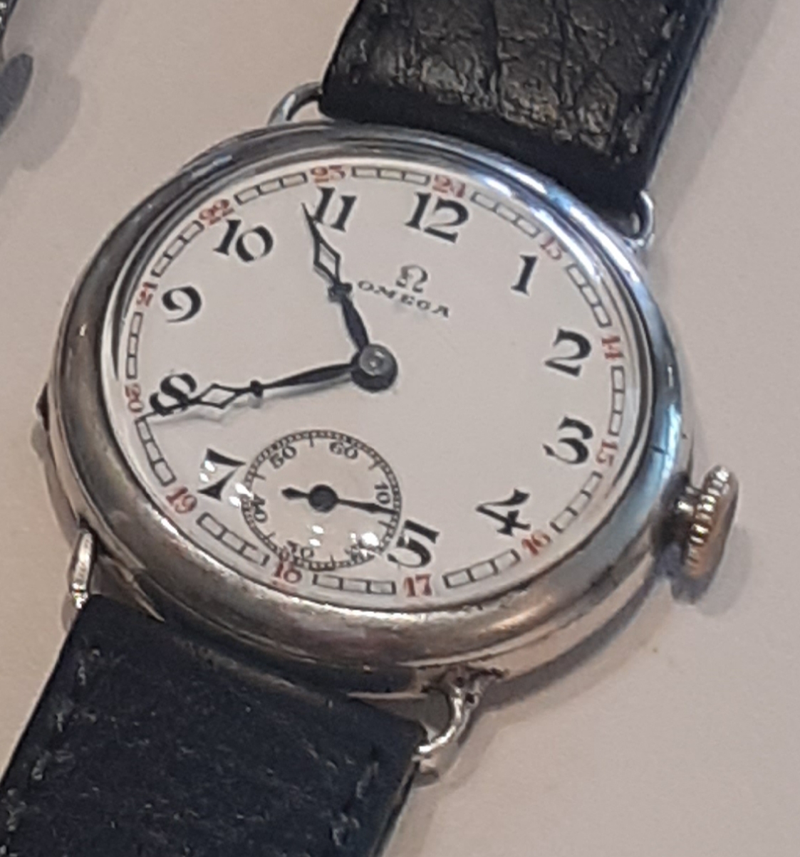

Please help to identify
6,902
10,764

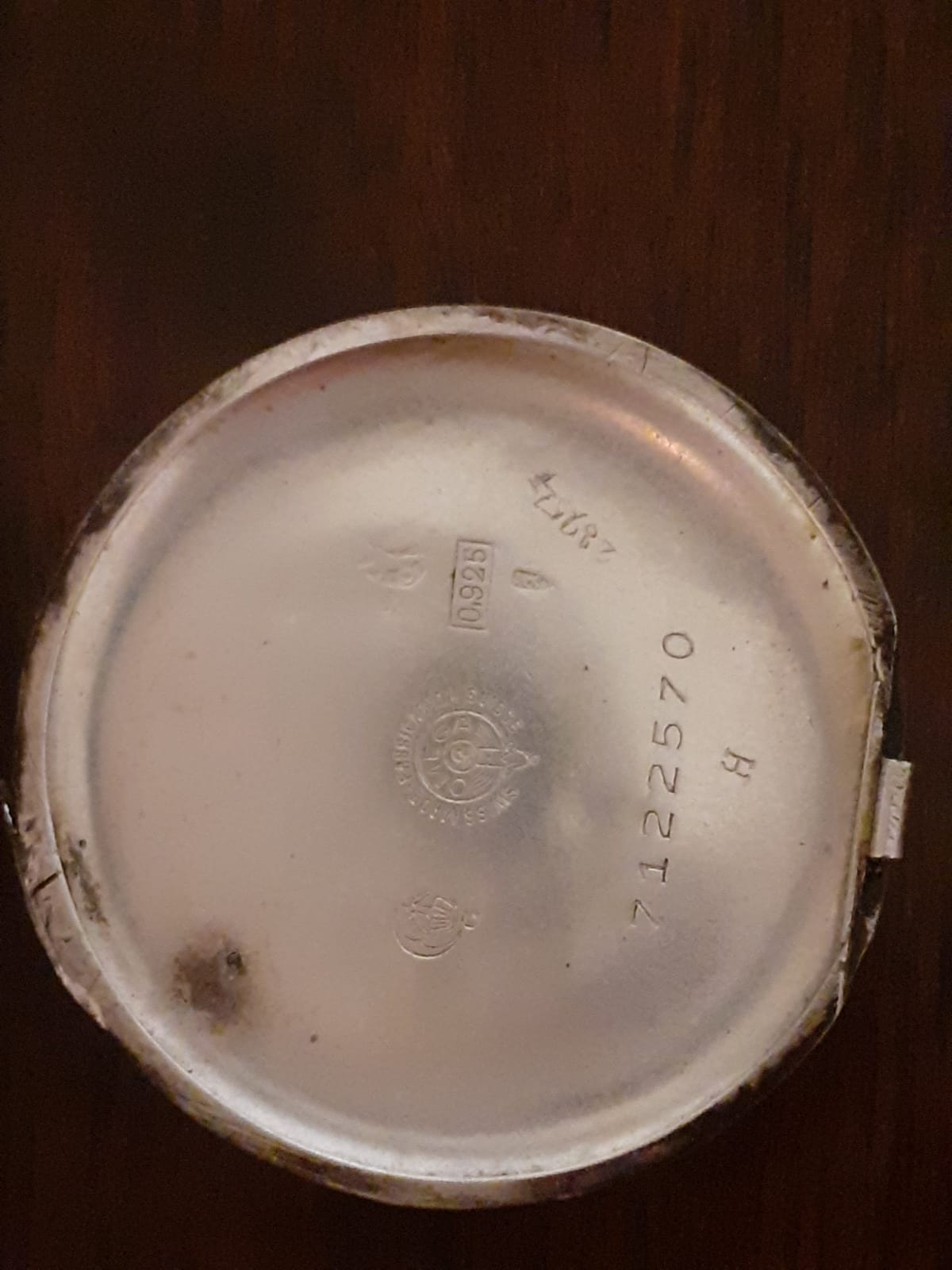

Any caseback pics?
18,326
27,695

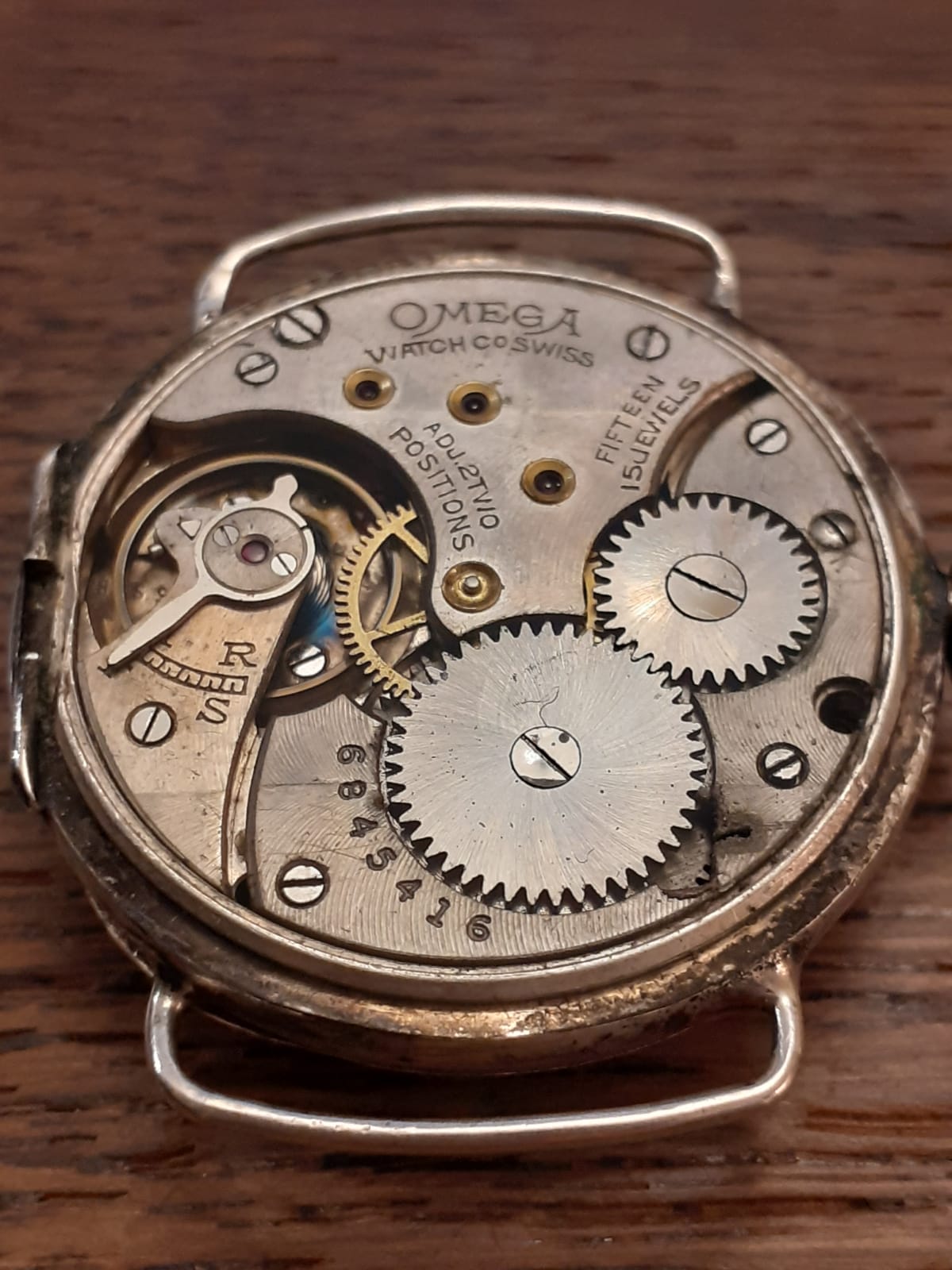

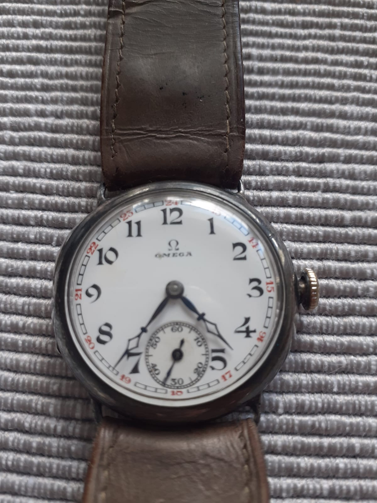

Typical fantasy piece.
old pocket watch movement in a third party case with third party dial.
case kinda presents as an old pocket watch case with braze on lugs…. But the dial is a dead giveaway.
Also please note that the 2nd picture is a different watch that has lugs with a different serial number.
both watches are in a dire need of service.

Hey gentleman's,
My mistake... Omg, there is a wrong picture... Sorry about that. I am going to make new pictures asap. ...and I will not forget glasses this time..

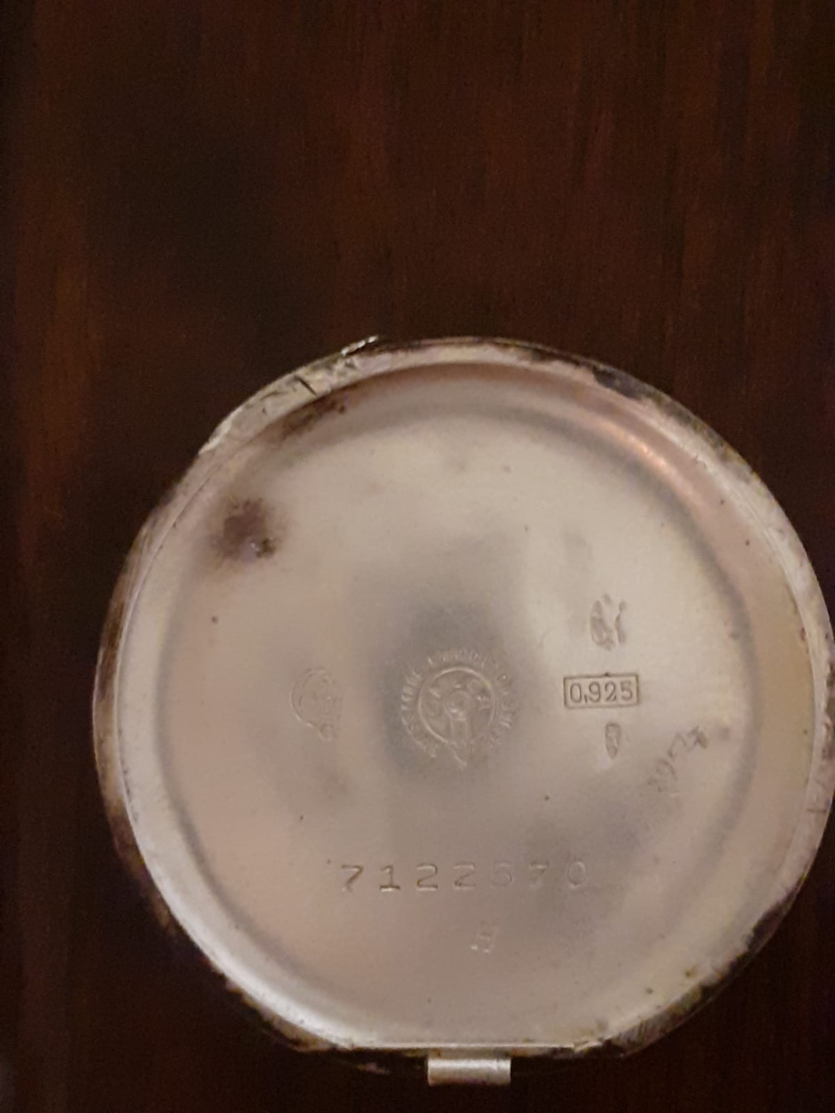

I disagree on the recased poocket watch and dial analysis. It looks like a ref 710 with 26.5 SOB, here in a 1926 German Catalog :
Dial looks correct to me (of course, as usual in this period, there were many variations and the dial shown in the above catalog was not the only one used in this reference).
I would be interested in a picture of the other watch.

ok I could be wrong. Extract time.

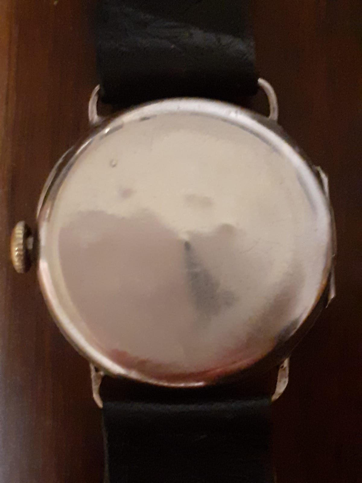

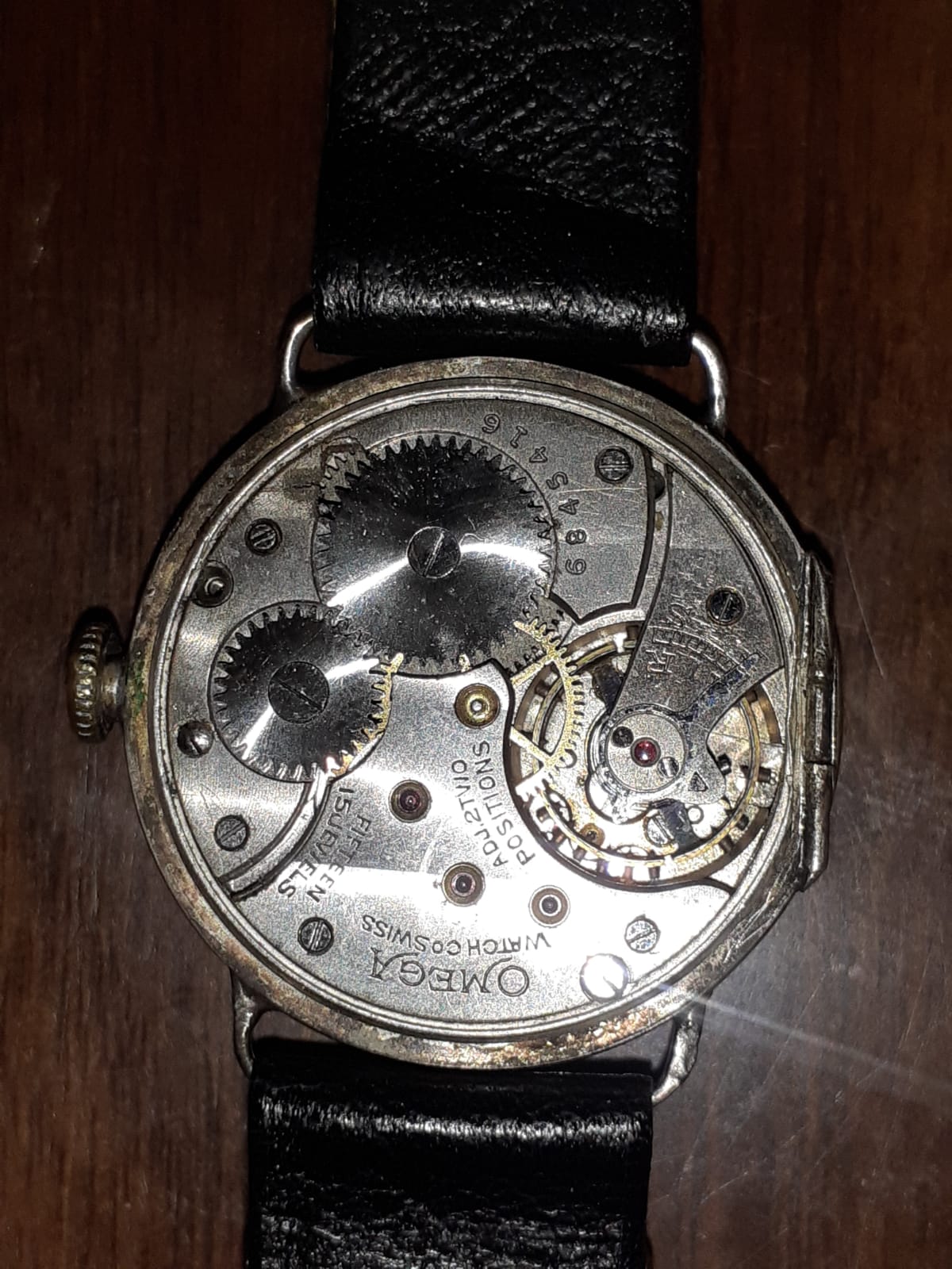

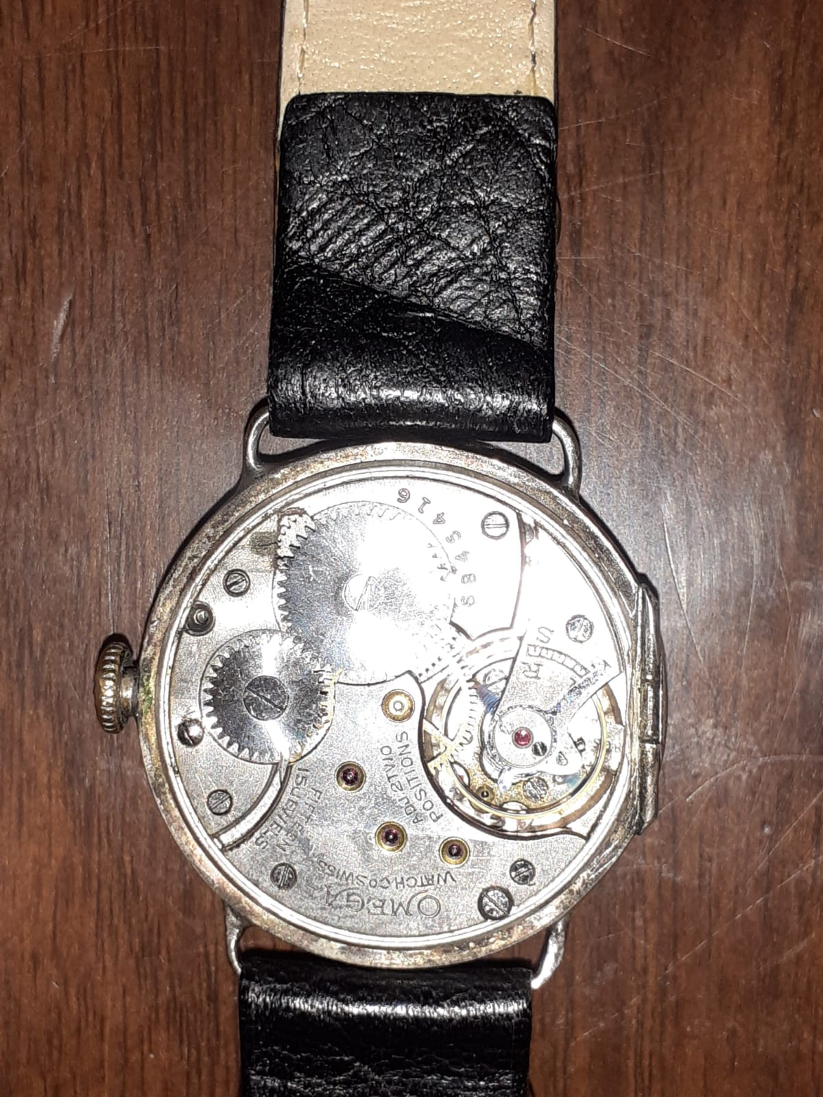

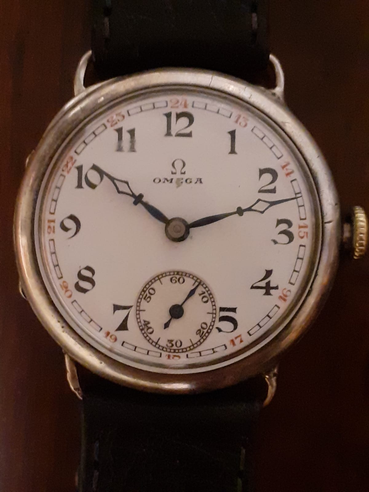

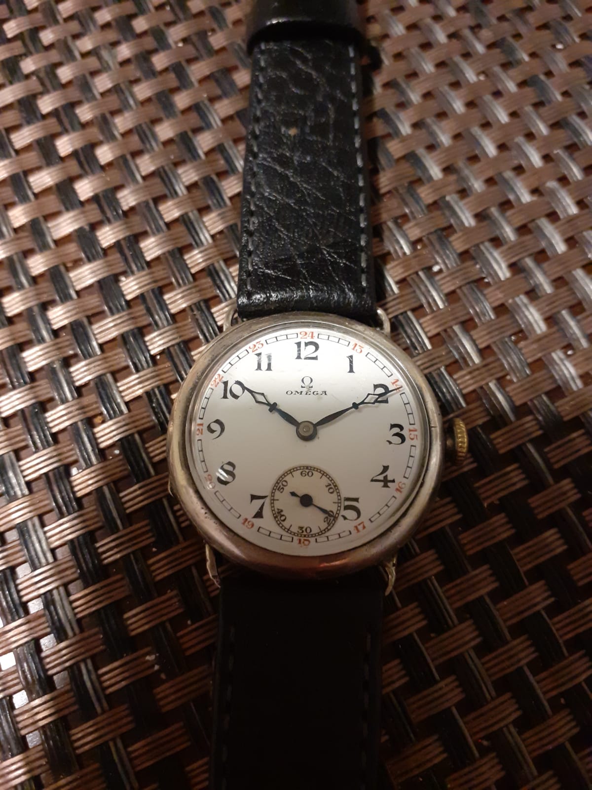

I realized that the four pictures above are actually the same watch but the pictures were taken in different time.it was confusing..
Please see more pictures bellow.
Thank you Polina for taking new pictures yesterday.
The diameter is 35mm
