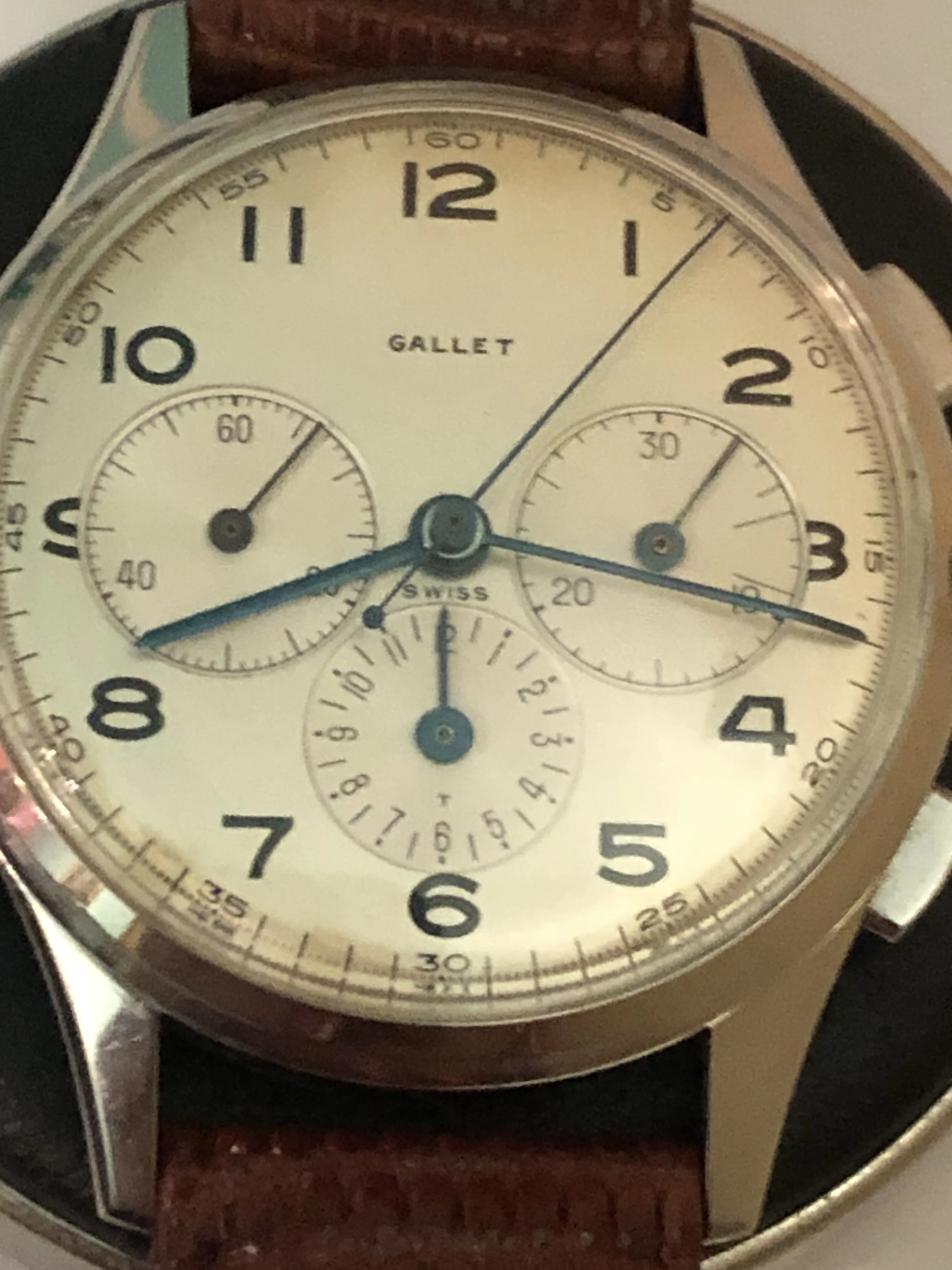

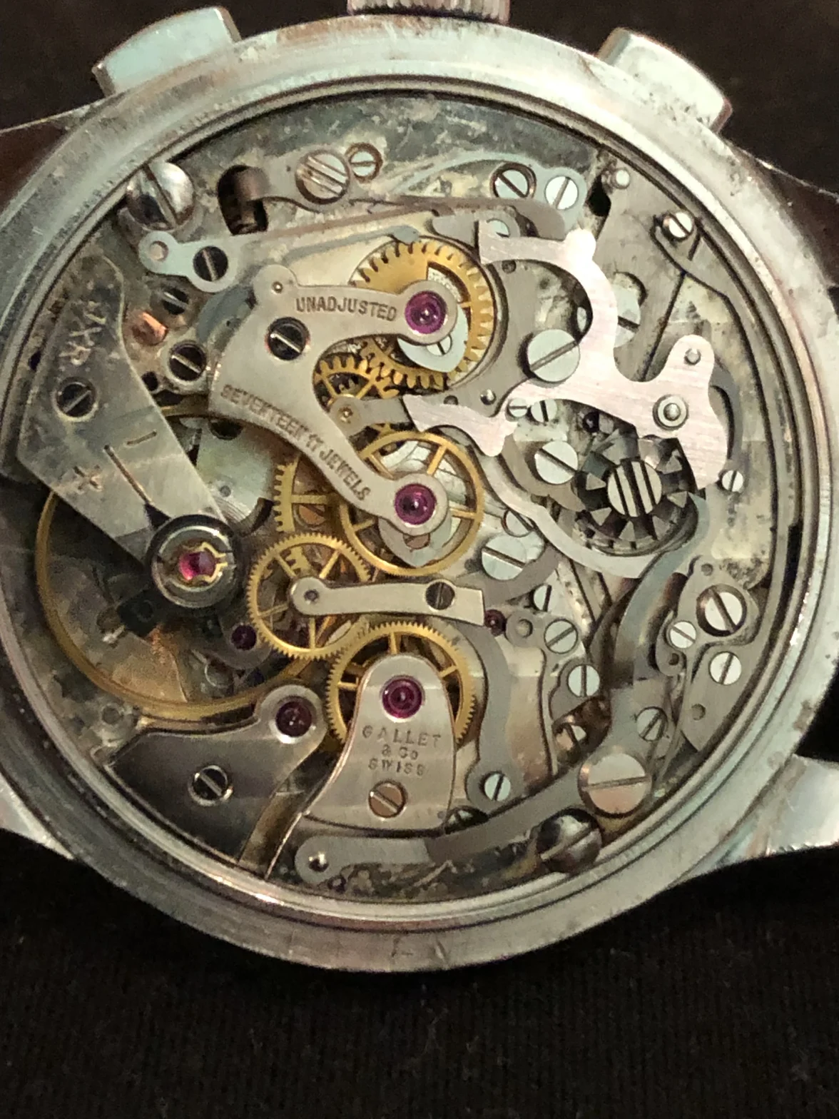

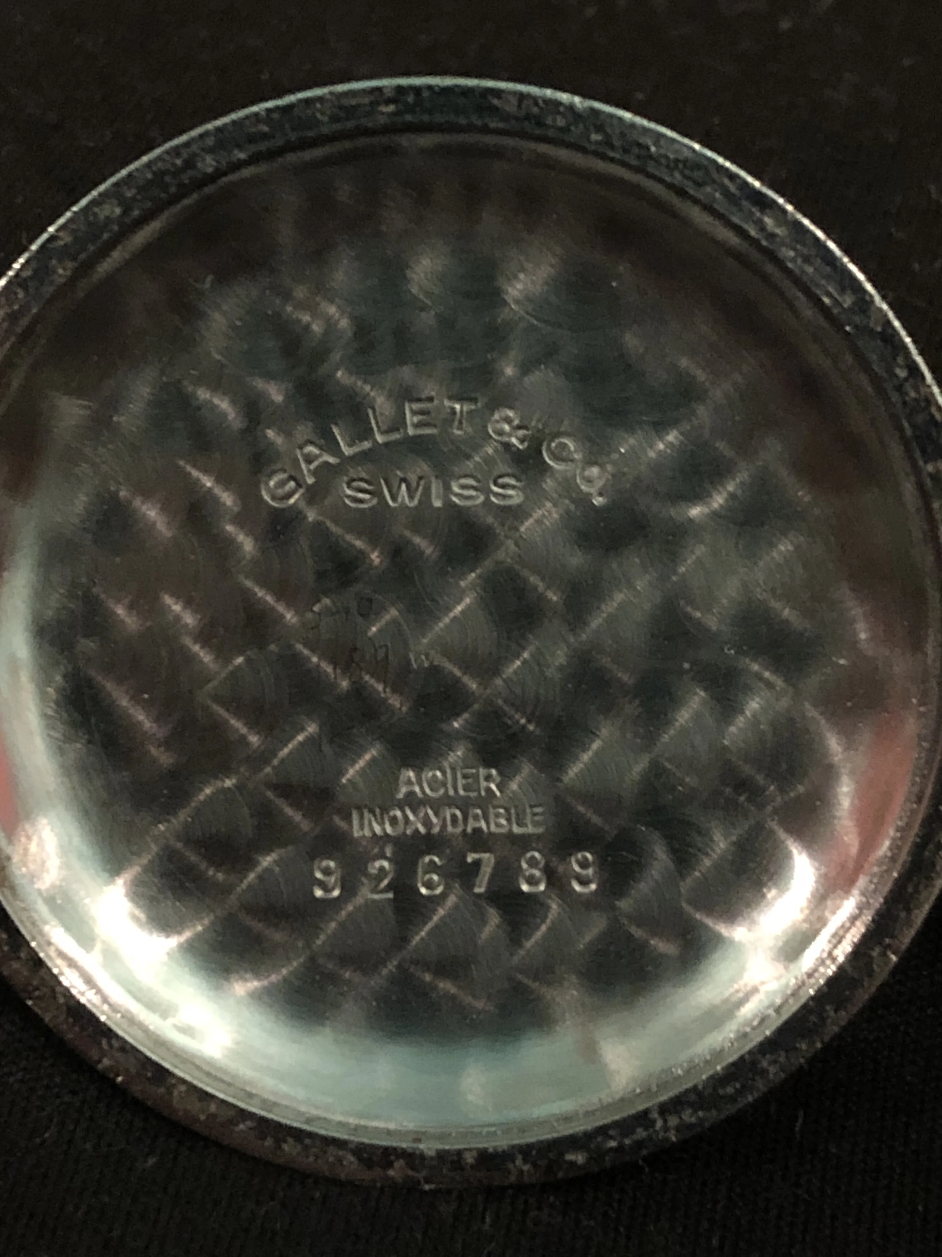

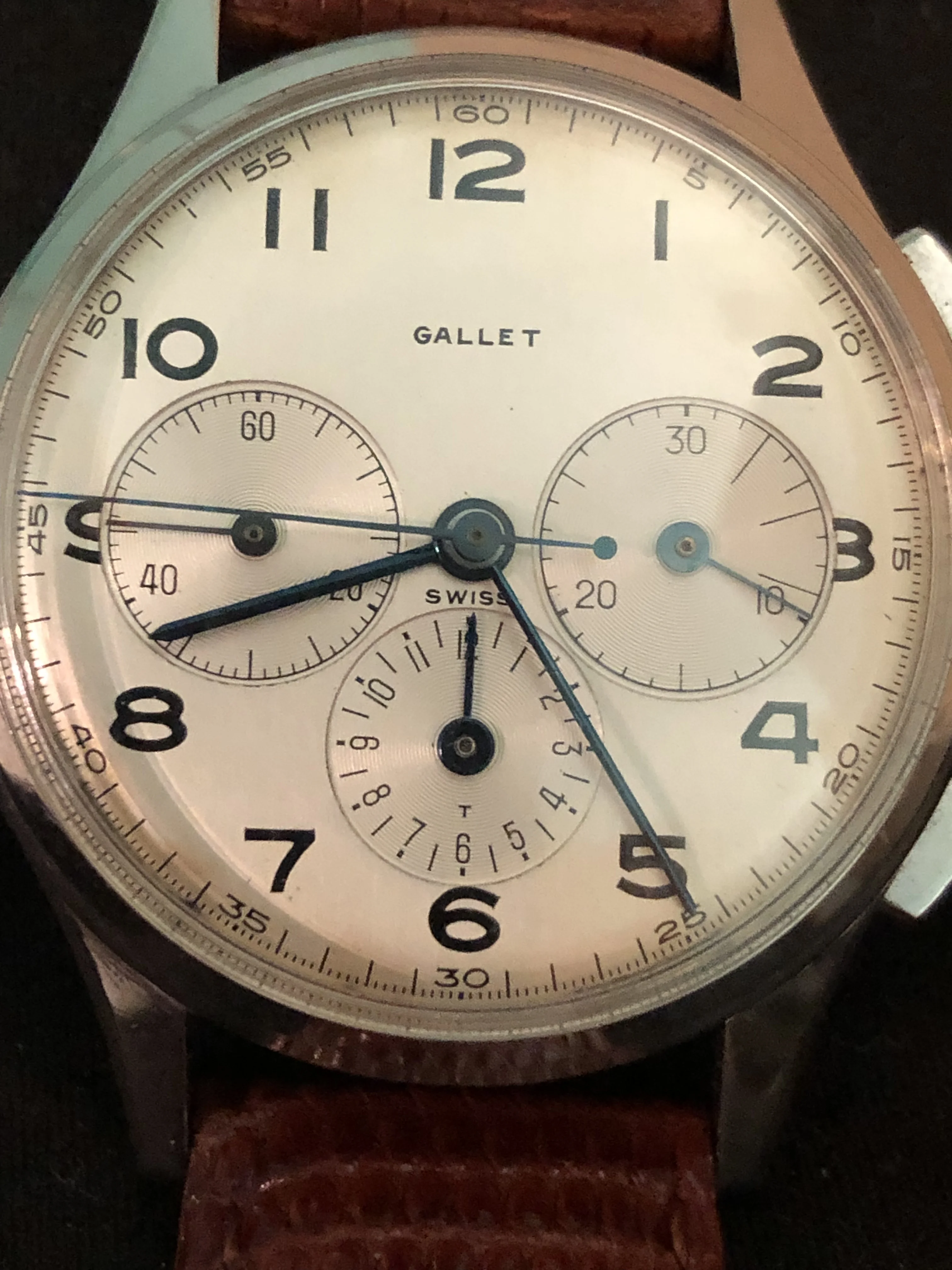

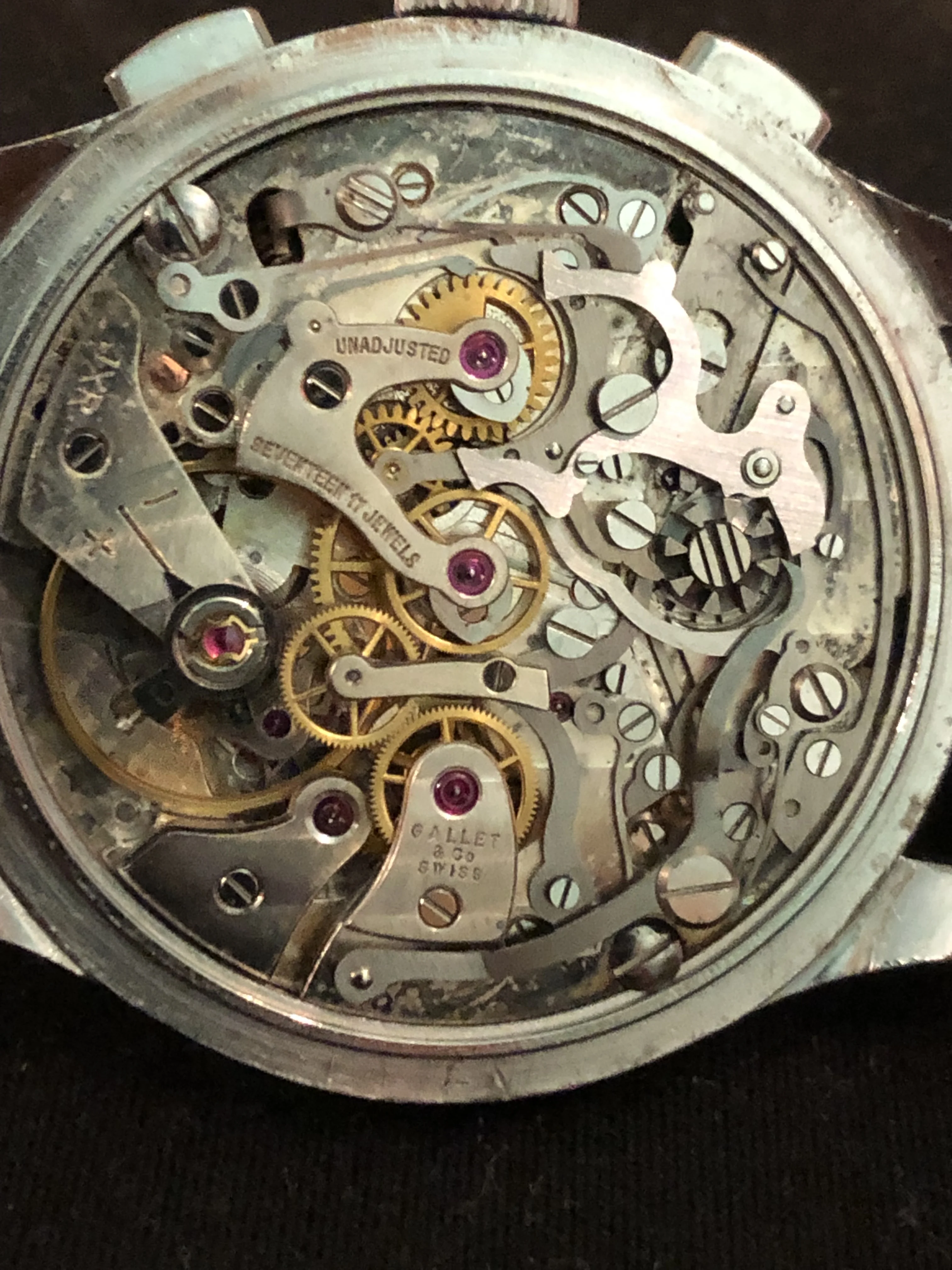

hello members , here I have my gallet chrono that is waiting long, long time to be enjoyed , trying to figure which model this is and especially what movement this is, as it doesn’t have any movement markings , your input will be greatly appreciated , I just would like to know what this is , purchased many many years ago , I liked the look of the watch so couldn’t help no get it ,🙃thank you, hope I’m not getting in trouble , by posting none omega watch here, good evening everyone, regards , kazd

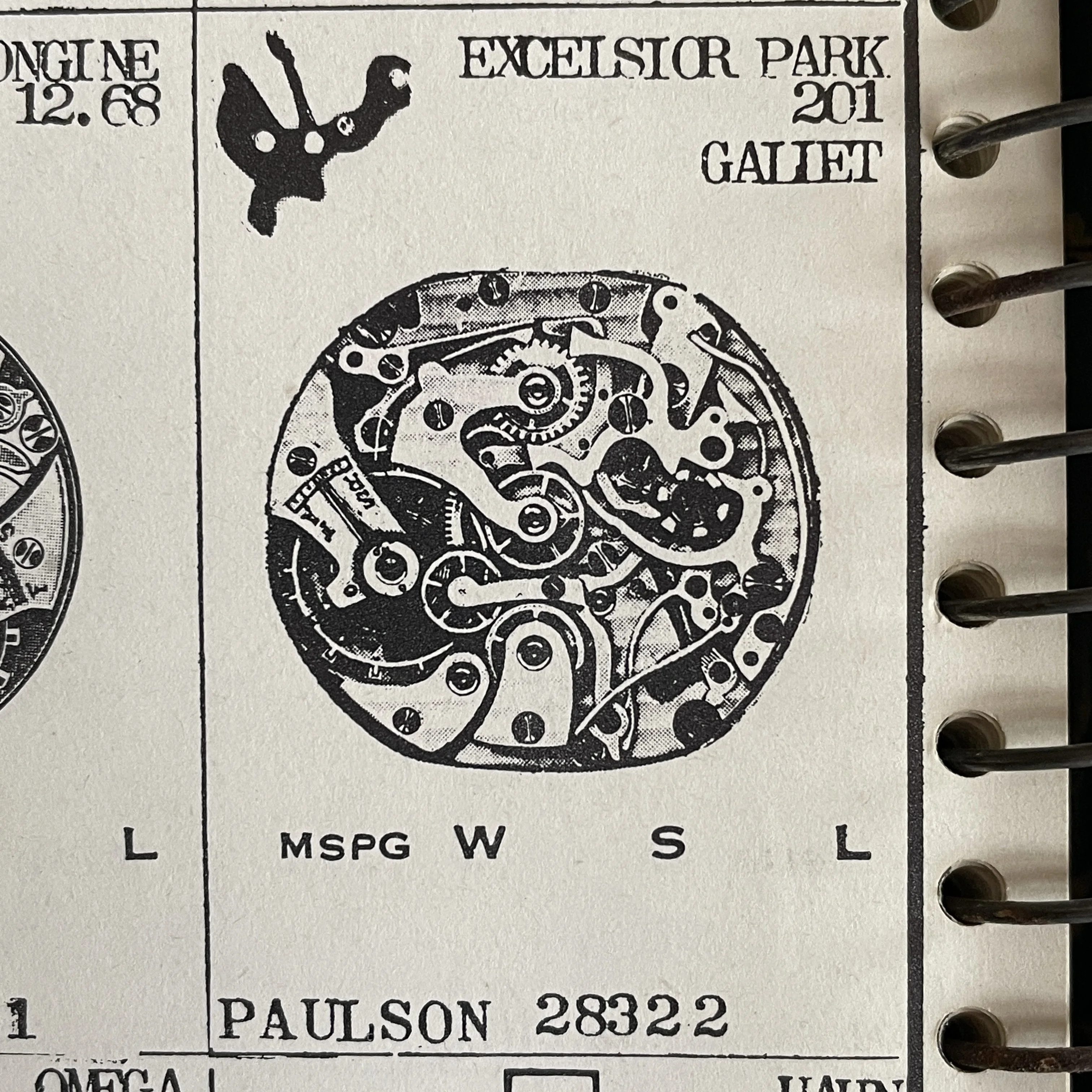

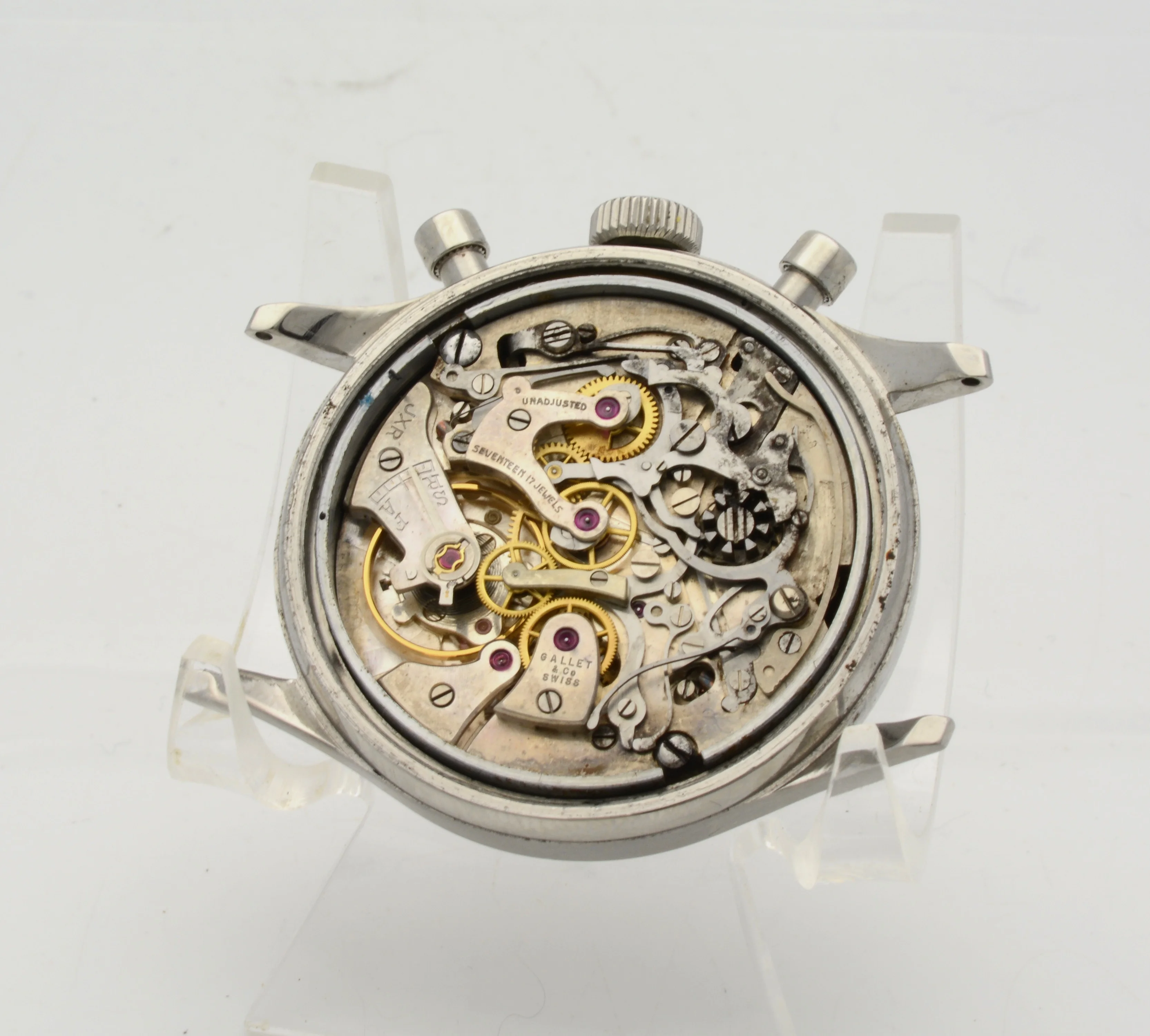

It shares some Lemania similarities (Chrono bridge on the left, balance below etc).
Closest I could find with a quick search is an EP 201, not identical, but there are familial similarities.

Excelsior Park for sure
Good morning, thank you for your research , to be honest ,I didn’t know where to start , the movement is so incredible to look at , it looks more pristine in reality than in the pictures, when I opened the caseback couldn’t take my eyes off of it, and the way it works , so smooth , especially the pushers , oh just pure pleasure , besides , I have many, many chronos , mostly 321 family 😊 but this one it feels somewhat different, thank you again , if I may ask , how about the dial ? it doesn’t have the tahymeter scale , thanks , good day , kazd

EP 4.0
Good morning and thank you for your research and reply , I don’t know anything about this movement , except that it’s a pleasure to look at , my 321 family chronos are fun but this one , somehow it’s a different feeling, question ? Is this a good movement , maybe worth to dig deeper into it since I have the watch and I intend to keep and enjoy it , the case is not waterproof,so have to be careful , I keep all my watches with plenty of humid absorbing silica around , this maybe a Sunday watch to wear lol, regards , love you guys , good day , kazd
Good morning, thank you guys soooo much for taking the time to help me on this , truly appreciate, before I close this chapter , is this a good movement ? and how about the dial ? doesn’t have the tahymeter scale , thank you again , regards , good day , kazd
It’s a sought after movement. Multichron 12hr EP 40. Sadly your pics are terrible. Is the dial stained or is it shadow? Looks like the case is rough. Better pics in sunlight might be helpful. There used to be a decent website on vintage Gallet. It seems to have vanished with its aquisition by Breitling.
good morning, thank you for your reply , and sorry for my armature picture taking , still working on this 😊 the dial is perfect clean not stained , it is a shadow from the light above, also much shadow distortion of the movement ,case is clean , sharp , minor hair scratches, thank you for the info. glad to know now that this movement is a valuable , the dial doesn’t have the tahymeter section around , not sure if this is just variant of the dial, will try to take better, detailed pictures. by the daylight , it is a truly stunning watch , I got it from collector in Canada , came fresh out of his watchmaker’s shop after complete service, I really admire the look and feel of this movement , besides the family of 321s that I have 10 of them , best regards , good day , kazd

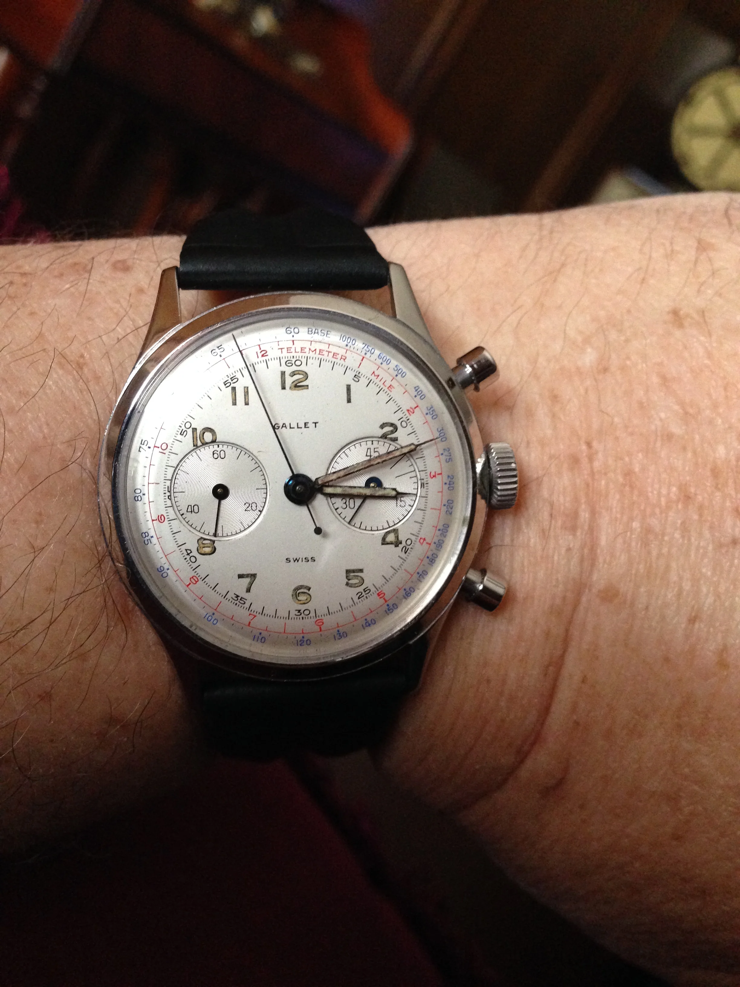

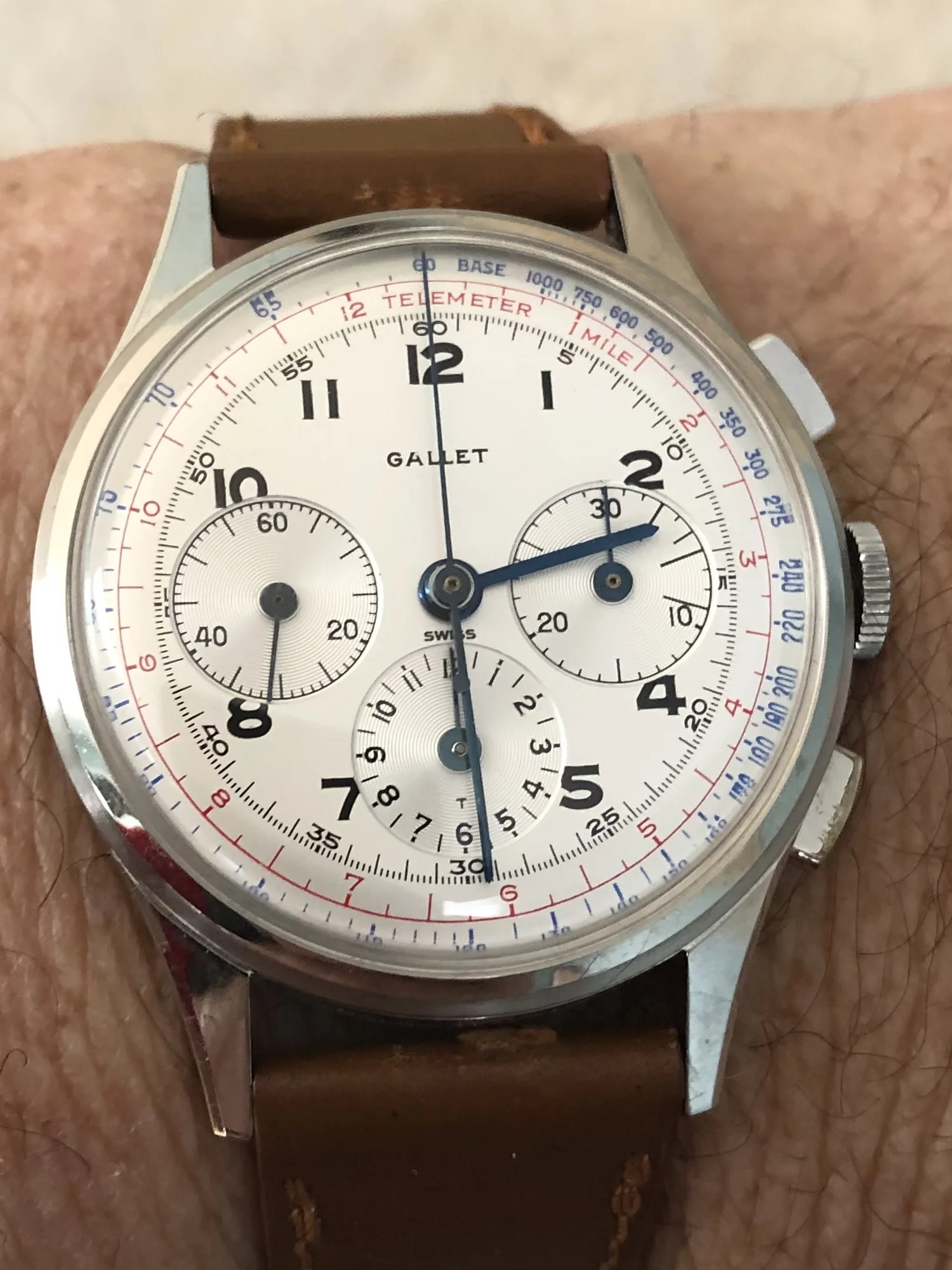

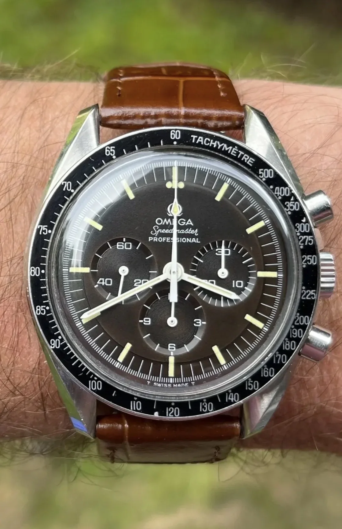

That movement looks pretty dirty. I’d question the claim about it seeing a “watchmaker “ …My watch …
hello and that is one gorgeous gallet, congrats, that what I was told by the collector that I got it from, I’ll take some better pictures hopefully , without the shadows 😊 again thanks , and question , mine doesn’t have the tahymeter outline on the dial, thank you, enjoy your stunning gallet , good day , kazd
