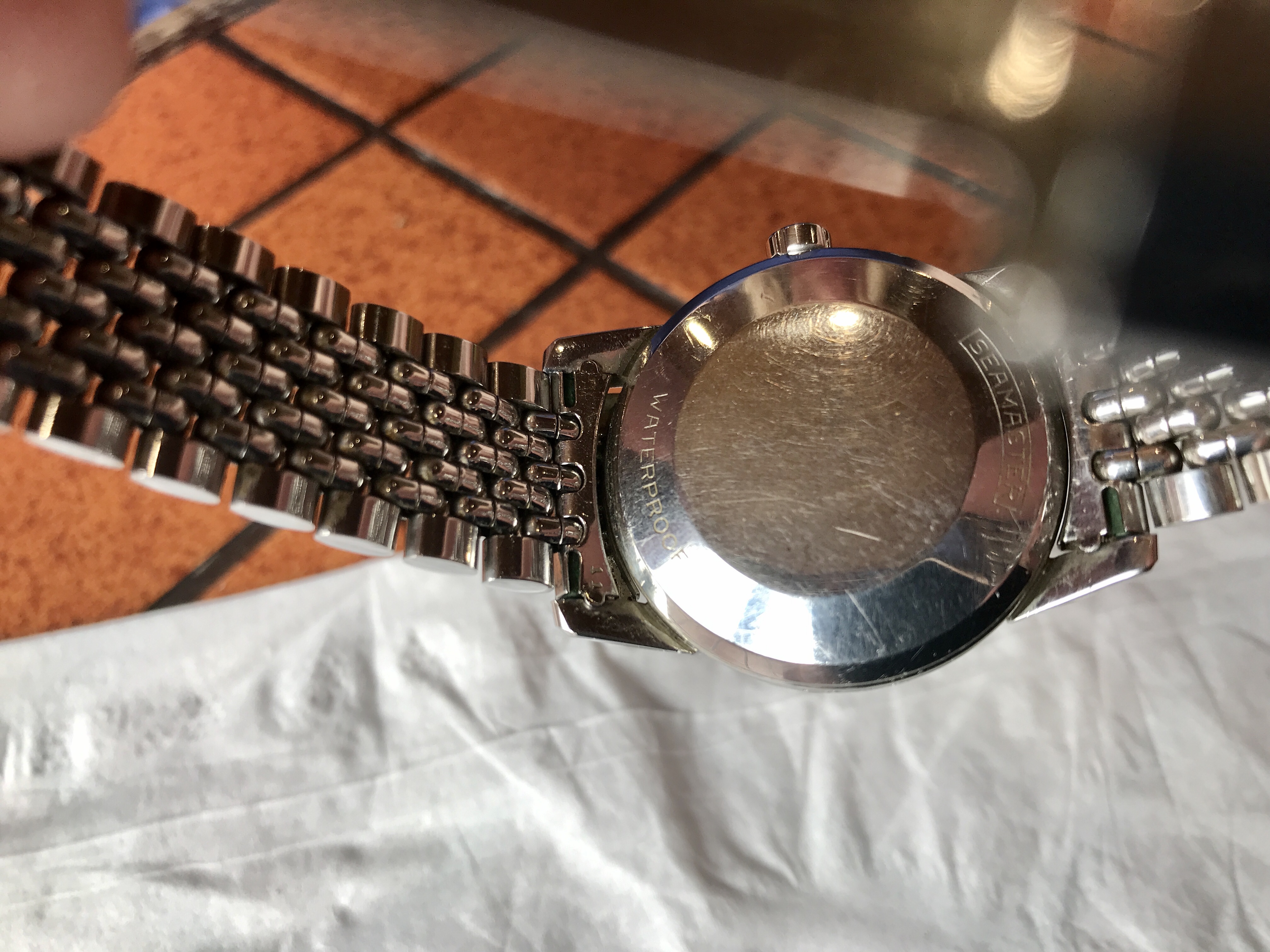

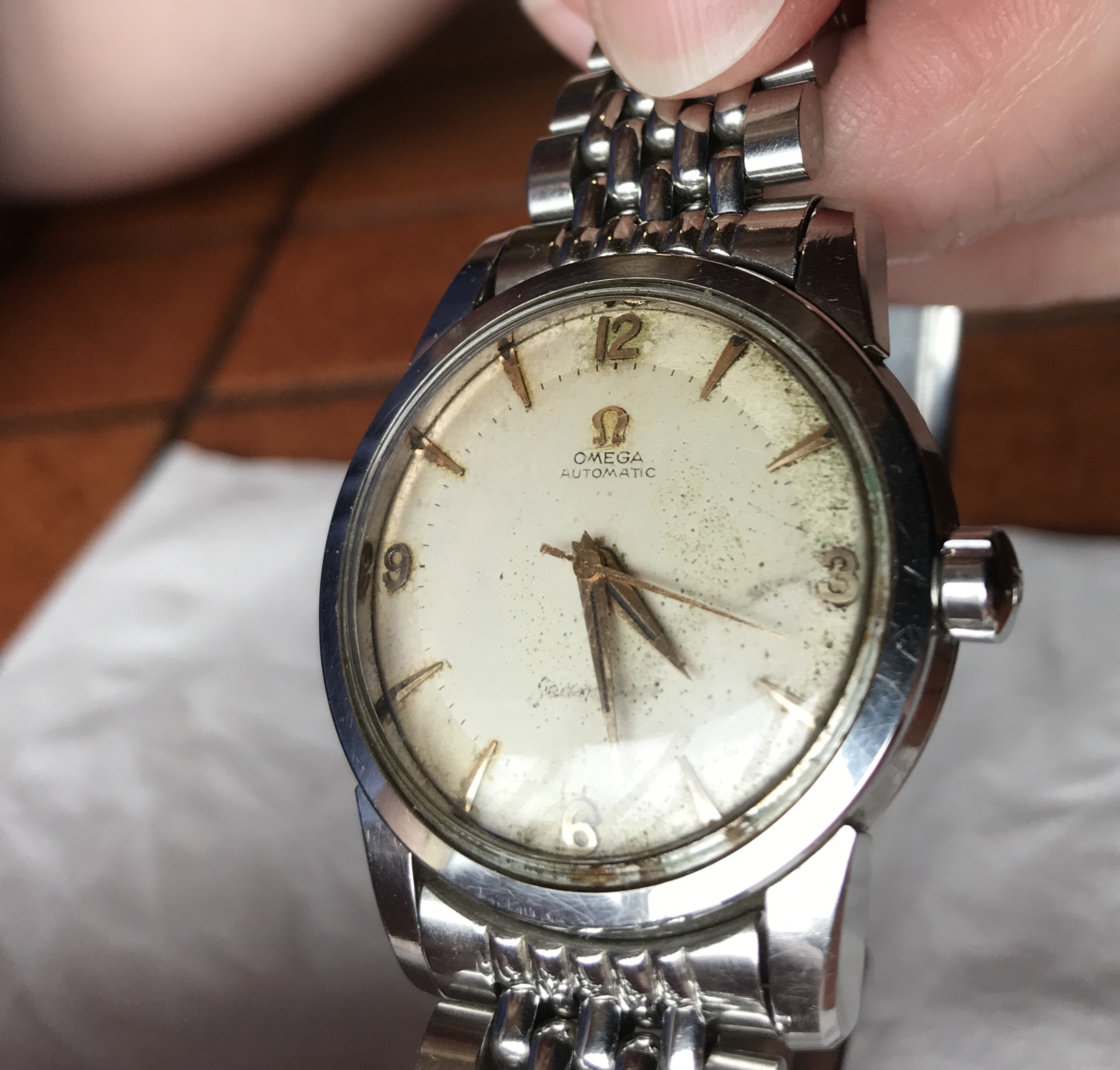

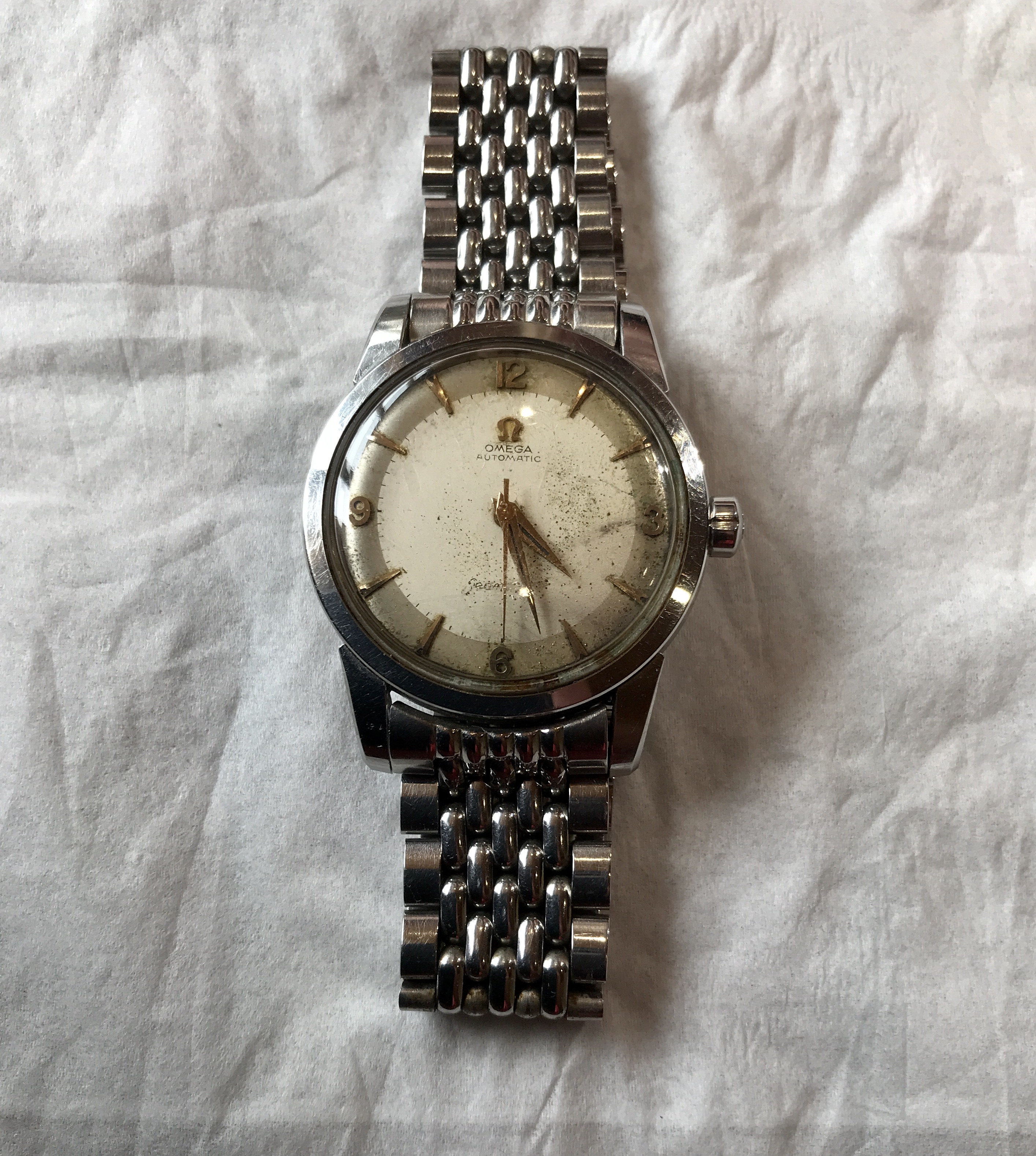

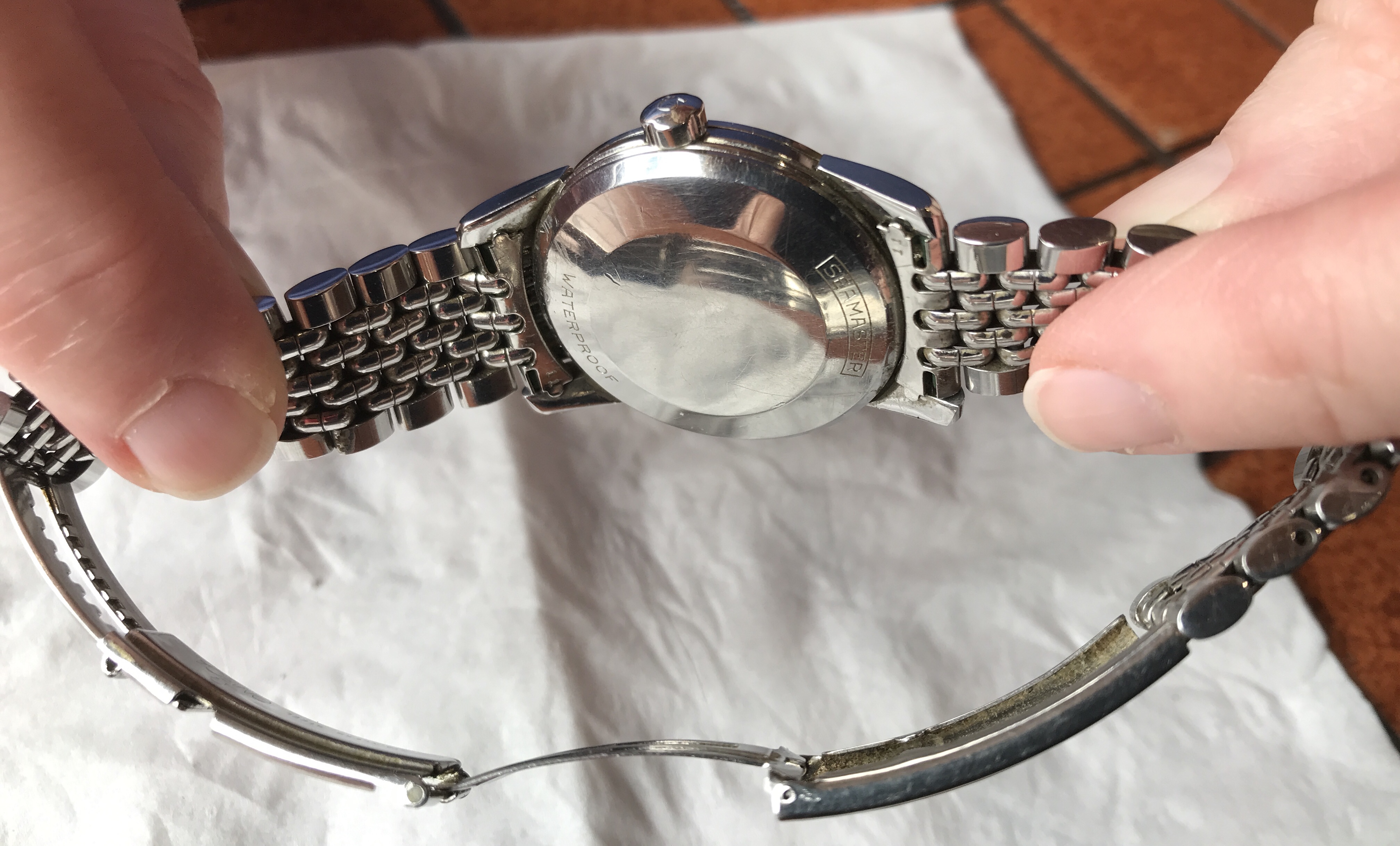

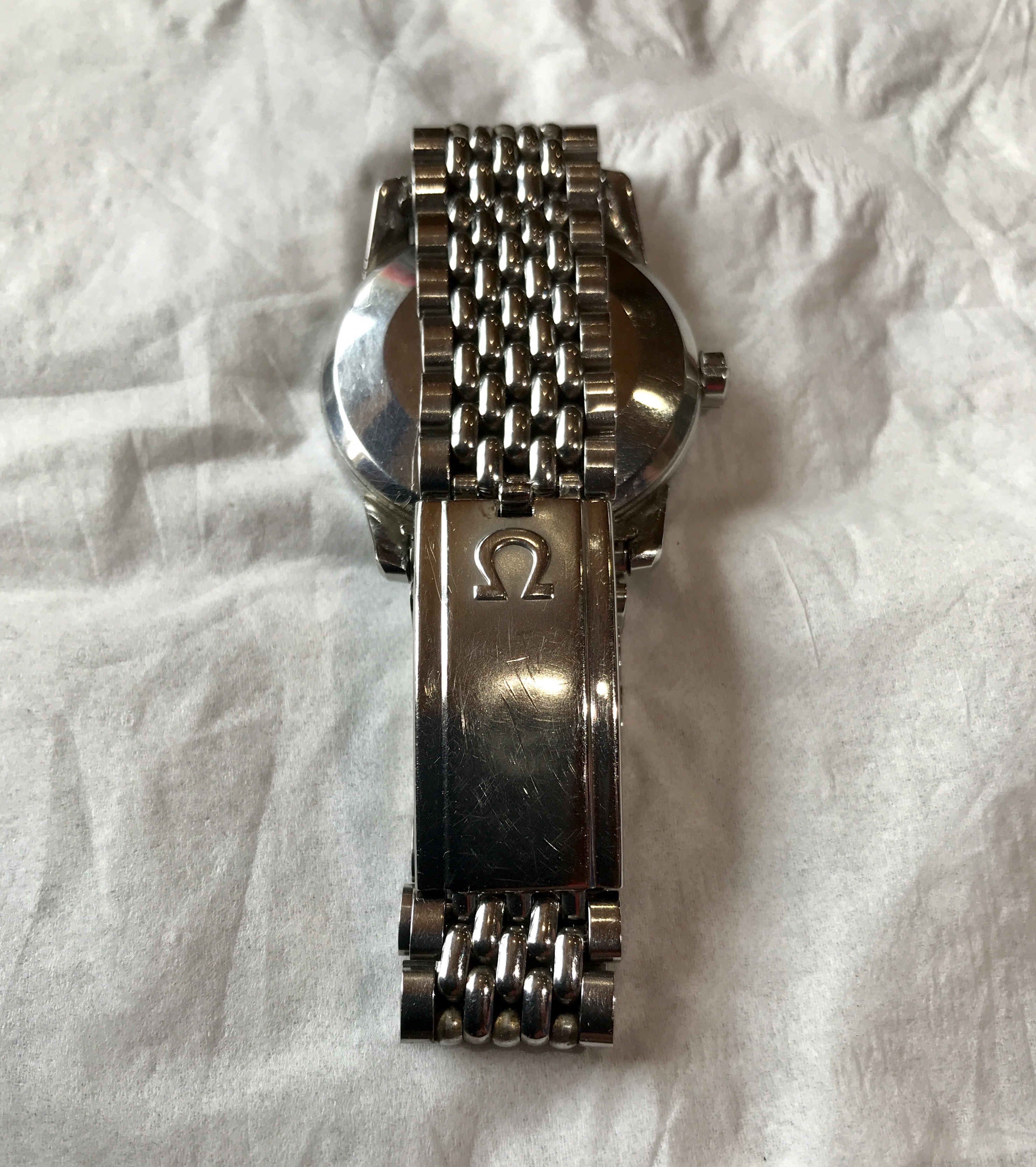

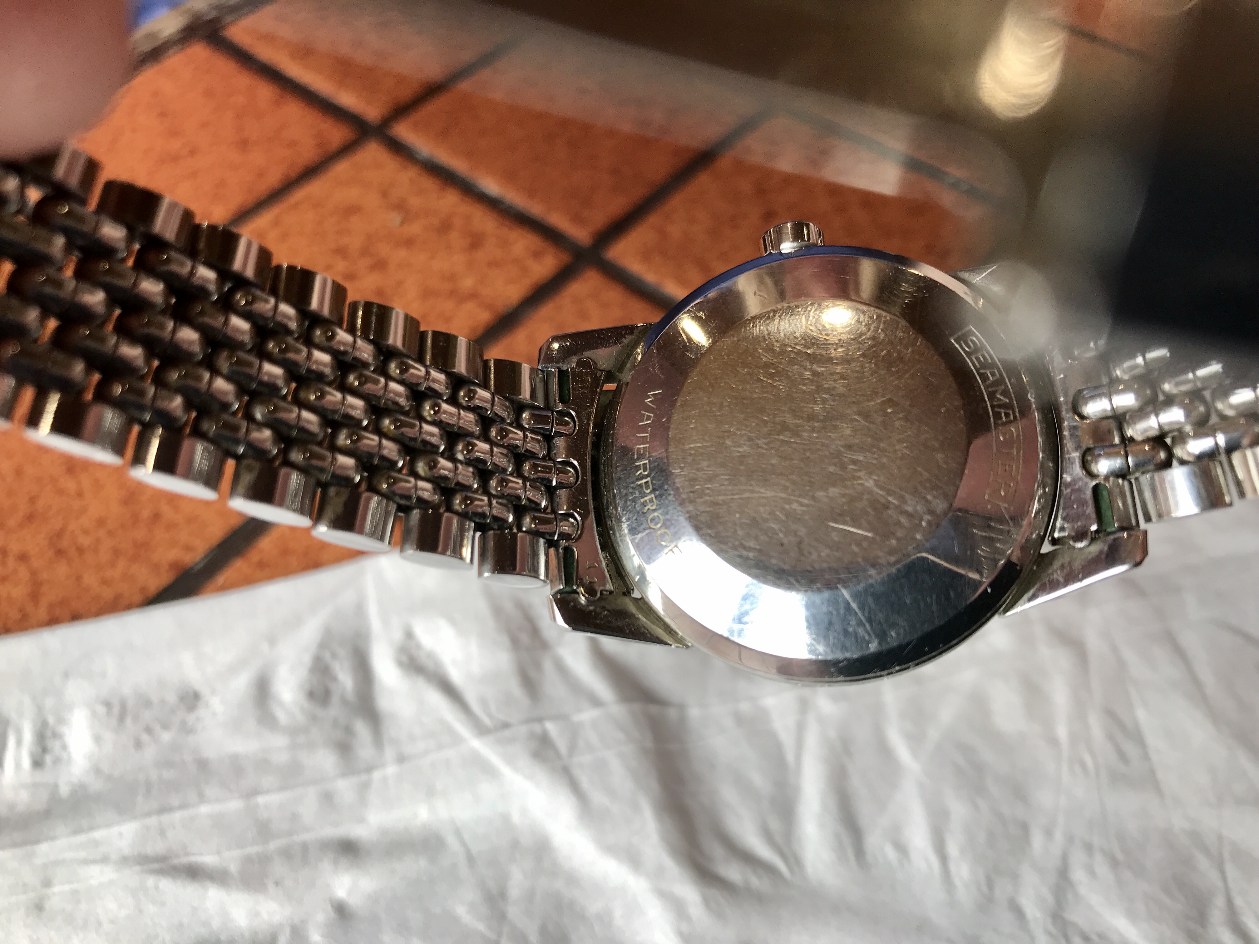

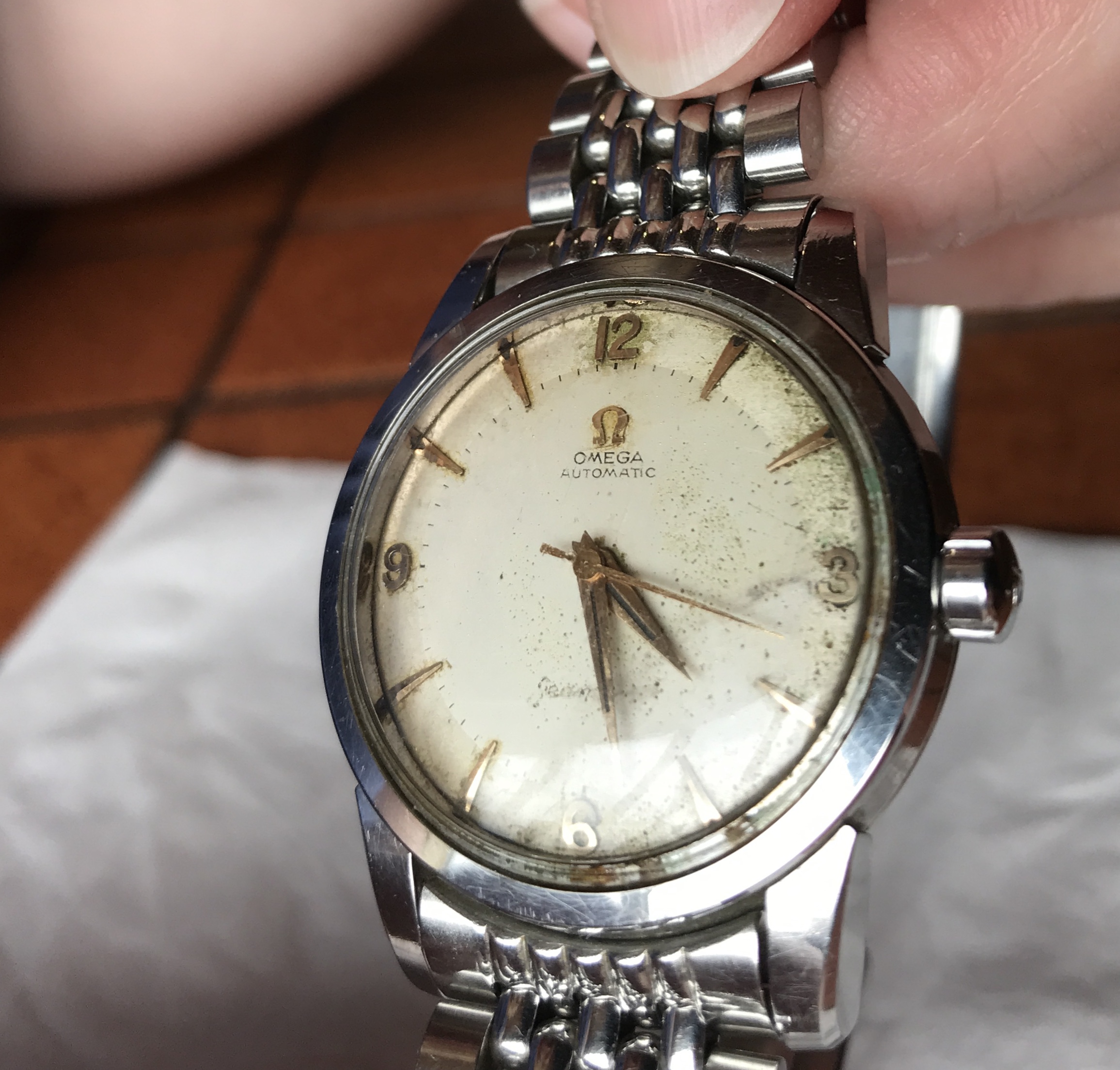

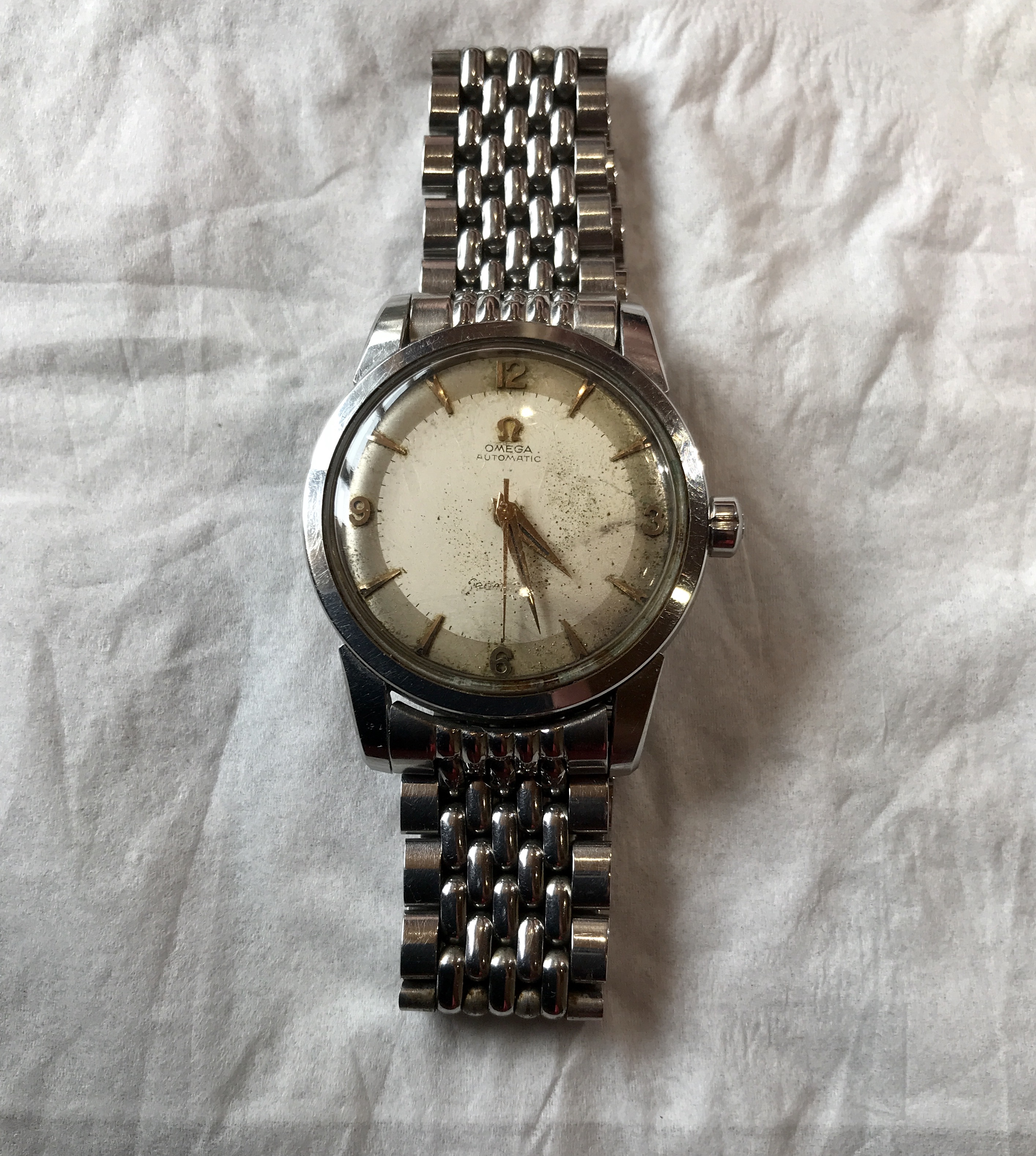

Hello,
My wife recently found a watch that belonged to her late father which looks like an old Omega Seamaster. We have no idea if it’s a genuine watch, there’s no paperwork, or box. Father in law either bought it in the late fifties, early sixties, or it might have been his father’s we just don’t know. We do know was in the RAF, stationed in Hong Kong in the sixties, and before that Gan in the Maldives. He wasn’t a high ranking officer, so if these were expensive items back then, it’s possibly not a genuine Omega watch.
If you can perhaps help, it would mean a lot.
Thanks!
24,836
55,255

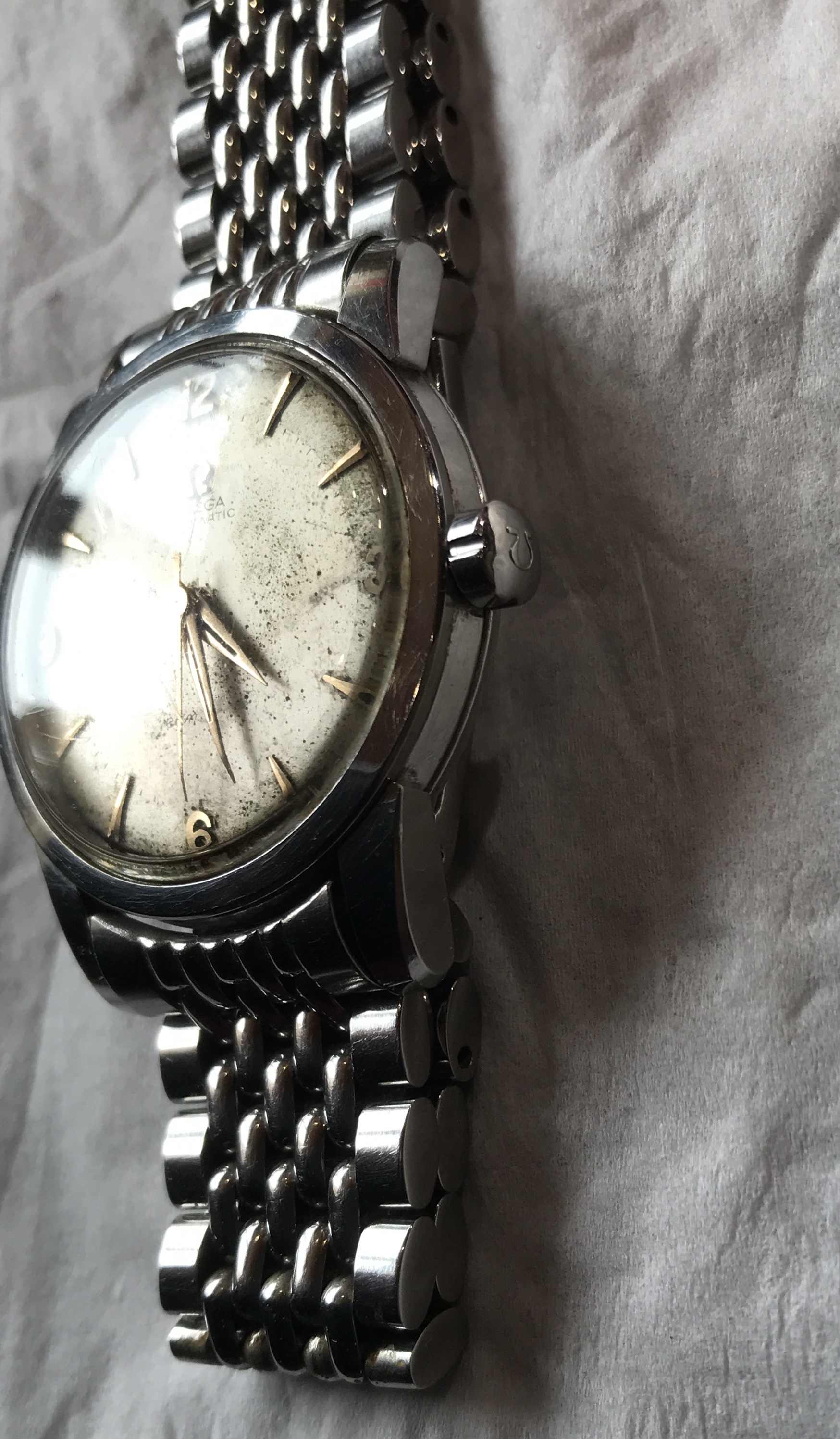

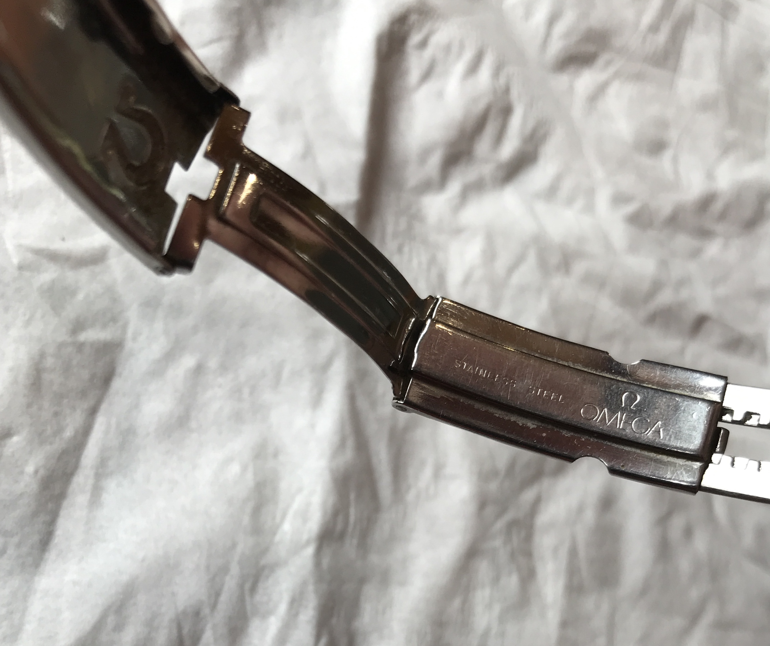

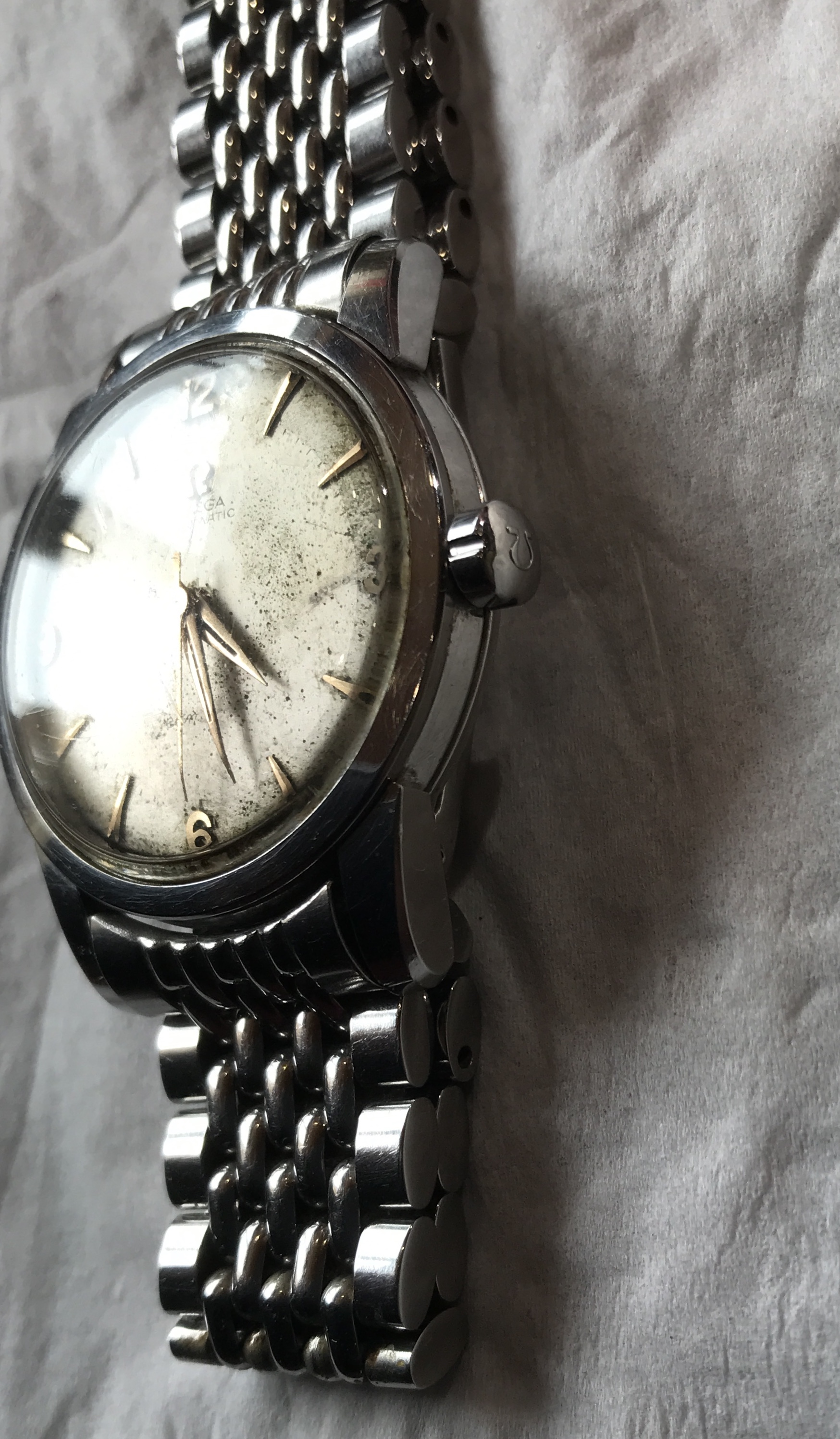

Looks totally legit to me, including the bracelet. There will be a reference number inside, but opening it is probably a job for a professional in this case. However, other members may be able to figure it out just by looking at the shape of the case. You provided good photos.
The damage to the dial is probably due to moisture that entered through a failed crown seal, so there may be some corrosion in the movement as well. You should probably avoid using the watch until it can be cleaned and lubricated by a watchmaker.
10,804
16,814
Most likely it is model 2846 from circa 1958-9. It looks perfectly genuine if a little worn. The bracelet may be slightly later, but its a good choice for that model, indeed I added one to mine.

Looks nice and original, especially with the original bracelet. A basic service on the movement would make for a lovely family heirloom that could be used for many years to come. The dial is slightly damaged, but you get a lot worse and it wouldn’t bother me that much. I would expect it’s something like a ref 2846 with a 501 cal. movement inside.

Lovely piece! Depending on how large your wife’s wrists are, the bracelet can be resized by removing a few links down to about 6-6.5”. If her wrists are smaller, these look stellar on leather (quality short straps are out there) and swapping it to a strap it a 2 minute job.

The adjustable-clasp BOR ("beads of rice") bracelet is a nice item to have.
You don't say how you feel, aesthetically, about the condition, but I think you shouldn't ask or want to have the dial cleaned. These watches are sought after by collectors in large part because the design has proved to look beautiful and work perfectly even as the dial ages. Hopefully your wife will agree with Dan S. that the dial tells a story that shouldn't be erased. It looks like a great watch.

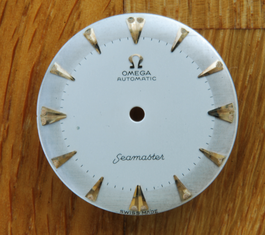

If you must have the dial improved (and I would want that myself), then there are a couple of restoration companies that will redial your watch to a much nicer look. Of course, it will always be a redial from that point and that would knock the collector value dramatically but, I suppose that is unimportant to you. I very much doubt that cleaning and re-lacquering will improve the dial at all and will probably destroy the text.

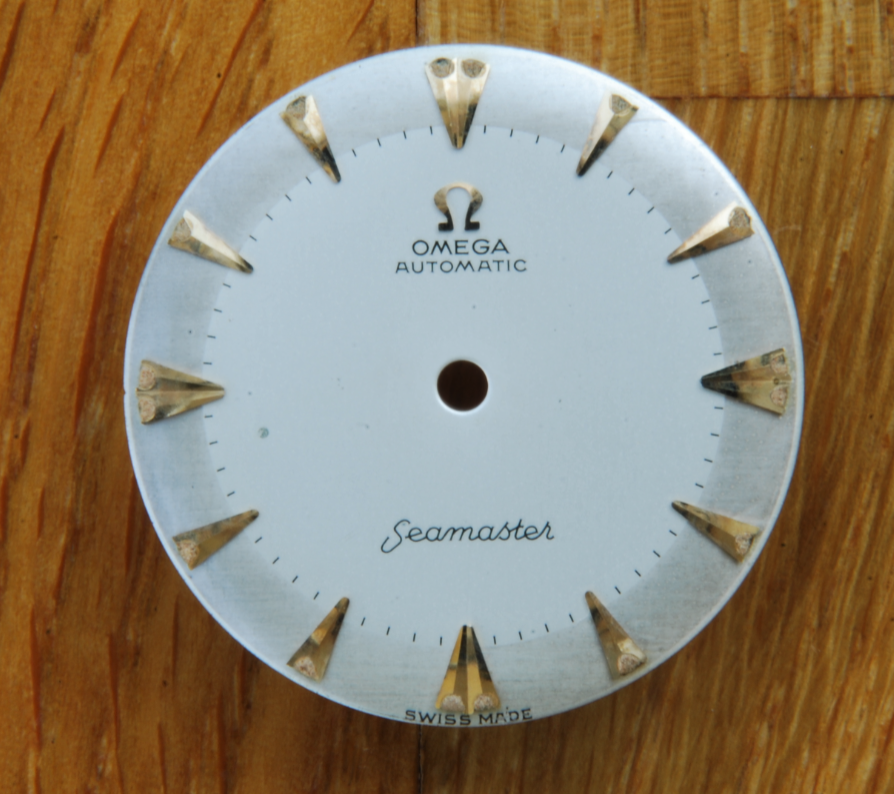

Coincidentally, I was looking through a spare parts box the other day and saw that I have this original Omega dial. I just looked at it and it's for a cal 501. You would only know about the diameter of the dial when it's opened to confirm it will fit your case though and that would also confirm it's a 501 in your watch.
Good luck, Chris
