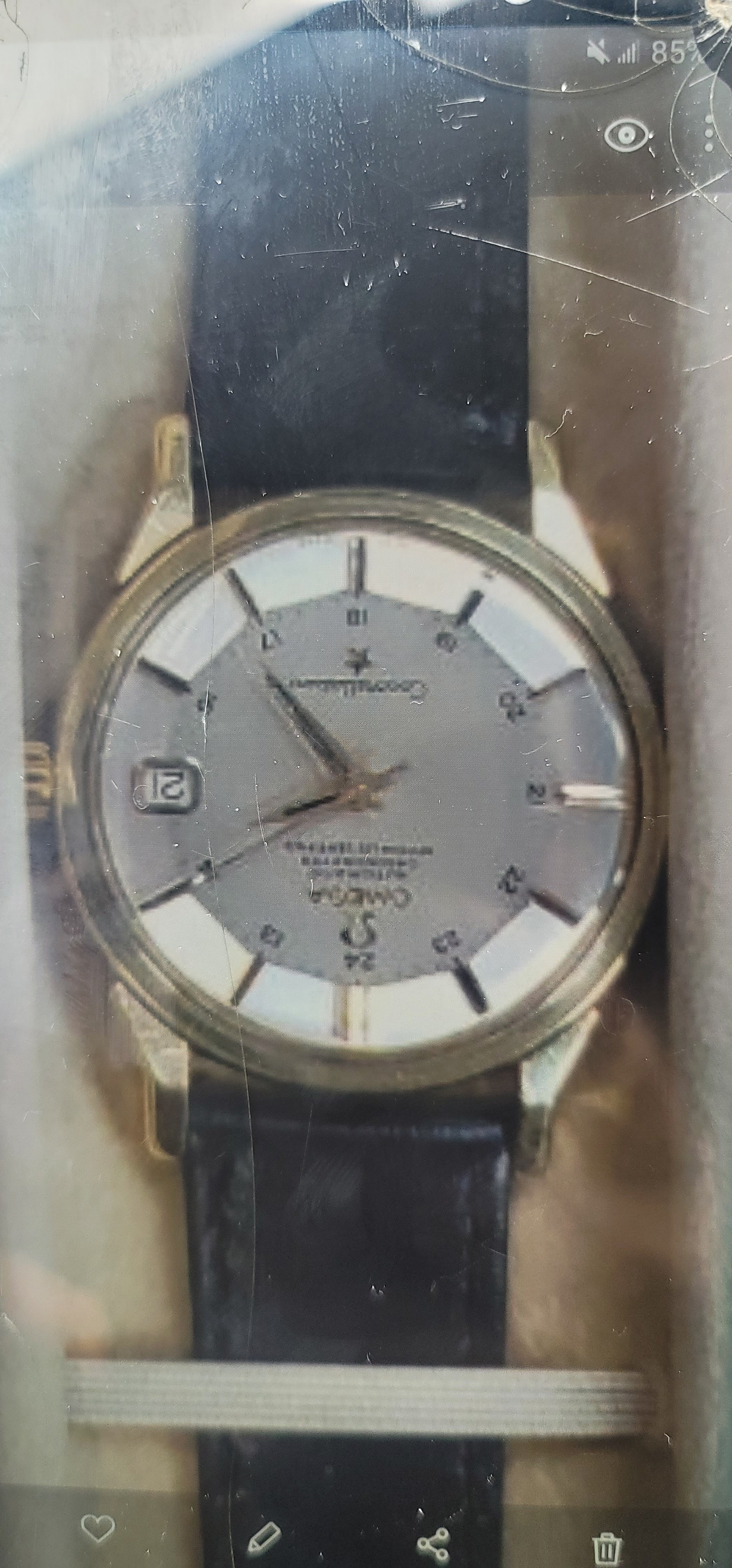

I'm about to buy a constellation pan pie from a watch repair store. I'm a little skeptical if it is real or fake.
I notice that on the dial there is 24hr numbers and from all the research I have done and countless youtube videos, none have these same markings.
Please help me make a decision.

Did you take that picture from the other side of the street?!
Even from that terrible photo it can be seen to be a redial.

Looks fake. Regardless, you should never buy a watch based on one low quality photo.

I’ve never seen one of these with those numbers on the dial. At this point I would walk away, close the web page, look elsewhere. Number on the dial more than likely are not original.

Thank you so much for all the quick replies,
The picture was sent via text message to me, looks like it was taken through a display case.

At the very least the dial has been horribly refinished and the case heavily polished.
Glad you asked first, run away from this one.
