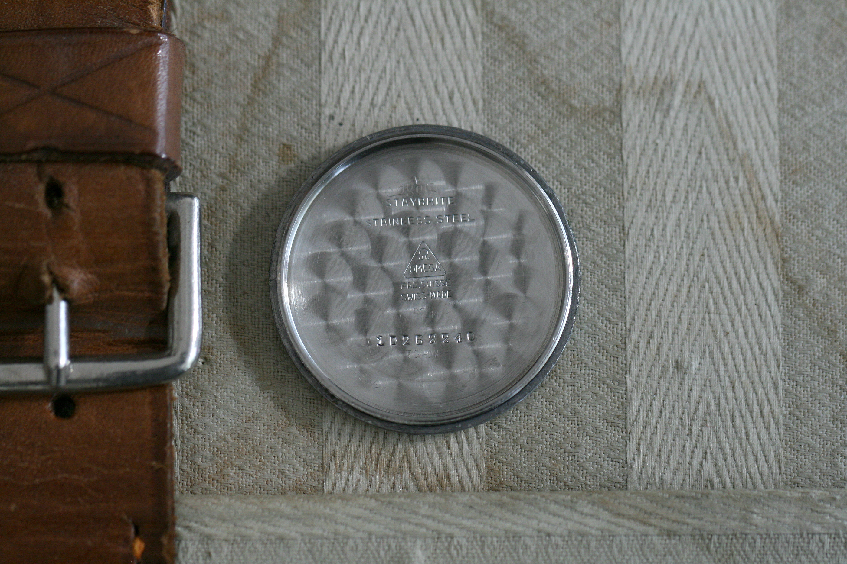

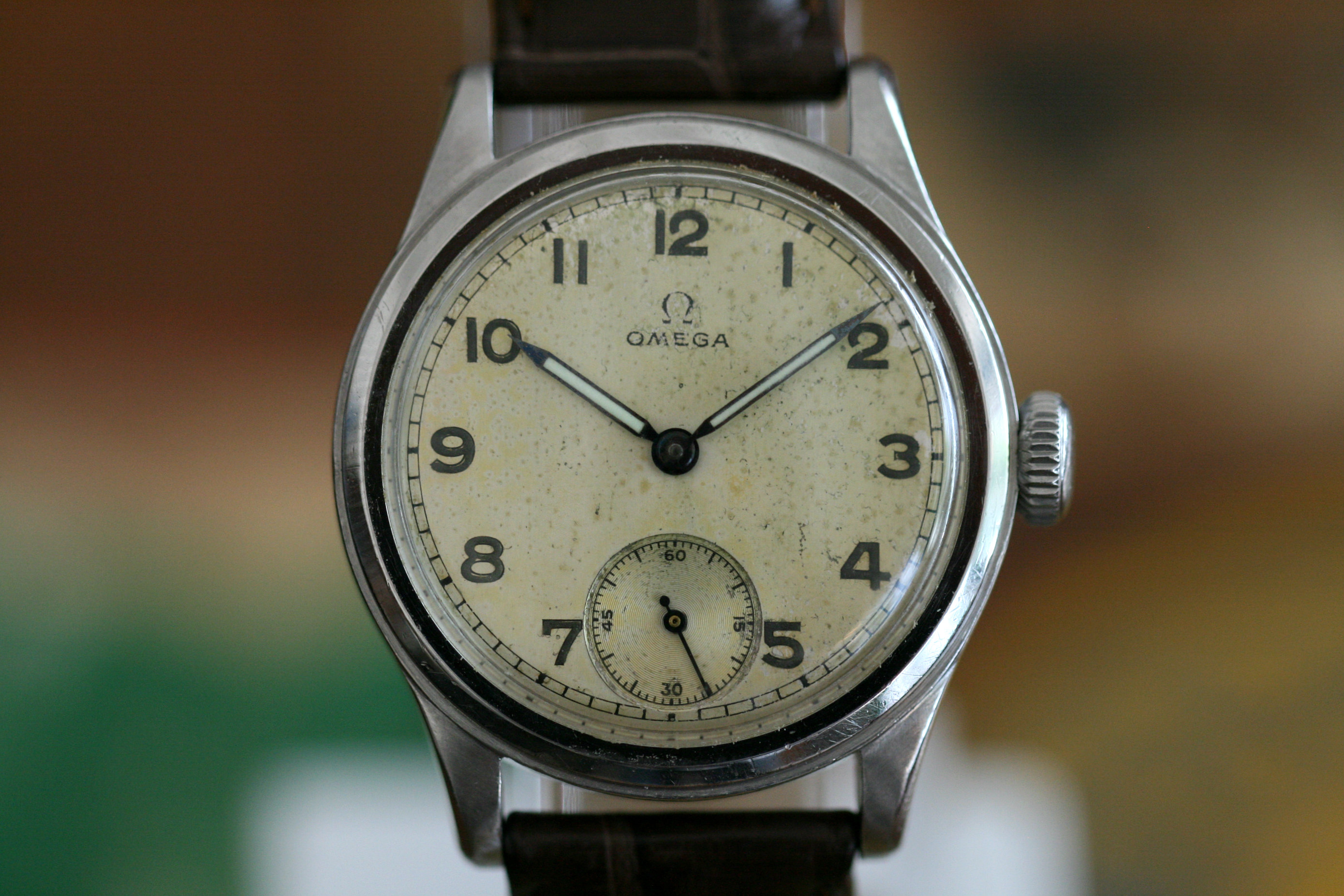

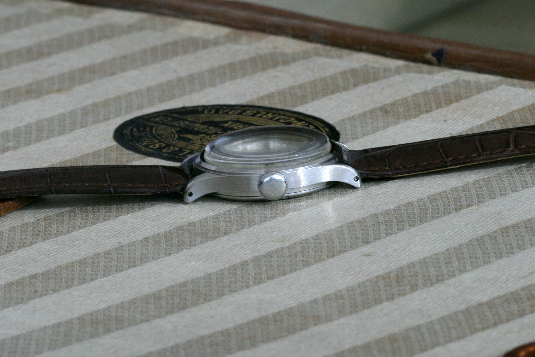

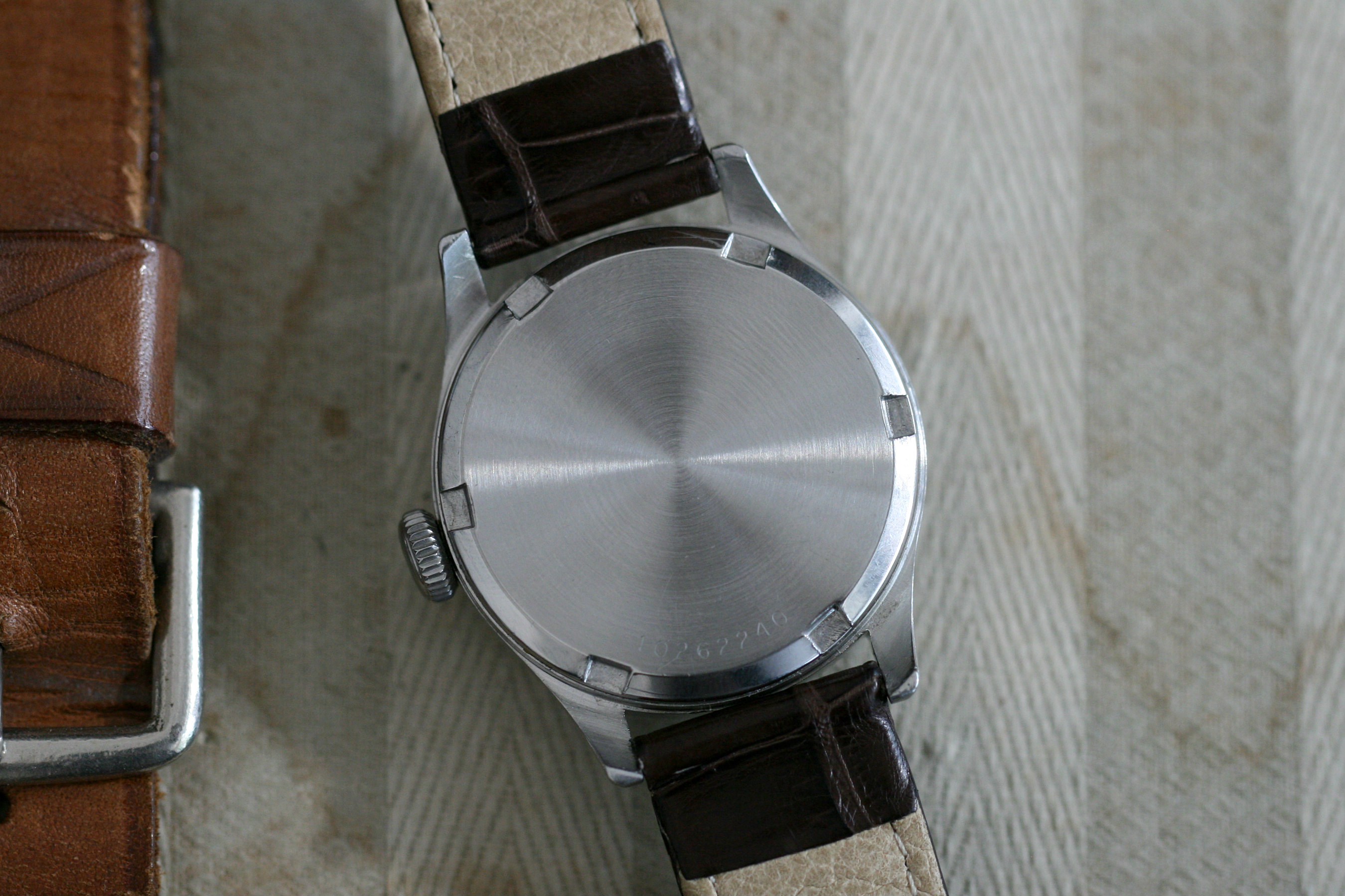

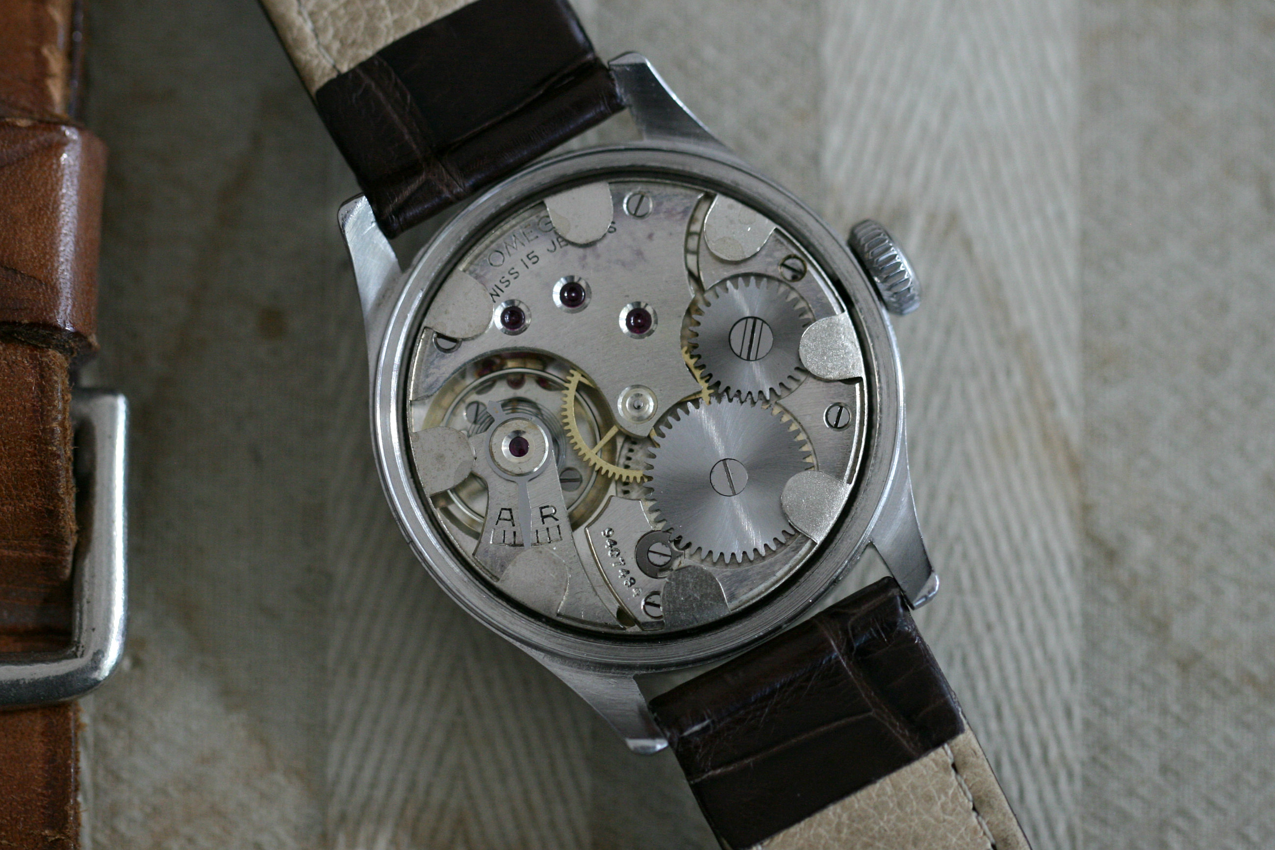

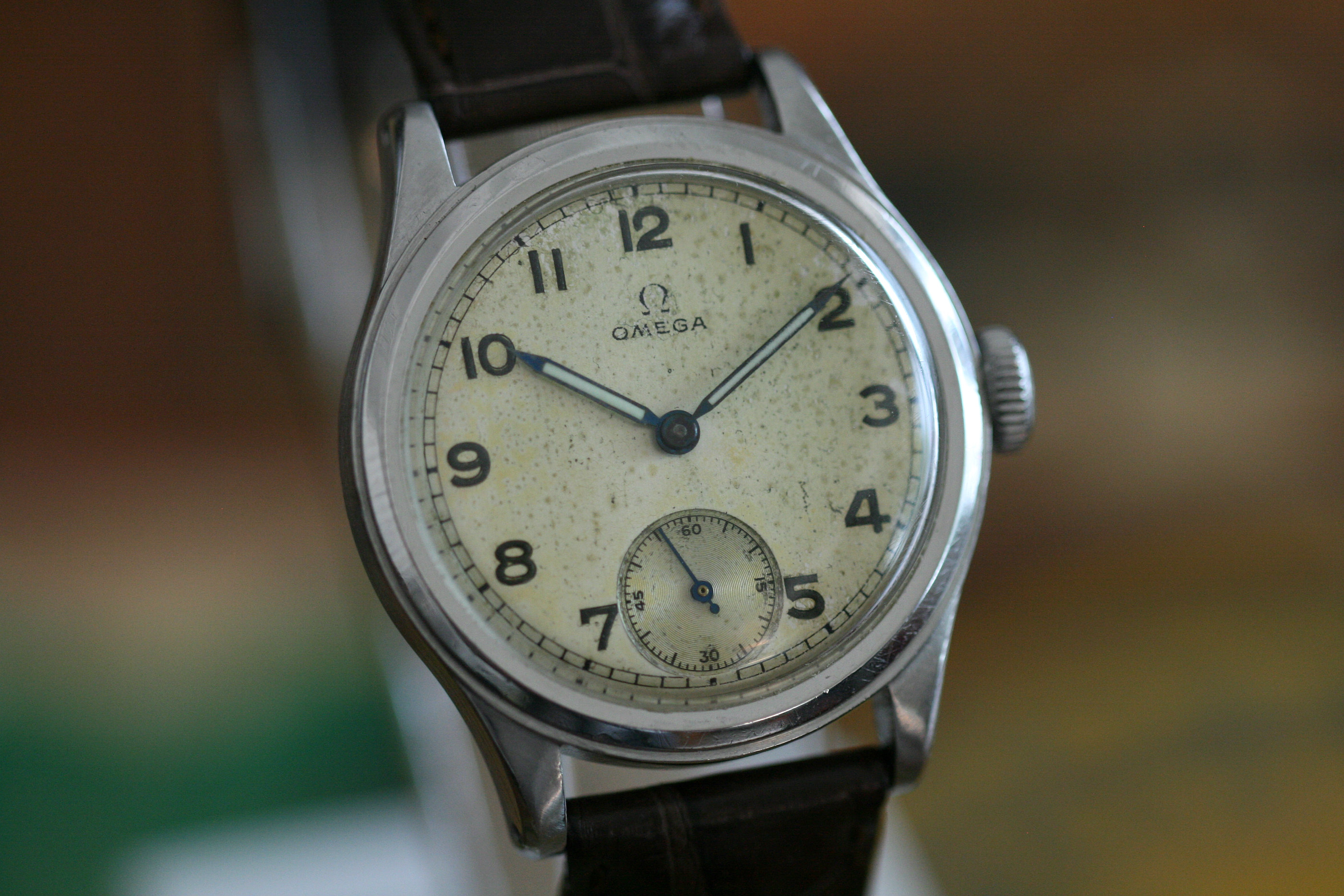

I hope you can help me identify this vintage piece I am considering buying, as well as give advice about any flaws with it.
I am not looking for an investment, but rather a nice watch I like to wear. That said, I still would like it to be (mostly) original.
Lastly, what would be considered a fair asking price when buying from a dealer? It is currently listed at 790Eur.

I really cannot reconcile the dial with hands or case, particularly the caseback, mid-case polished, caseback looks like new. Lumed hands and non-lumed dial. I do think we are looking at a parts-bin special.
That said I buy watches I want to wear and don't care about resale value. In this case if I wanted to wear it I would go to maybe 100 Cowrie Shells. Keep an eye on this forum https://omegaforums.net/forums/private-watch-sales/ and you will find much better.
24,836
55,256
Late 30s or early 40s waterproof cal 26.5. I think it's probably ok with the possible exception of the hands; perhaps the watch should have syringe hands, I don't know. It's also possible that the hands are original, but just poorly re-lumed, someone else may know better. The case has been refinished. The dial appears to have dark radium lume. I suspect that this is a tiny little 30mm watch, in which case it's worth less than half the asking price IMO.

What stood out to me most too, were the hands which simply seemed a little out of place..
I think I will stay away then and keep an eye on the private sales section of this forum as suggested!
