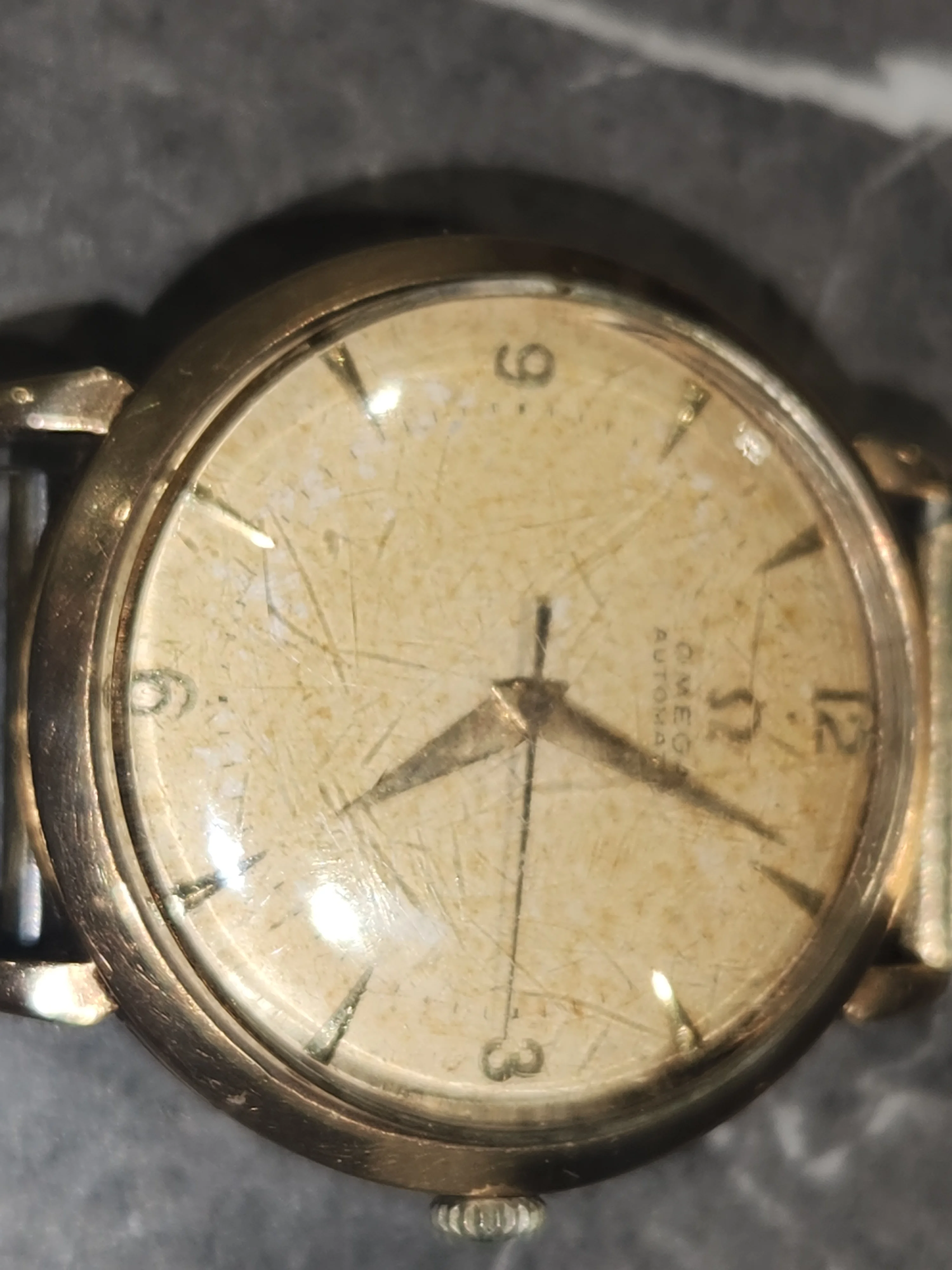

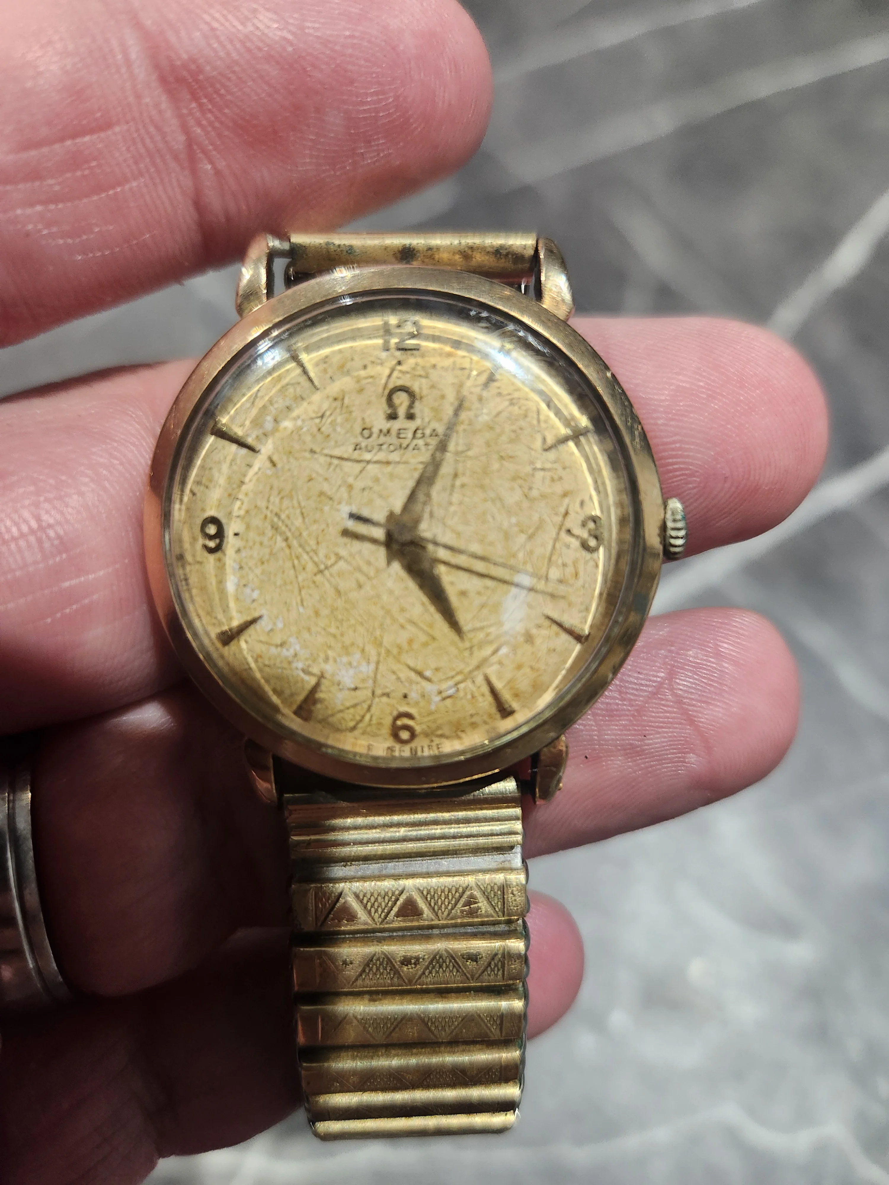

Hi,
I recently inherited from my father his Omega watch.
Story is that he was given it on his 18th birthday. That would have been 1955.
I know that he wore it daily and has quite a few dents and scratches and may have possibly had the glass replaced. The family can quite remember.
Questions i have are.
1, What is it.?
2, What is the correct strap for it.?
3, Whats it worth in current state.?
4, Do I have it restored.?
I don't want to sell the watch, I want to wear it on occasions to remember my father.
But equally i don't restore it if it devalues it
Sorry for all the questions i am very new to this.
Thank you
Steve

Welcome; the best way to figure out the precise reference is to have a watchmaker open the case up and take a picture of the inside of the case-back.
I'd recommend against restoring the watch, particularly if you want to keep it as your father had it.
For now, though, you could order some Polywatch and remove many of the scratches on the acrylic crystal, which would go some way to cleaning the watch up.
Further, while the pictures are a bit blurry, it also appears that the hands have been replaced at some point

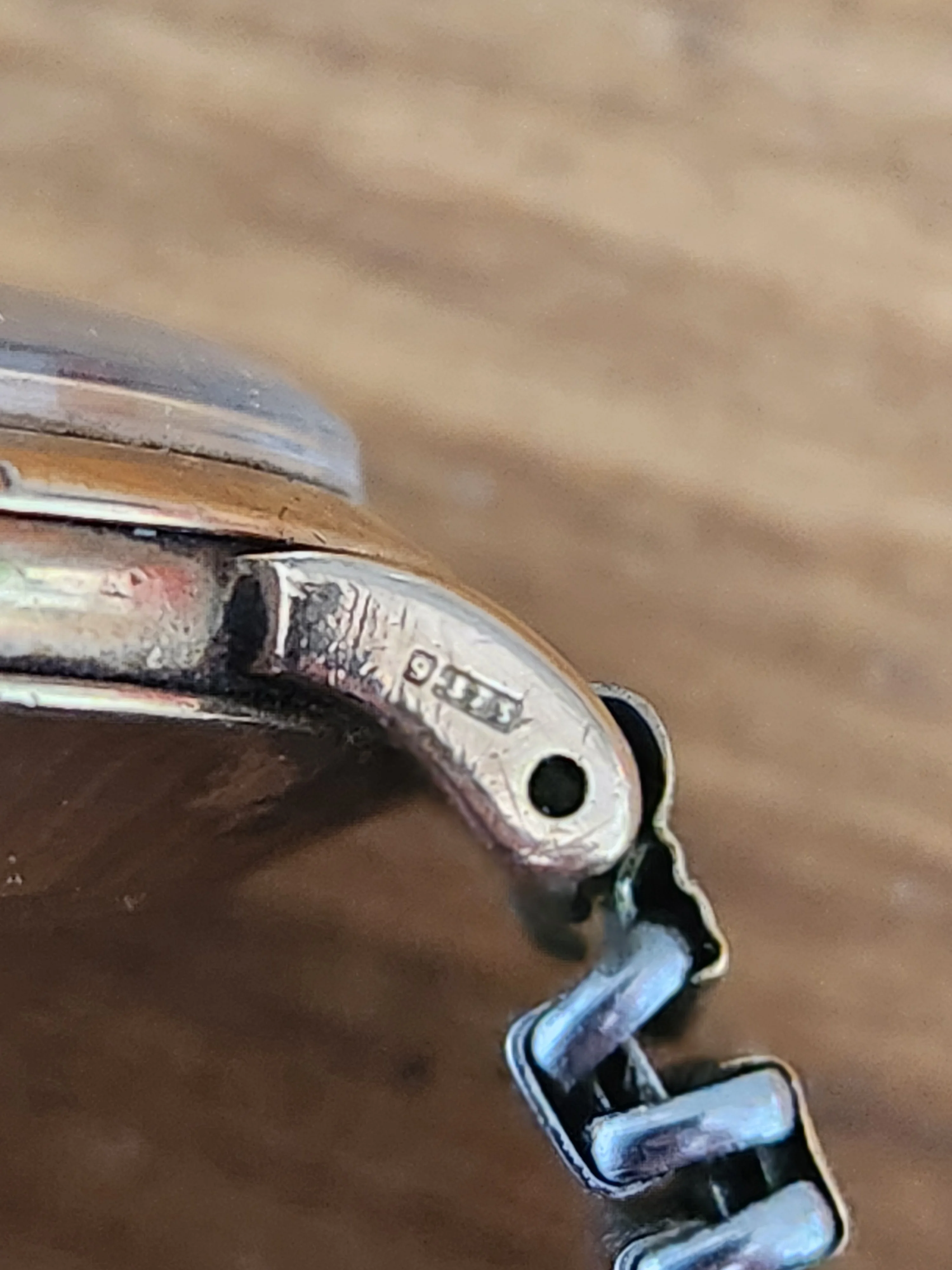

The 9ct hallmarks suggest an English (or possibly commonwealth) origin for the case.
In which case you won’t find the usual Omega references inside the case back.
The movt serial number will give an approximate date of production for the movt and the hallmarks inside should give a year-date for the case - but you already know that from your father’s birthday.
Having the watch serviced is a really good idea - by an independent watchmaker used to vintage watches.
You could try @Mitka, a member here on OF.

And you could use a jeweller’s cloth to gently remove the tarnish.
Unless you’re really keen on the plated bracelet you could just buy a new strap. Those old plated bracelets can damage the lugs.

Looks like a UK market model 13308 which is a Dennison cased version of a Swiss model I can't quite place the number for right now. Or if not that one, some other similar Dennison model. It should have a hallmark (prob the Birmingham Anchor) and a date letter stamped on the inner caseback. If so, the letters changed on July 1st not Jan 1st in this era so bear that in mind for dating. The B'ham letter for late 1955/early '56 was capital F.
I can't tell from your pics, but if that bracelet, which is not original Omega btw, has spring loaded ends then ditch it pronto as it will be gouging circles onto the inner faces the lugs. Of course if your father wore it on that bracelet then perhaps that factor outweighs any minor damage!

The top image shows what looks like a spring bar at the 6 side. The top looks like a bar has been soldered in.
Bumper movement.
Simple all black or dark brown strap.
Post location and maybe someone can suggest a watch maker to service movement and replace the crystal

You have a nice heirloom, and personally I would pursue only minimal restoration. In particular, I would have the movement professionally service and replace the crystal. I wouldn't get involved in trying to restore the case to remove dents/scratches, and certainly I wouldn't touch the dial or hands. That is how your father wore the watch and it has a coherent and honest aged appearance. The watch is collectible, but the value isn't extraordinary, let's say something in the $500-$1000 USD range. The sentimental value is much higher, IMO. To preserve it for your descendants, treat it with care, especially keep it away from contact with water.

If it is the model I suspect, it’s a full rotor not a bumper but he should be able to tell pretty easily of course!
