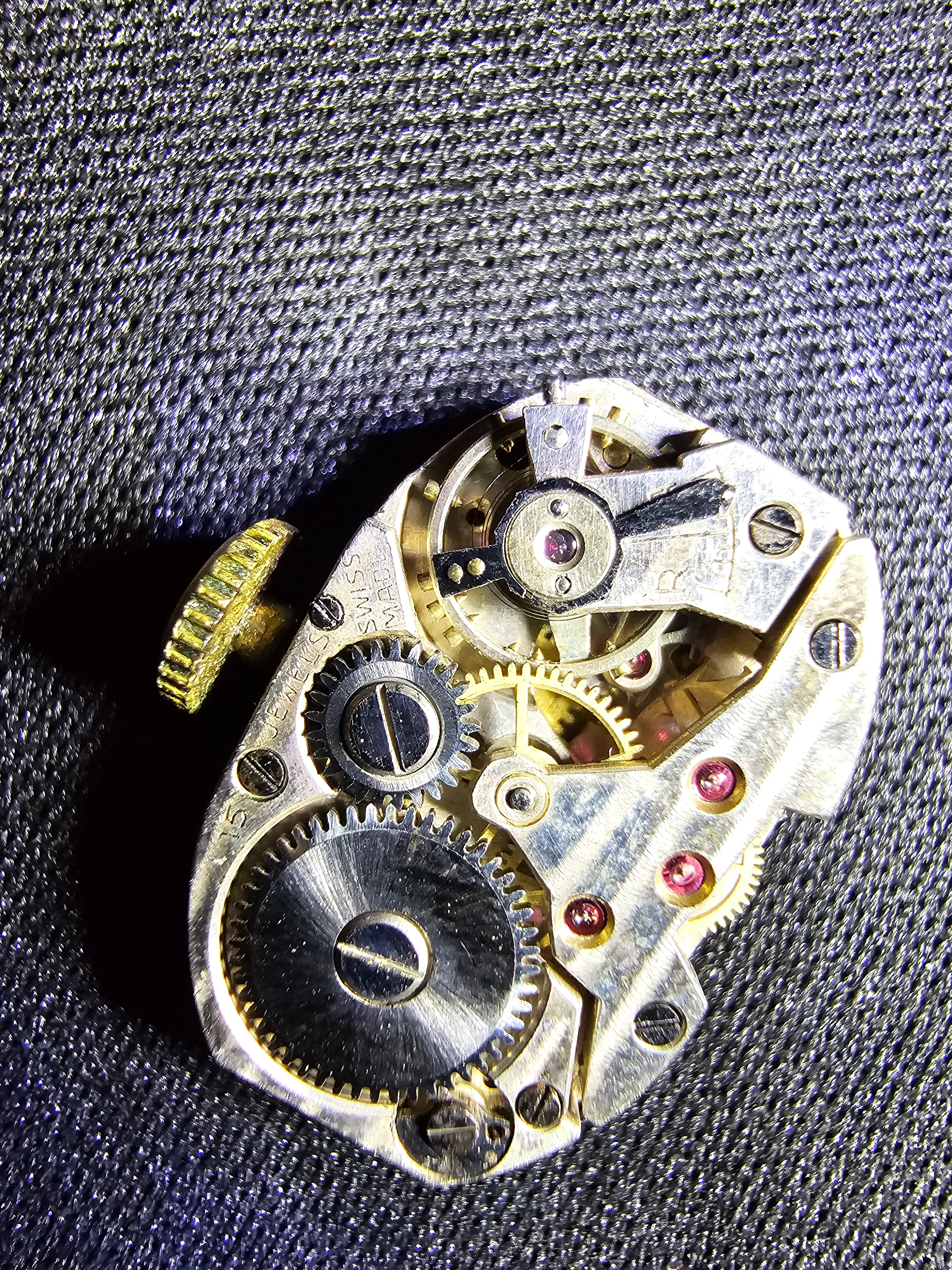

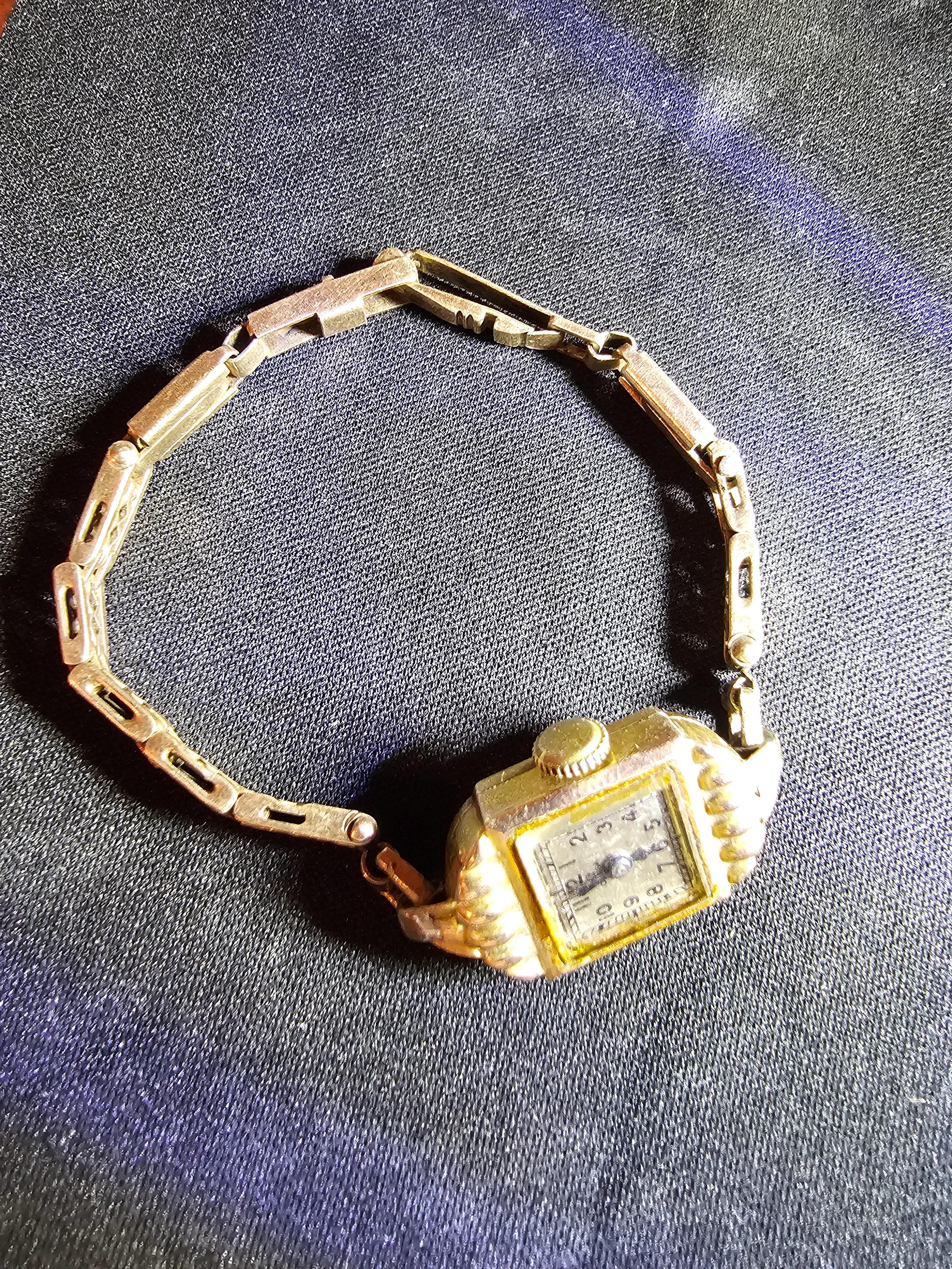

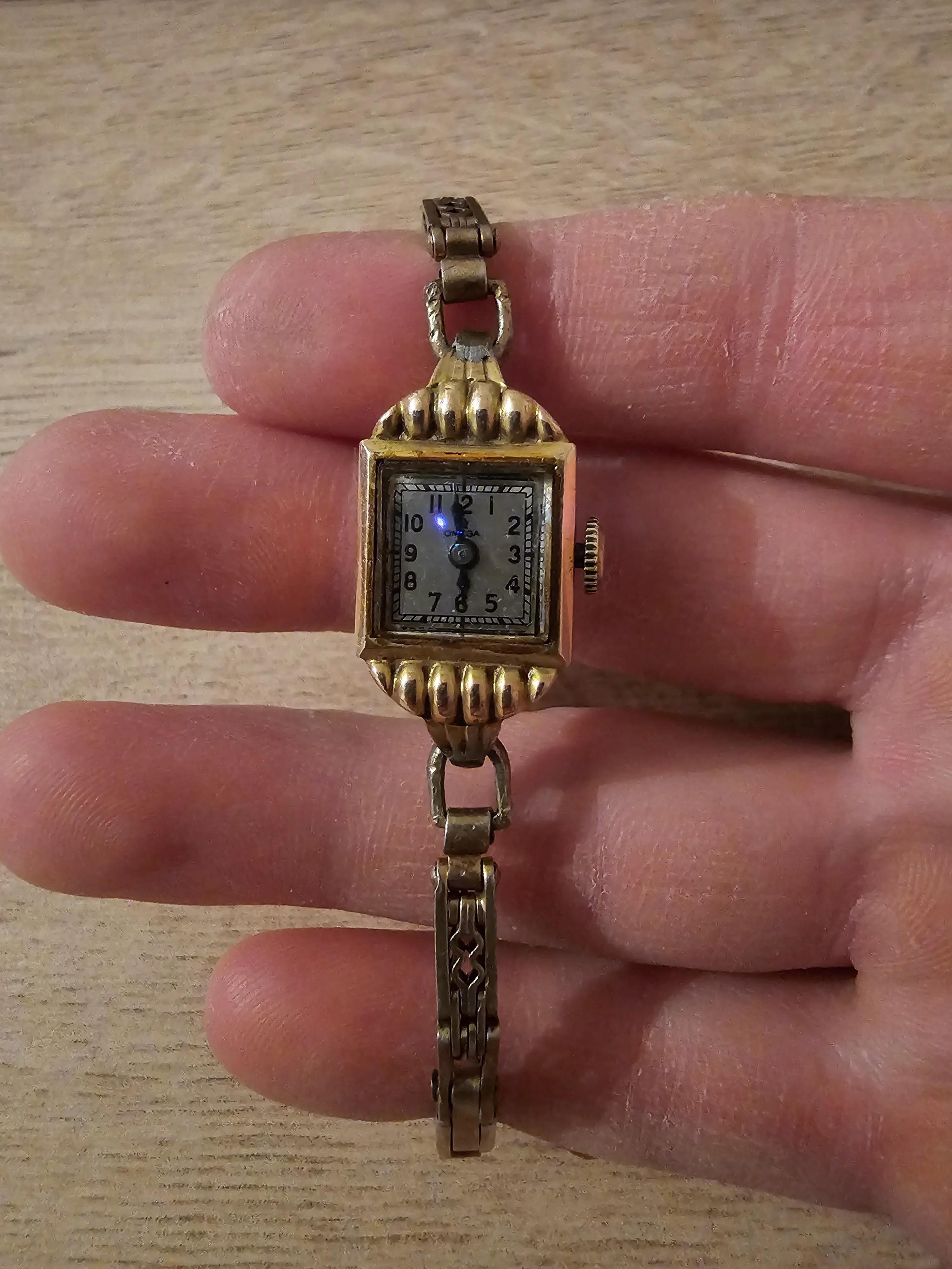

I recently found this gold Omega wristwatch, which may have belonged to my great-grandmother. Unfortunately, its age and history are unknown, and I haven t been able to identify the model.
I would be very grateful for your help identifying the watch, determining its approximate year of manufacture, and learning more about its history and any interesting details.

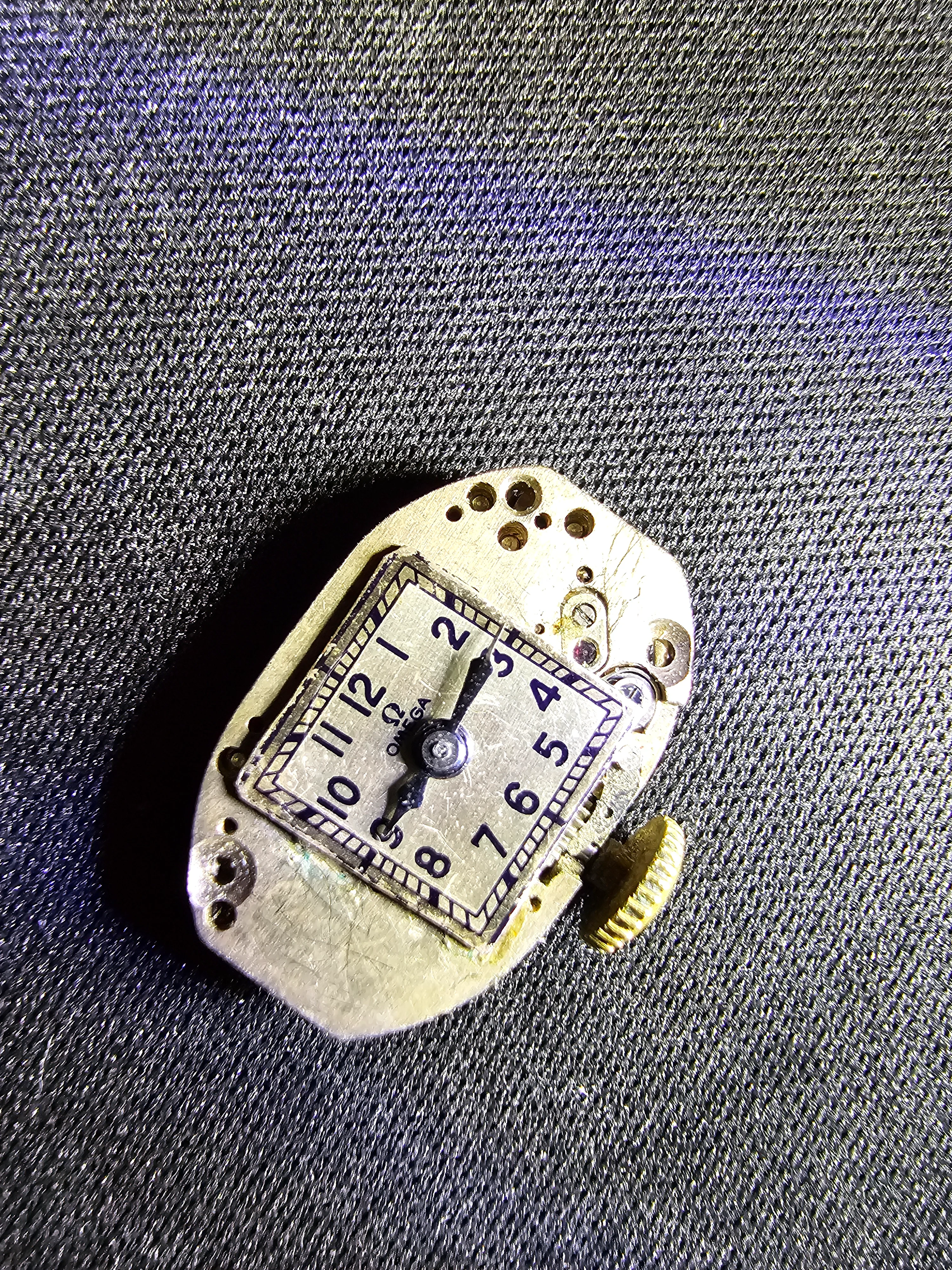

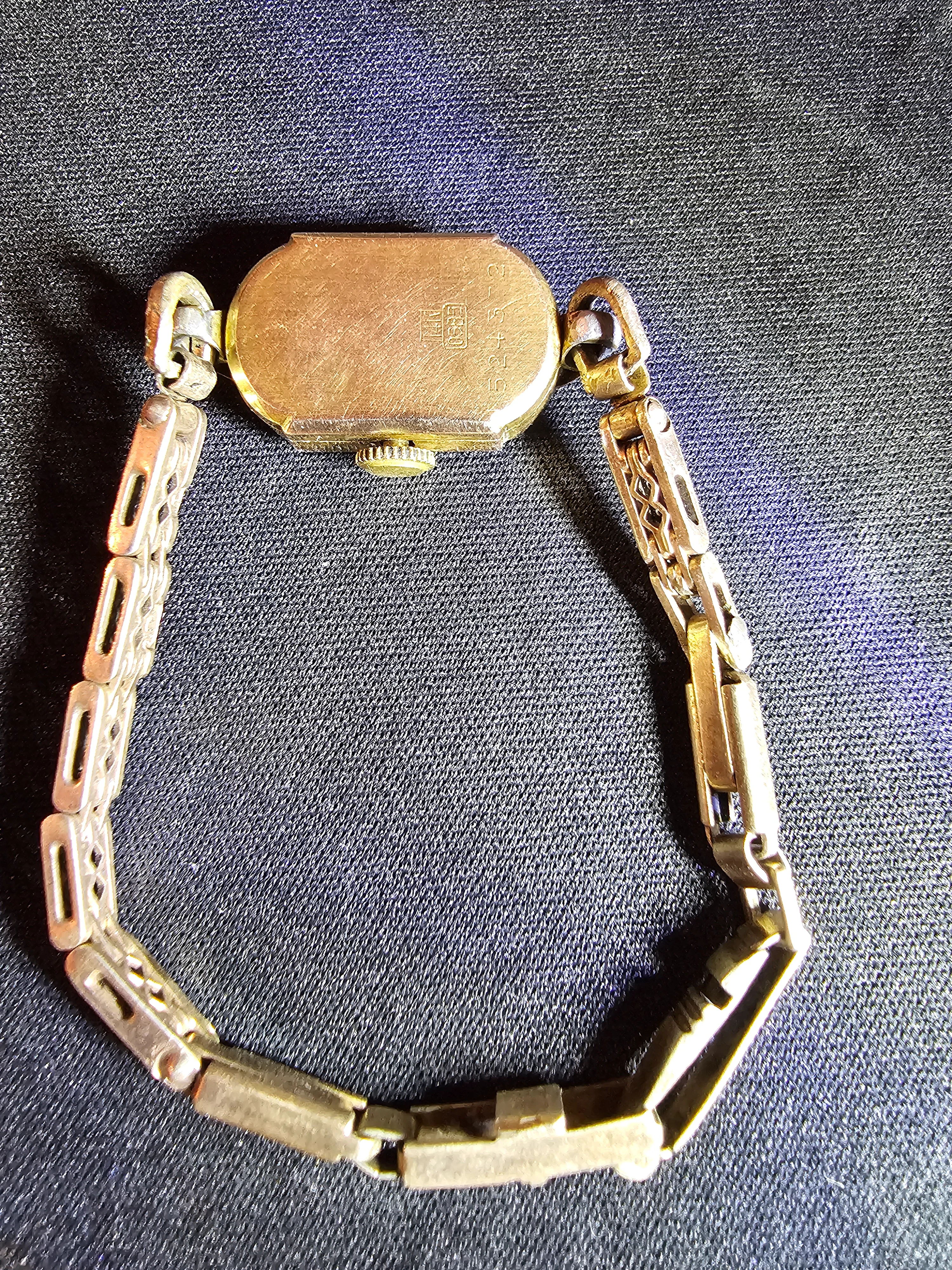

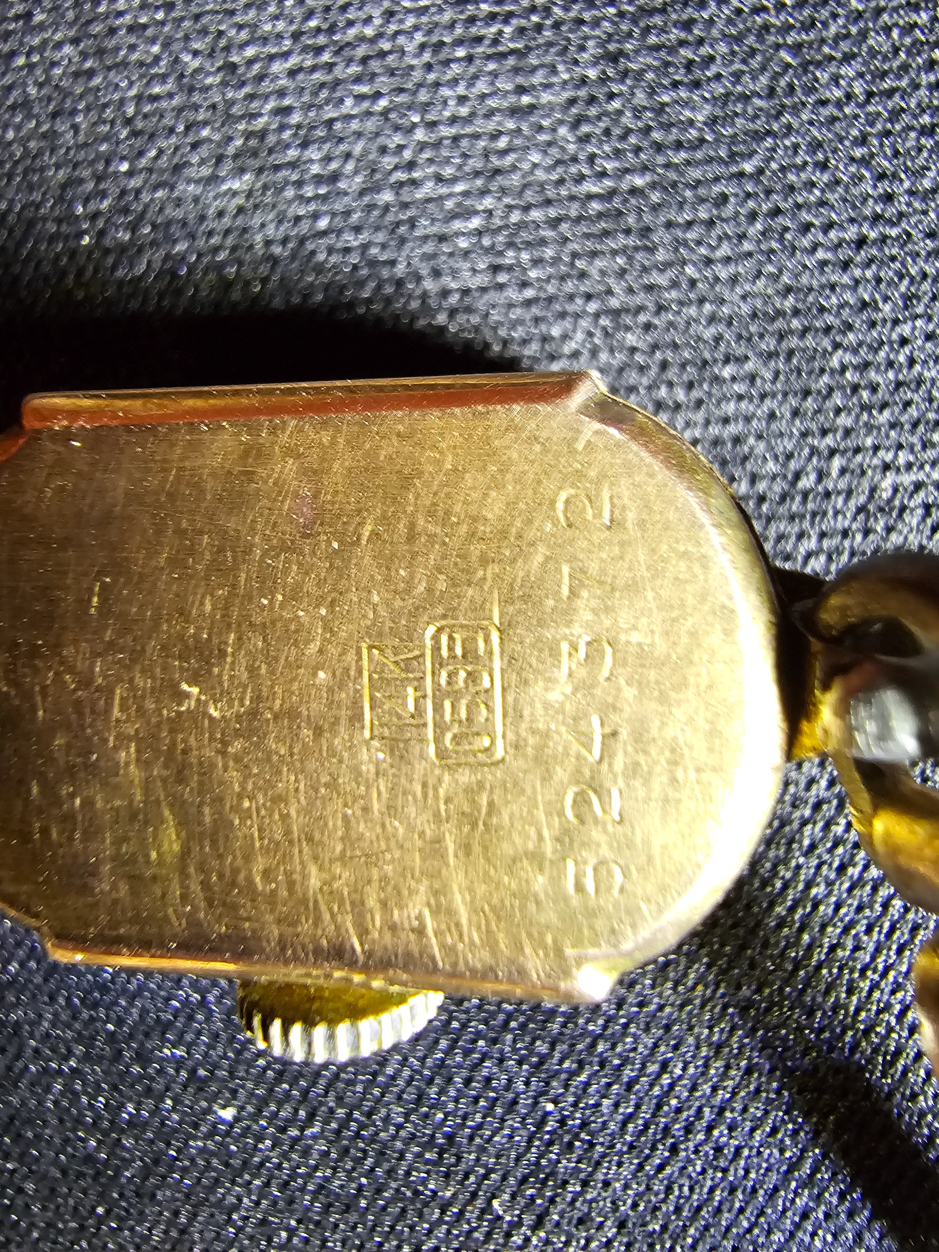

My thoughts. Movement is not Omega. Wear through on the case lugs seems to indicate case is not 14-karat gold as indicated on the case back. I believe the only place Omega would put the karat of the case is inside the case back. Your second last picture shows the dial turned 90° counter clockwise. Almost like someone had removed the dial feet from a donor dial and transplanted the dial to a generic movement where it is free to turn. Conclusion? Not Omega. Sorry!
18,775
39,018
I tend to agree. The architecture of the movement doesn't have any Omega "DNA".
However, the case may be 14K gold, I think the observed wear through may be a repair attempt with solder.
Are there any markings on the inside of the caseback?
