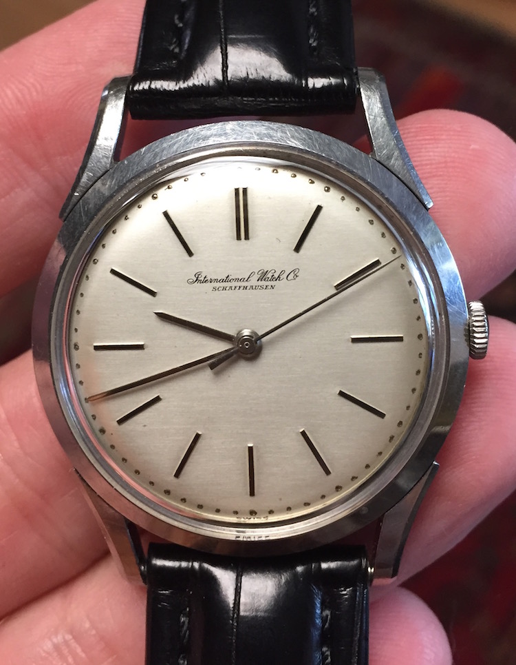

Unless he really knows what he's looking for, and gets a bit lucky. I got this for $800 on eBay ... 37mm, cal 89. But I took a risk on crappy photos from an eastern European seller. It just felt right to me and I went with my gut ... you know what I mean. If you have to ask the forum about every potential purchase, it's not going to happen.

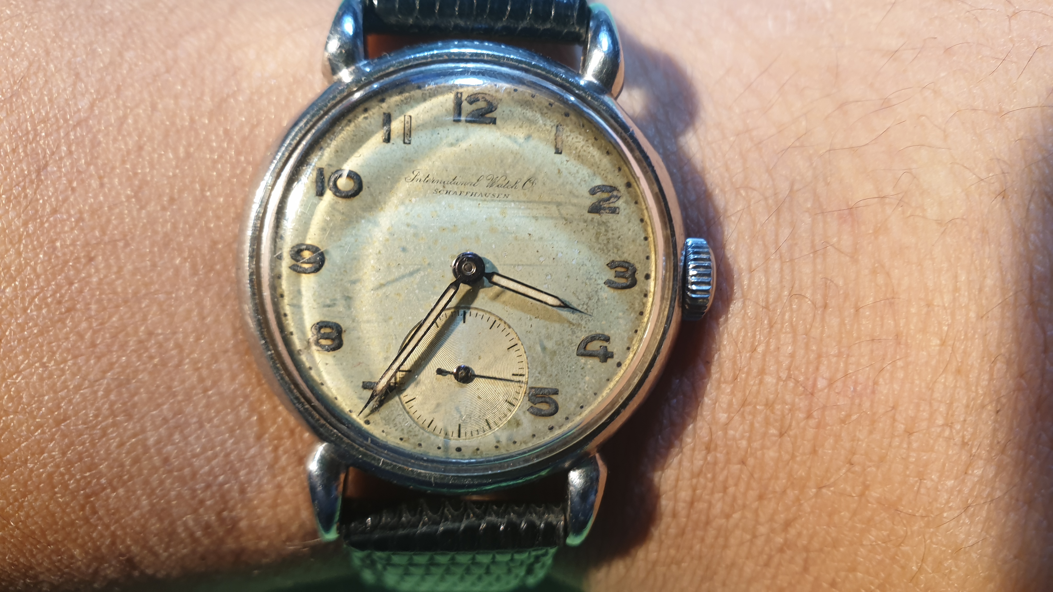

Kind of reviving this thread...

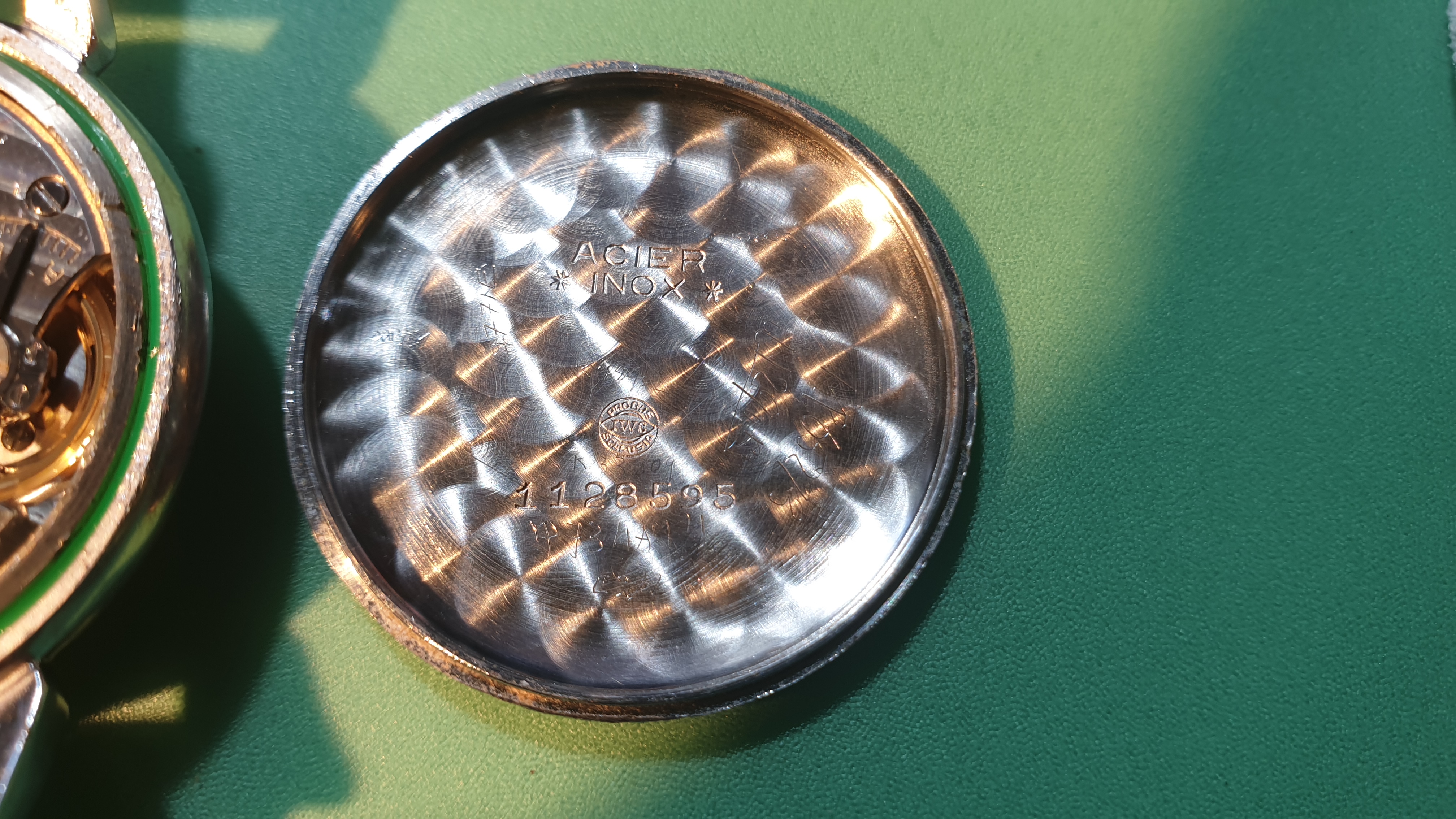

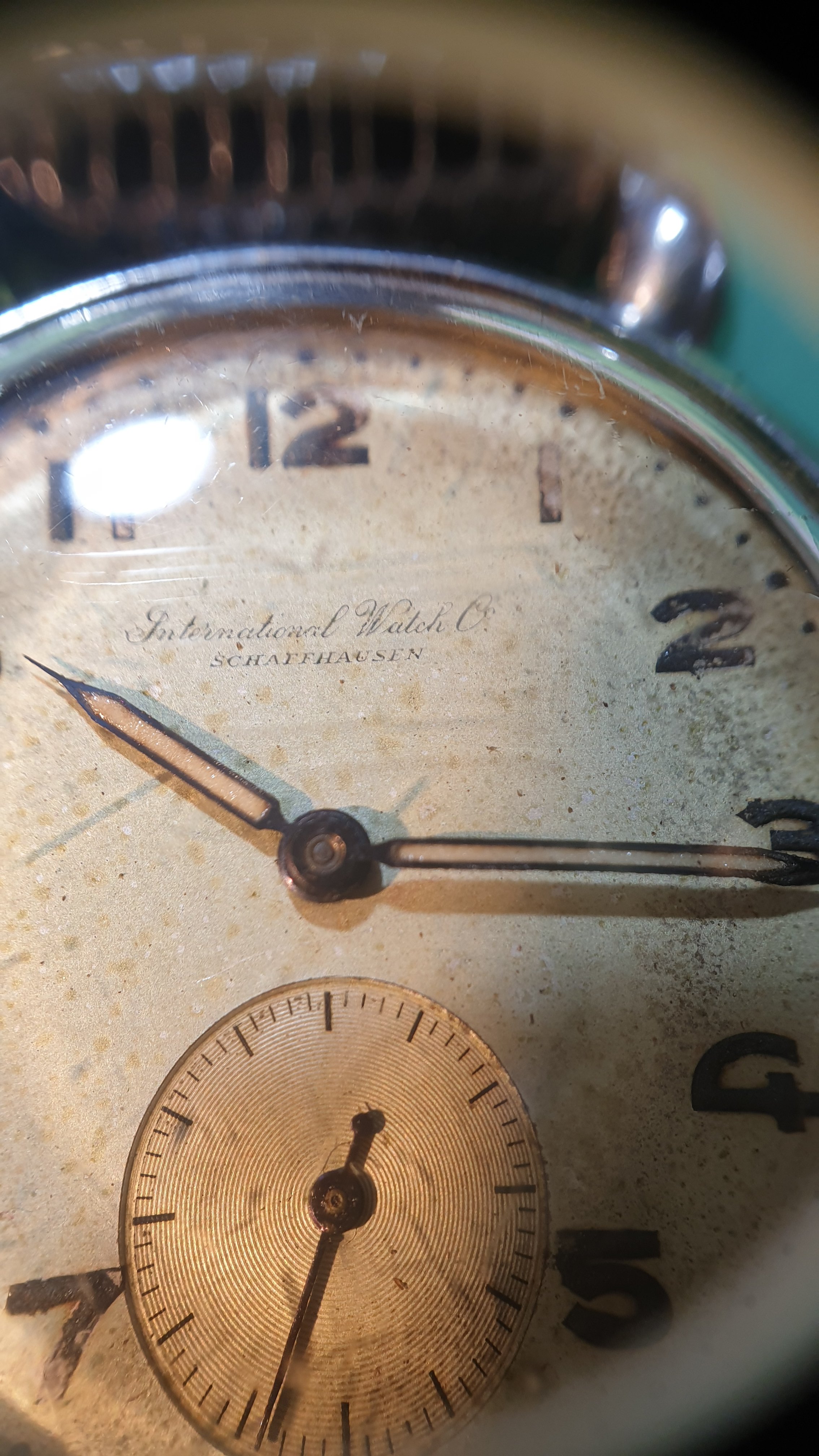

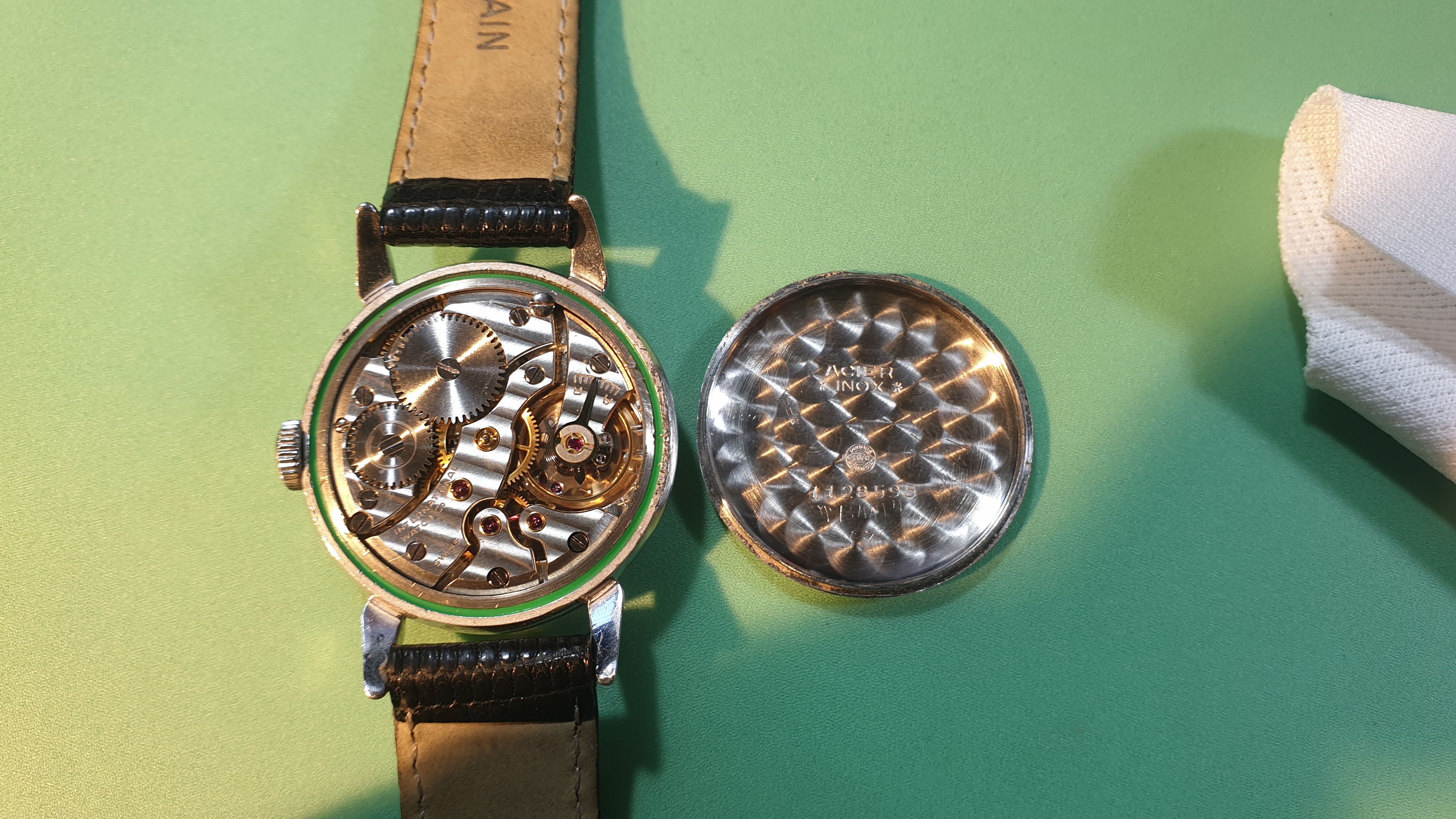

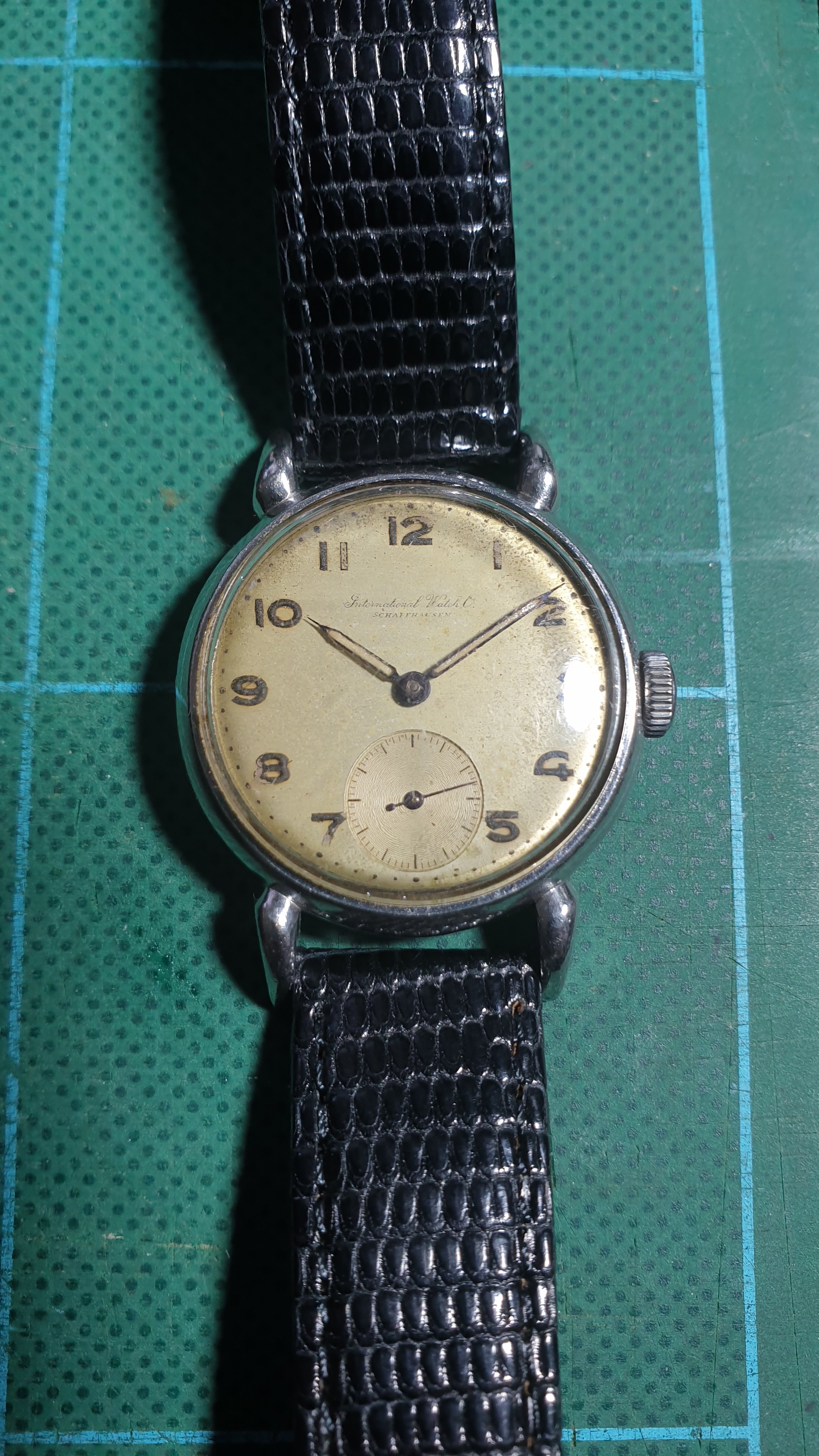

I stumbled on an IWC with a barebones description of *female/unisex* on the Bay. Only bidder and received today.
32mm stainless steel without the signed crown, hands are relumed, dial seems original though. I could be wrong as this is my first IWC as well. Movement is a Cal 88, same as the OP's, while snapback serial dates it to between 1945-1950.
Would you be so kind as to apply your expert advice please @Dan S and @gatorcpa?

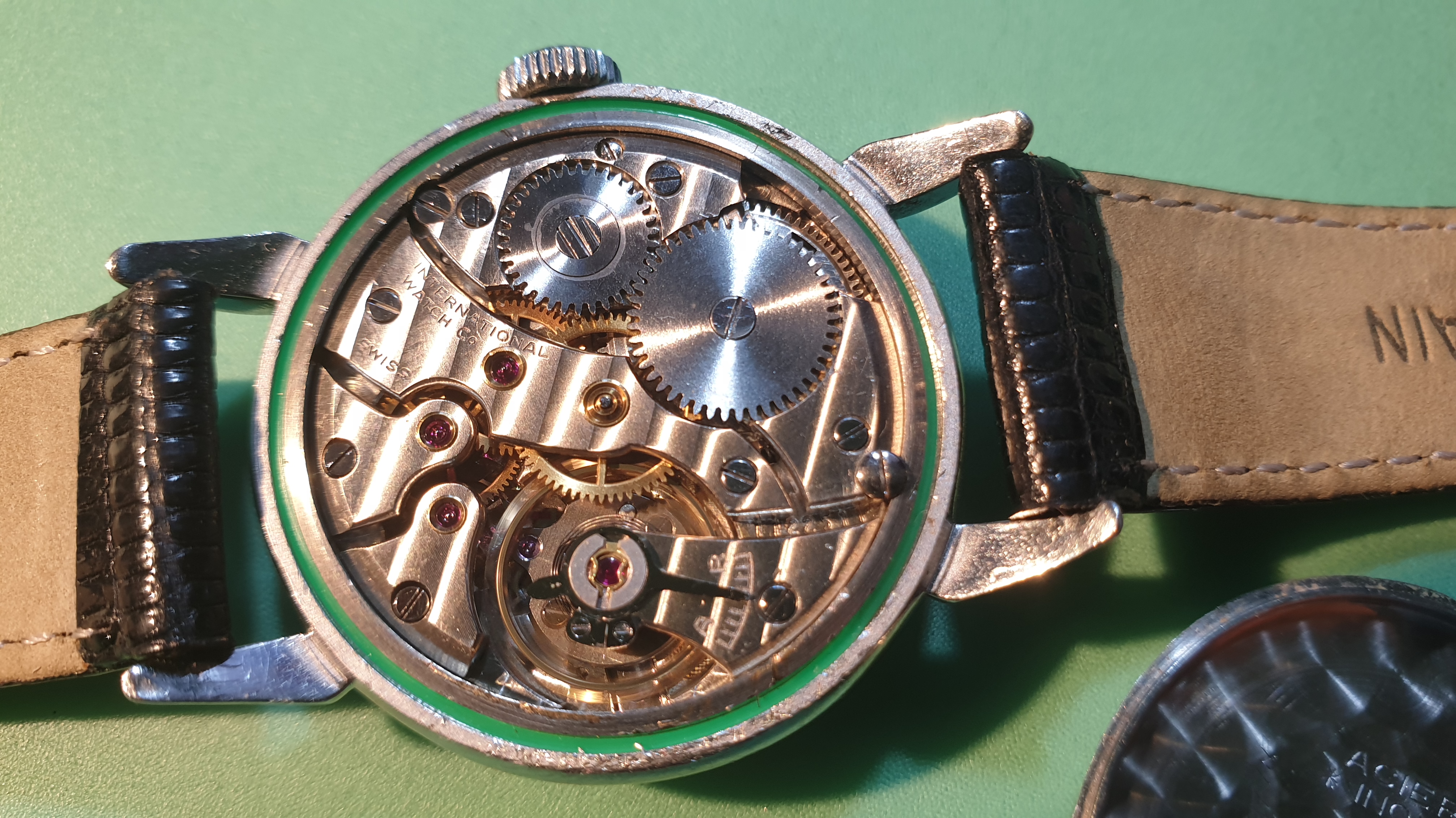

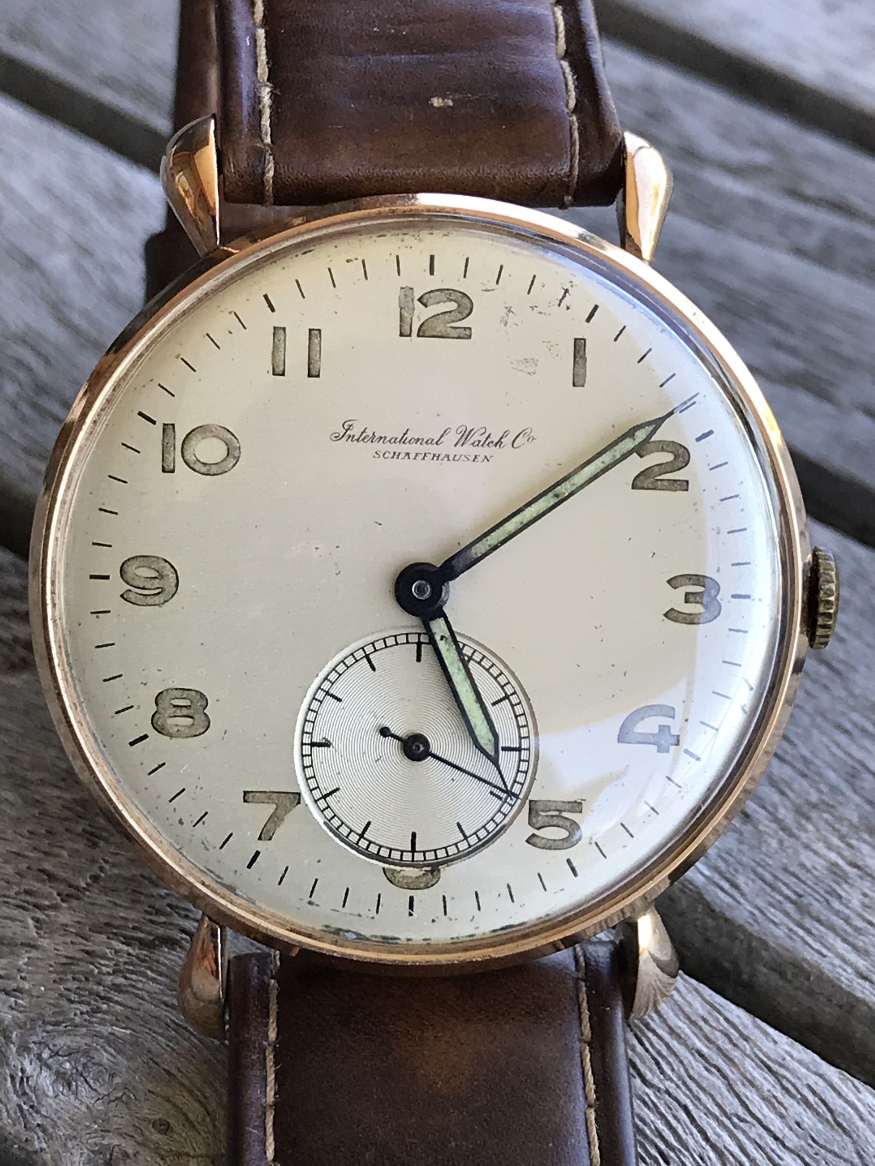

I have a 1942 Cal 83, 35mm incl crown, with very similar dial and same hands. For comparison....
edit:1942, not 1941.

Looks fine to me @GuiltyBoomerang. If you look closely between the bridges (just above the balance cock in your photo), you can also see the movement serial number, which is quite close to the case number, which is what one wants to see.

Dial looks original to me. Basically a “barn find” watch.

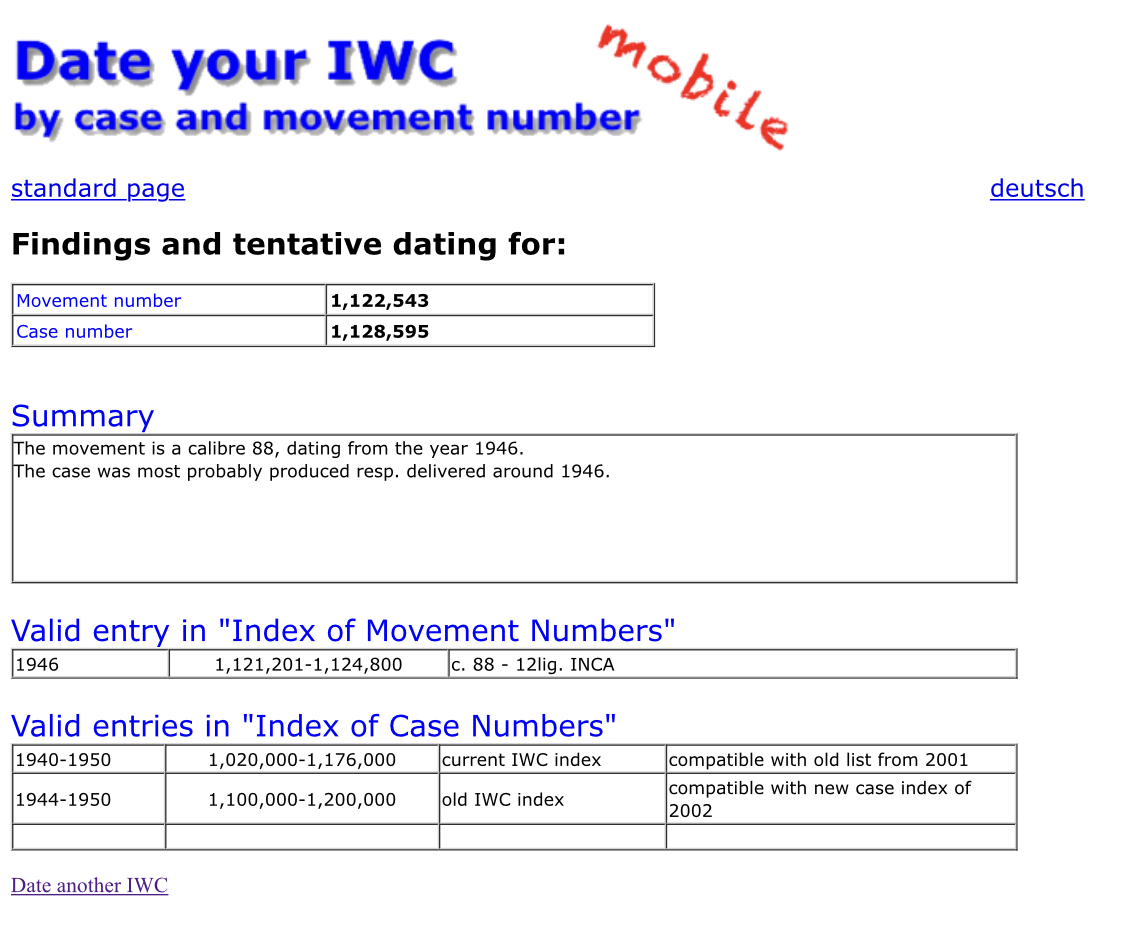

Looks like it dates to 1946 based on this:
http://moeb.on-rev.com/dyIWC/dyIWCm.lc
The last 3 digits of the movement serial are a guess by me. Doesn’t look like they would make a difference here.
I like it! 👍

Thank you Gatorcpa, Dan S and Queriver for your responses! I do hope @lonemian has found (or is close to) finding one themselves 😉

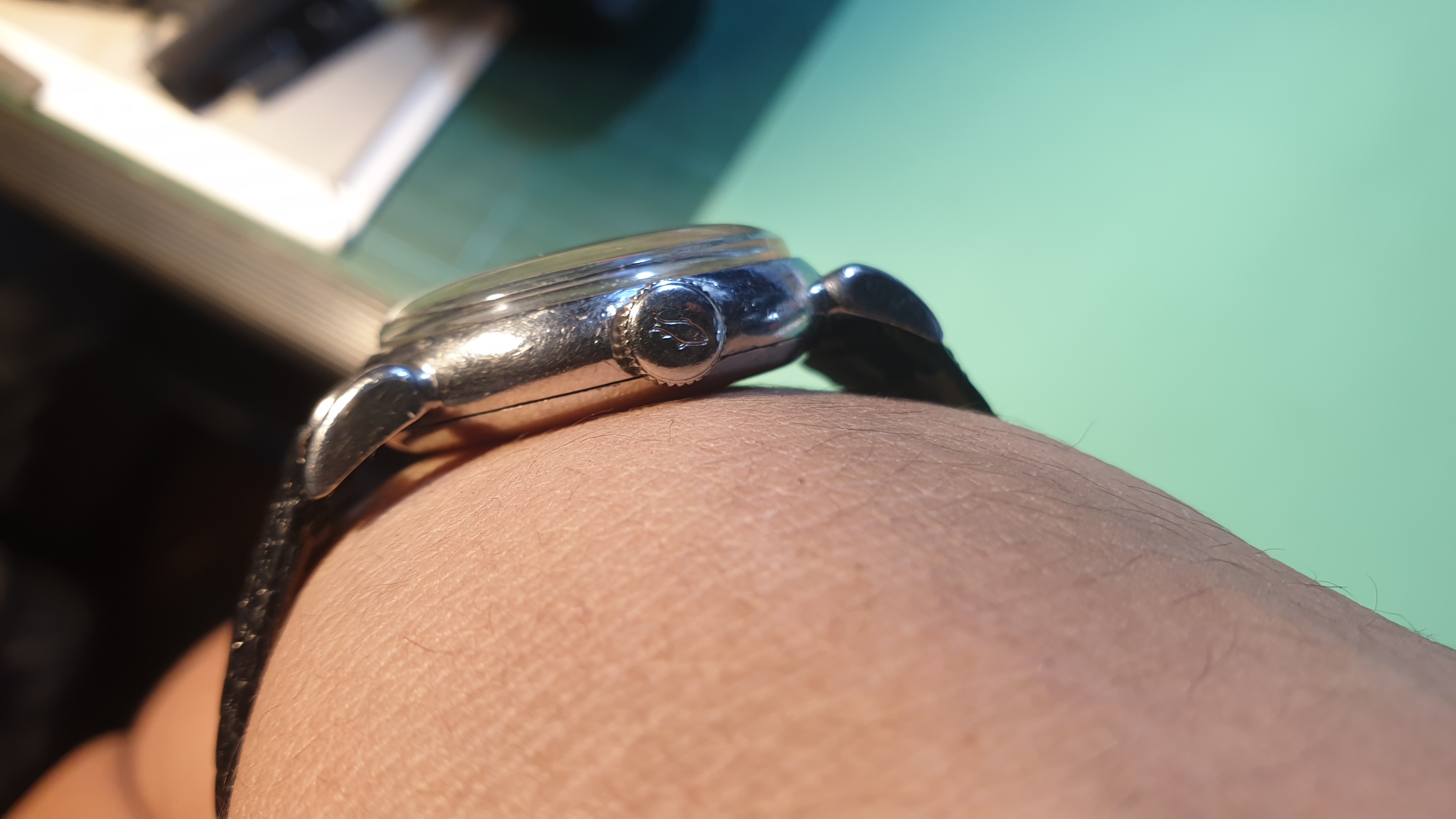

I'm far from an expert on IWC watches, but it looks like from your pictures that you do have the original signed crown. If I'm not mistaken, the fish symbol on the crown was used to denote watches with water-resistant or waterproof cases.
Excellent find! It looks to be fairly original.

Honestly, I'm relatively new to this, and I can usually only see the signs of a redial after it's been pointed out to me, but that leapt off the screen as dreadful before I even scrolled down. Don't!
