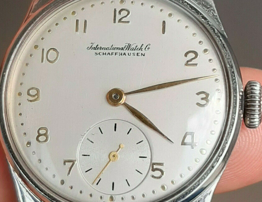

Please evaluate this IWC cal 88
135
120
It's on the bay (https://www.ebay.com/itm/153923305715)
Thesedays I went nuts about vintage watch with arabic index and subsecond dial so I'm on verge of buying this.
But I decided to hear second opinion/devil's advocate before proceeding anything.
Below is my rough analysis. What do you think? Tell anything freely to me!
<Pros>
Arabic index and Subsecond with nice proportion (my appetite)
Steel case in ok-ish state
Movement in good state
Cal 88 (rare to some degree)
so-so price (Far from a perfect example, but enough to enjoy)
<Cons>
Redial? (retouch should cost $90)
31mm size (but still wearable to my wrist)
24,800
55,082
It looks like a very sloppy repaint, and I think you can obviously see pain on top of the markers.
135
120
Yes the marker painting is uneven and sloppy. Considering that the dial needs to be retouched, what would be fair price of this?
If I were you, I would not buy this at all.
Redial will affect the resale value(if you care about it)
It will definitely require a service.
And putting in all this effort to have a redialed watch at the end of the day would put me off, you might have a different opinion.
Not to mention it will look horrible in person, judging by how bad the dial was executed, until you get it redone.

I'd be concerned about the sloppy IWC script and Schaffhausen on the dial. They aren't centred either. Others will be better placed to comment about the cost to have them re-written but I doubt the script and numerals could be done neatly for $90.
What do you mean exactly? Do you want to refinish a refinished dial?
Yeah I thought about modding the dial. But I realized all of these are not good ideas. 😉
Well. In theory it's possible. But then i would buy a cheaper one. Japanese ebay dealers, like closer, have a lot of iwc redials and/or bad dials for much less and in 35mm cases.

Well. In theory it's possible. But then i would buy a cheaper one. Japanese ebay dealers, like closer, have a lot of iwc redials and/or bad dials for much less.
thanks for the input. Should I visit Japanese site? or just searching for Japanese sellers should be okay?
Maybe it's better for you to find a original iwc for a bit more the the above. I think it's better. If you really want to pursue this you can send me a pm. But do you know a watchmaker who is skilled in refinishing dials? Most of the times they do a terrible job.

I think this should really go without saying, but not for a second would I consider paying $850 for a poorly re-dialed 31mm watch like this.
Indeed!! It will be the seller's best day ever!! Try to find a good example even if you have to pay a little more, you won't regret it. This..you will

...you can obviously see pain on top of the markers.
Not often that a typo adds clarity to a statement.😜

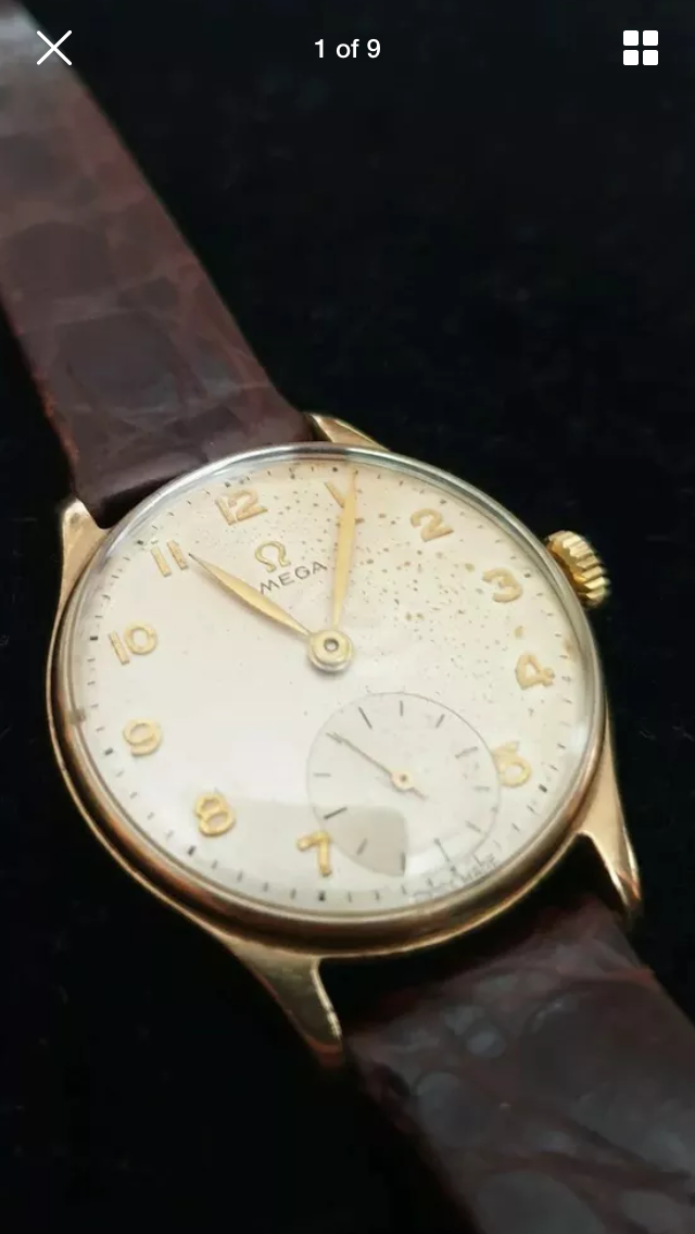

I think I found a decent alternative to this. 30mm sized Omega 9ct calatrava with cal. 361. My bidding target is about ~usd 400.

A omega is something different then a IWC. With patience you can find a 50's or 60's omega in good condition for $ 400. Finding a good IWC for that price is much more difficult. Why do you focus on 30mm watches? Small wrists? And why did you suddenly changed to omega?

Oh. I see your other thread and you already bought this one. Well, enjoy!
You are right. IWC is different.... I think I need to be more patient to spot a 36mm sized IWC vintage in a good condition. Although I just bought an omega, I still want to solicit a nice IWC. Can you share me some tips?
