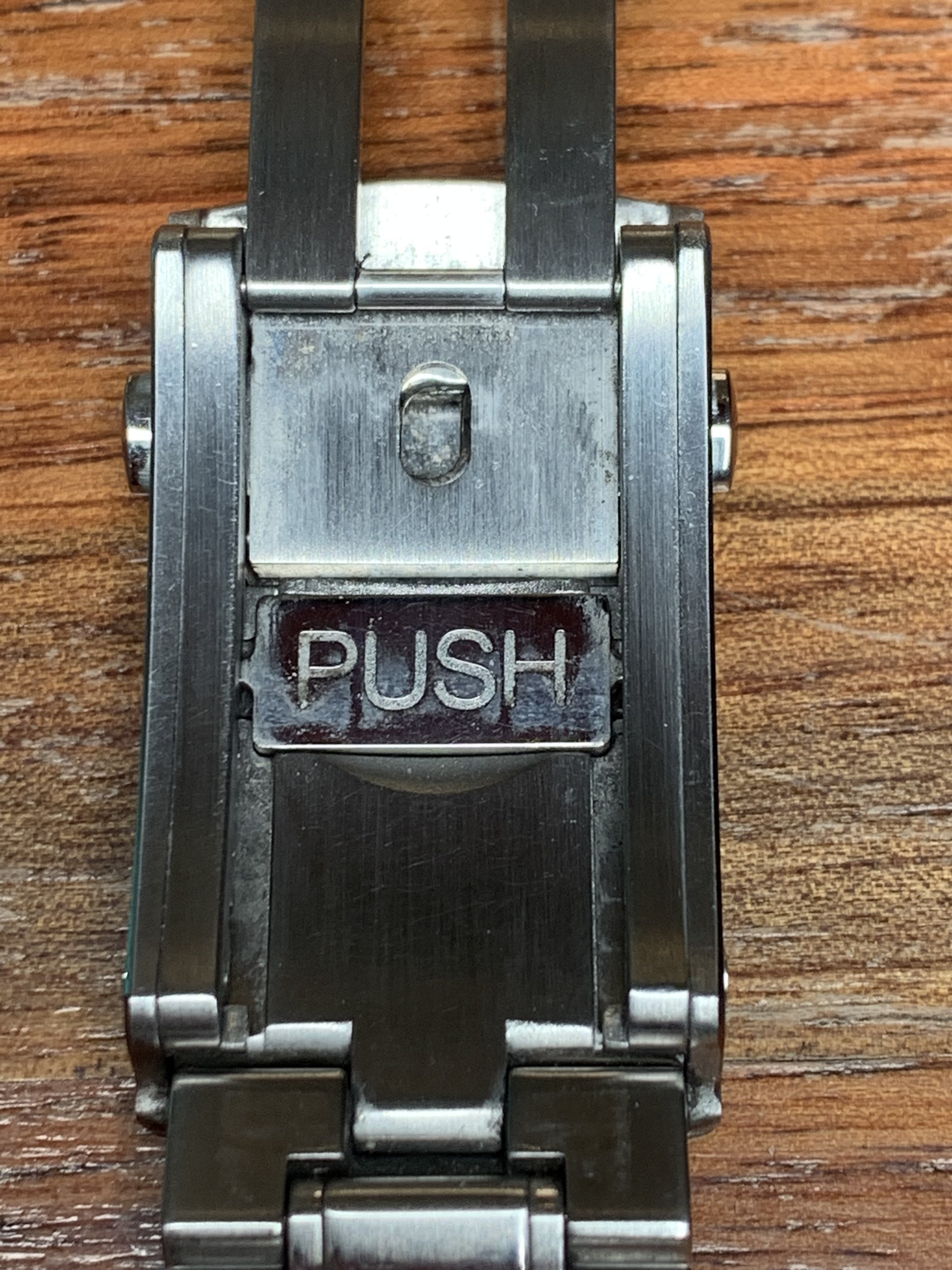

199
1,464
Having an issue with my clasp now, it won’t stay latched. I have the 117STZ00154 clasp, if someone could take a picture of theirs. I’m afraid I lost a spring inside the hole between the pushers.
Thanks in advance!
