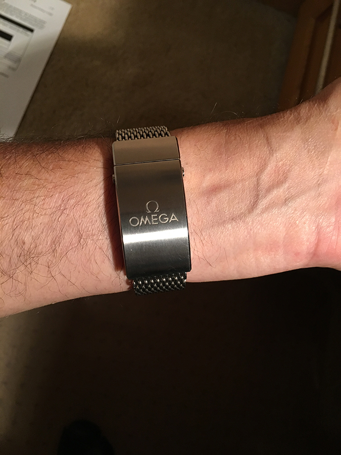

Once again works fine with PO 2500 on mesh. No other links required.
