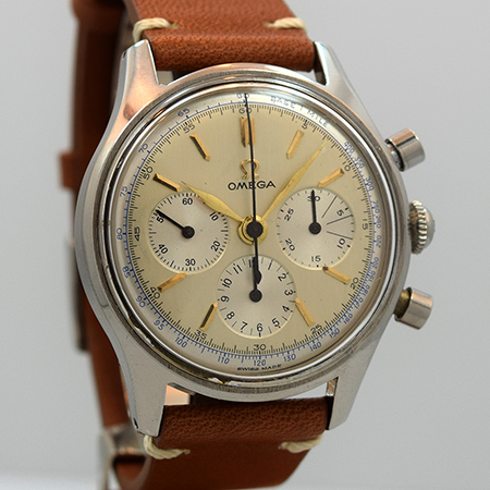

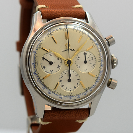

well here is a omega with base mile outer ring do not know if original looks good, i do see the extra marks in the small center dials on my version, how the dial got there unknown, my dad was involved with indy car racing made alum parts for the turbines in mid 60's remember flying to the races a few times had special box above the pits he would time them. just for fun could he have had a special dial made , sure he was quite wealthy, just dont know. but I can guarantee it is how i received the watch over 53 years ago and it sat in my sock drawer in a little green felt bag. he stopped wearing the watch in late 60's because the one reset button fell off and a small sharp little threaded point stuck out, into his hand if he leaned it back he had a nice rolex wore instead. brother got the Rolex I got the Omega,

Thanks , appreciate , yes Canada dollar is low but hey we get free heath care lol did you see the picture of the omega with base mile dial like mine has ? is it real or fake dial, ? I do see the extra marks on mine dont know history so ??? would there be fake Omega dials in 1960 ebay did not exist and china was for buying rice?
The other watch at least doesn't have the big outer ring where yours has the minutes overlapping in the subdials so definitely you have a badly finished redial.

true much nicer dial i do see that , just I was told omega never did base mile watches, and yet found one, but don't know if real or not, does not say seamaster or speed master, I just was looking for mile based outer dials trying to educate myself .

Its not the 'Base Mile' that's making everyone say it's a redial. It's the overall font (particularly the word 'Seamaster' and 'Omega), the overly large numbers on the sub dials, inconsistent hash marks on the sub dials and the overall quality.

agree the rest of the dial is not good, was just responding to a "you cant find a base mile omega" thread. I am not saying anything about my dial only showing that omega seemed to make a base mile watch.

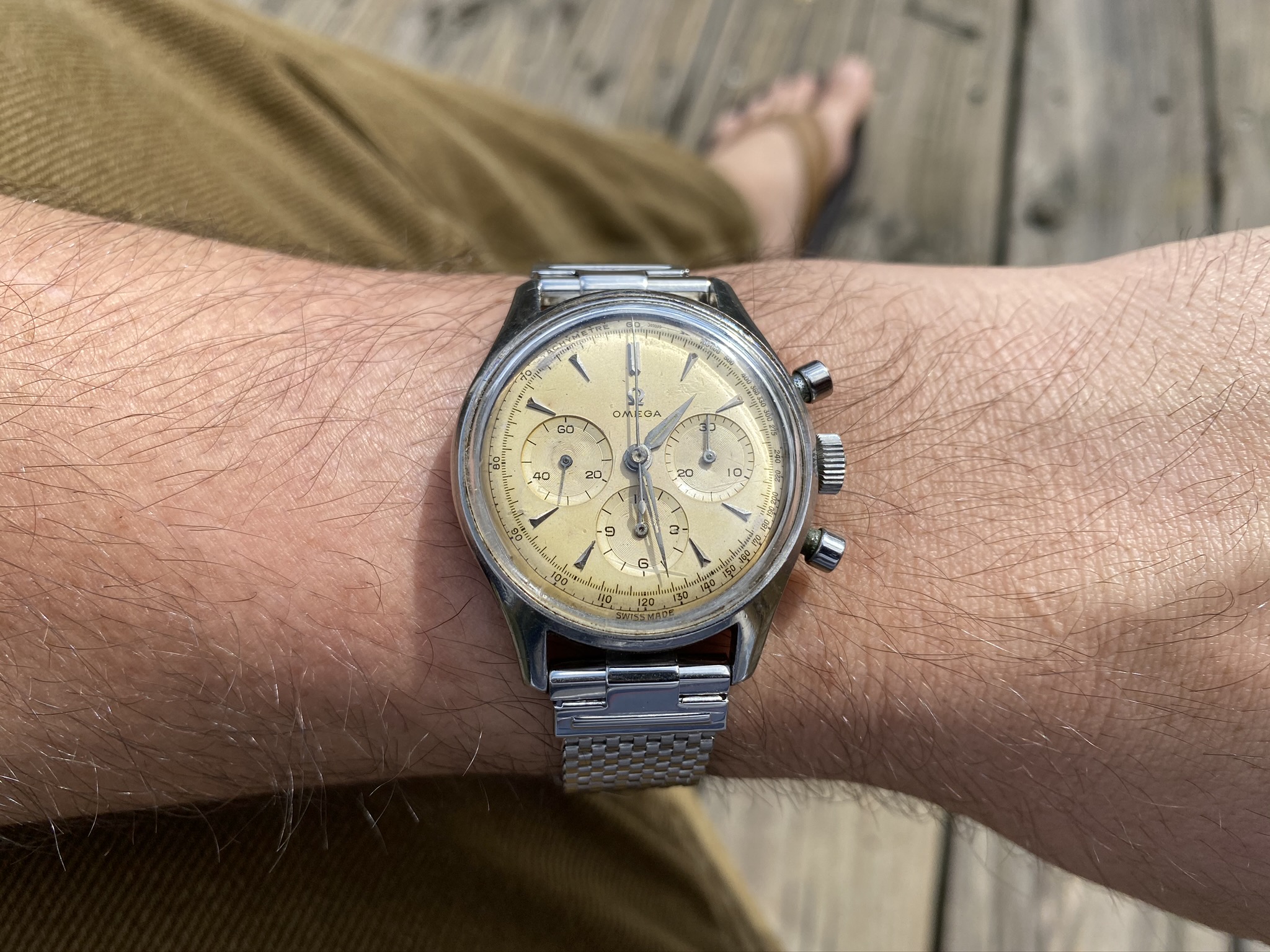

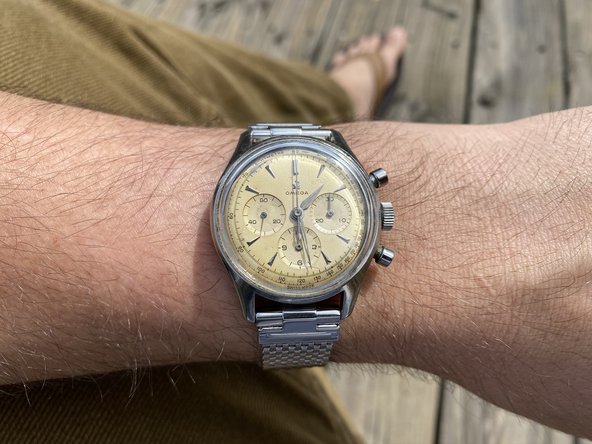

I dug up a picture of my all original unfinished 2451-7. There are variances in fonts for the chronograph registers between references, but I want you to see how consistent these watches are with details when they are originals. As you can see on mine, the dial has no inconsistencies with the fonts or numbering. When you see these inconsistencies and they are clearly not from damage (or “patina”), that’s a good sign that the dial on the watch has been refinished, or what we call “re dialed.”

The problem is that if you search hard enough, you will find other re-dialed watches to confirm almost anything you want to believe. We see this all the time on the forum. If you find 100 watches that look one way, and 1 watch that is different, you need to use common sense, and not just believe that the single isolated example is correct.

Thats what I said I think not arguing my dial does not look original, was only suggesting that base mile did exist, when pushed by some one. I even questioned if it was real or not. just trying to learn.
