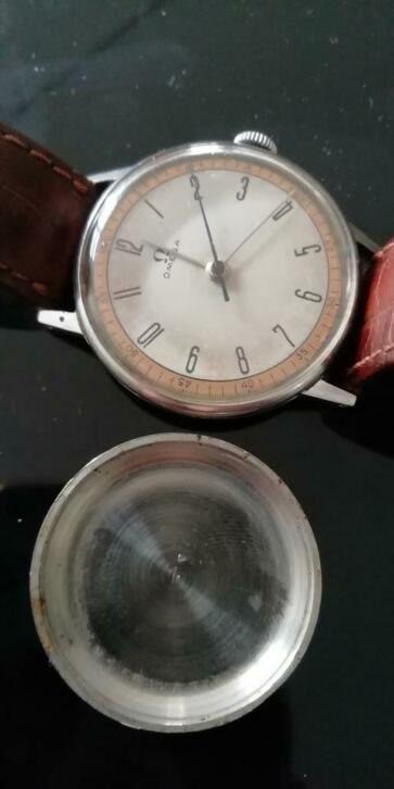

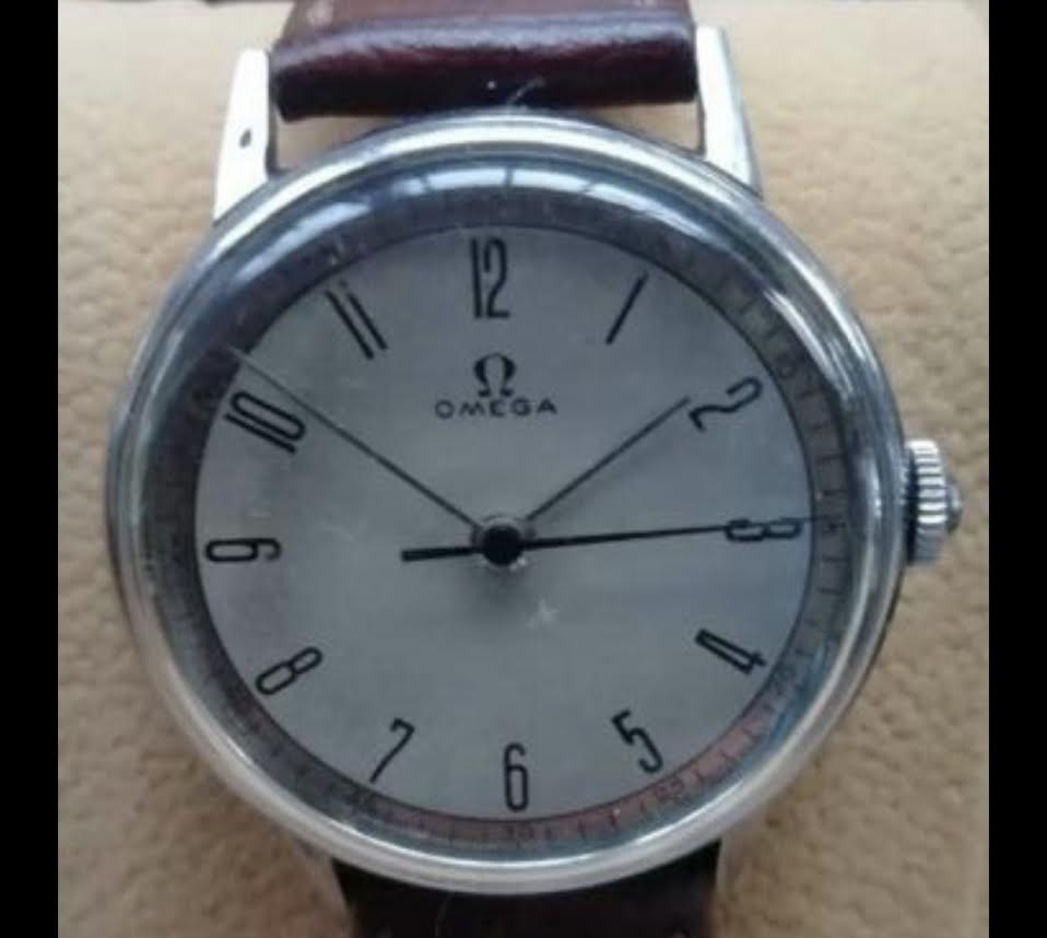

Posts 2 Likes 0 steelneuf ·Apr 5, 2022 Hi found an old omega watch. But it looks suspicious. Is this the original dial?
Posts 5,729 Likes 9,514 watchyouwant ·Apr 5, 2022 steelneuf Hi found an old omega watch. But it looks suspicious. Is this the original dial? And ? What do you think about the case back ?
Posts 2 Likes 0 steelneuf ·Apr 5, 2022 watchyouwant And ? What do you think about the case back ? What do you mean?

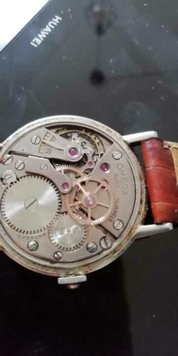

Posts 13,676 Likes 19,045 gatorcpa ·Apr 5, 2022·ΩF InvestiGator steelneuf What do you mean? He means that the case back is not made by Omega. I’m not sure about the case top either. Pictures are too fuzzy to say anything about the dial. Movement is genuine Omega. gatorcpa
Posts 352 Likes 308 Azveld ·Apr 5, 2022 and what about the crown? I would be very surprised if it came from Omega. this watch doesn't smell good...
Posts 260 Likes 673 khangct ·Apr 5, 2022 Movement and crown seem fine, everything else look unoriginal.
Posts 18,840 Likes 39,183 JimInOz ·Apr 6, 2022·Melbourne Australia It would help us help you if: 1 - You posted clearer photographs. 2 - Told us a bit about you and the watch. If the watch came from Switzerland, it has issues. If it was sold in another country, there could be reasons for its construction.
Posts 553 Likes 2,760 Omega D ·Apr 6, 2022 I am no expert and we need clearer pics. However, dial looks refinished in my opinion.
