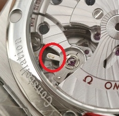

Sounds good. The clone that got me concerned would be this one:
Not sure if there's something I missed there or it's really hard for a newbie anyway.

This is the easy "tell" of some of the fake 8500's

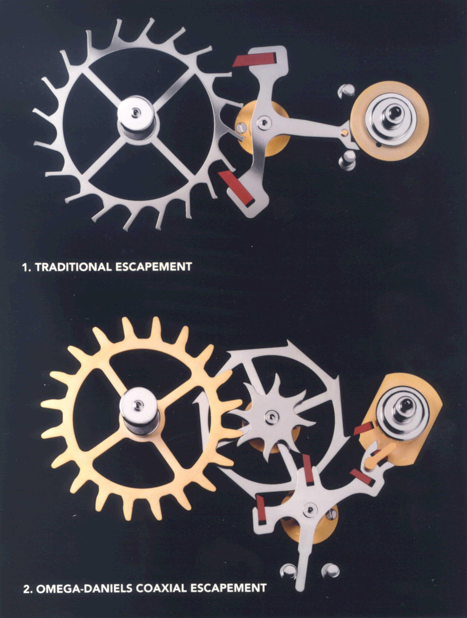

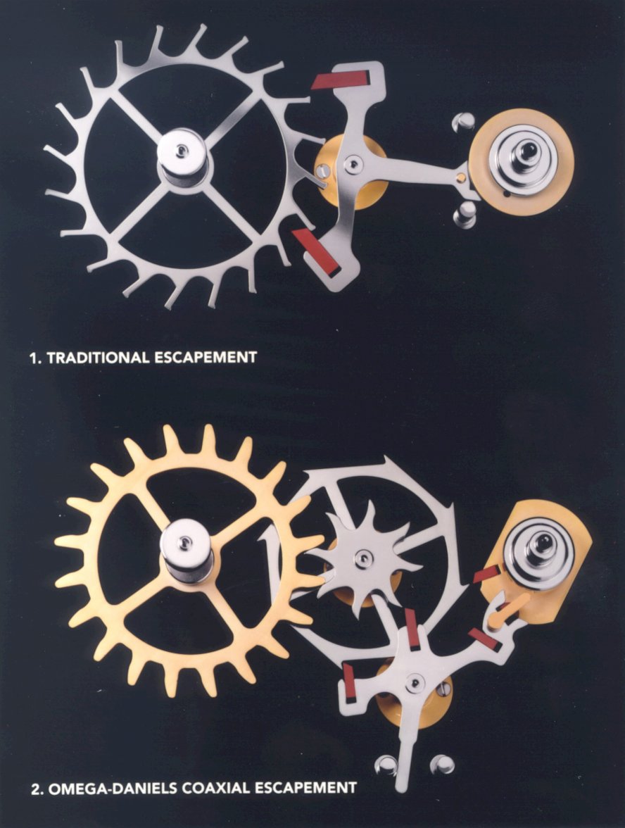

The other easy tell is if you look beneath the balance on the fakes you see a traditional Swiss lever escapement, the Co-Axial escapement. Even Omega had a hard time getting this thing to work so the fakers won’t be able to figure it out for a long time.
