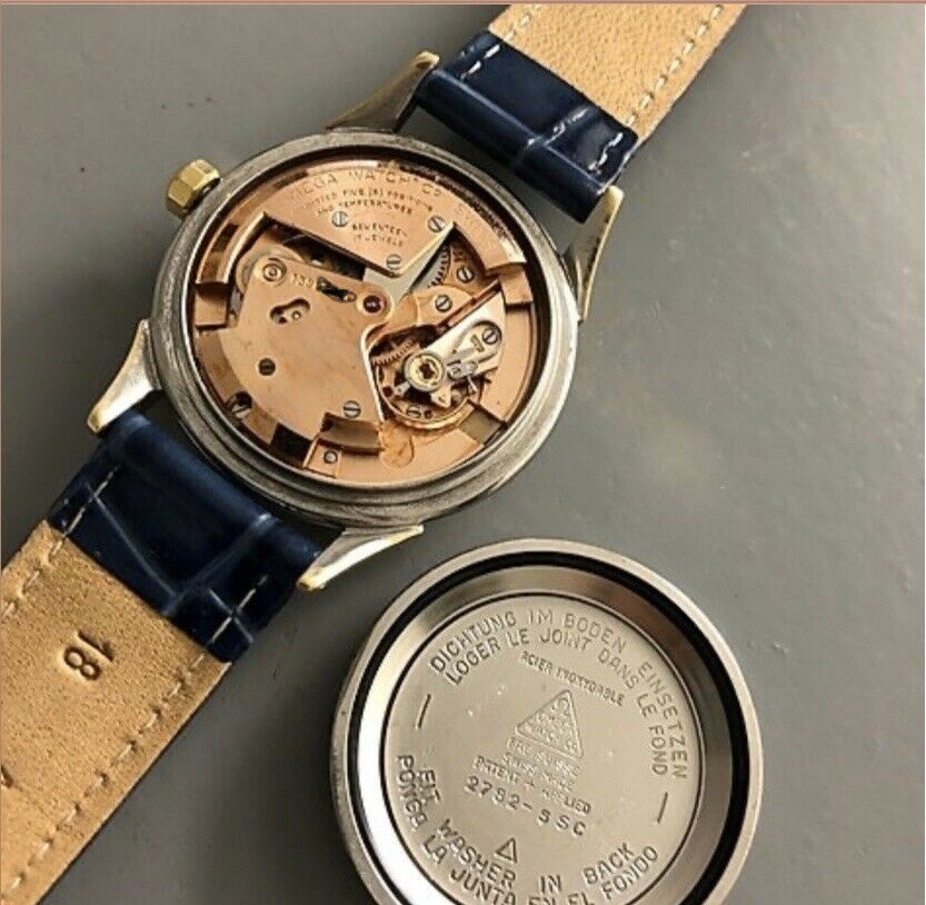

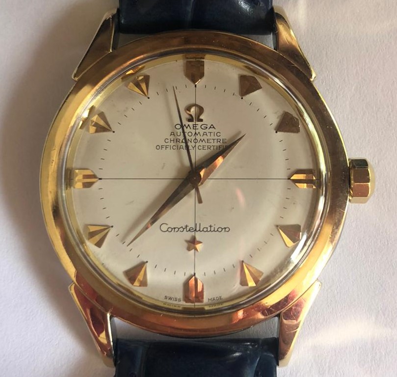

I am seriously considering buying this Omega Constellation (1953 apparently) that is on auction. I have asked on your input before I buy as I think I am wearing "rose tinted glasses" which is impairing my ability to find the potential issues with the watch. It seems too good to be true.
This is my first thread so I hope I have followed the rules and do not offend the Omega Vintage Gods! 😁
The description on the auction says this is a bumper movement (Omega 354), I have checked online and the movement matches other 354's that I have seen. The seller goes to describe the dial as "factory original cross hair very rare white dial" suggesting to me that it is an original dial and not a re-dial. The description says "The case and case back are solid 14kt yellow gold with 14kt gold lugs over stainless steel", This is an odd description for me, is it solid gold or not?
My research so far took me to Omega website where I think I found the exact watch dated to 1954 (https://www.omegawatches.com/en-gb/watch-omega-constellation-omega-ot-2782). The watches next to each other look like mirror images and the model number and movement match.
Here are my main concerns though that I would like your opinion on:
- Swiss made are either side of the hour hand marker rather than under the hour hand marker in the Omega photo
- The Omega site says "18K solid gold", and this is not solid gold, it is acier inoxydable
I appreciate any help you can give, this would be my first omega. Thank you for time Omega Vintage Gods.
Photos are not mine so are not great quality.

It doesn't pass the MOY test 😀 and the exception to the MOY for this kind of dial has a different T in Constellation than the mentioned one in a guide I've downloaded years ago...
I've yet to buy a Connie of this or similar reference thanks to all the guides I might have wrongly interpreted.

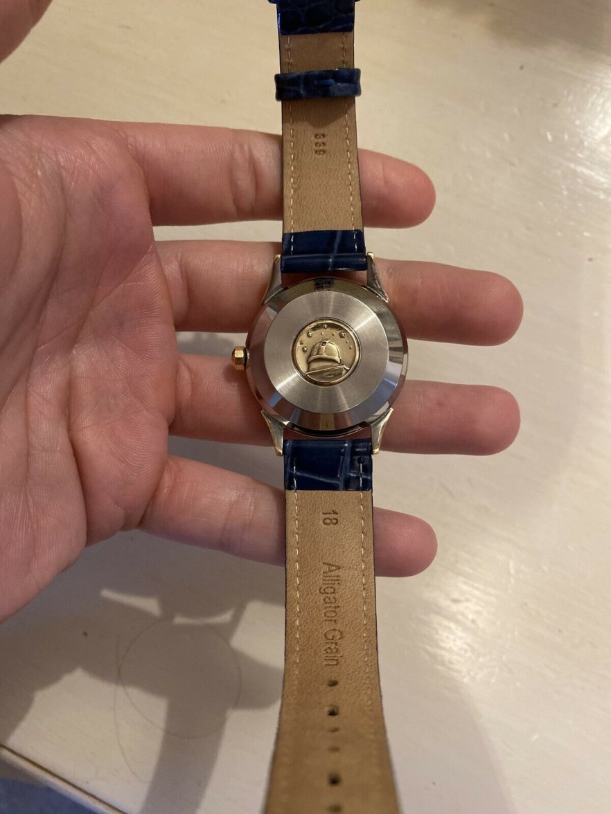

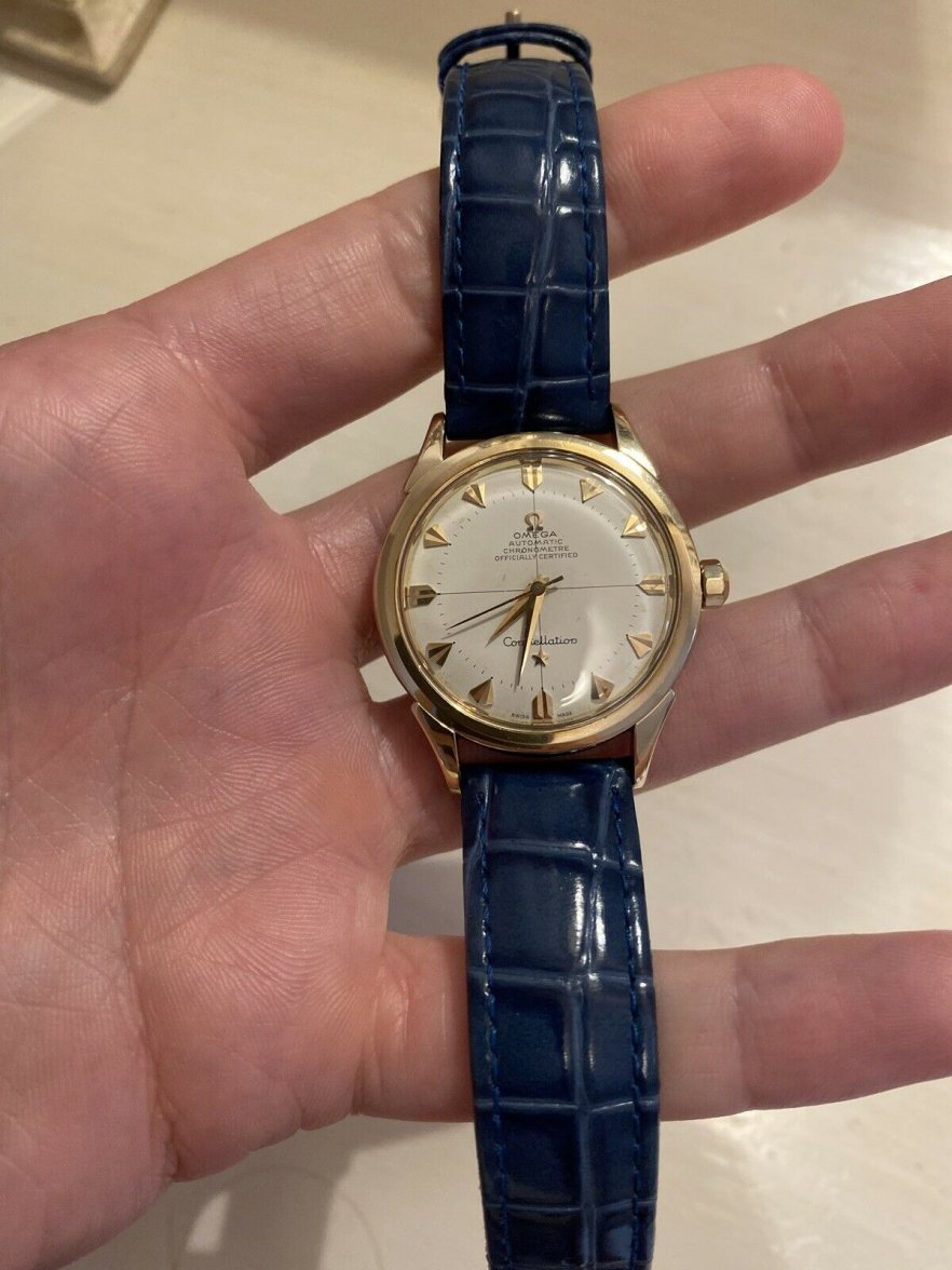

I won this bid in the end 😀 , just received it today.
This is my first Vintage Omega. At first glance, I am amazed at the detail on the dial. I have to admit, Unless you have a professional camera, it must be very difficult to take better photos.

I will ask my Photographer sister to help me out with photos in the future

Congrats to your first vintage Omega!
Dial looks original and in quite good condition.
are those darker spots on the dial?

Yes those are indeed darker sports or marks on the dial. There is also one in between the 10 an 11 mark, and next to the 2 mark.
Thanks Christoph with your help on this.
Are the marks something to be concerned about? For me it reassured me that it was not a repainted dial.
2,298
3,157
I'm not concerned about the marks, just curious 😉
IMO this better picture confirms that the dial is in its original condition

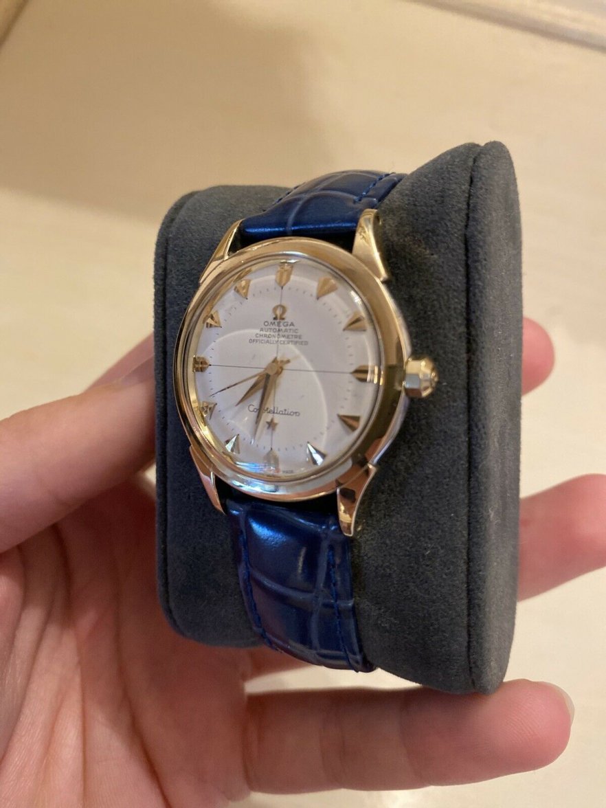

Phew! 😵‍💫
I am admiring the dial in person. Absolutely gorgeous, and it's given me a new appreciation for all of the other members Omega's.
