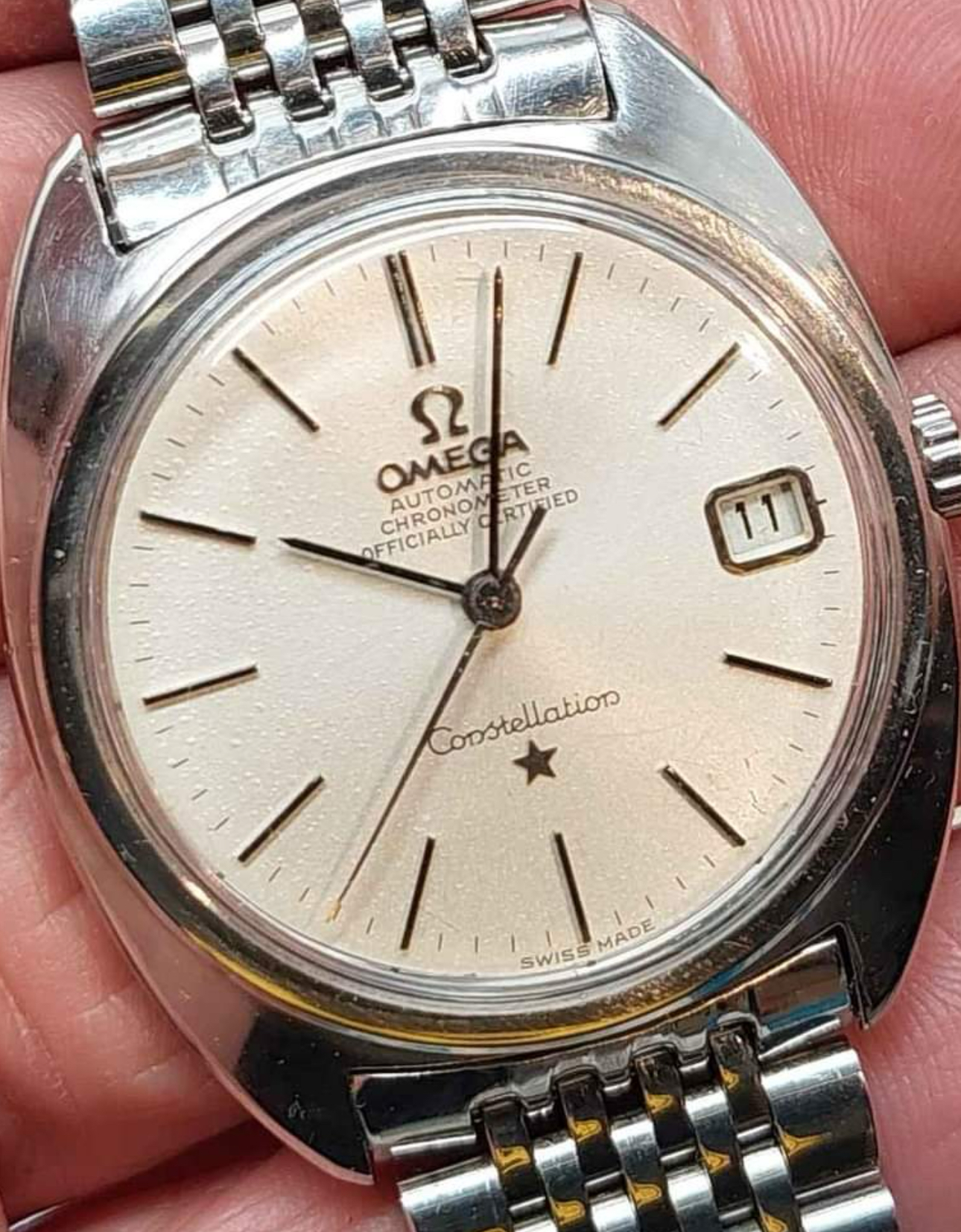

Here’s a better photo of the c case. Seems to have blistering on the dial.
I got the seller down to $800usd, thoughts on the blistering? Movement seems nice and shiny with no rubbing on the rotor.
TBH, I couldn't tolerate the dial or the case. I think that will be a very hard watch to sell.

TBH, I couldn't tolerate the dial or the case on that one. If you looked at the photo and are still interested, I think you probably need to just decide for yourself.

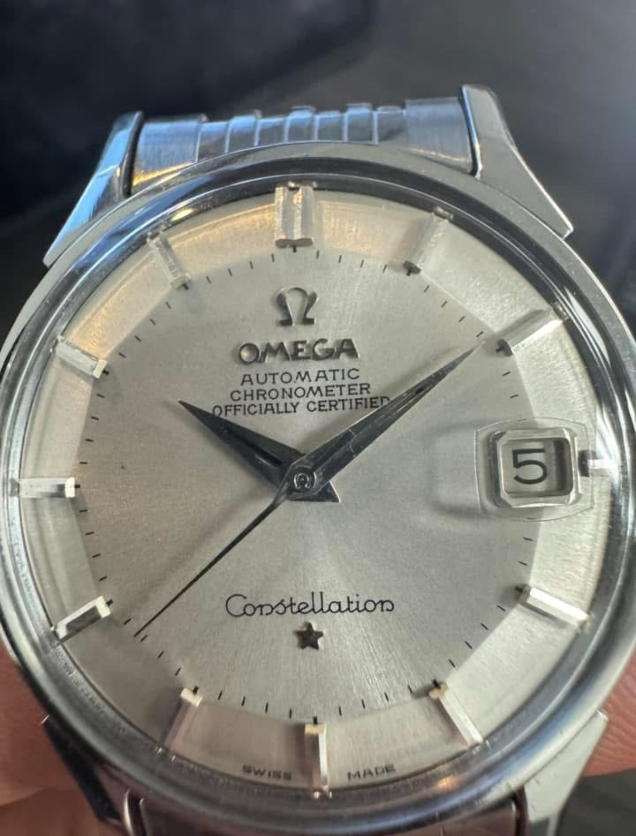

Good evening Omega forum! Been researching and looking for the past few months and came across this listing. It’s a 561 movement, serial number shows 1962 model. Seems to pass MOY but I’m iffy on the “O” in Automatic and Chronometer, shouldn’t the chronometer O be more skinny?
Do you think it’s a redial?

I doubt that this is a redial. The burst is rough. You should check the star and hour markers using a 20X lense to see if the hour markers are fully attached to dial and is there any trace of adhesive

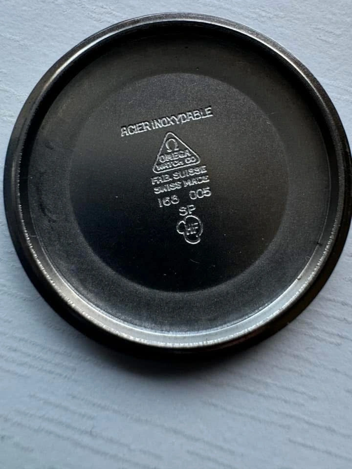

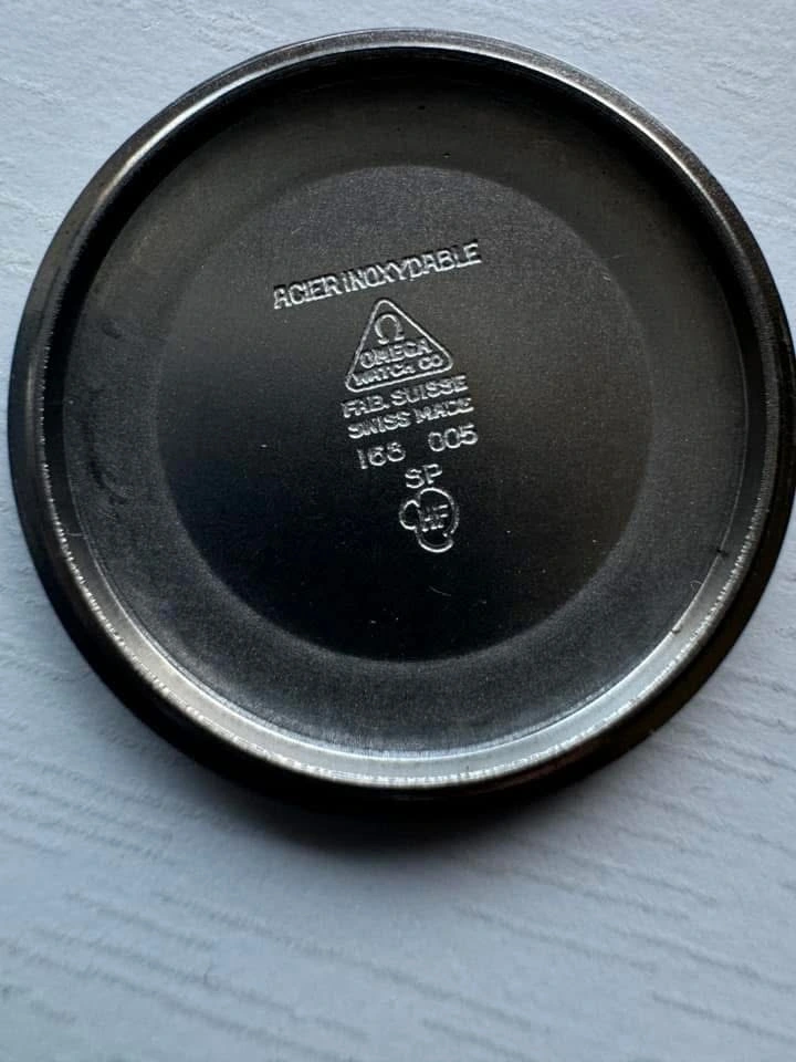

Thanks hant26, I just checked the inner case and it’s an HF case, I believe doglegs should be SGR? I’m starting to think this watch is put together with off parts

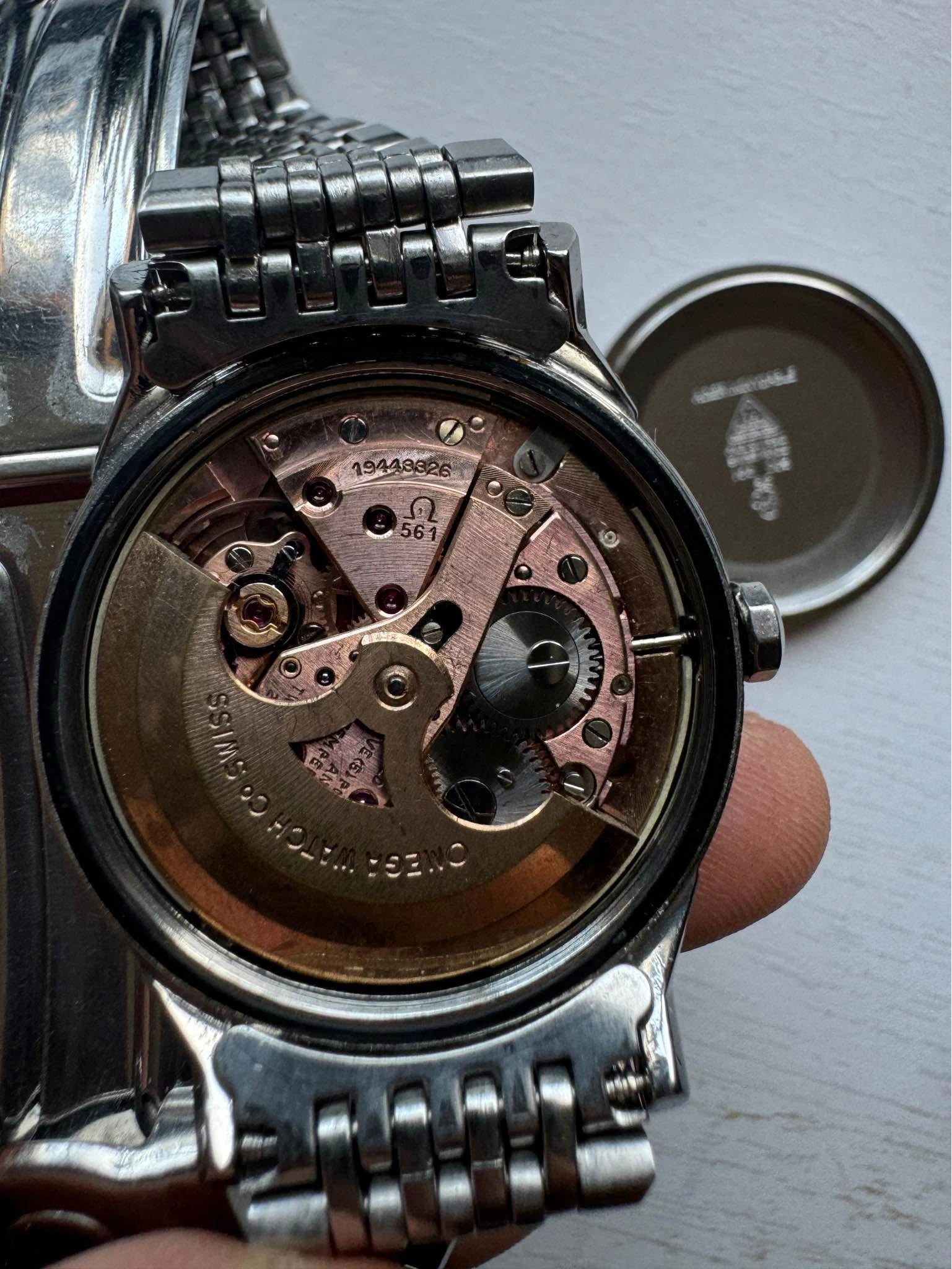

Thanks for the reply, but I just saw close ups of the movement and there’s serious rotor rub and it’s very tired looking. Gonna pass.

Doglegs have more than one case manufacturer and were not just made by SGR.
Not all Constellation dials have the narrower ‘O’ you refer to.

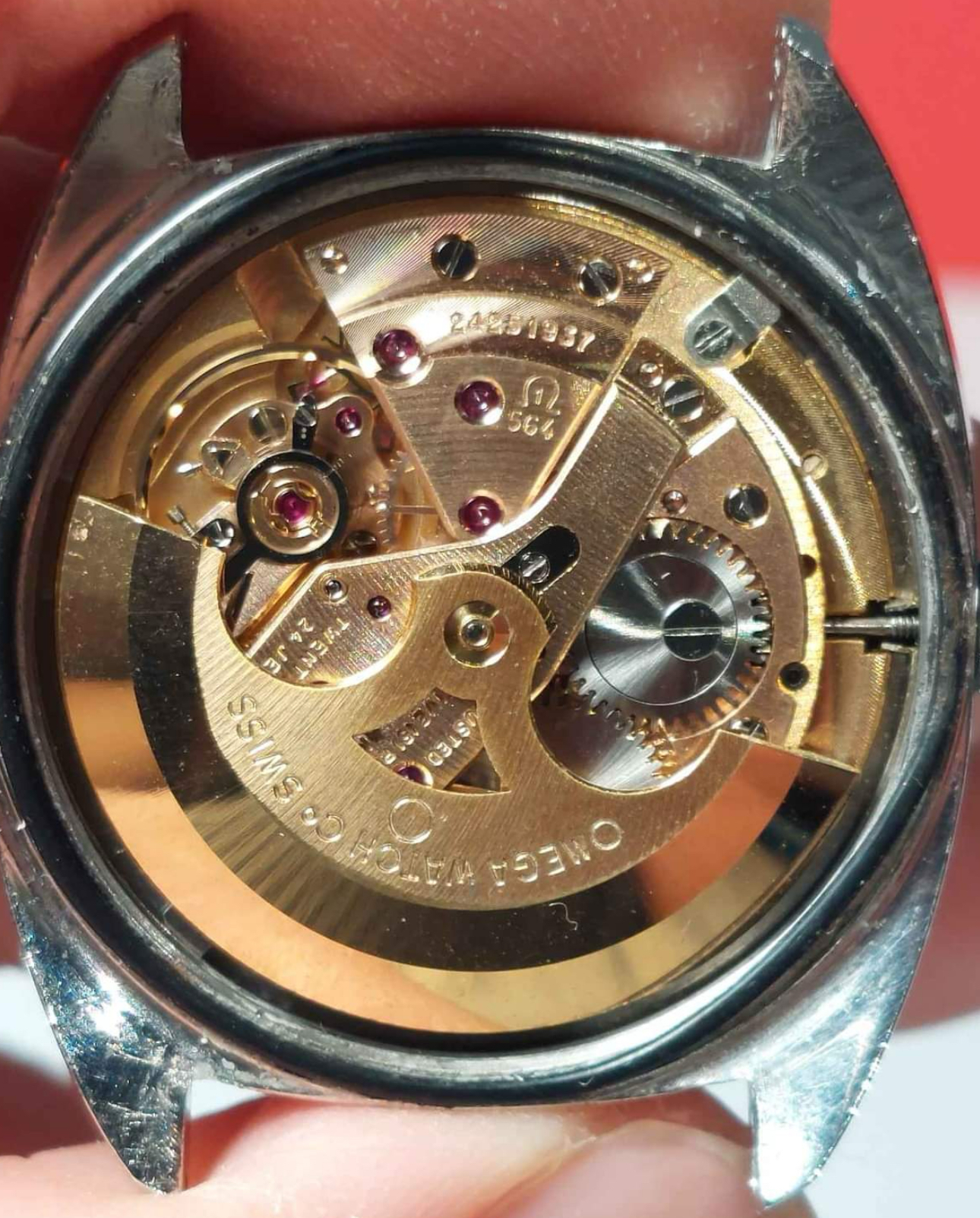

Do you have any other images such as the medallion and movt with serial number?
24
4
Thank you @Tomolok
This is all that was provided. It ended up selling last night for more than I was willing to pay, $1300usd.

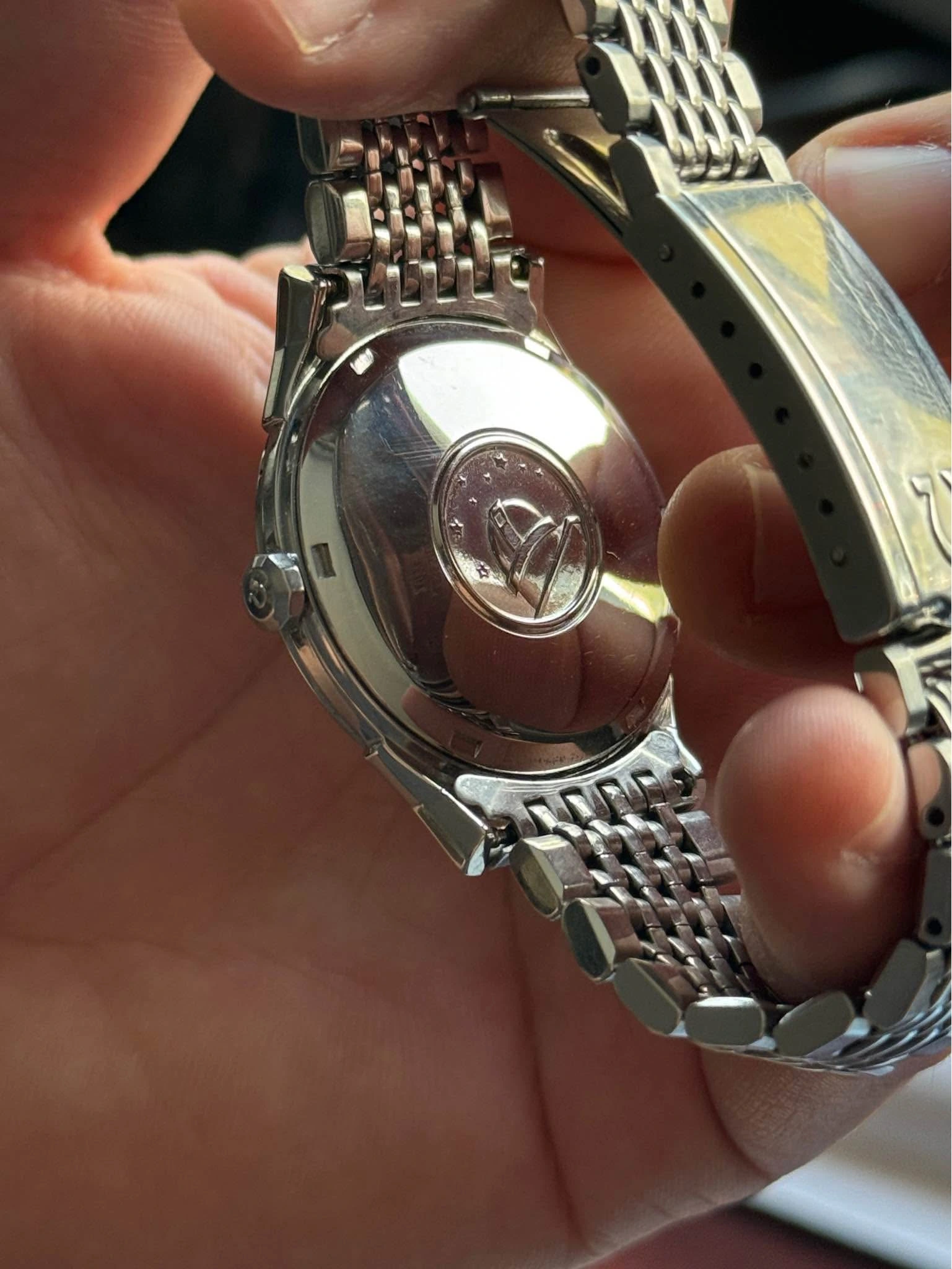

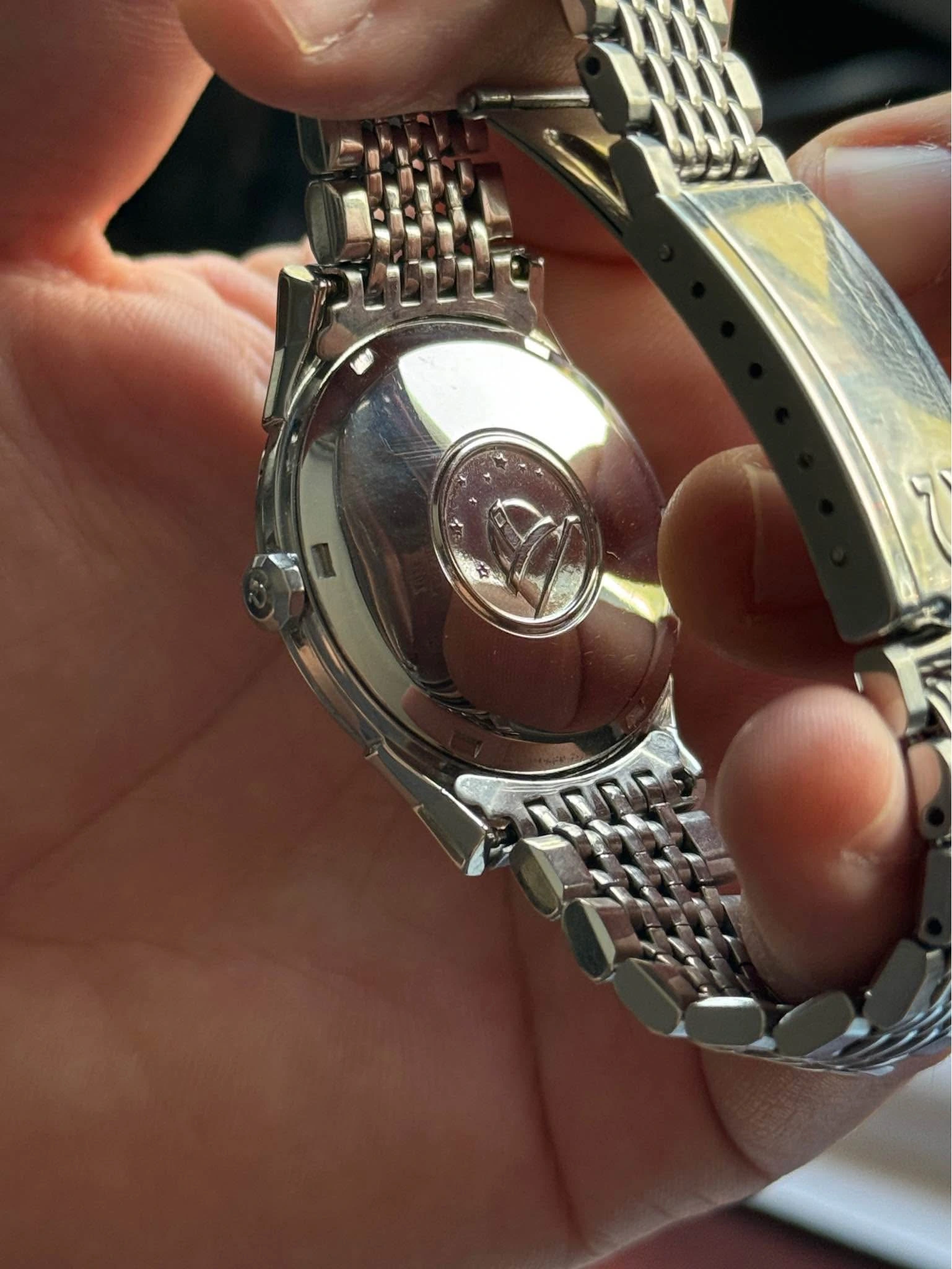

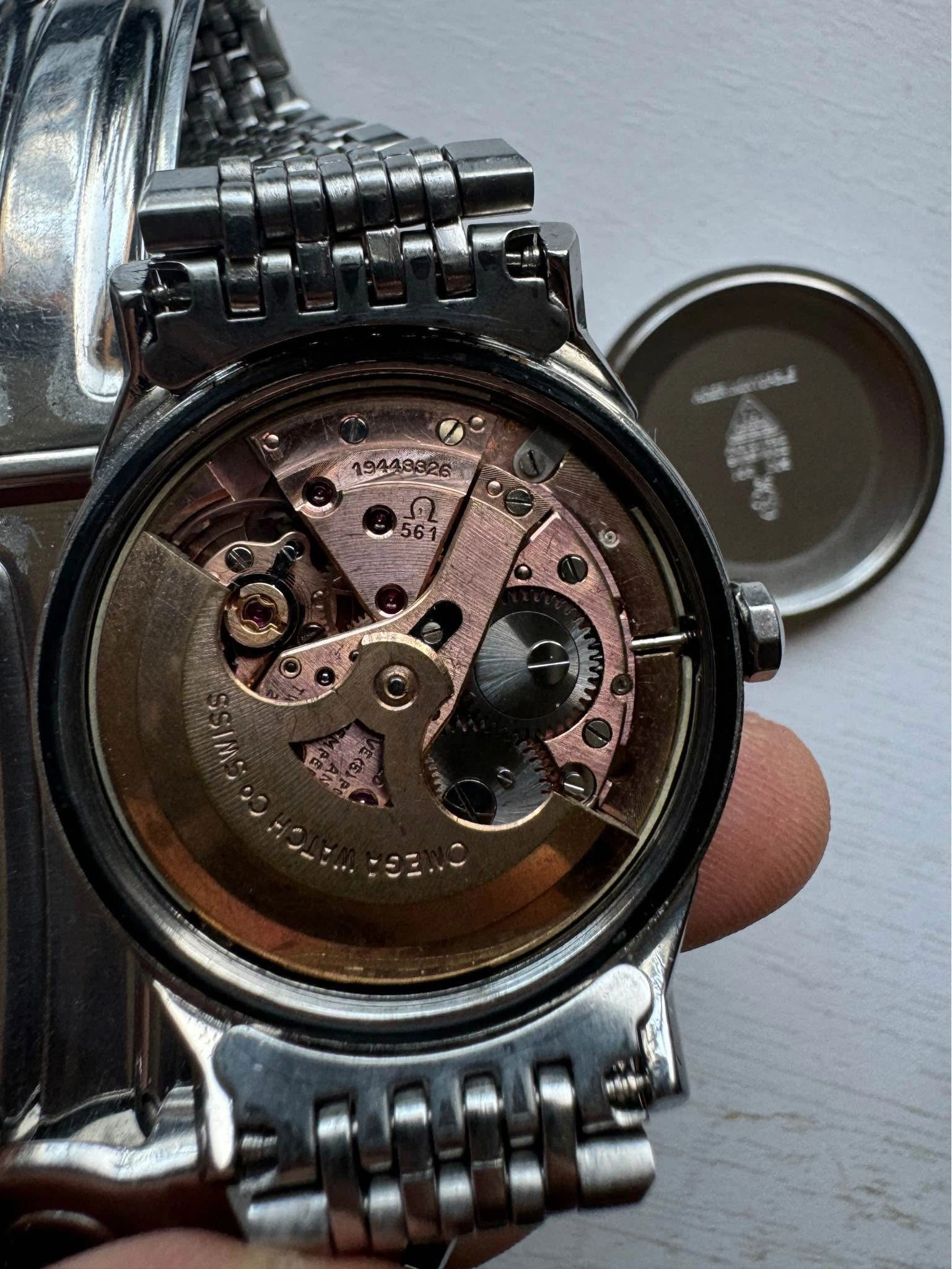

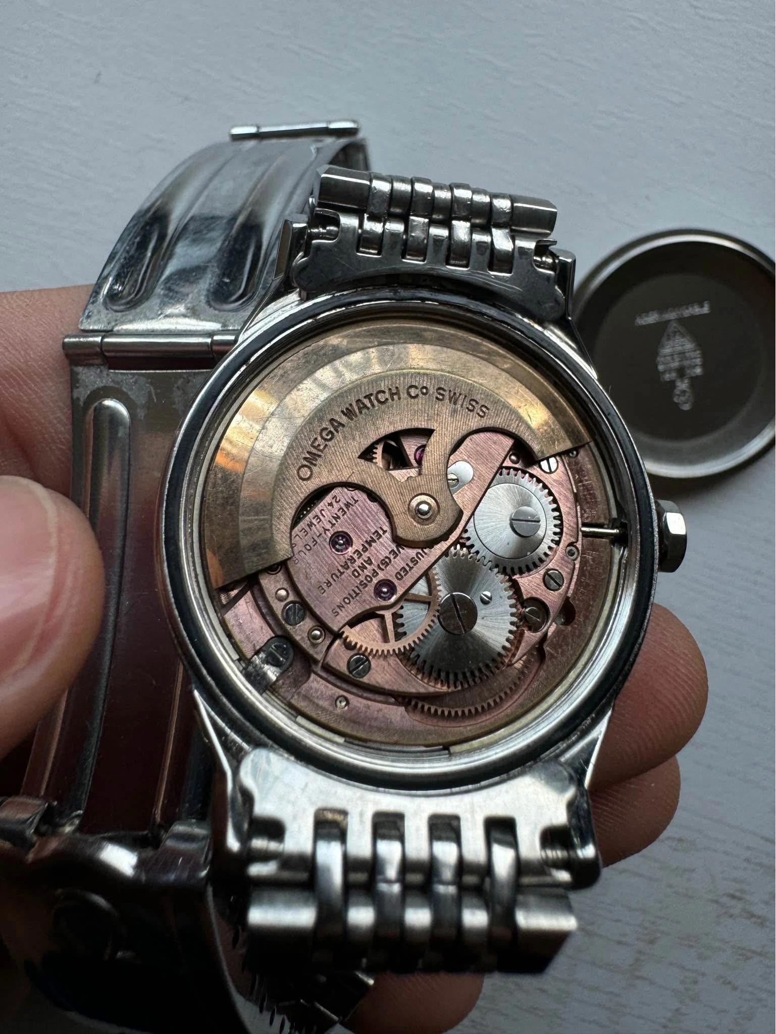

From what we can see from the additional photos, the caseback does not fit with the movt, as it would have perlaging.
It’s not a great image to assess but the caseback is a replacement at best.
The rotor has been replaced and the movt does look a bit grubby.
The 19’4xx serial does align with the lumed dial but no Ts.
The dogleg lugs and bezel are soft - I think you did right to let this one go.
Thanks peemacgee for the feedback and supporting my decision. But even as a mishmash of parts, it still sold to an unaware buyer unfortunately for $1300 (auction) in a local forum.
Just for my own knowledge, what would this be worth?
6,836
10,508
Always difficult to value a less-than-perfect piece.
Much easier to price a good watch.
Decent enough dial but the rest is sub-standard.
Certainly significantly less than $1000.
To a collector it’s only a dial and movt parts.
