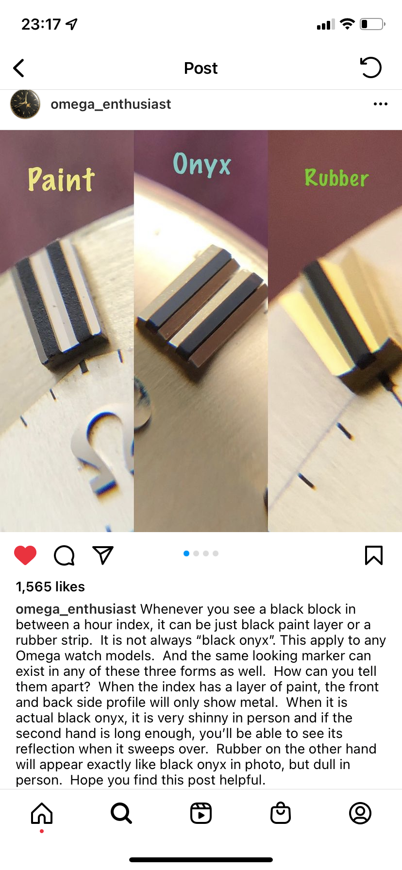

Sorry to resurrect an old thread, but I wondered if this might be a good place to discuss this. I’ve read that true onyx inserts can only be found on gold dial/marker constellations, and SS ones have rubber instead. I was wondering if anyone can shed further light on this? The difference is in the depth; onyx is shiny and a deeper black whilst the rubber is more matte.
the question is, where did you read this @norb1967 ?
This claim has been made before in a thread - once again citing someone else’s writings.
But there has never been any evidence to support the claim.
Would be useful if you could link to the source.

It was in an Instagram post by Omega Enthusiast from early 2021. I didn’t link it at first because I don’t want anyone to think that I’m accusing him of spreading false info or anything! However it did get me thinking. I hope it might spur a discussion. A screenshot of the post below:
thanks @norb1967
IIRC this is the information that was quoted last time the matter was raised.
it’s okay to raise someone’s posted info on the internet when you think it might be wrong or questionable.
Omega enthusiast posts some interesting stuff but he (she?) doesn’t always know what they are talking about.
( I seem to recall a post about hidden crown Connies where most of the info was correct but the remainder was just plain incorrect)
There is no evidence that we know of that Omega ever used rubber in their inserts.
Who knows where Omega enthusiast got this idea from?
I, for one, would love to see their source material because their claim is out there without any evidential proofs.

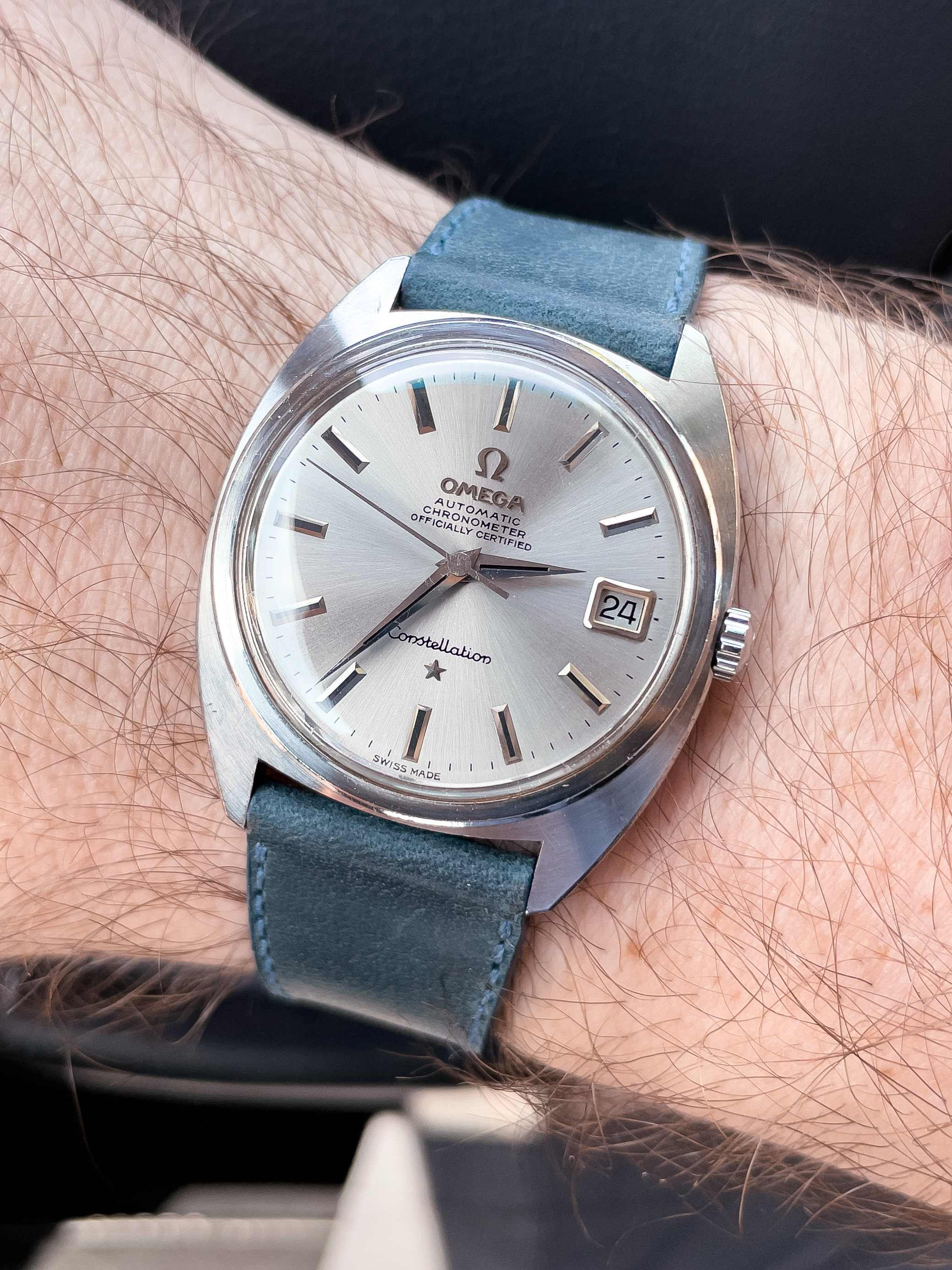

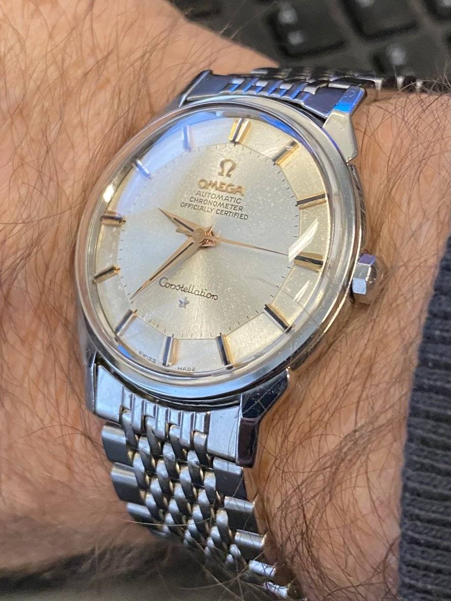

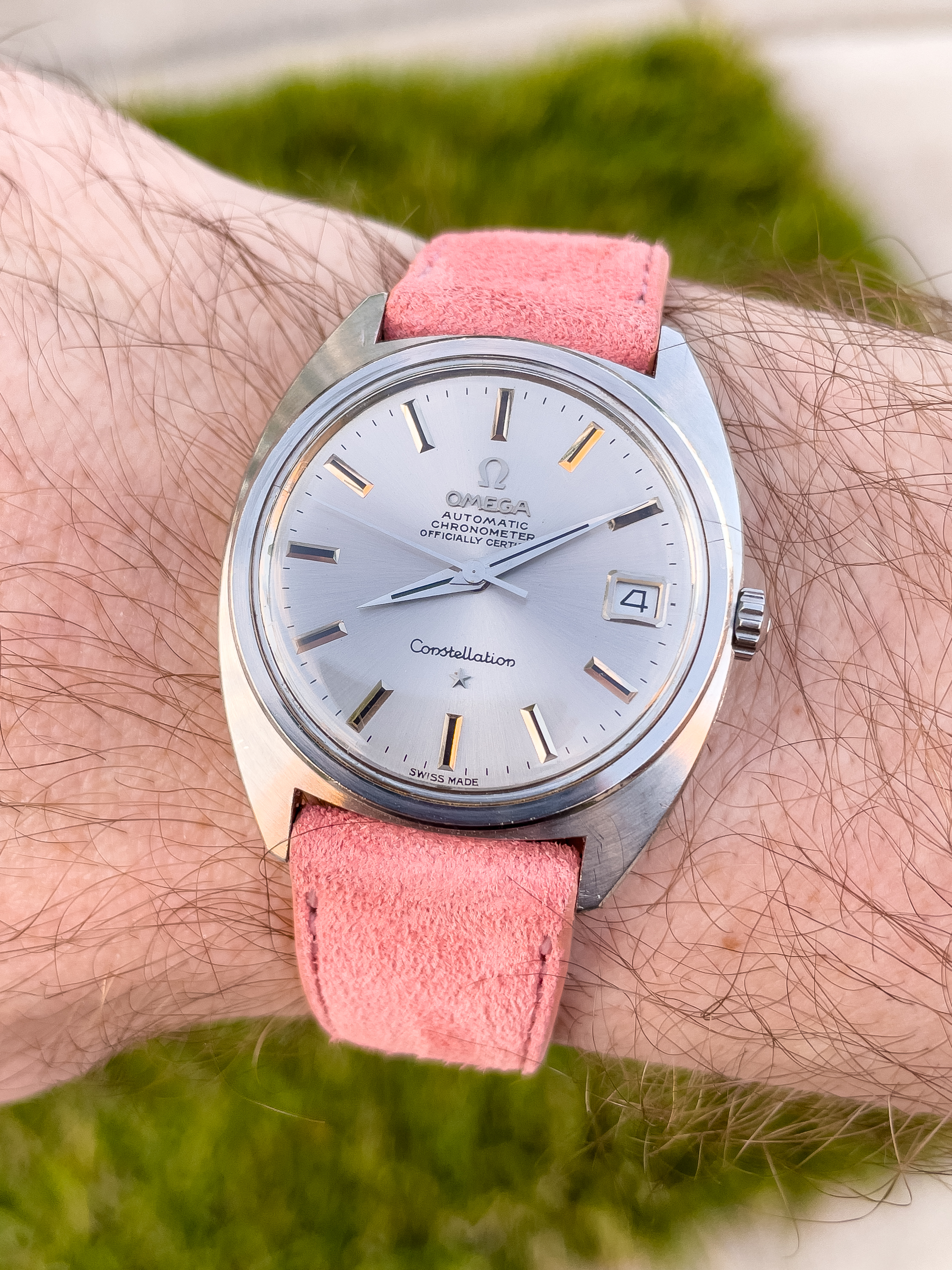

The pics shown above illustrate Constellations with:
Painted indices.
‘Fat’ flat onyx inserts only found on solid gold deluxe dials
Regular ‘prismatic’ onyx inserts found on 50s & 60s Constellations - yellow gold, pink gold and (I believe) rhodium plated steel silver-coloured indices.
( there are some Connies with white gold indices but I can’t recall seeing any with onyx inserts - but that doesn’t mean they don’t exist)
Note: indices styles on Connies changed towards the end of the 60s and into the 70s whereby they started using more ‘brutal’ chunky indices (some with big flat onyx inlays)
They also reportedly used jet as inserts on some watches from mid/late 60s ( a hard black semi-precious gemstone related to coal)

It’s early and I’ve been up through the night with our little boy, but I’m a bit confused about the above posts.
@norb1967 is asking to discuss the possibility that onyx insert were only used on gold dials/markers, quoting OE as the source. However, no where in that post is that claim made. It’s just stating different materials were used and how to identify them.

Oh sorry, I should have clarified. He told me that (about onyx only being on gold dial ones) in a PM when discussing a watch.
12,938
22,387
Gotcha. I think that’s nonsense.
