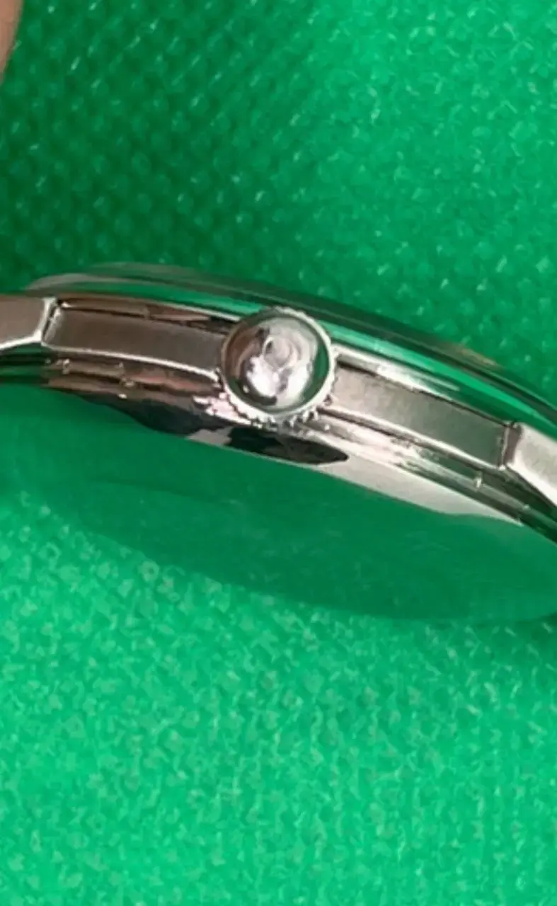

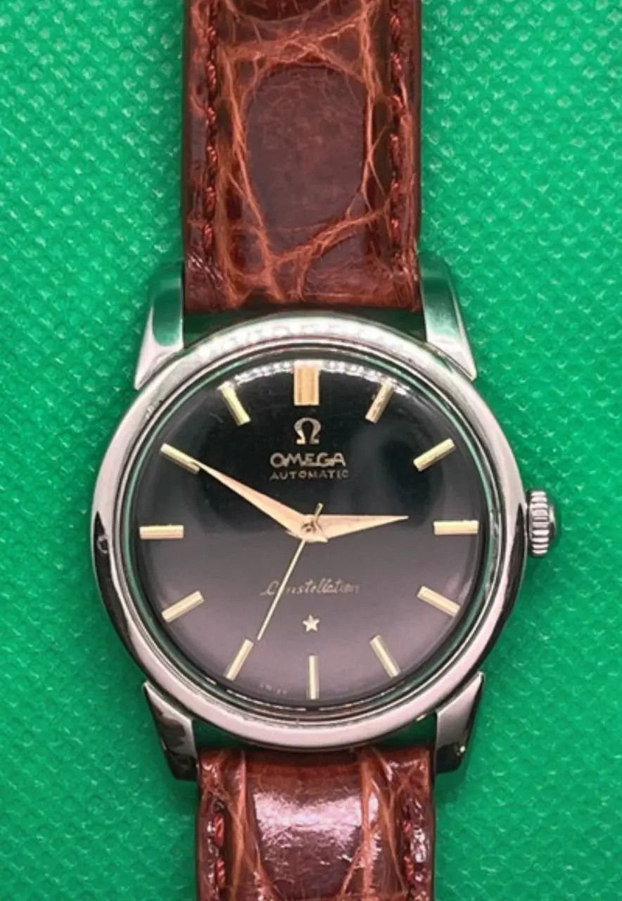

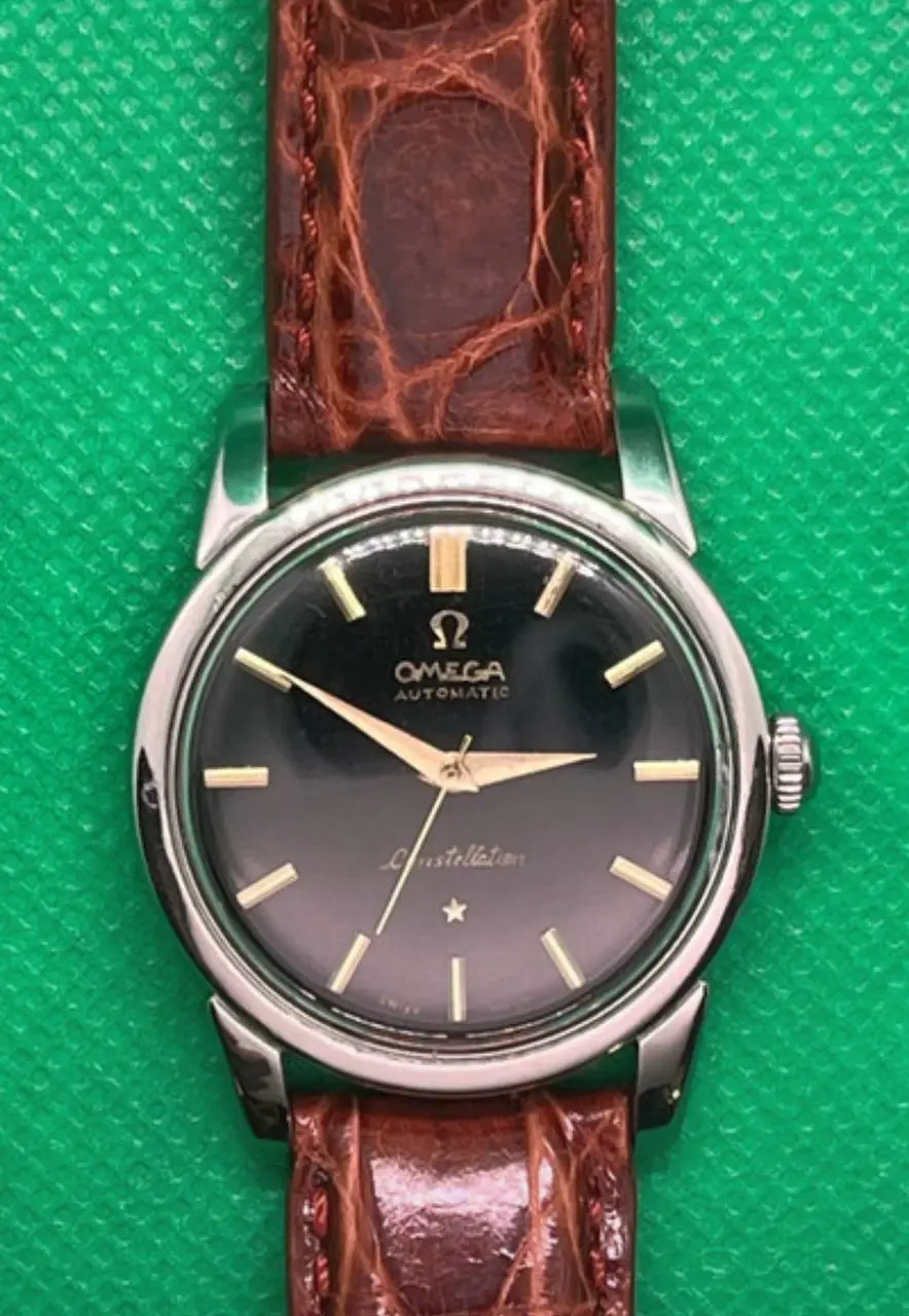

Can you help me to identify this Constellations ?
3
I found this watch on a market and I wanted to buy it, could you help me to understand how much it's worth and identify the model please ?
10,757
16,747

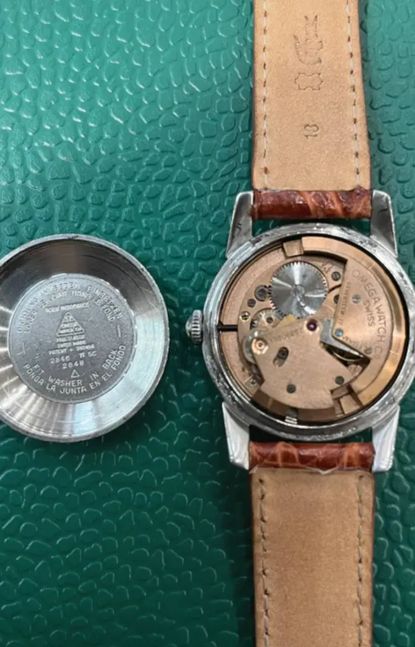

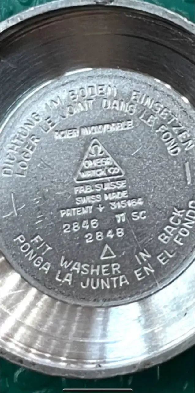

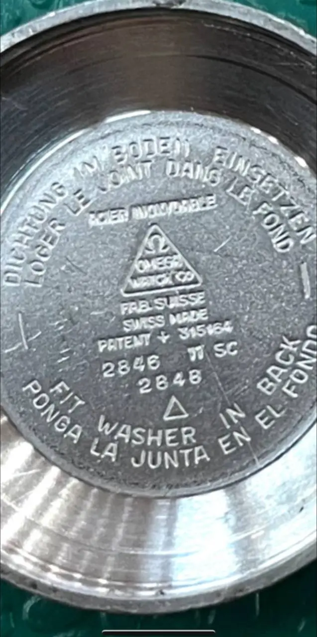

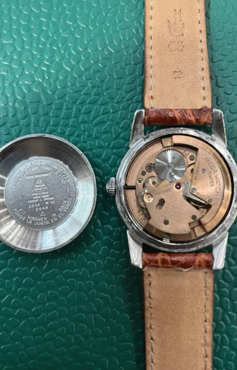

That is a very nasty redial. Pity. The movement and case don't match. It's a right mess with the parts of at least 2 watches, maybe 3, worth the sum of the parts at best. Search on Omega 2846, you'll see that it is not a Constellation and doesn't have that kind of movement.

Oh thank you so much <3 Can I ask you how you identified that (also which website, if any, you used) ? I want to learn as much as possible
10,757
16,747
As above, search on Omega 2846, you'll see that it is not a Constellation and doesn't have that kind of movement.
3
Oh sorry, I didn't saw that you edited the message, thank you so much again!
