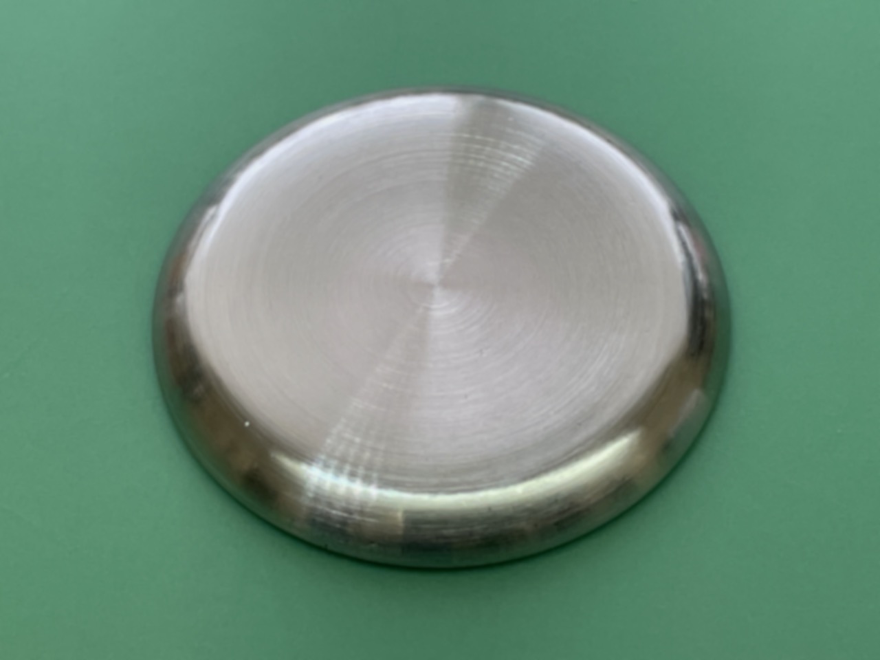

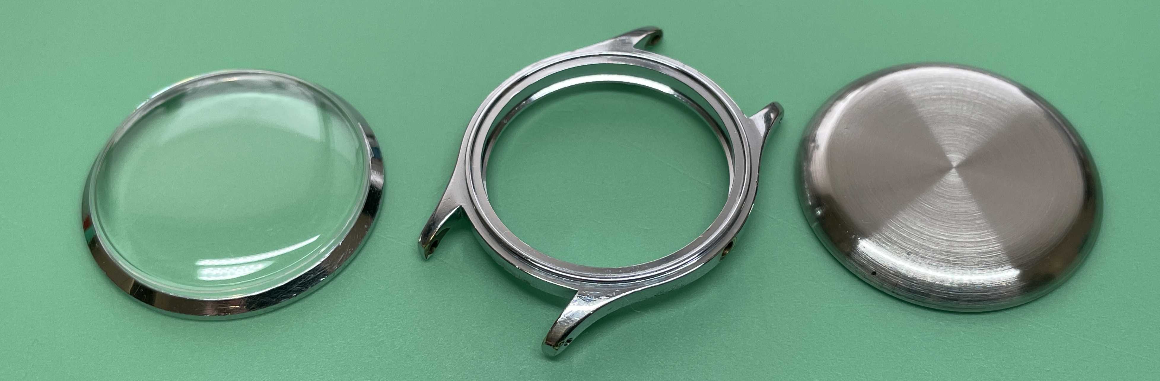

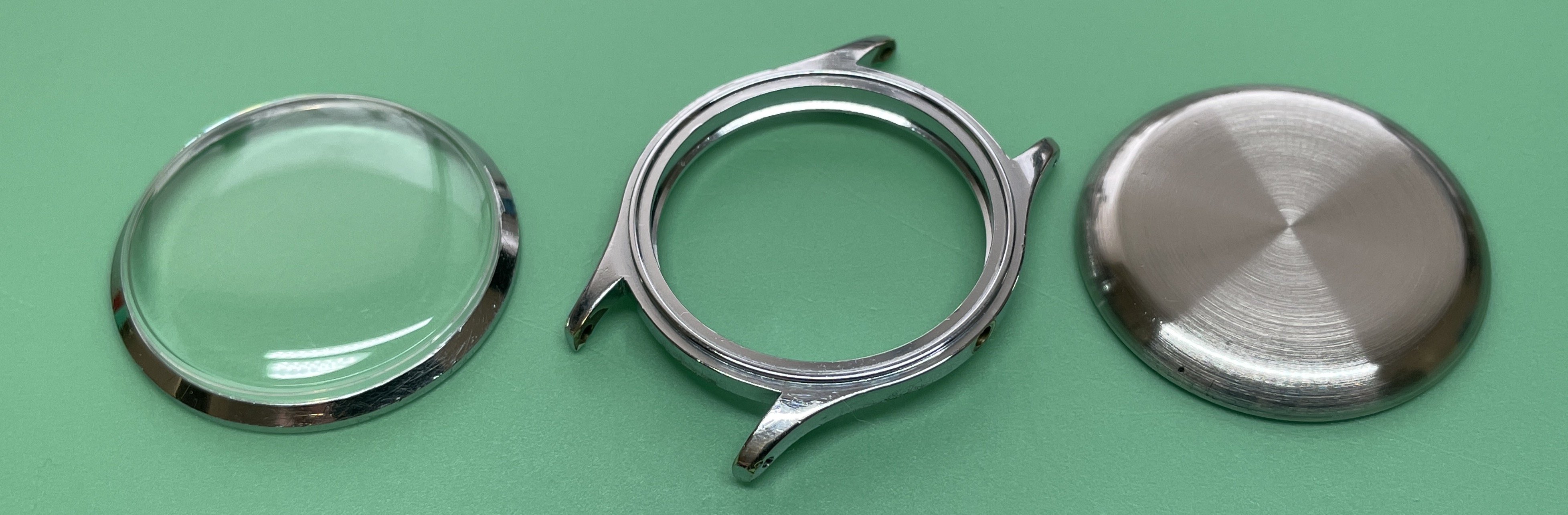

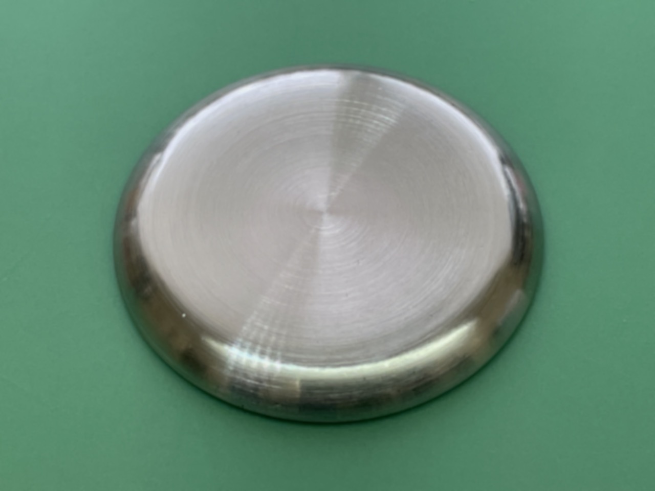

Caseback was also cleaned up to remove wear marks and scratches.
So now all parts of the case are ready.

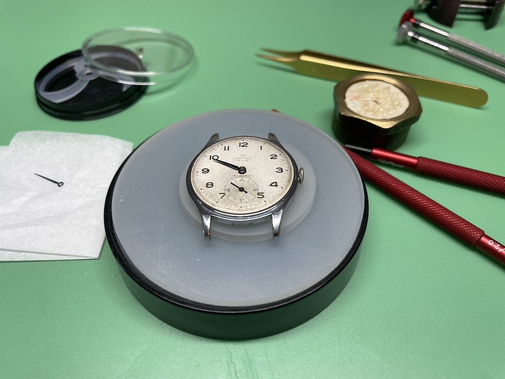

Time to get moving with the last steps.

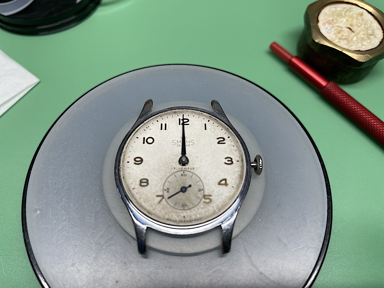

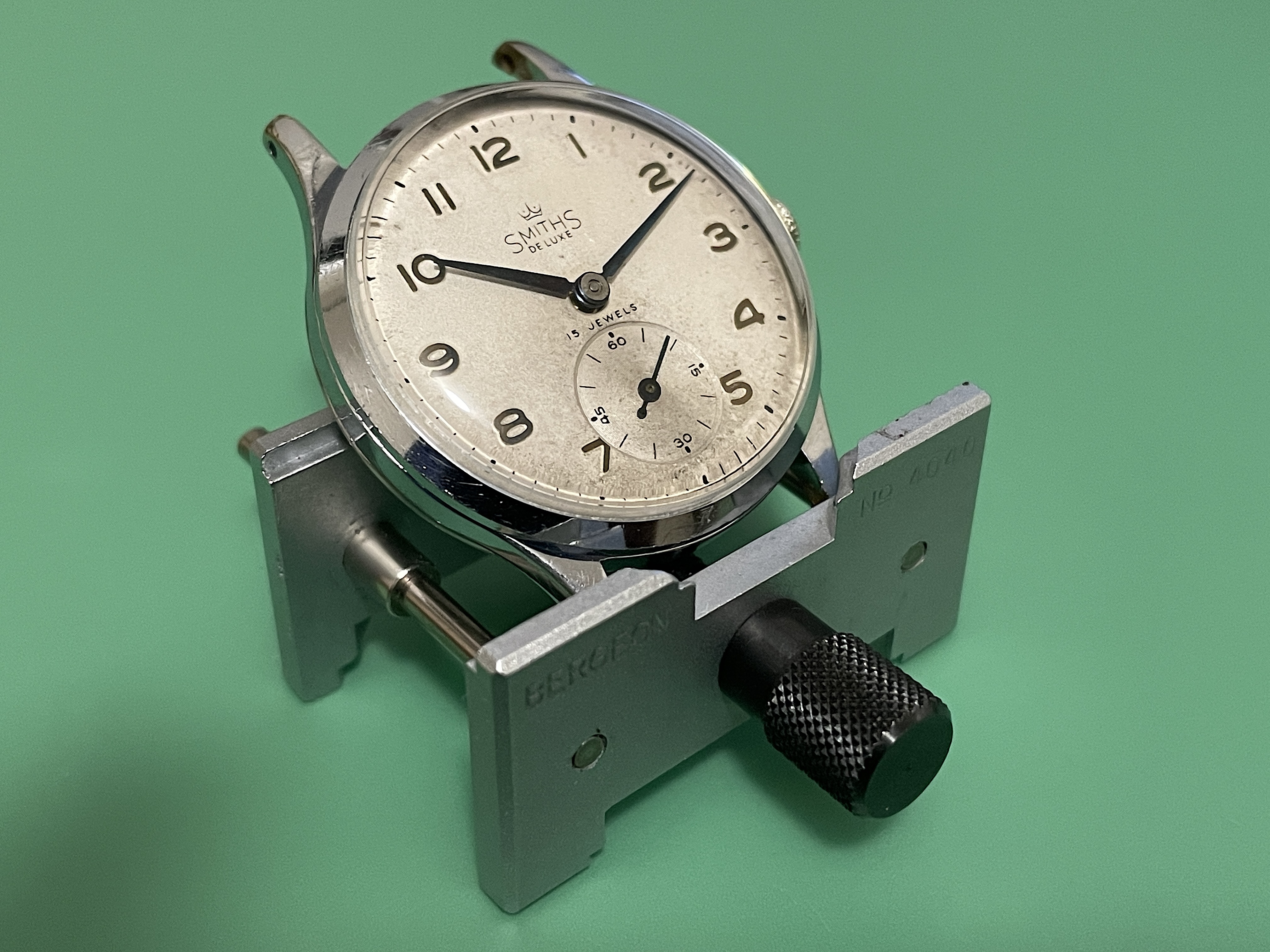

The dial (after a light clean) was fitted to the movement.
Hands were next, Starting with sub-seconds, and then hour hand.
minute hand was then correctly fitted and checked for alignment.

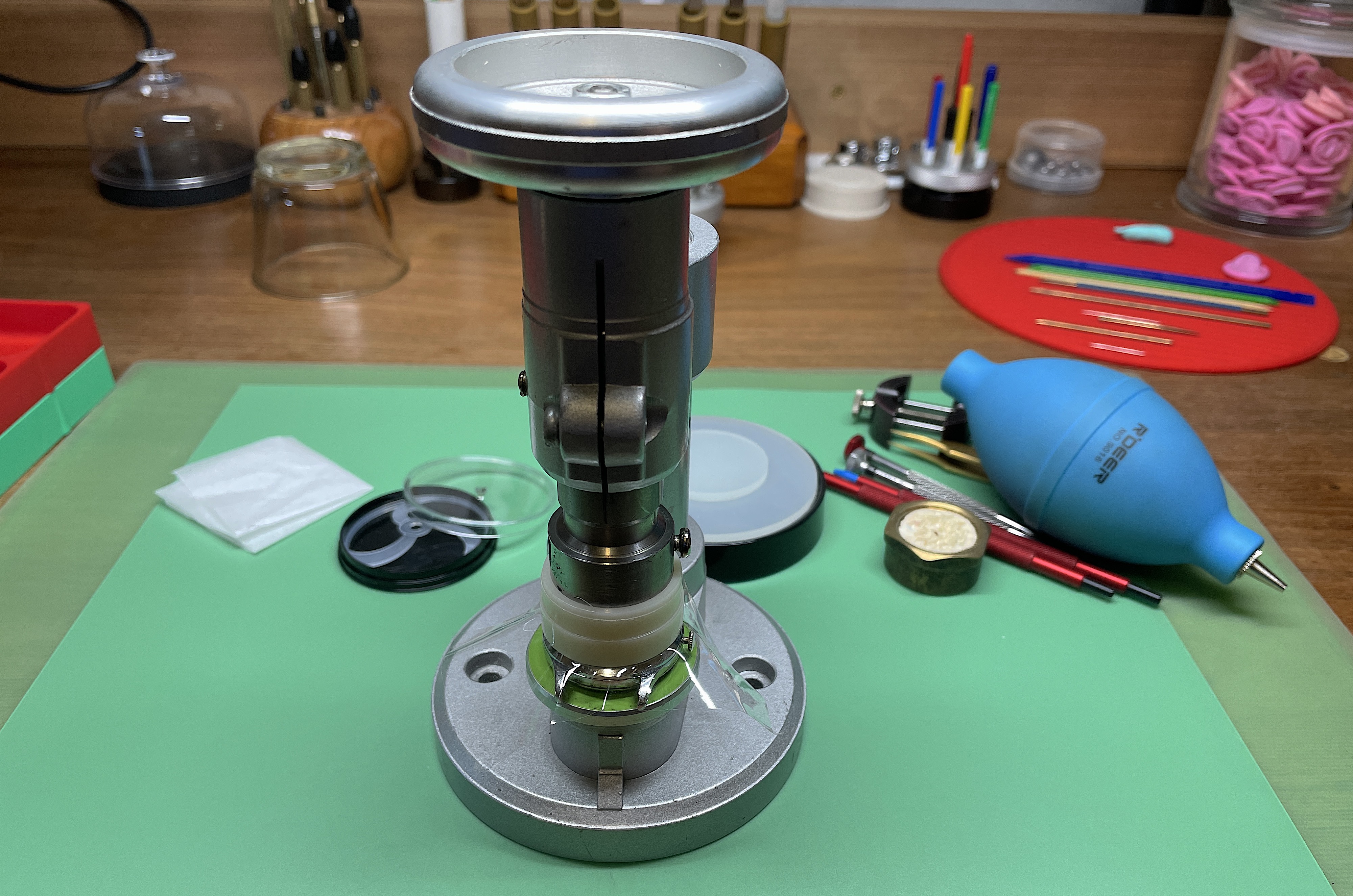

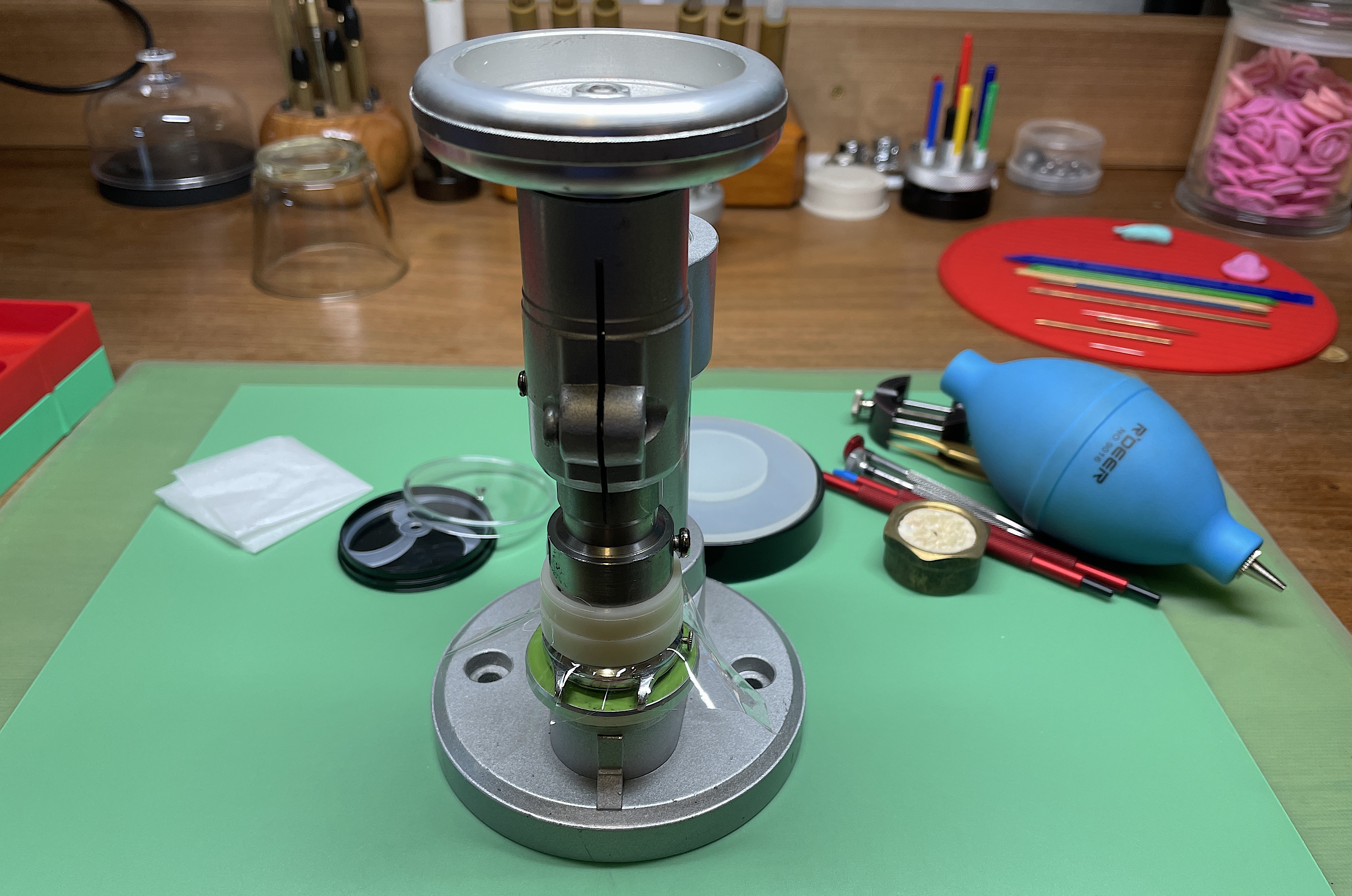

Just need to press on the crystal and the caseback.

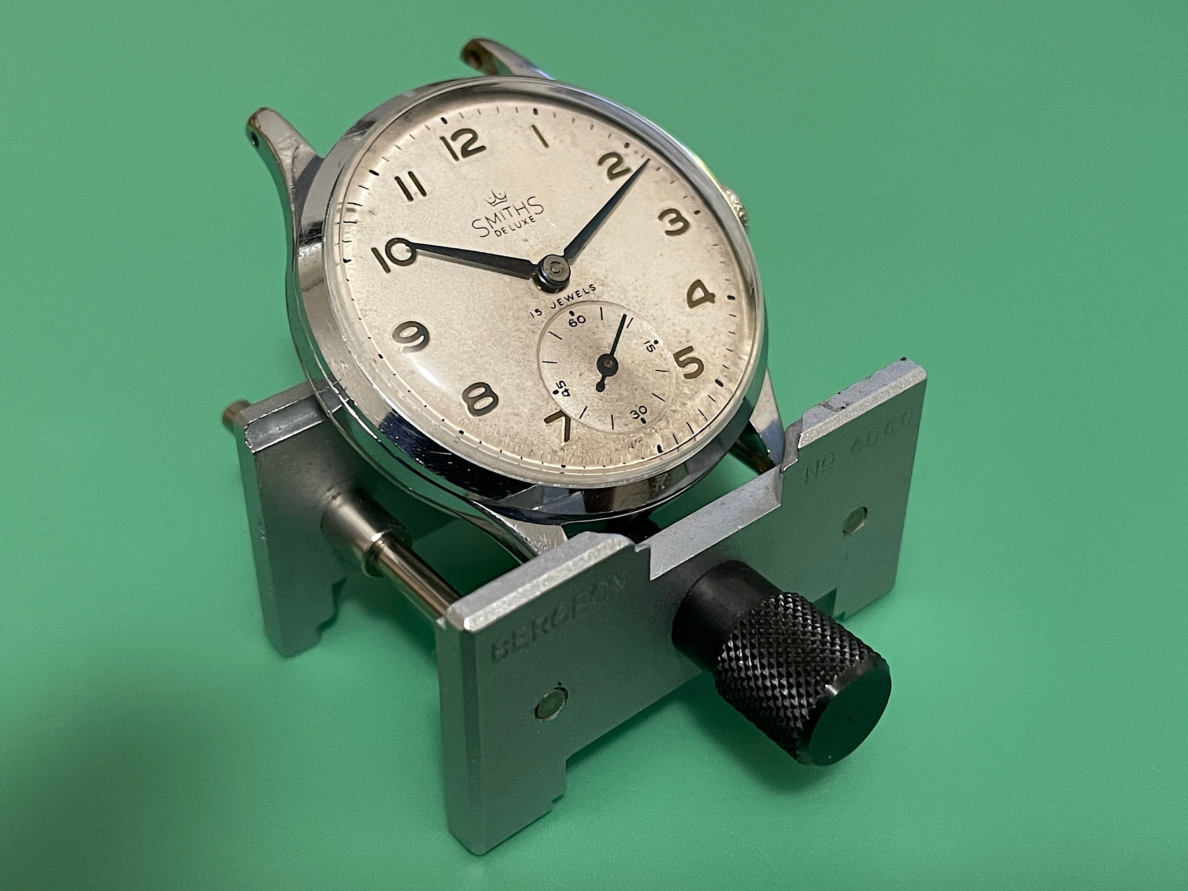

and there we have it.
18,844
39,191

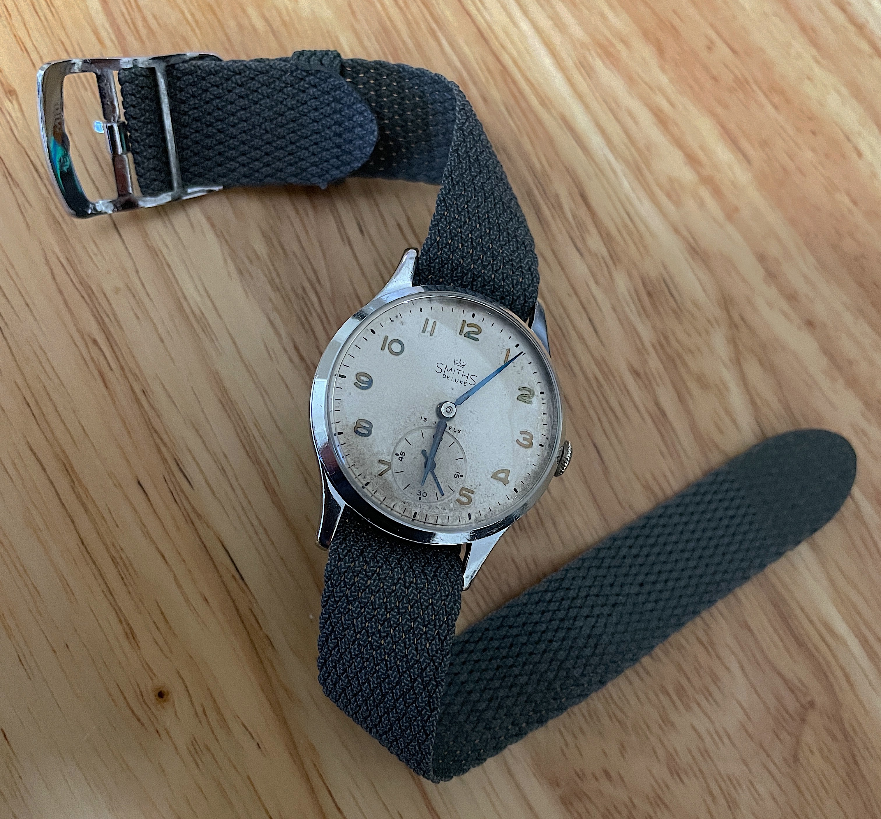

Can't close without a couple of shots.

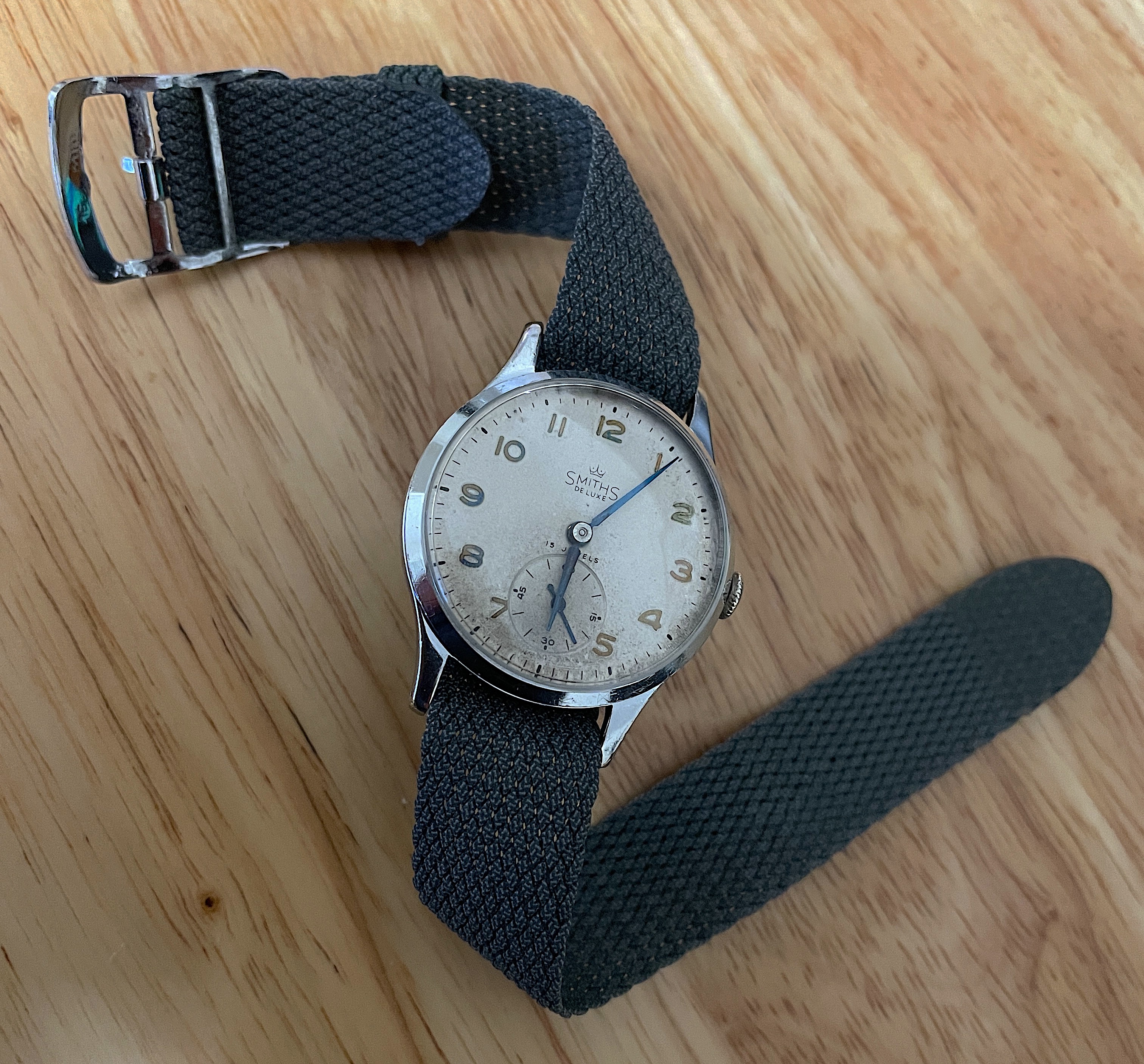

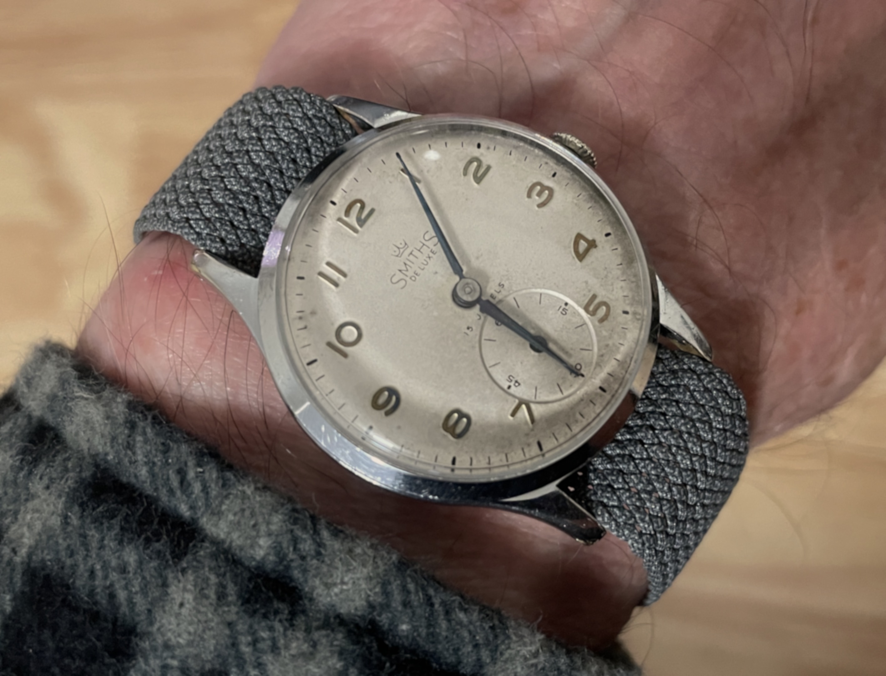

On the wrist
and a goodbye shot, on my bench, Smiths De Luxe.

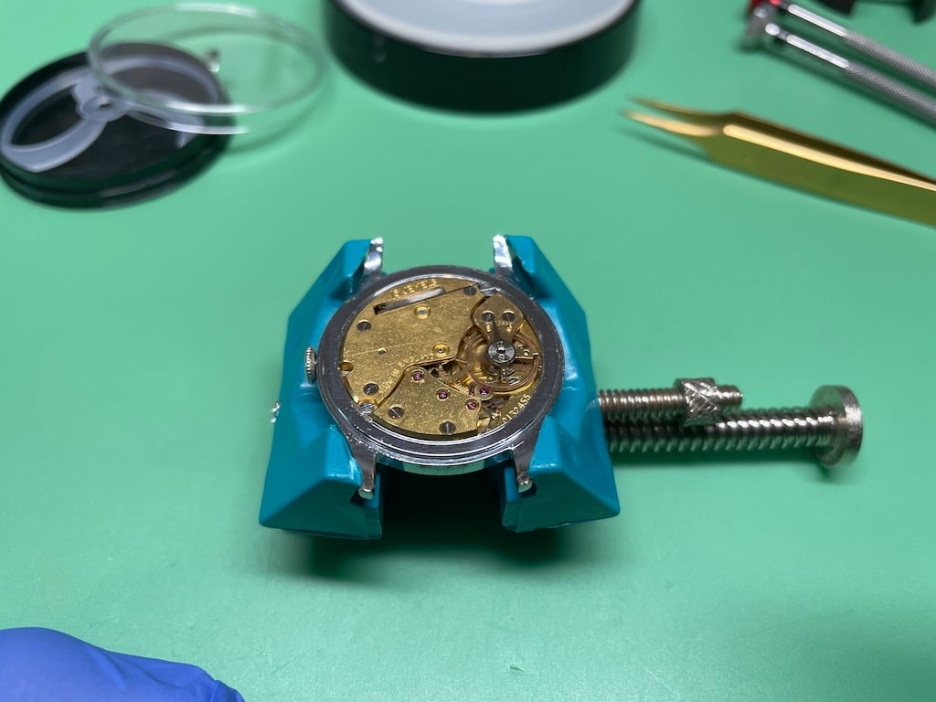

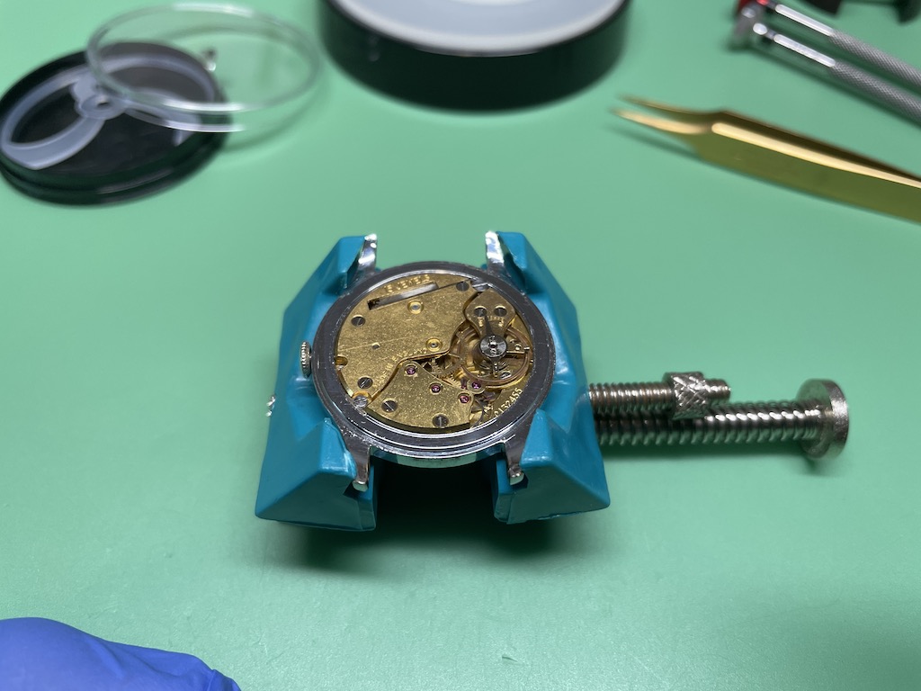

That was fun. All apart and adjusted and while putting it back in the balance cock slipped of the tweezers and pulled the balance out of the movement with it, stretching the hairspring in the process.
So two more episodes of this.
Balance removed and laid on a soft surface so I could undo the stud screw (silver one) and turn the boot so I could lift the balance wheel/hairspring off the cock.
Then the balance wheel was inverted on a brass block and a shaped pivot wire is used to rotate the collet. This moves the position of the stud in relation to the impulse jewel, and when it's back on the movement, hopefully the impulse jewel will be closer to a theoretical centre where beat error does not exist.
Note that the hole the balance wheel is sitting in is 4mm diameter.
After getting it back together, things started looking OK again. Beat error is much lower and I could go all day trying to get it better so I'm happy with this.
