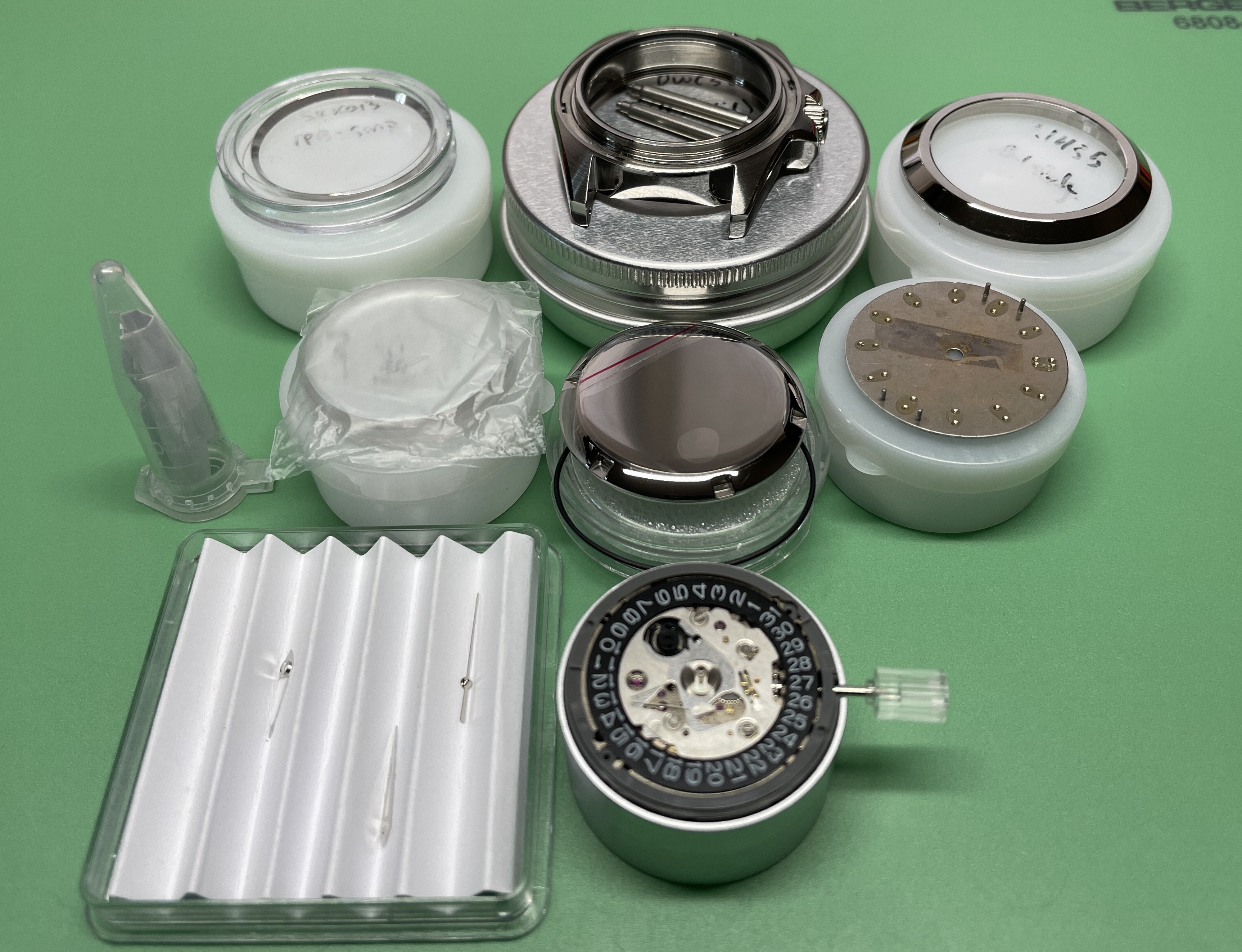

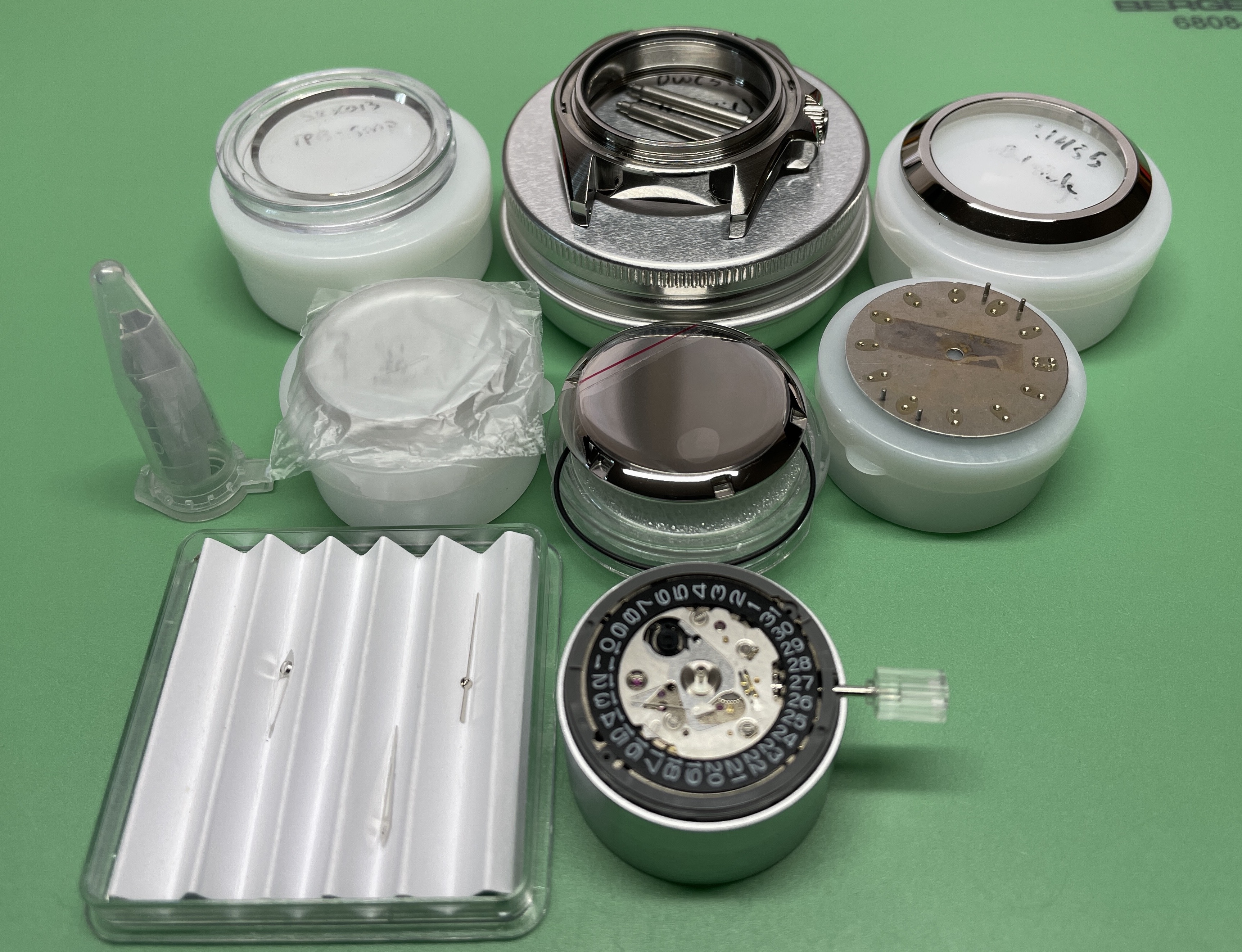

It's always good when you have a stack of packages that you need to open.
Wonder what's in them?
OK, I won't be a teaser, here's the booty.
From top to bottom, left to right, or the other way, whatever you prefer.
1 - Polished chapter ring
2 - case
3 - Plain polished bezel
4 - Set of hands
5 - Crystal
6 - Plain caseback
7 - Dial (Hmmmmmmmm, no dial shot 馃槖)
8 - A movement

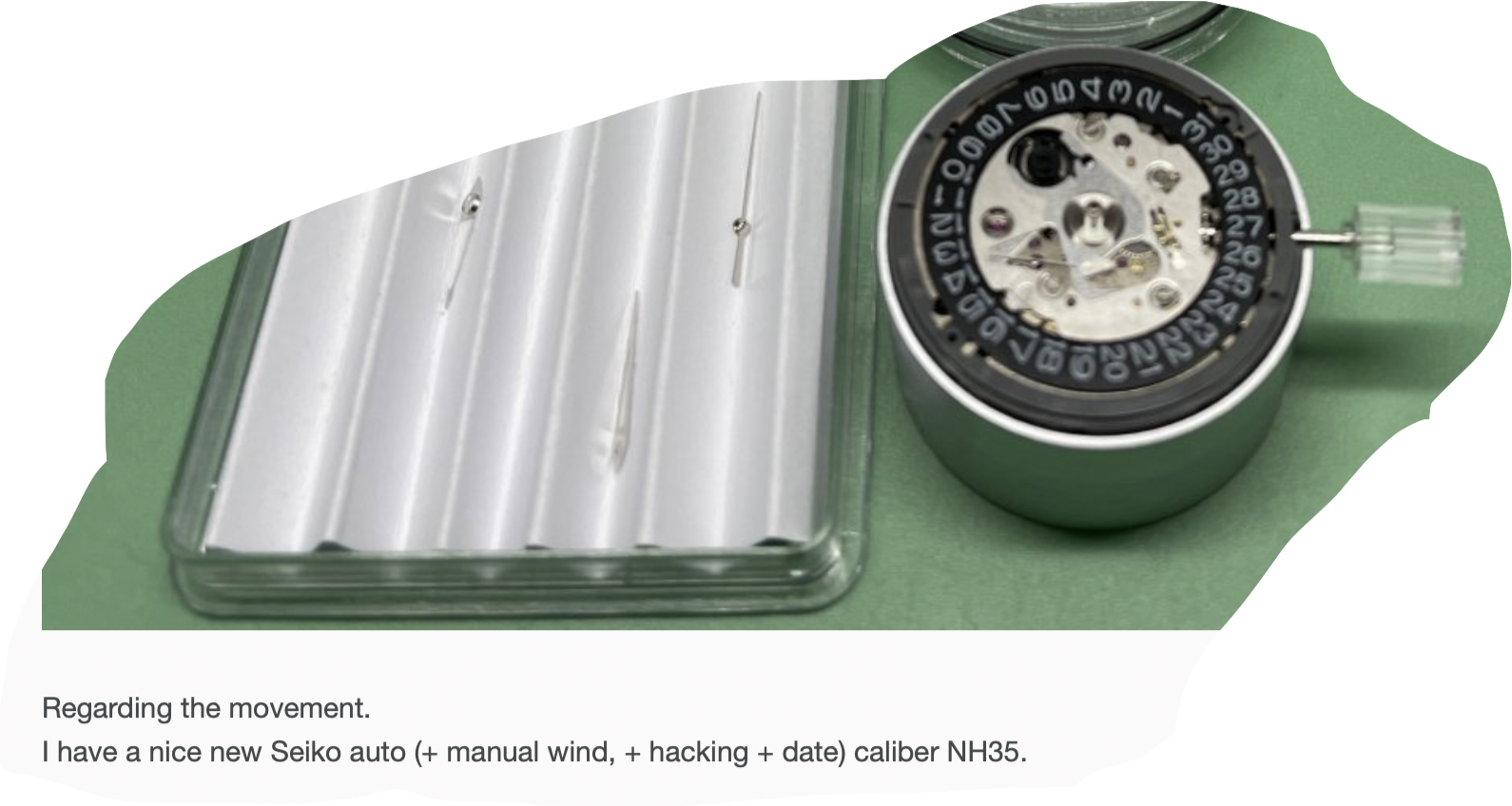

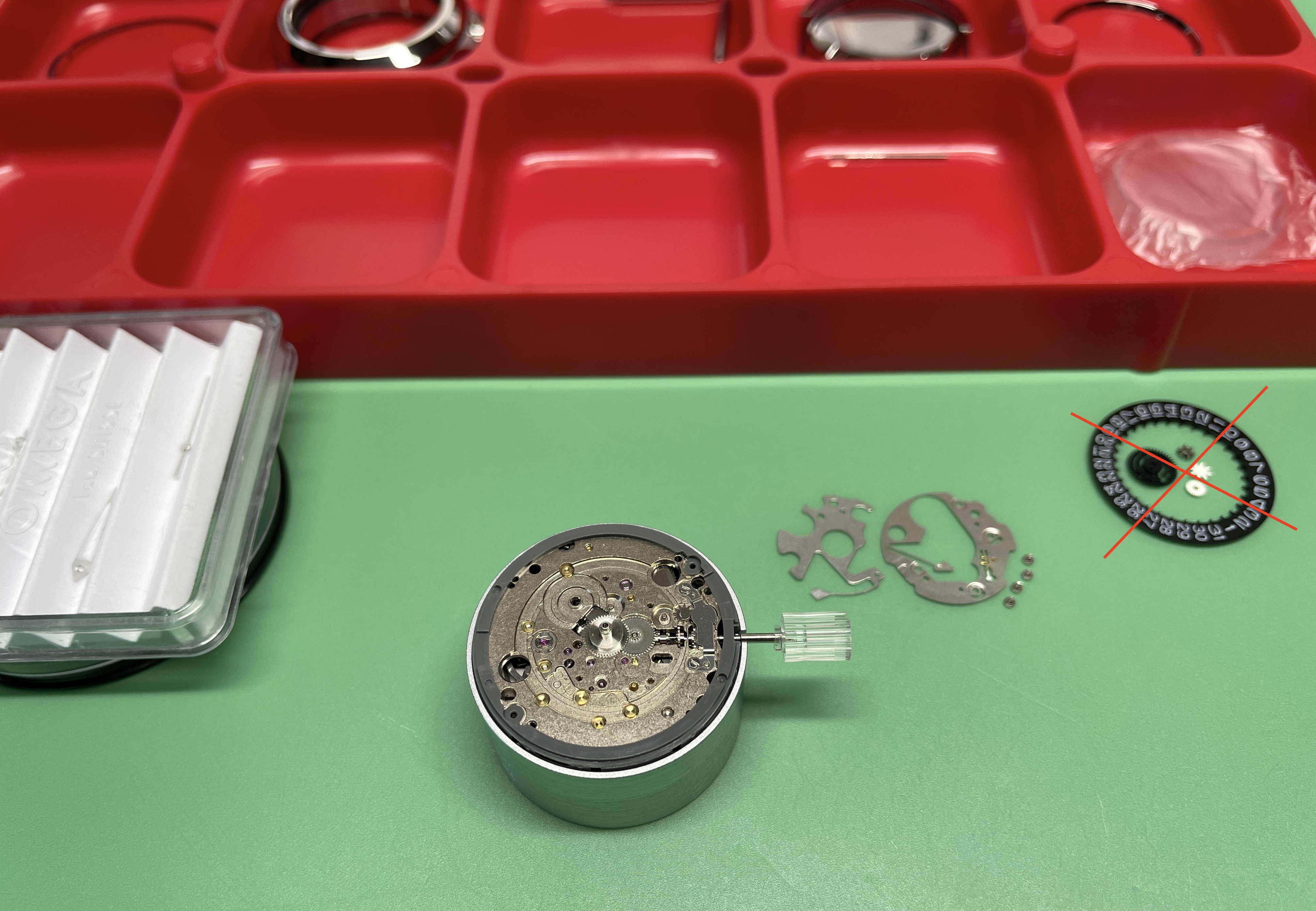

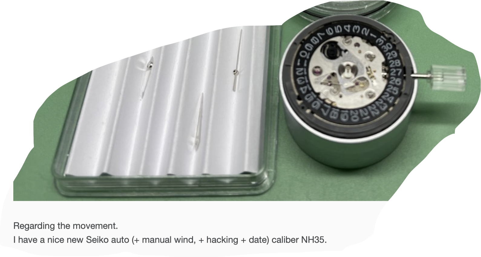

Regarding the movement.
I have a nice new Seiko auto (+ manual wind, + hacking + date) caliber NH35.

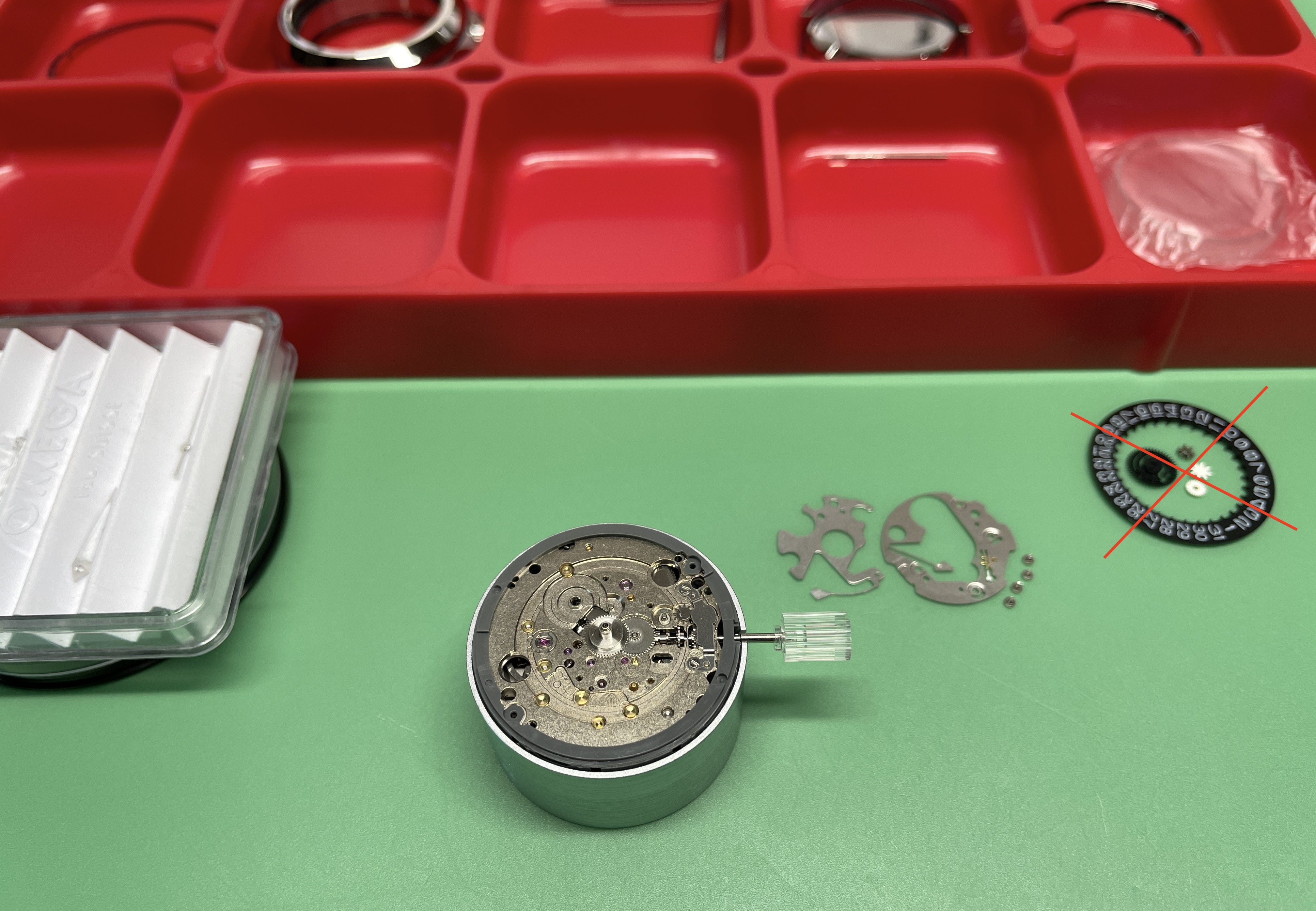

As the observant among you may have noticed, the dial has no day/date windows, so the mechanism for date is superfluous, so it comes out.

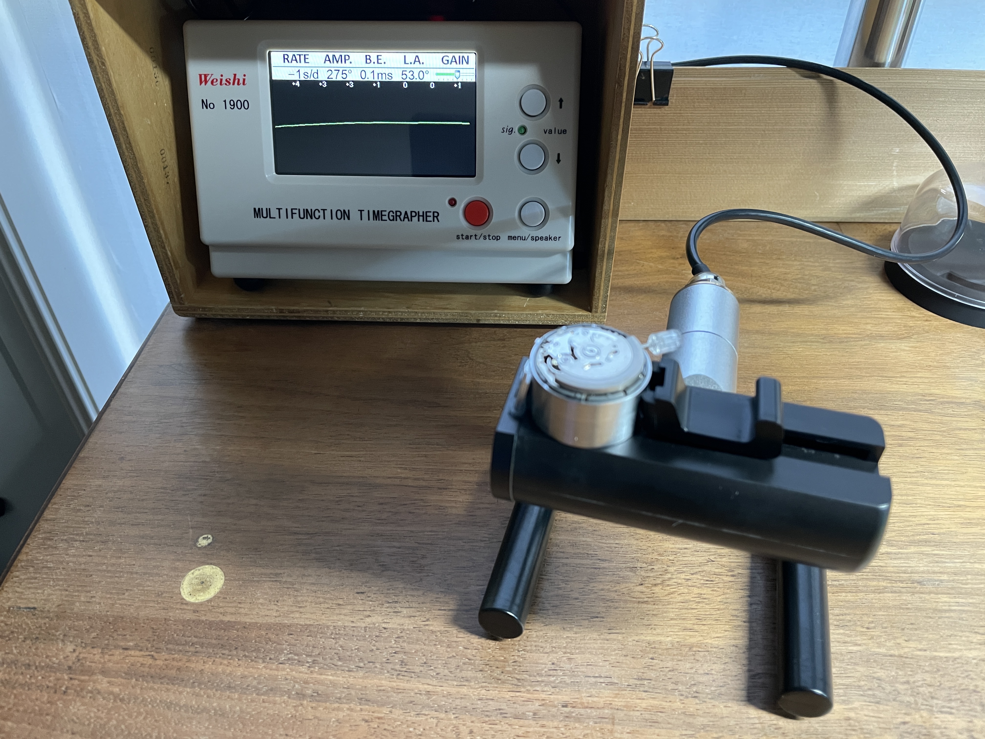

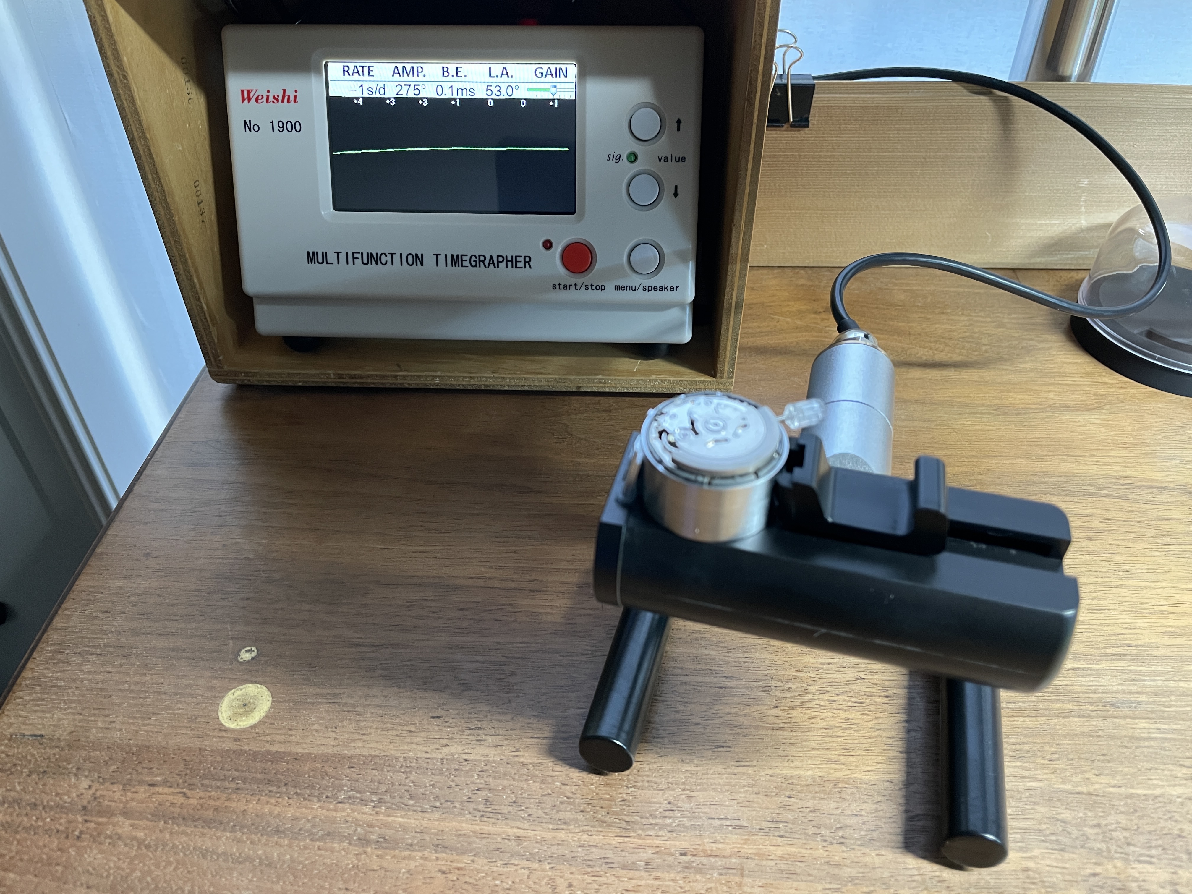

A quick look on the Timegrapher looks promising for an unregulated out of the box movement. Maybe I'll be able to get it a bit better.

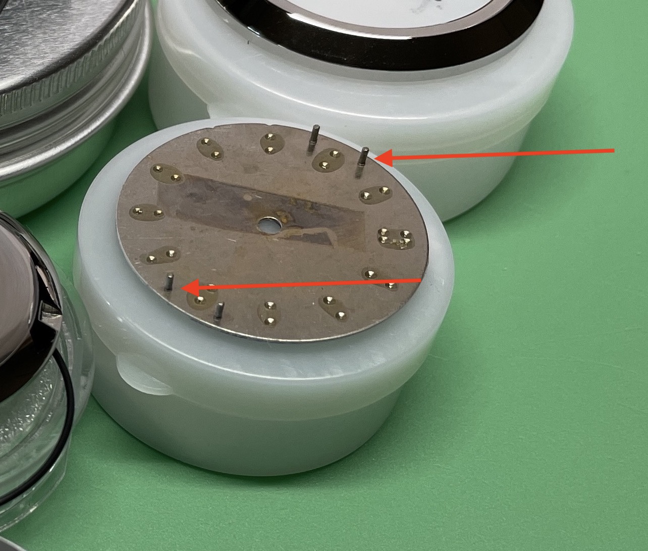

Now that the movement has been modified, it's time to get biblical with the dial.

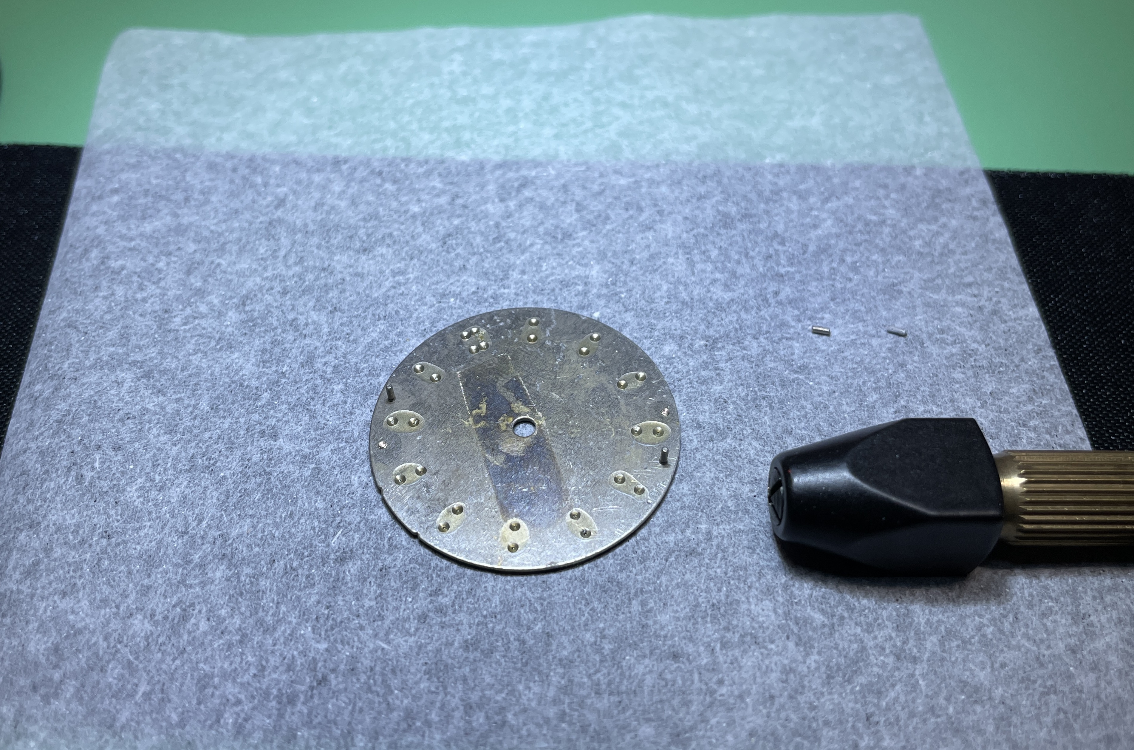

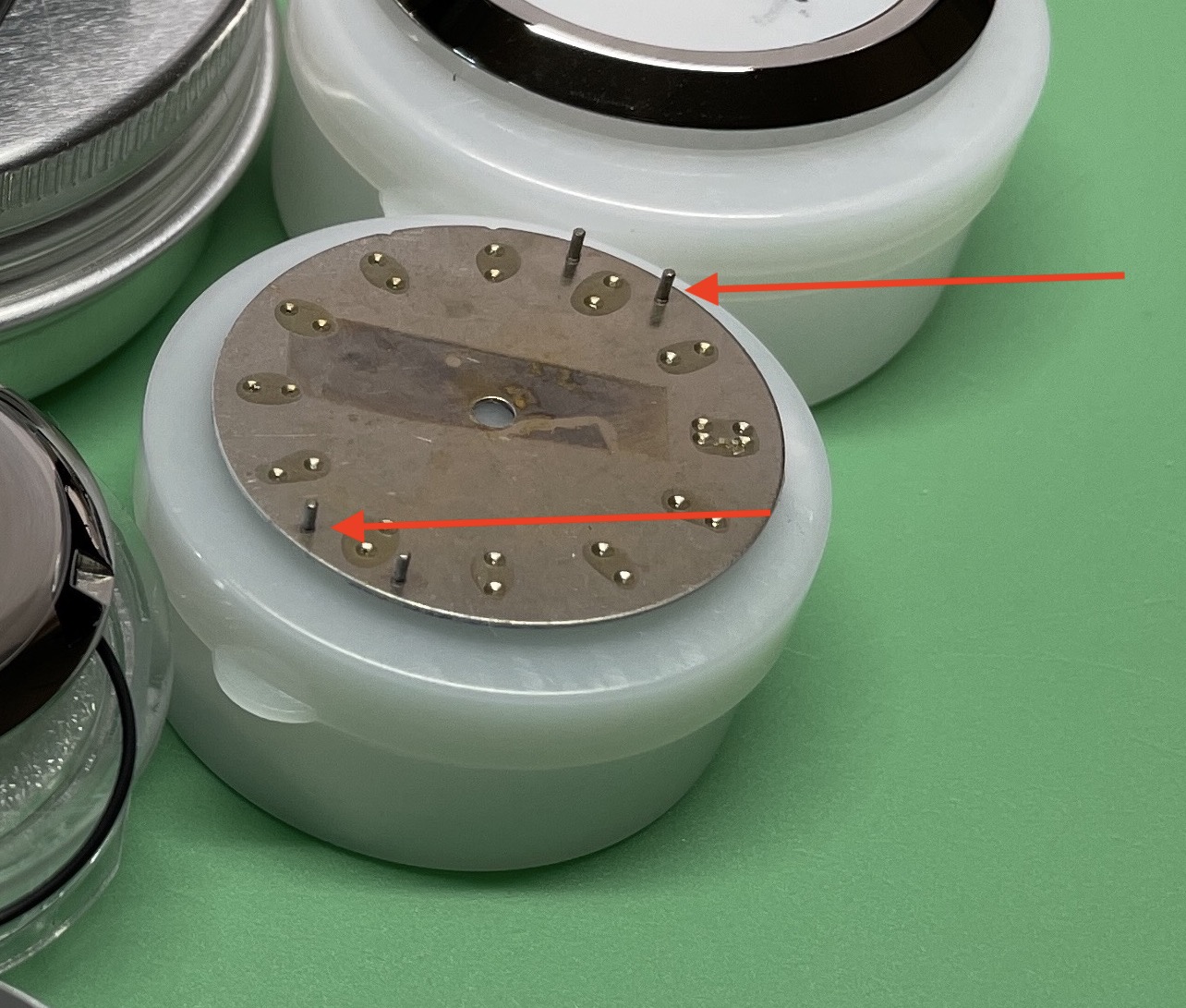

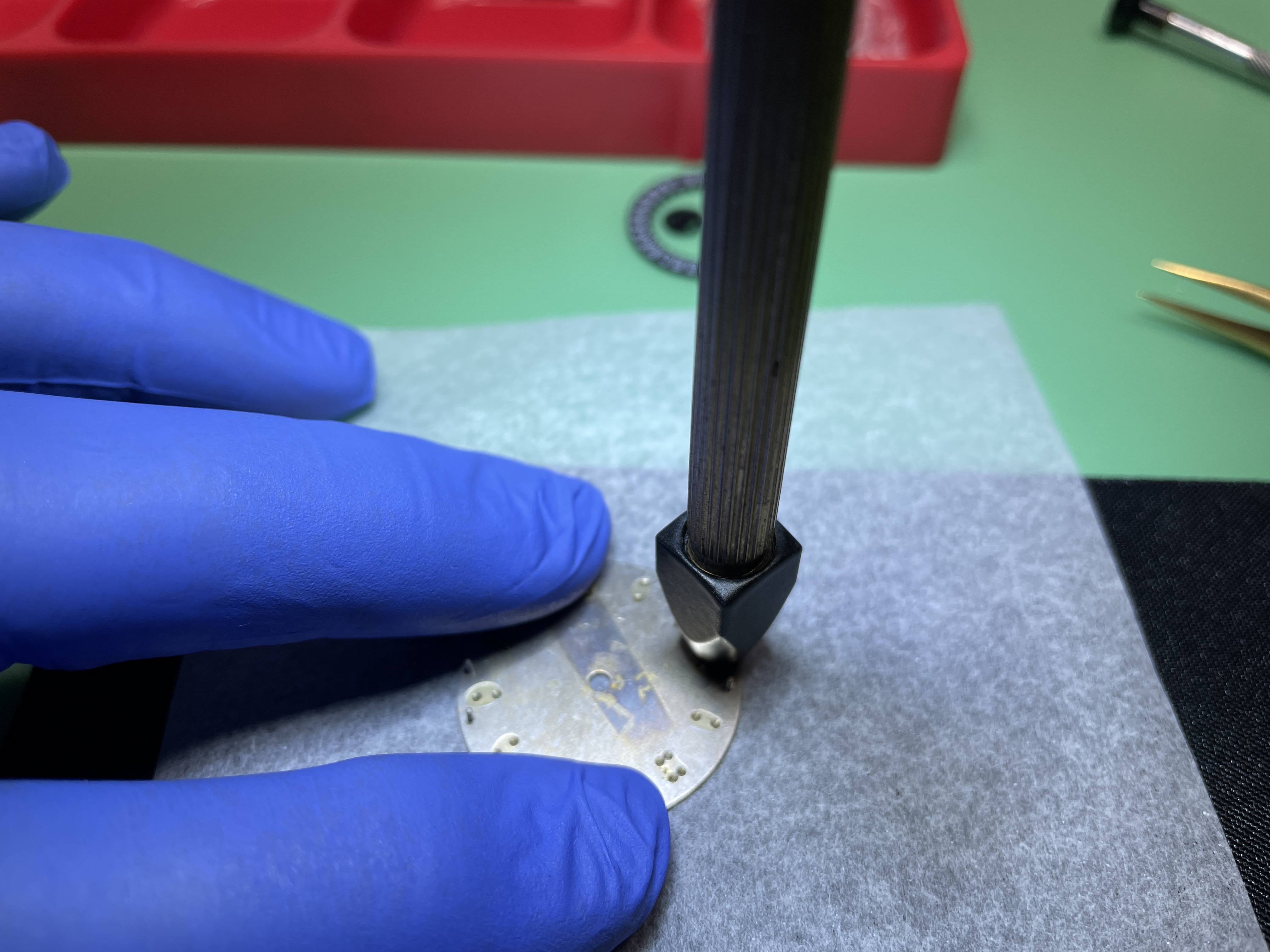

It's designed for cases with stems at 3 o'clock and 4 o'clock, so it's provided with four dial feet.
Two of them have to go!

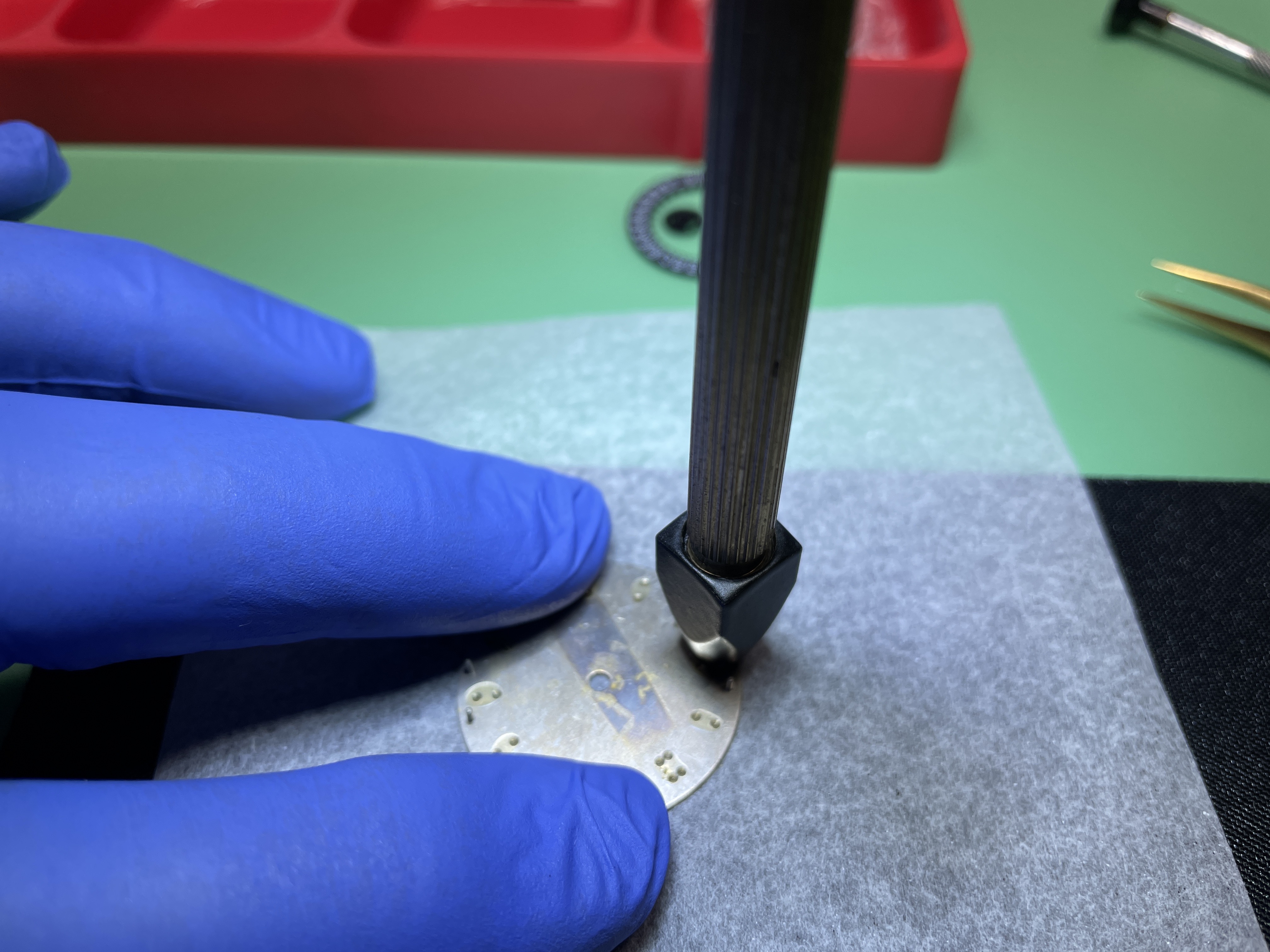

I could use a grinder (noisy, messy), or a pen knife (danger! sharp objects), or a pair of cutters (leaves a tag). After seeing how these little feet seem to fall off dials when you don't want them to, I decided to use the "horizontal applied torsion technique".

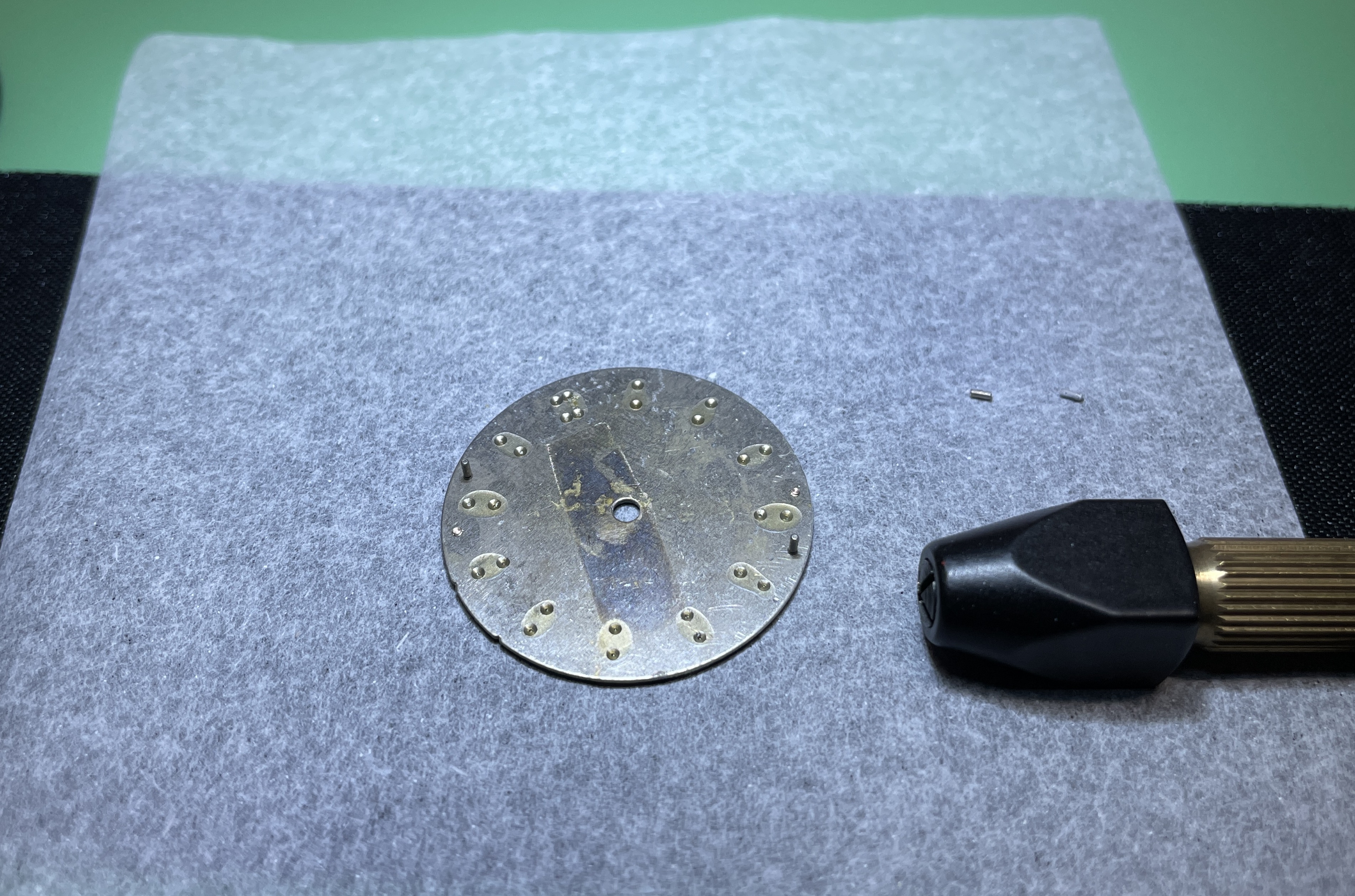

That is, grip the dial foot in a pin vice and twist it off.
Due to my incredible twisting skills, the operation was a success.

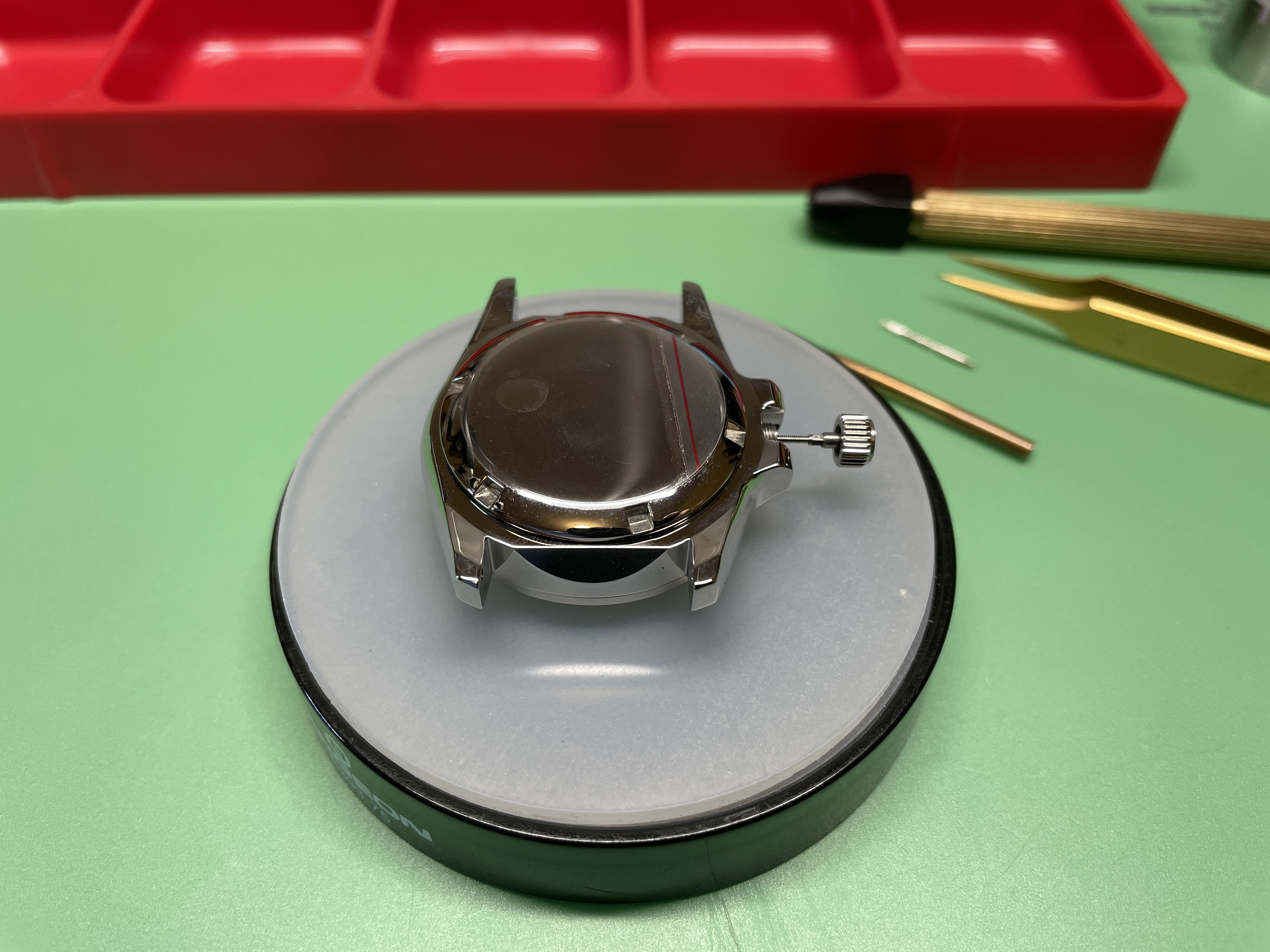

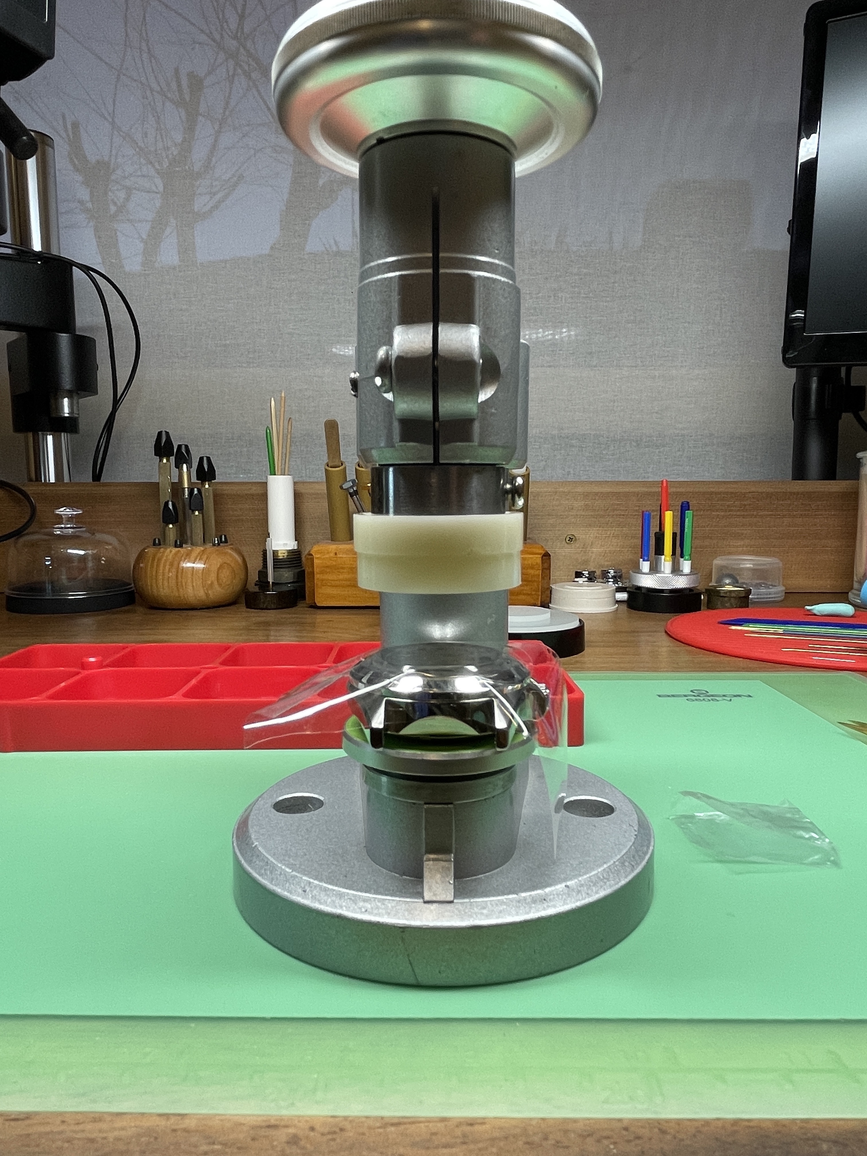

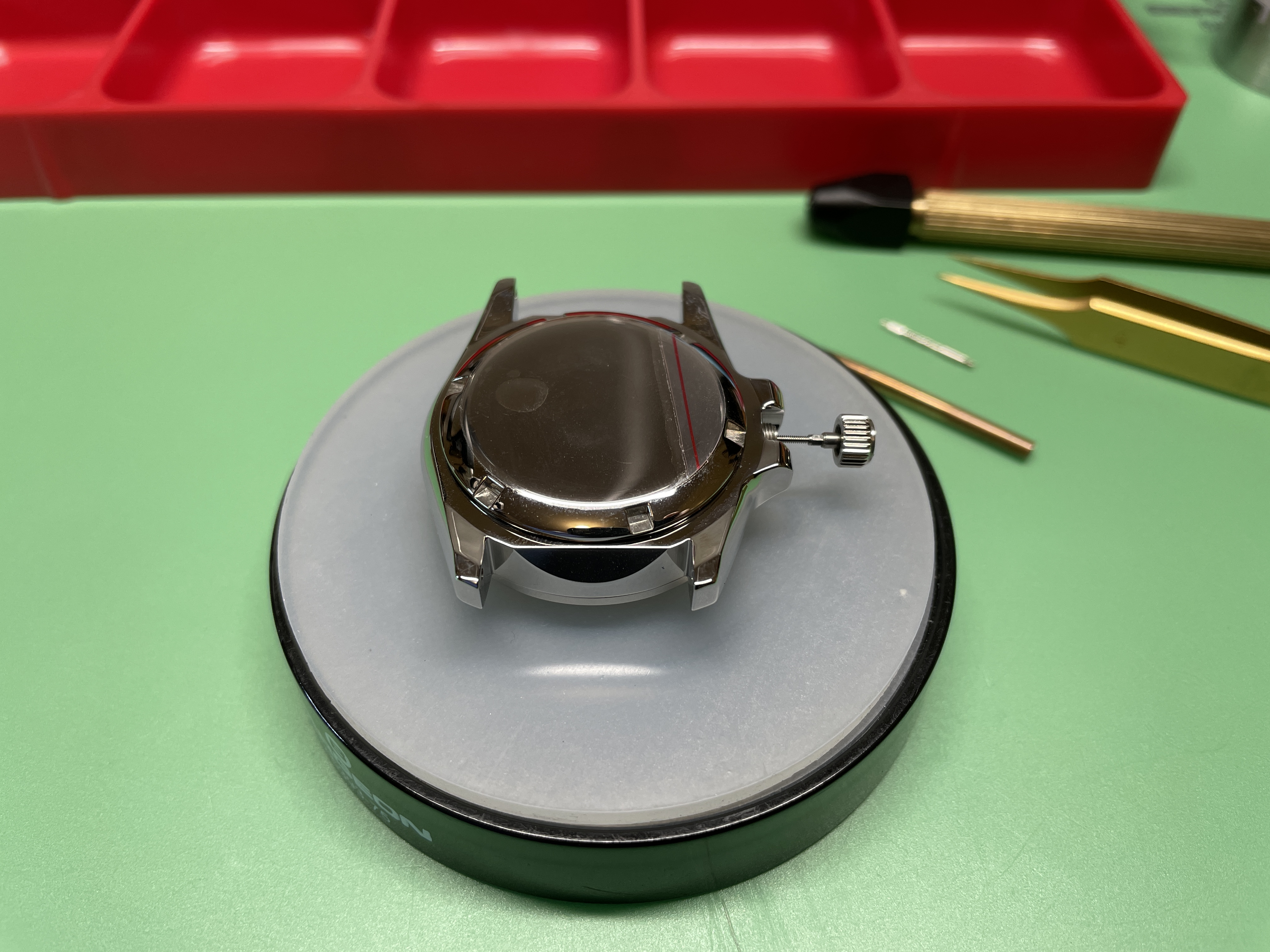

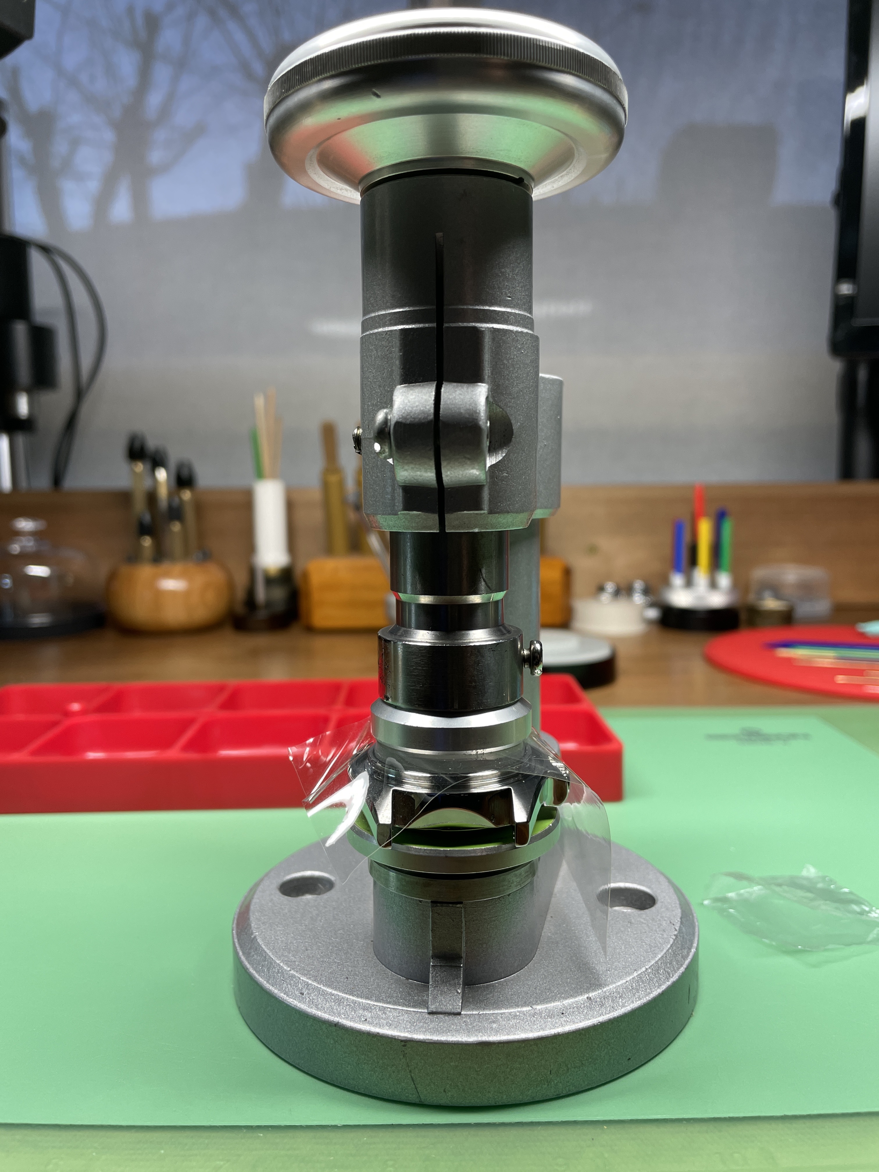

A nice crystal is fitted to the case.

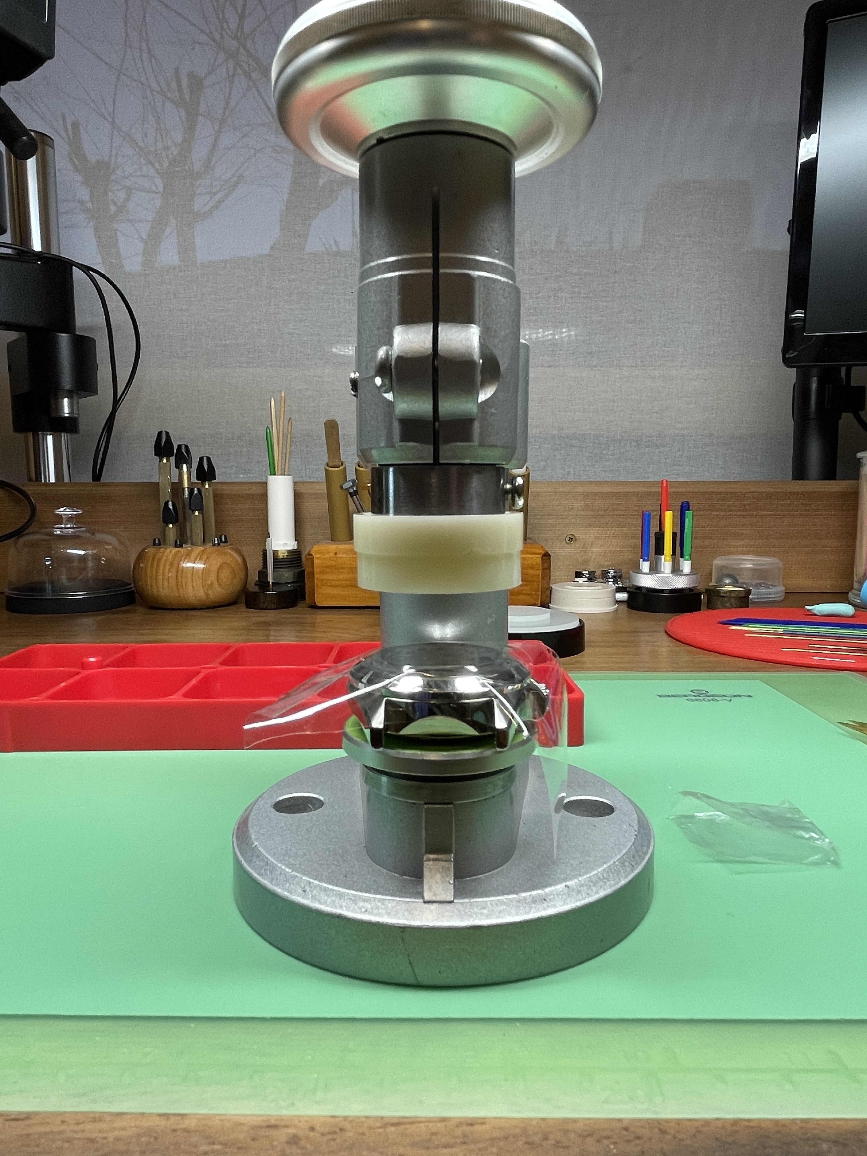

Quickly (but carefully) followed by the polished stainless steel plain bezel.
The shipping stem is rather unattractive, so it will be replaced by a brand new stem.
DAMN!
That's NEVER going to be waterproof.
Back to the drawing board.
