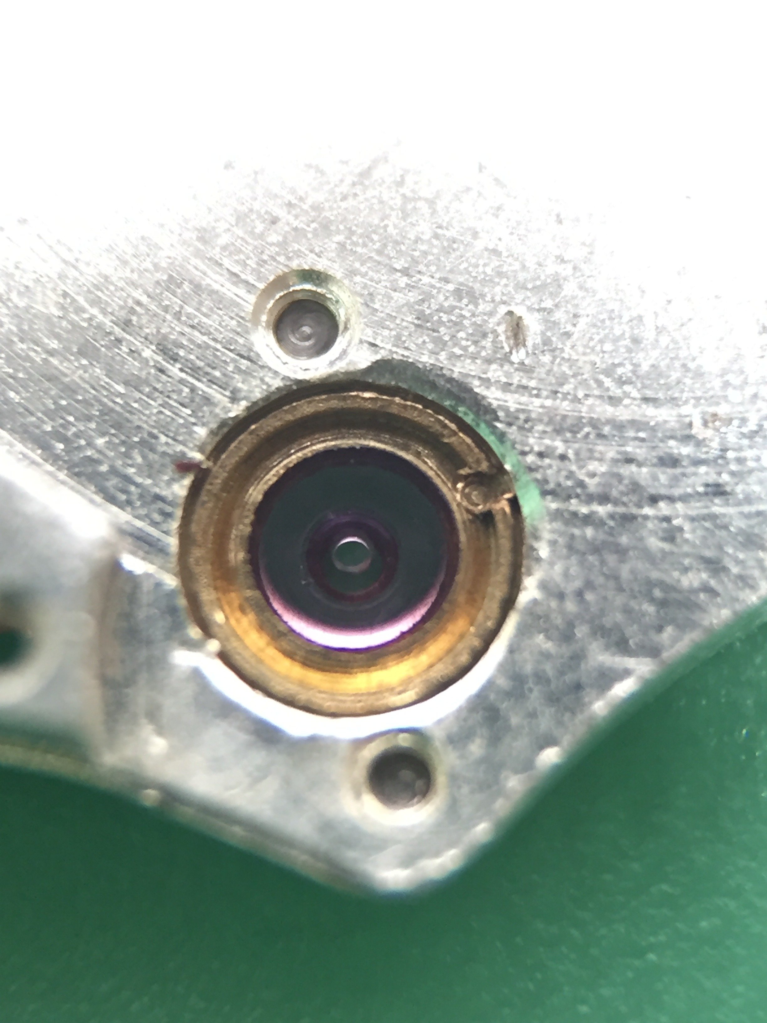

Coincidentally, I'm working on the other Elgin that was going to be a donor but turned out good enough to restore.
While cleaning and inspecting the jewels, I noticed a method of securing the jewels that I've not seen before.
Although I once saw an example that was staked in 3 spots by a centre punch, this solution appears to be a factory product.
It's also a bit of "belt and braces" because the jewel chaton is held from the other side of the plate by three machine screws.
