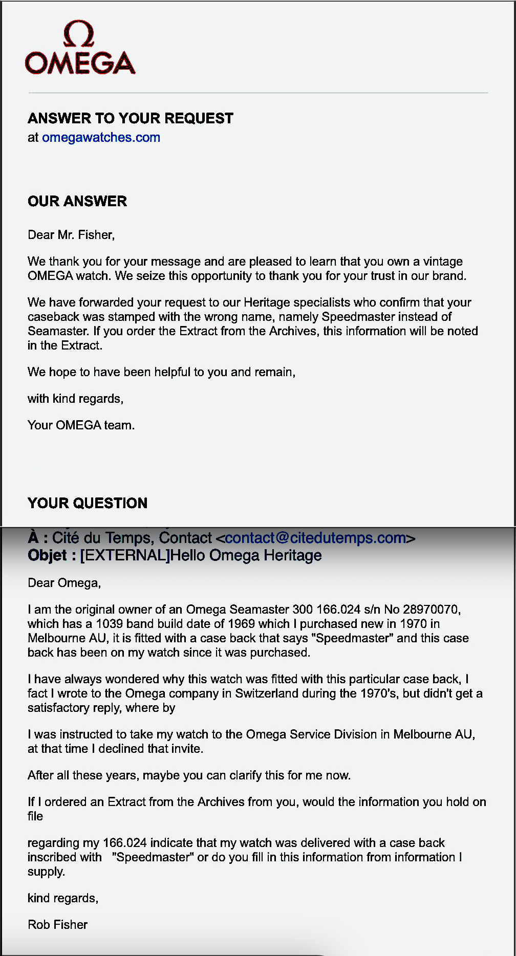

I won’t labour this point because Ive discussed this issue before but not in this context , I refer to the Casebacks of 2 models ,165.024 and the 166.024 where by they were printed up with Speedmaster.
This has intrigued me for some time, a member of this forum uploaded an E of A which stated in the remarks quote,
“Part of a small batch with casebooks misprinted with Speedmaster” ….. his 300 was model ST165.024 with a production date of Dec 4th 1967.
My 166.024 is late 1969 model also has “ Speedmaster’ case back. The difference of 2 years between these builds is a considerable time span for the small batch ( to run ), and also consider that mine is HF build and and another Ive seen has a CB build with these“Speedmaster” case backs, so we’re dealing with 2 manufactures..( the correct model number is stamped on the inside in both of these watches)
I tried unsuccessfully to get an answer to this question from Omega in Switzerland by letter many years ago and it remained unresolved till the light of this recent E of A.
………. also “misprinted “is how Omega described this anomaly on the Caseback……..What does that it mean in context of fitting the correct watch back for that model ?
Does it it mean they failed, and sent out watches with the wrong case back without realizing, or did they use case backs they had on hand from both manufactures CB and HF over a period of years, and this didn’t faze them.
I ask the pertinent questions,
Where did Omega get this info now, did they really have this info on file……………….or was this question proposed to them on the application form ?
The info supplied by Omega in the” Remarks on the E of A “ just doesn’t seem to fit for me but I could be wrong..
Maybe I should apply for E of A with out making mention of this case back “Misprint” in the remarks and see what happens .

I wrote again to Omega a few years ago to try to pin them down on the fitting of the incorrect “Speedmaster” case back, and to find out how much they knew regarding the fitting of these “Speedmaster case back to the Seamaster 300.
They told me zero in the 70's
This time they said it was fitted with the wrong case back in the above letter, but it is odd that some one on the assembly line didn’t question these fittings, considering the correct model number was stamped on the inside case back.
