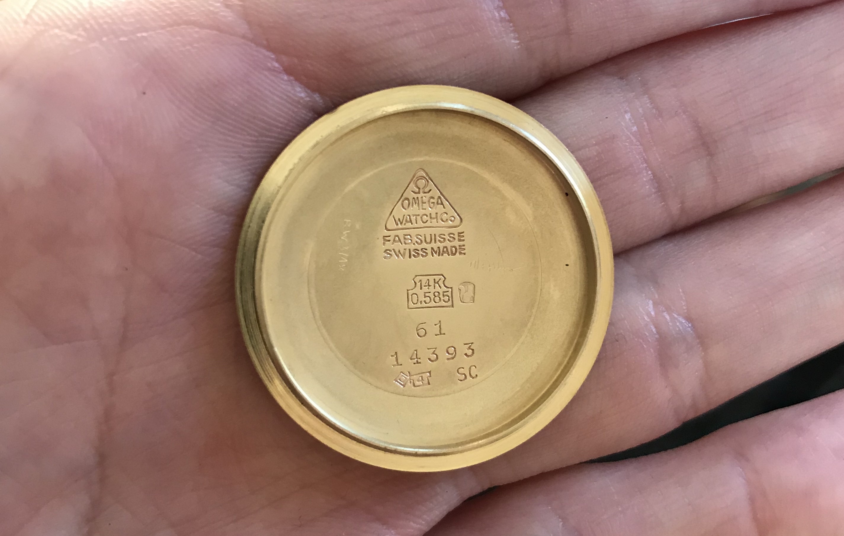

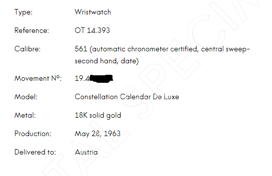

I ordered an Extract of the Archives from Omega but surprisingly the data on the document does not fit my watch.
It is stated that it's a 18k Constellation Calendar De Luxe OT 14393 allthough it's a 14k Constellation 14393SC.
I actually sent them a picture of the caseback with engraved 14k stamp and even stated it on the text I sent them- so that's quite odd in my opinion.

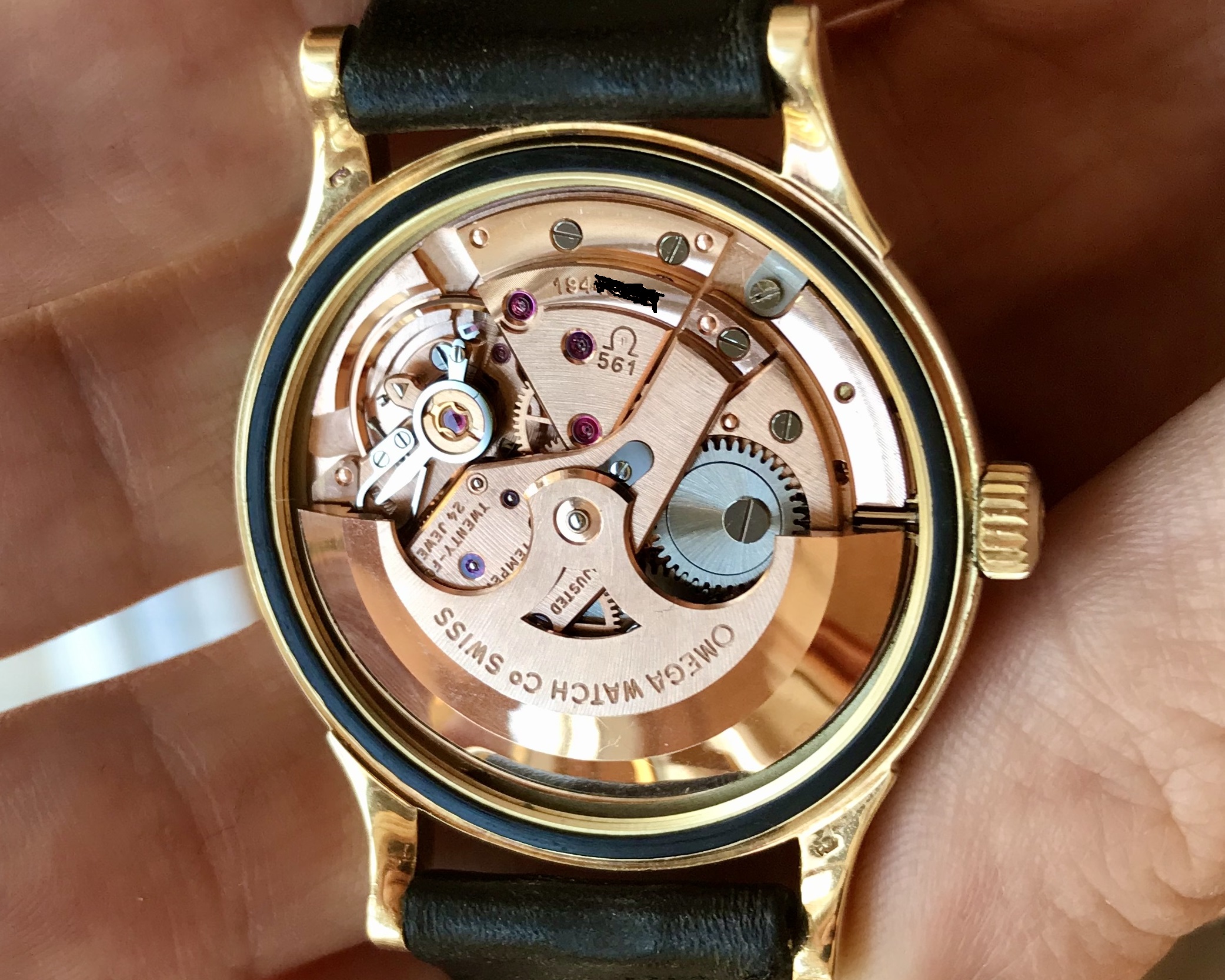

The calibre 561 (19xxx) actually seems fitting to the reference (14393SC) and the production date 1961-1962) so I wonder why the extract shows different date.
What makes me wonder is that as far as I know if the provided infos do not fit the the watch the extract of the archives is declined. So what is your opinion? Is it a mistake by Omega or has my watch been reassembled in the past or something else?
Here are pictures of the watch + movement and caseback and the extract of the archives.
Thanks a lot for your help.
Kind regards, Max

I would ask them if the extract information is correct - ie is the 18K a typo ( and should it have been 14K )
6,830
10,500
As a watch, it looks correct.
I agree that you should go back to Omega.
Although it can’t be a typo as your case was never a deluxe as it doesn’t have a dual reference case back.
Two options I’m afraid:
1. Transplanted movt
2. Error at Omega. (Either in the records or the reading of the records)
my bet is on the latter.

I don’t think there is anything wrong with the watch (other than a replacement crown) or the extract.
1. “SC” stands for Seconds Centrale, French for Center Seconds. Since all Constellations of this production run had this feature, all had this designation on the caseback.
2. The “61” on the caseback does stand for 1961, but that doesn’t mean that the watch was built, delivered or sold during that year. It is the year that the design for this reference started.
You have a beautiful watch. Enjoy it and please don’t obsess about the minute details that no one cared about when it was made.

Well I'd expect a Deluxe to have a solid gold dial and the Extract has 18kt gold yet the case has 14kt.
I'd say these are quite major discrepancies and render the Extract a worthless waste of money at this time. I think going back to Omega to clear it up for the good or bad, one way or the other, is the way to go here.

short update on the topic: I sent them an email regarding the issue (especially the 14k-thing). They apologized and corrected the document (14k instead of 18k). Unfortunately they did not correct the "De Luxe" typing in the extract. Partly it was my mistake i believe because I didn't state it as clearly as the 14k-thing. I kind of thought it was a bit obvious because as far as i know there even exist no 14k- De Luxe versions. Still i should have stated it more clearly.
I think the reason originally why they believed it was a De Luxe was that on the picture I sent them the dial looked a bit golden because of the lighting.
Because the document still isn't correct as i believe I sent them another mail and asked them kindly to correct it again.
Lastly I want to highlight that the communication with the customer support was fast and friendly; and mistakes can happen on both sides.

Final update how things went since my last post: As stated beforehand I emailed them again with the issue about the document still not being correct in my opinion. After some time they replied, apologized and sent the certificate again with correct information (14k gold and no De Luxe Constellation).
To state two positive things:
1) I still received useful information on the origins of the watch (date and selling place). It does match with the origins the seller stated when I bought it. I didn't tell Omega this information so that's a proof for me that there was actually some digging in the archives involved. I still do not fully understand how the other mistakes occured but nevertheless I got some new informations on the watch that approved what i believed of it beforehand. Of course the fact that I kind of could tell them what to change in the certificate remains a bit strange but it was good for me so I won't complain too much. As I read about a few times if the heritage team identifies the watch as franken they just won't issue the certificate. So in my case I assume that it was either a mistake or that the records in the archives were not complete and they assumed the model name+material incorrectly.
2) The costumer service worked very well and they sent the third and correct version without hesitating, allthough it was partly my failure with the second correction because I did not specificially mention the modell name being incorrect.
Long story short: I am happy how things finally went and I learnt something new about my watch. Not it's time to simply enjoy it.
