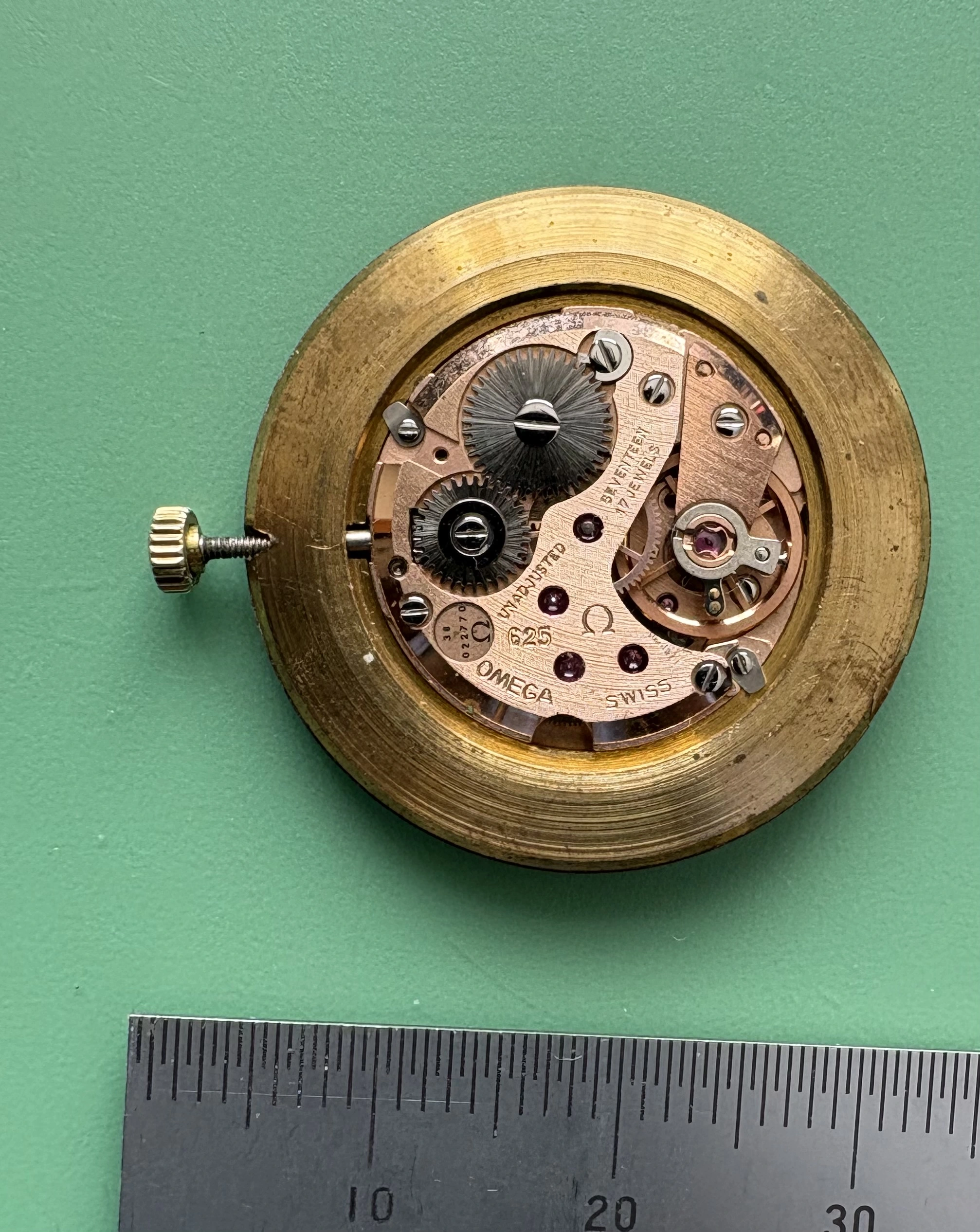

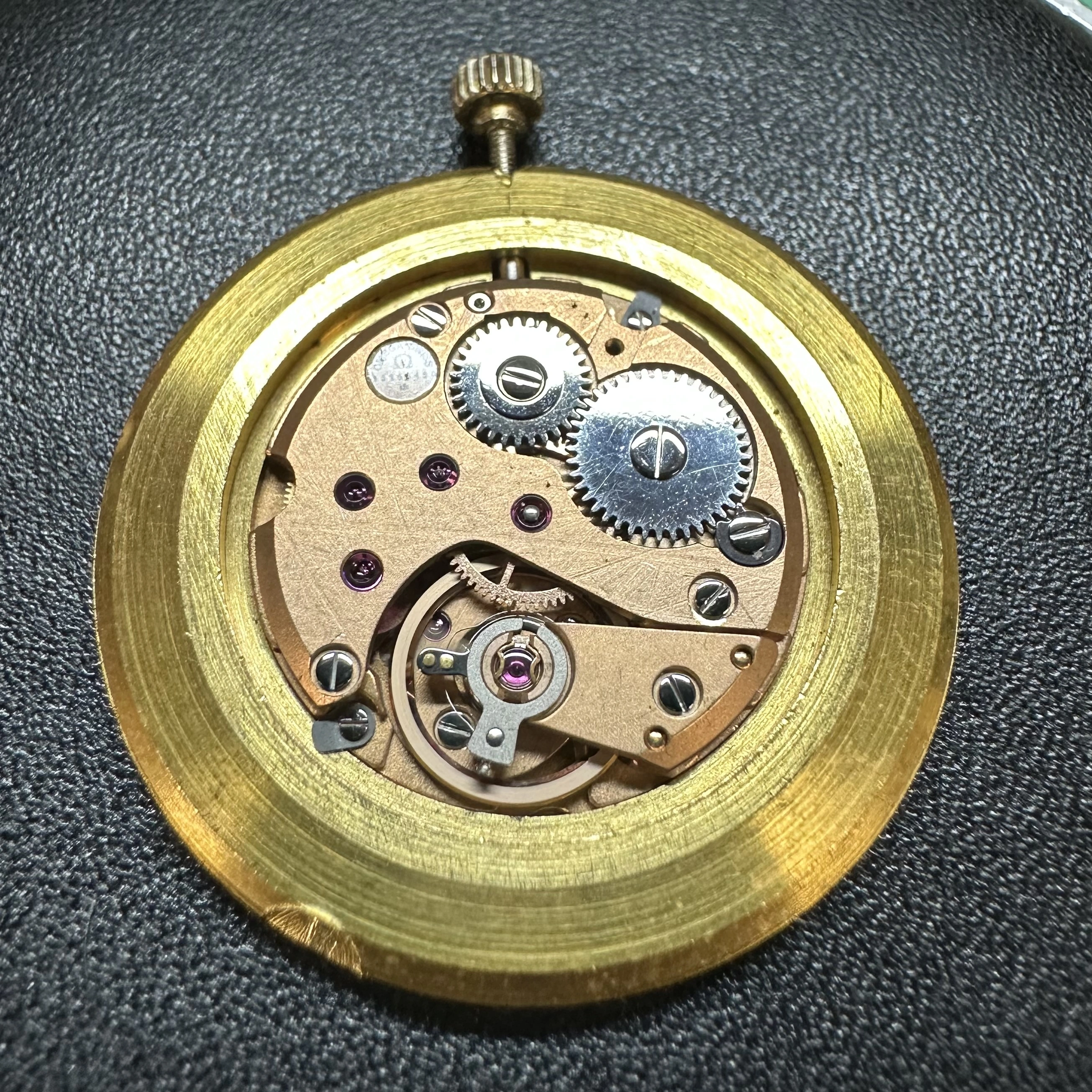

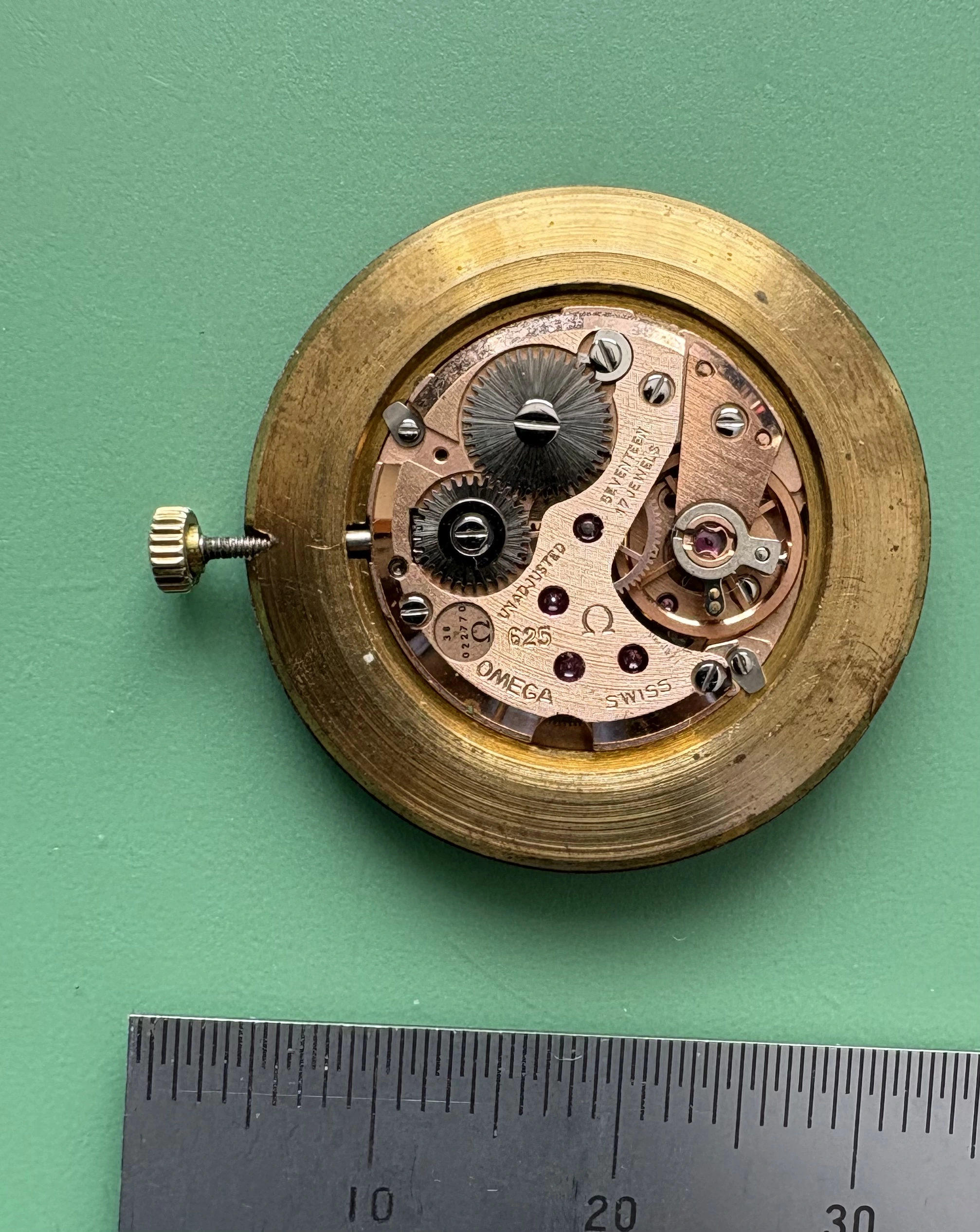

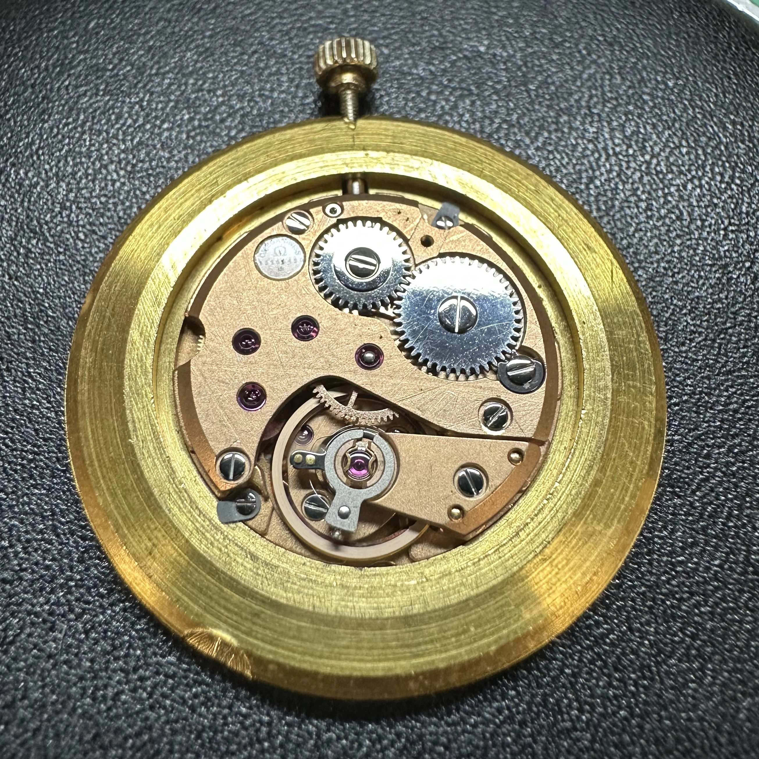

Ok. Like a lot of people I have an Omega Deville cal 625 movement with a dial and hands that I bought to service. But it’s pretty much a paperweight if it’s not being used as a watch. So, try as I might I can’t seem to find a suitable watch case for it. It’s not as if it’ll fit in any old case, but I can’t even reference the right number for the case I need.
I can’t believe that I’m the only one in this position but I know that there are some good people out there who will know how to help!!

This is a small 18mm movement used in the 1970s. Fairly common movement. As a dress movement it usually does not have a sweep hand. That is the more rare 630/635. Similar movements are 620/630. Automatic variations are 671 and 681.

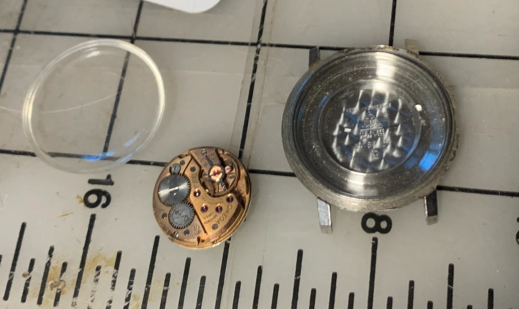

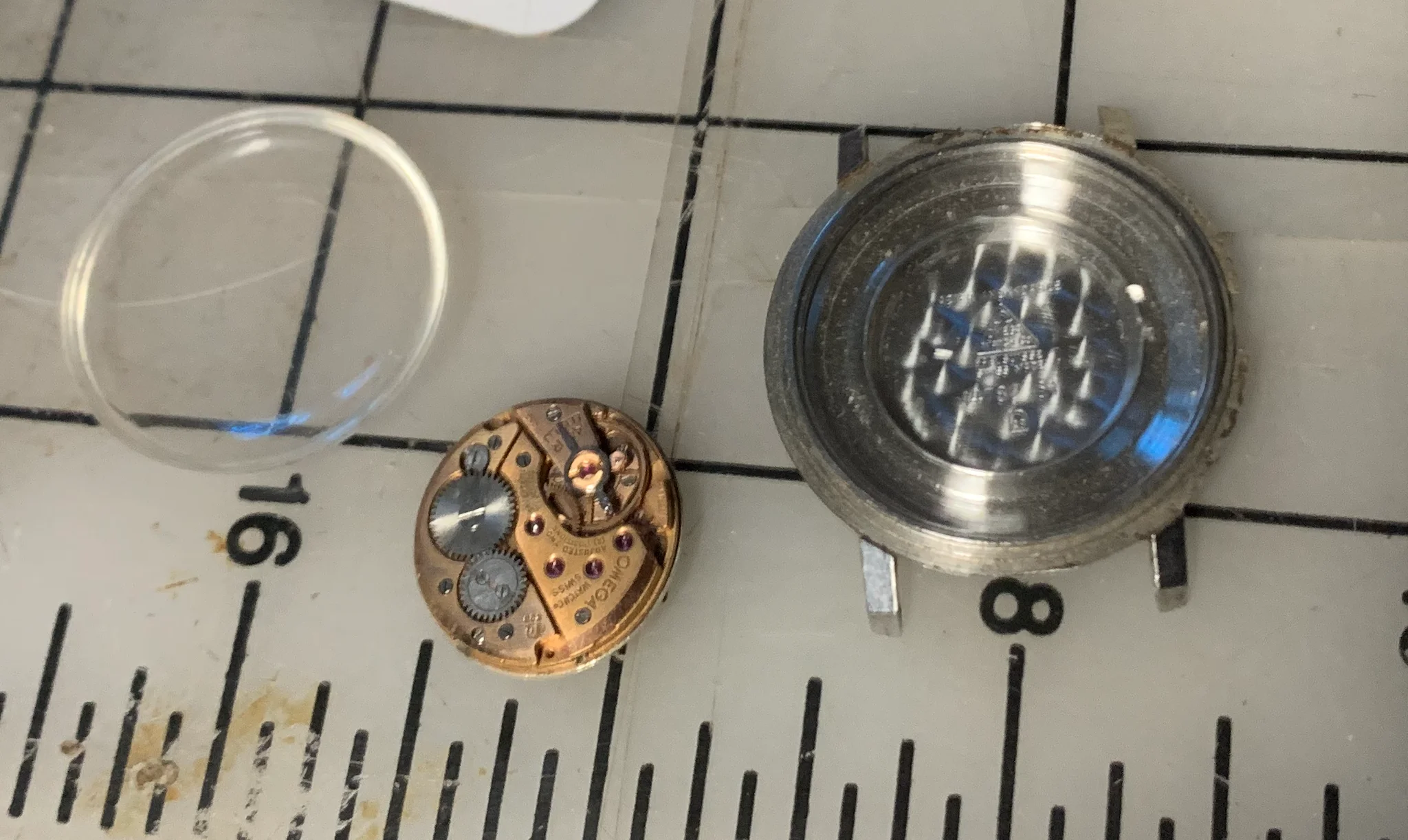

I just got a 147.82 -61 case last week on eBay. No bezel though. Dial will be a real PITA since most of these were in Lady sized cases. More interesting are finding the rectangular or 'tank' shaped cases. Does take some effort to search, but they are out there.

620/625 is the lowest of the low end. Well the microscopic cocktail movements are probably a bit lower end. These things are best found in job lots and assortments. I call this potato chip watches. You can not just stop at one ...

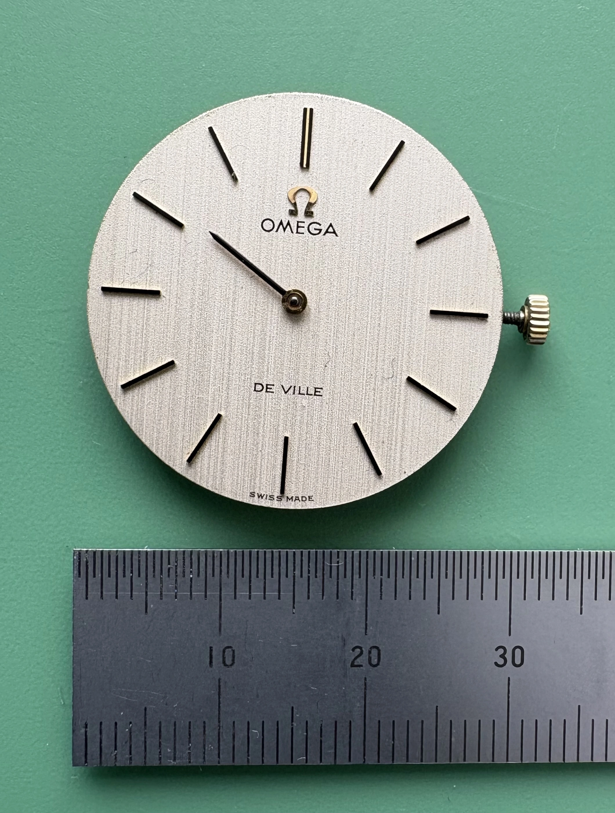

I am aware that there is a whole rabbit hole of controversy I could fall into with regards to the “Frankenwatch” scenario, that’s why I am only interested in finding a genuine case for this movement. If I can’t find one then I’ll just keep the movement, rest assured I won’t be force fitting it into a case from AliExpress!
I’ll upload some photos so you get more of an idea of what it looks like re the dial/movement ratio.

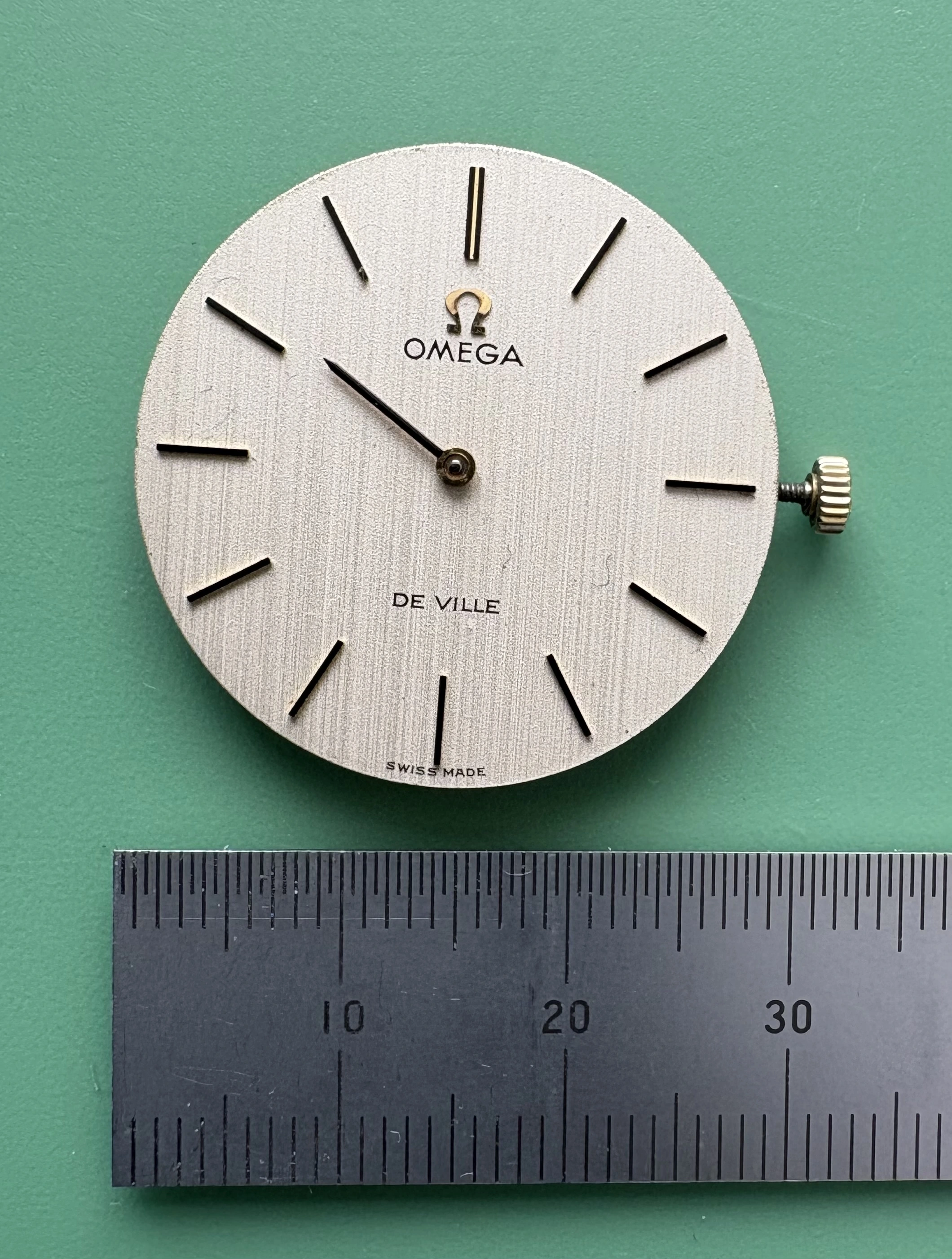

The problem you may have is that although the movement will have been used in many references, the dials were sometimes slightly different dimensions, specific to a smaller number of references. As such, you may buy several cases that are correct for the movement, but find they don't fit the dial.
3
That’s a good point that while obviously, is one that I forgot about!! I seem to get a bit too focused on the movement number. Clearly the movement is absolutely tiny but the dial in comparison is quite large.

Not only the dials. The hand support parts too which include the sweep pinion, cannon Pinion and hour wheel. I have been dealing with this for the last few months. I have perhaps 1/2 dozen movements and perhaps 3 or 4 case candidates. Last week I got a bunch of 1233 hour wheels, thinking they were H1 when they were actually H2. Even worse with the sweep pinion 1253. The second part of this is a letter. 550 1253 is H0, 560 1253B is H1 and 560 1253D is H2. Then when 752 gets involved there is 750 1253A which I got mixed up with H2. This is actually even taller to clear the day date wheel mechanism.
My plan is to write all this up, but that I never have it far enough along to actually feel there is useful info. I am thinking of shortening the 1233 hour wheels to the 1232 height, since that is the most common. Typically this number show up inside the Ω symbol.
The 620..681 smaller movements have similar cannon wheel heights.
The real problem is sellers will not bother with checking any of this. I have a bunch of 550 1253 sweep pinions which at least one was sold inside opened 560 1253B packaging.

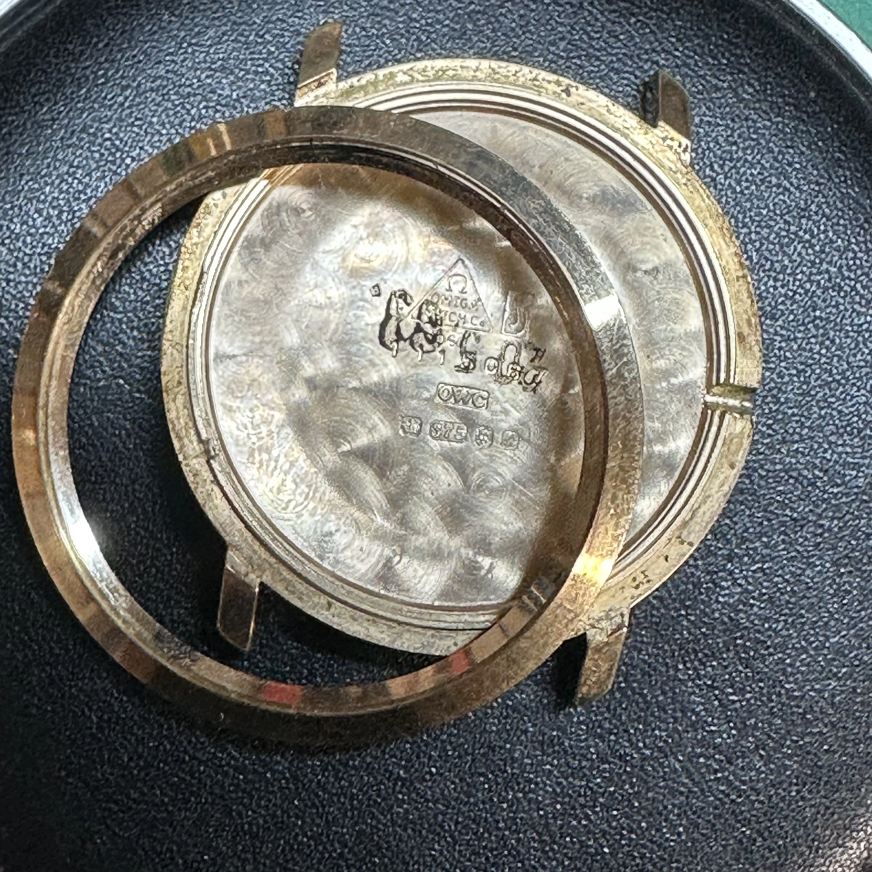

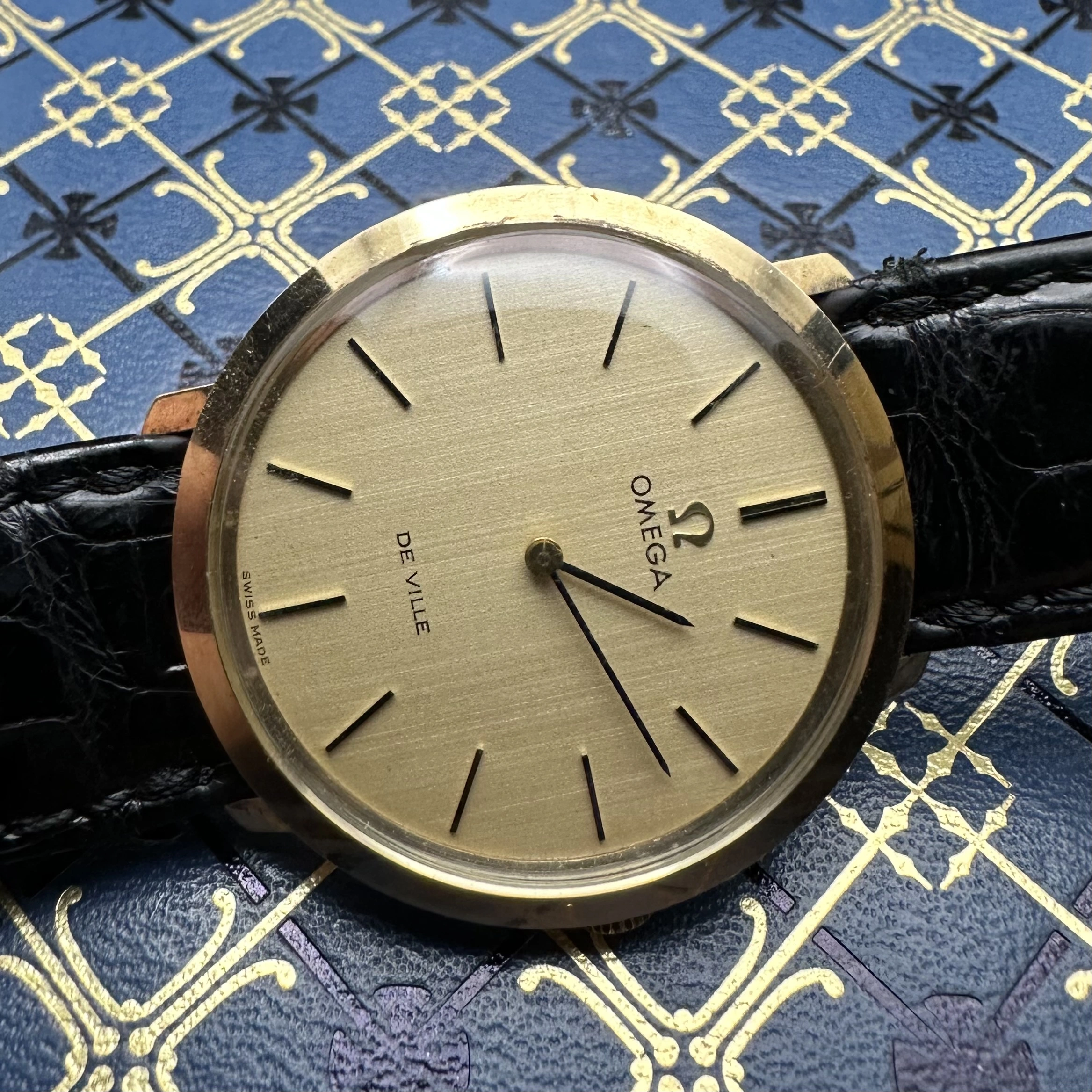

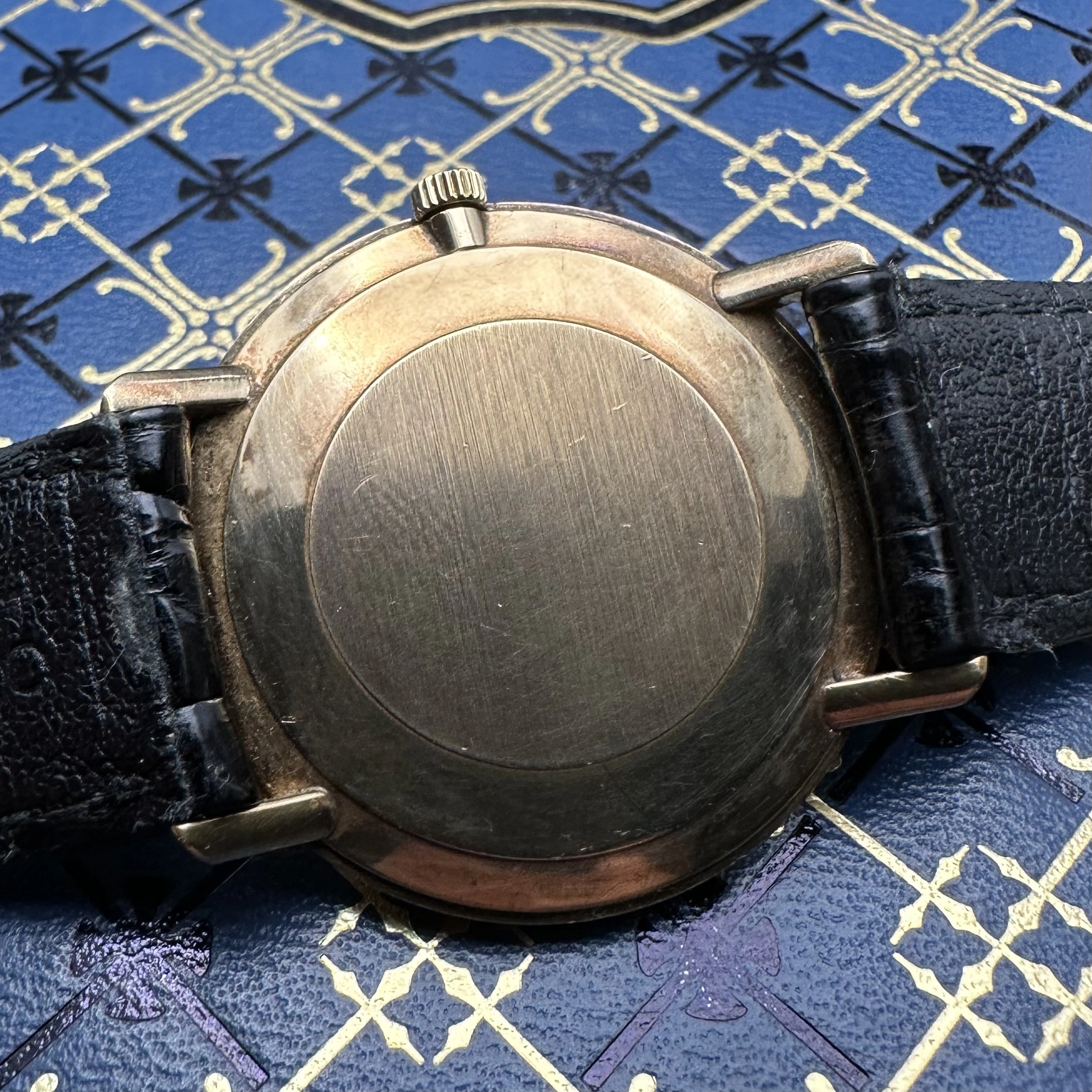

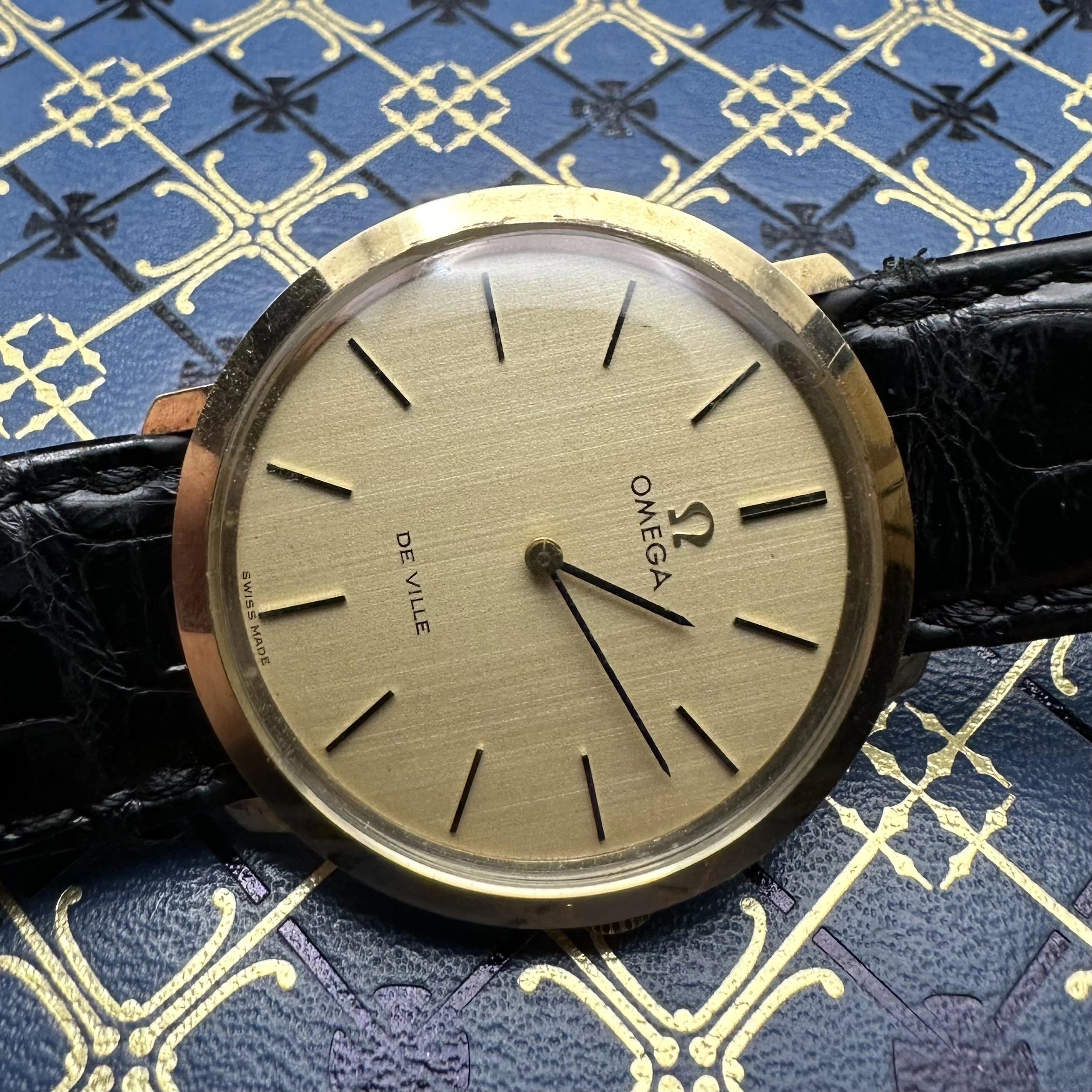

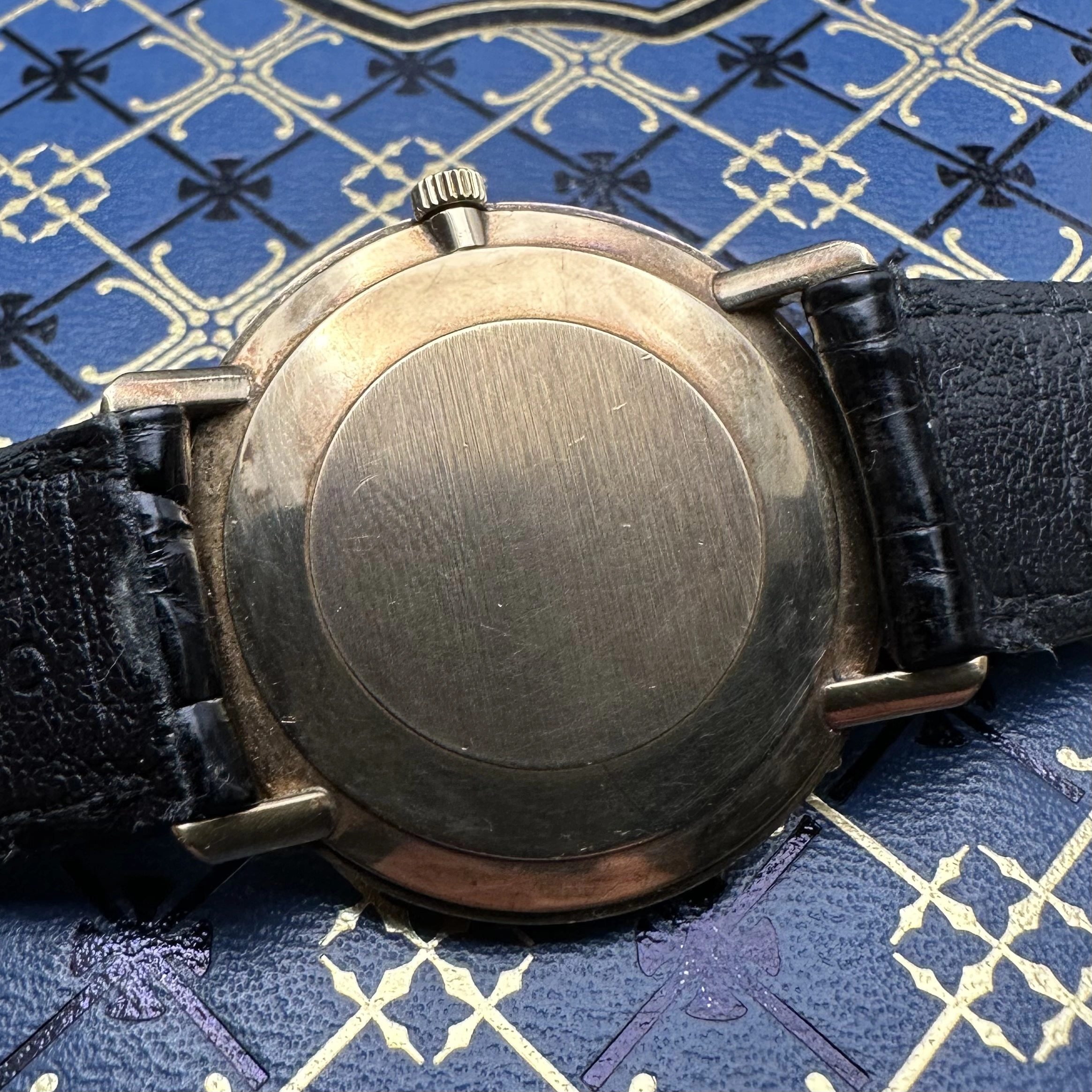

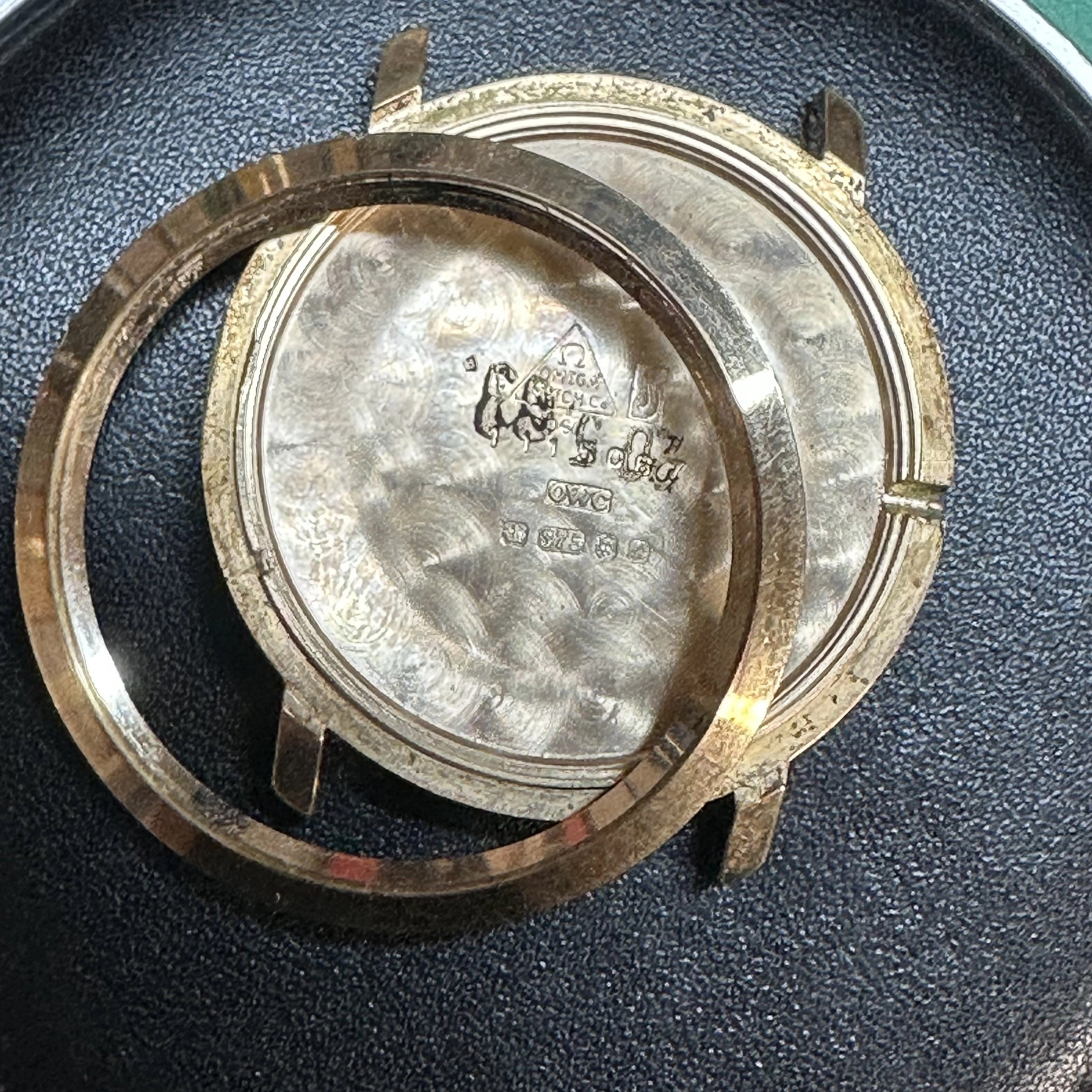

Unfortunately, finding a case for this will be very, very unlikely. I suspect this belonged to a 9ct gold 111.5067 case from the 1970s. The original case for your set was likely scrapped.
I had one in the past, but found it a little small for my liking and sold it.
