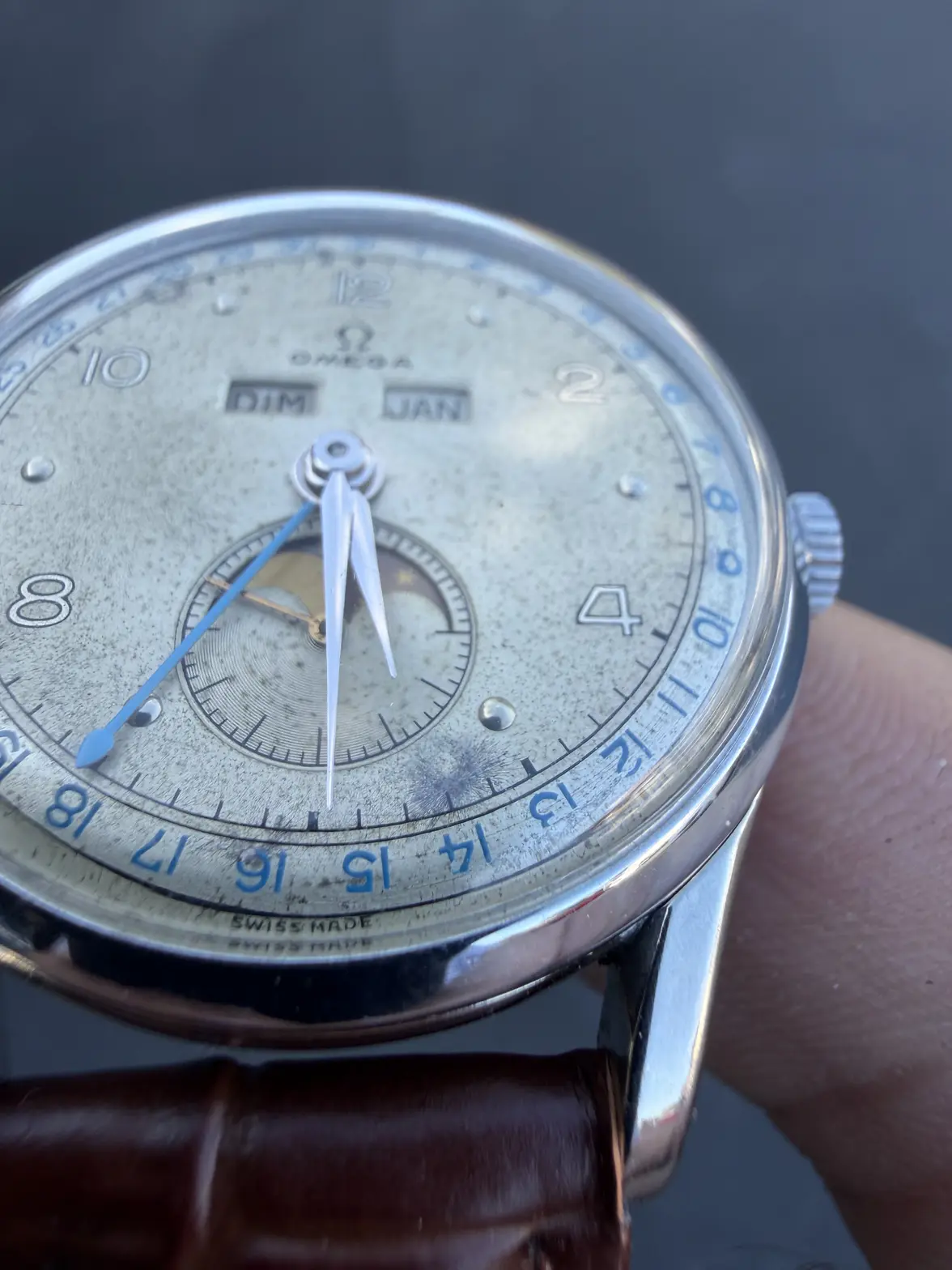

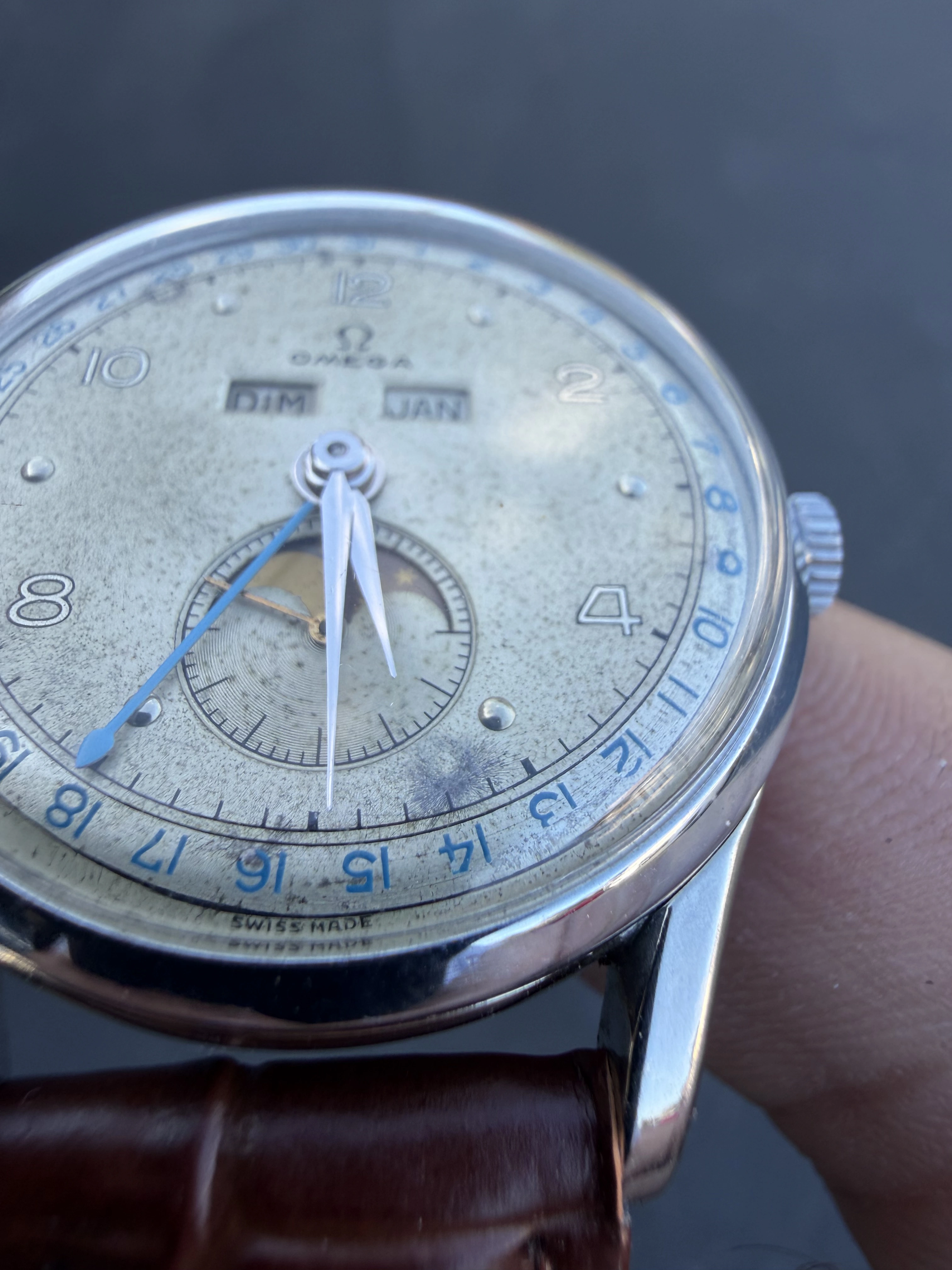

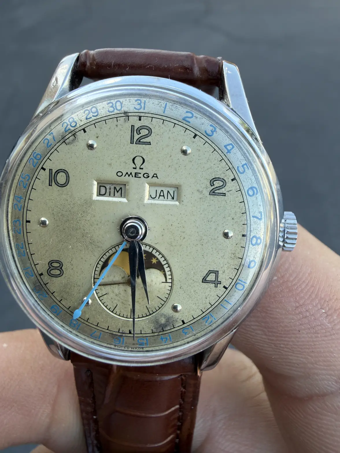

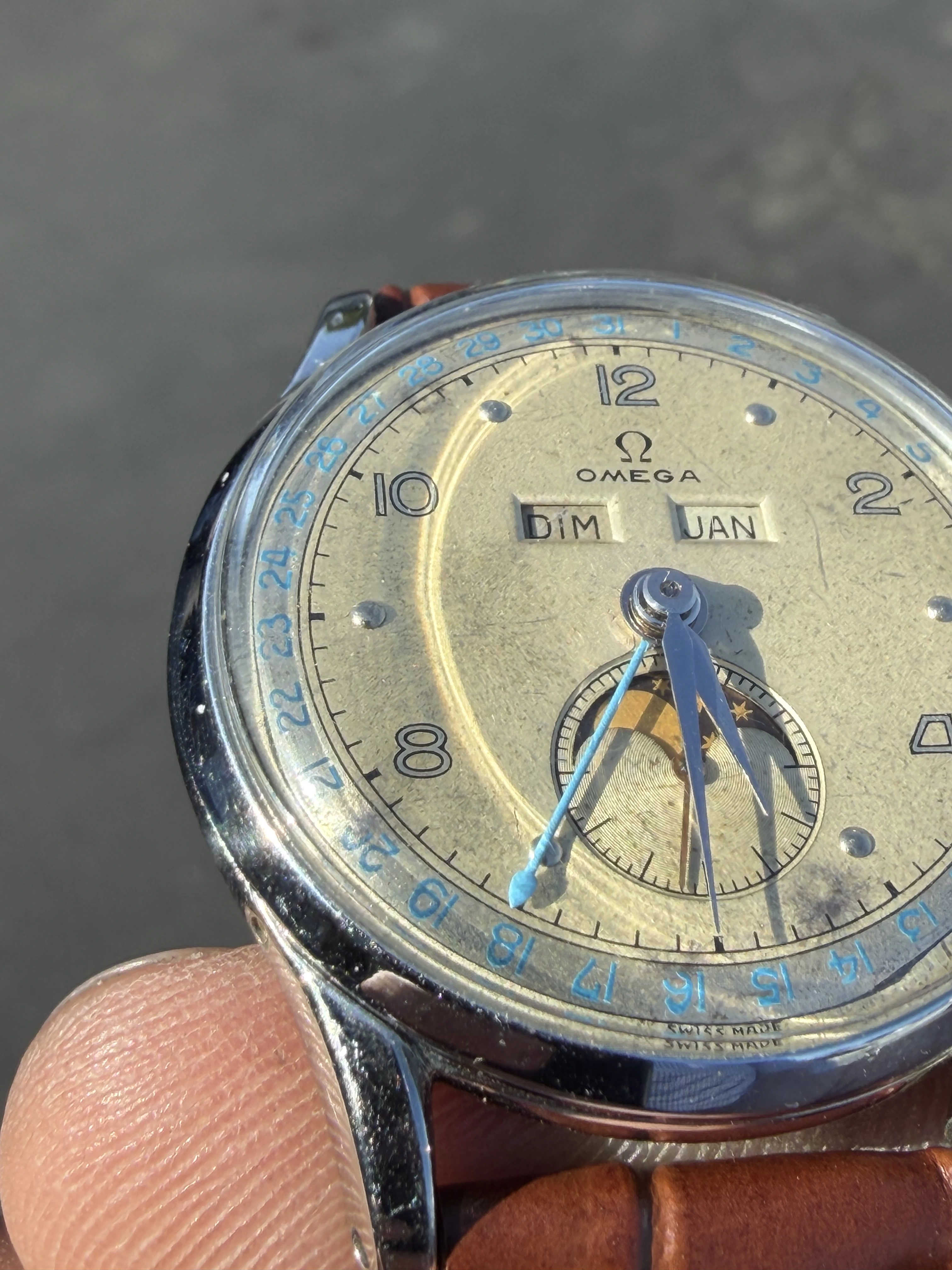

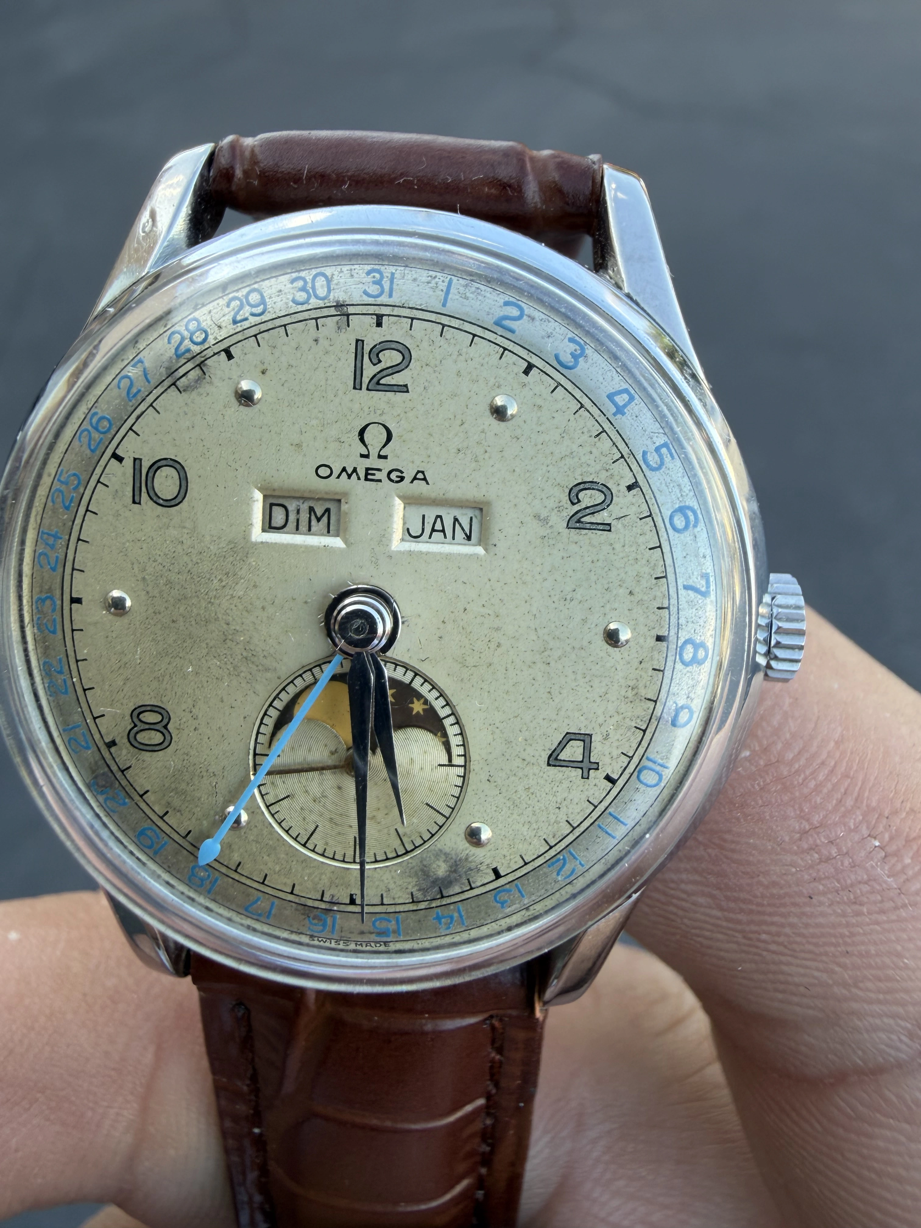

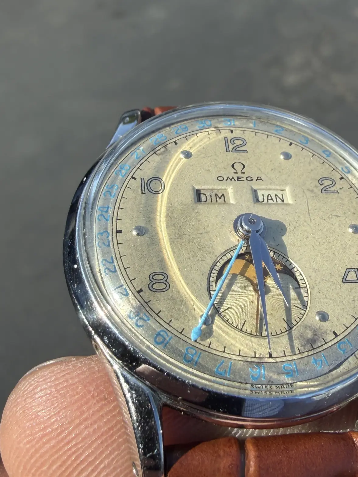

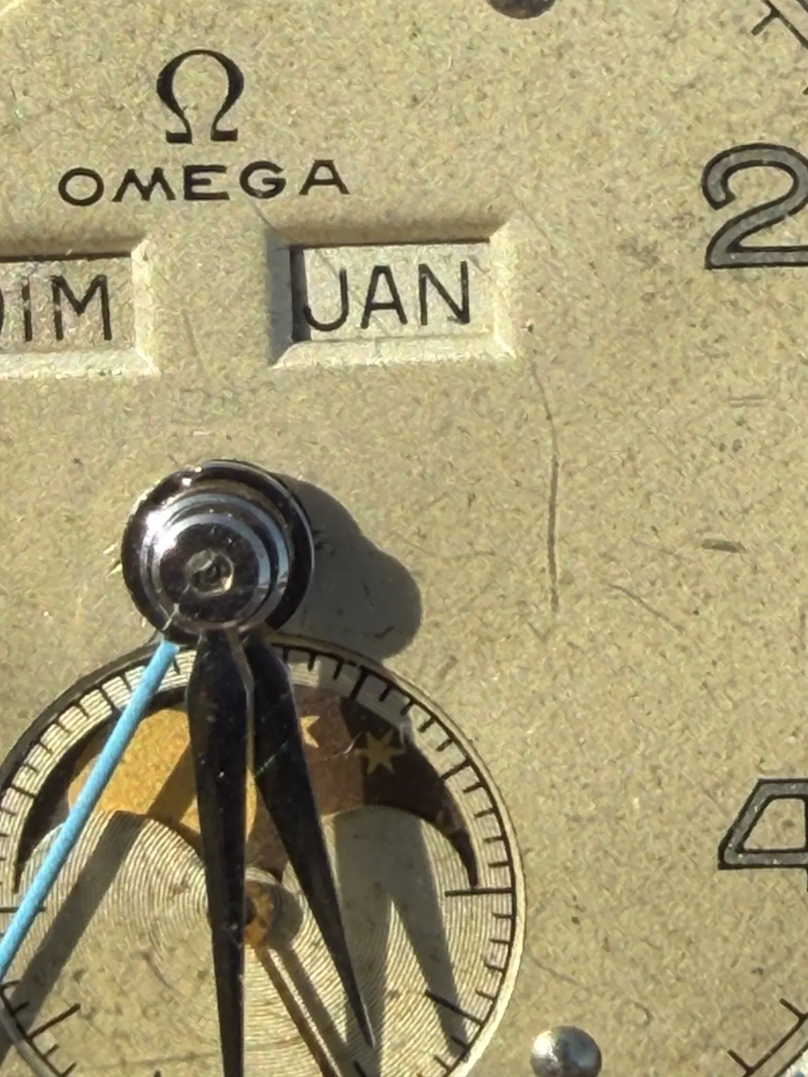

Hello, finally I was able to get this watch in hand.This is my second omega cosmic Per seller the dial is original. The hands are replaced per seller with NOS correct period??
I would love to know your opinion if the dial is redone or original , condition from photos etc…

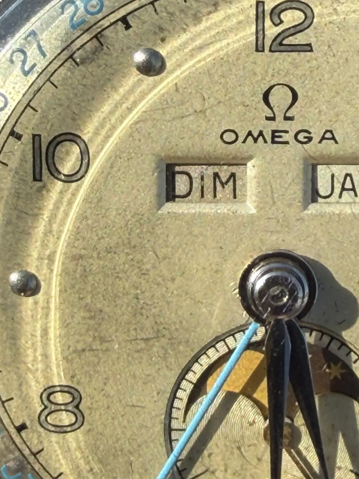

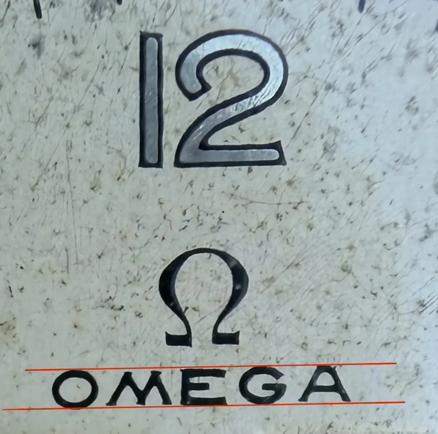

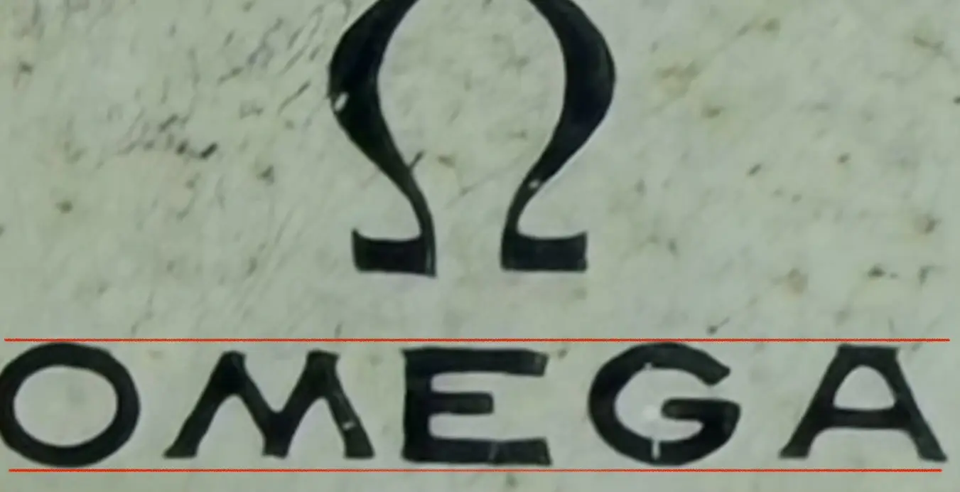

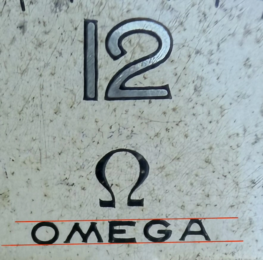

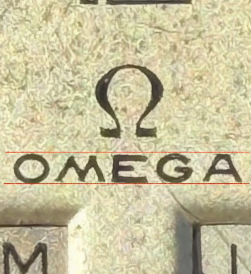

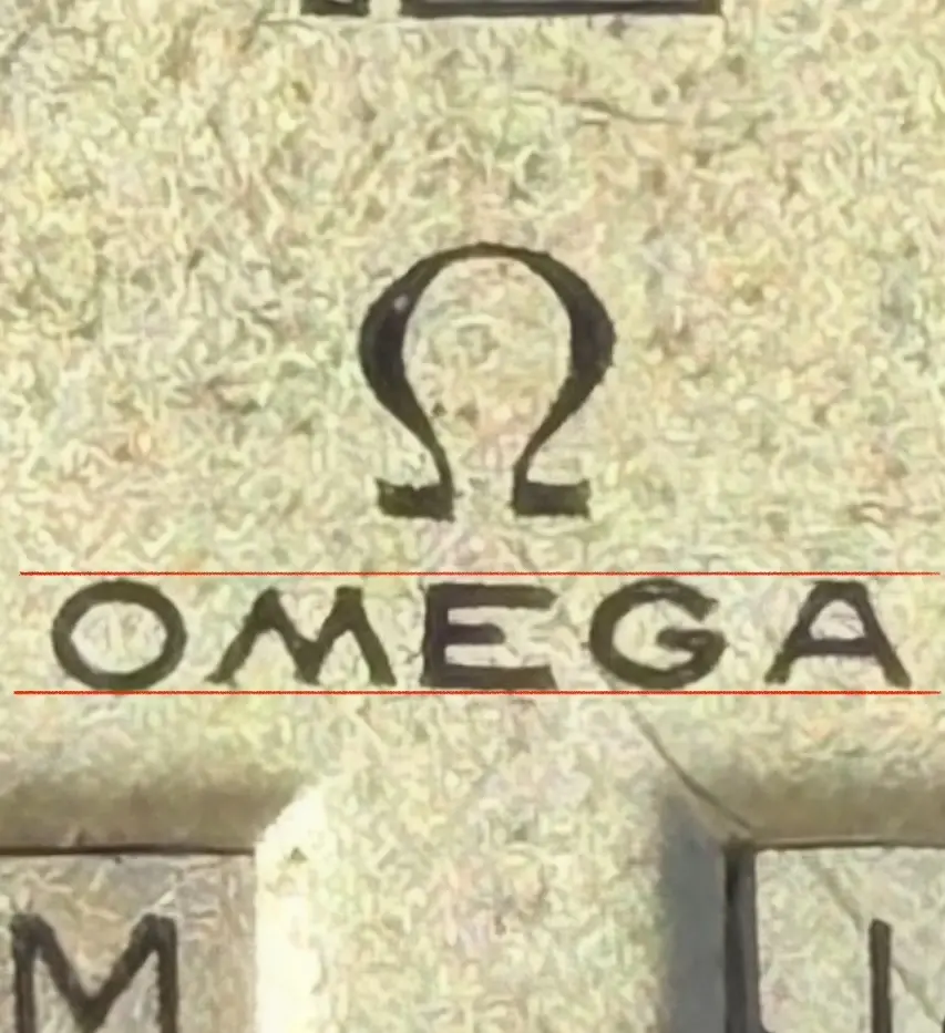

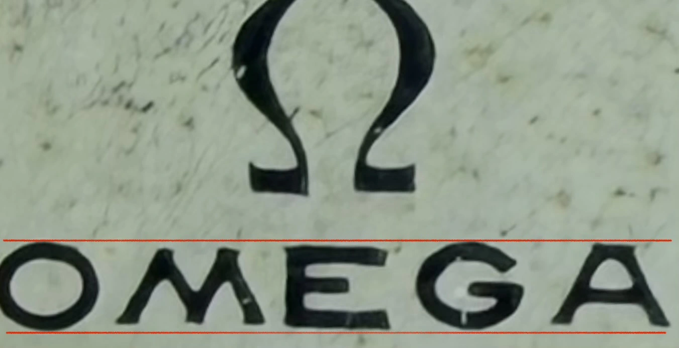

The dial does appear to be original except for a couple things. The "A" in Omega does appear to not be lined up correctly but it could be my eyes. The serifs look a bit weak.
If it's not original, perhaps an early redial.

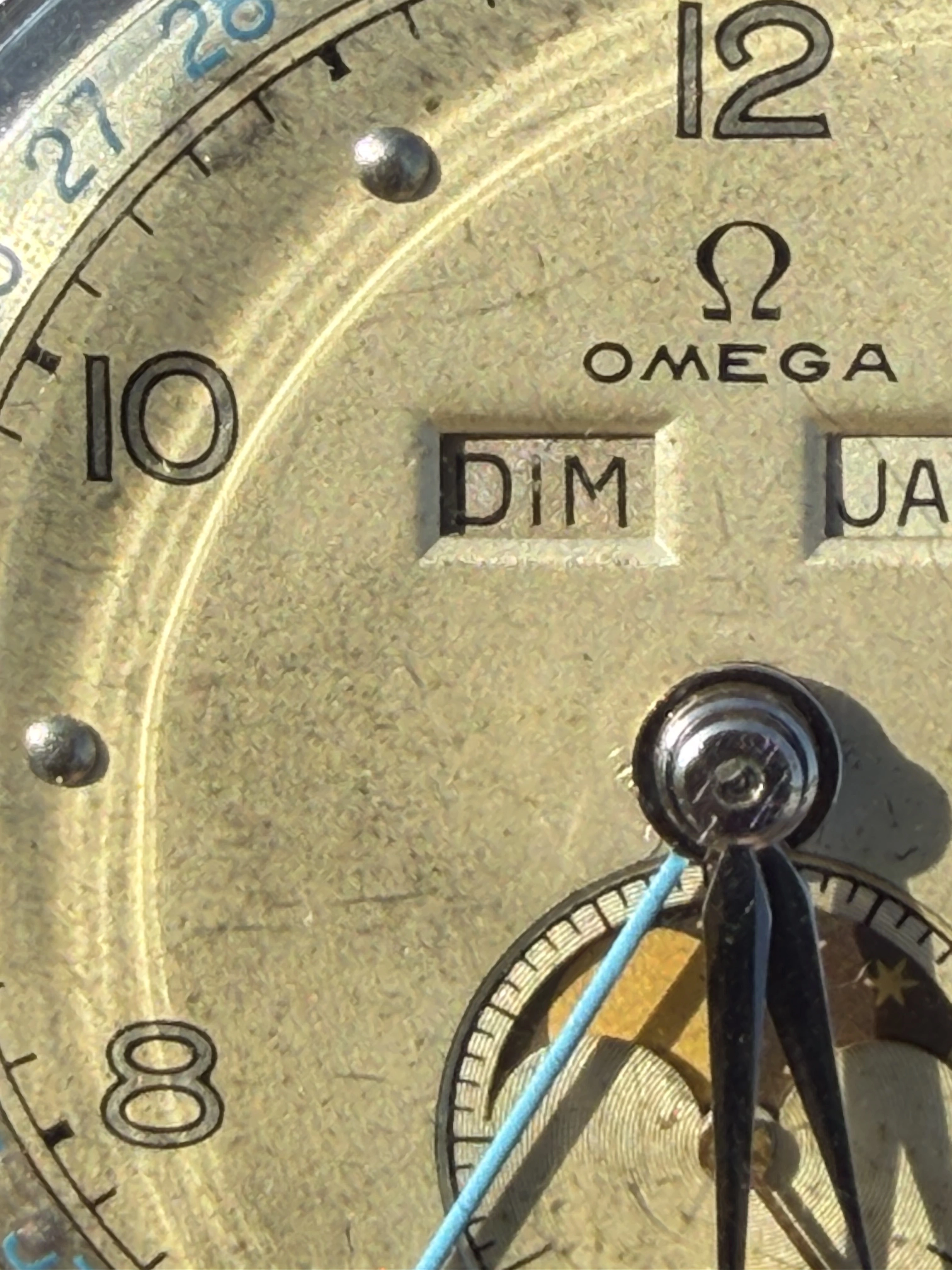

As mentioned on A in Omega. Also left side of logo seems to sit lower.
Could be crystal deflection, but would need to remove crystal to be sure

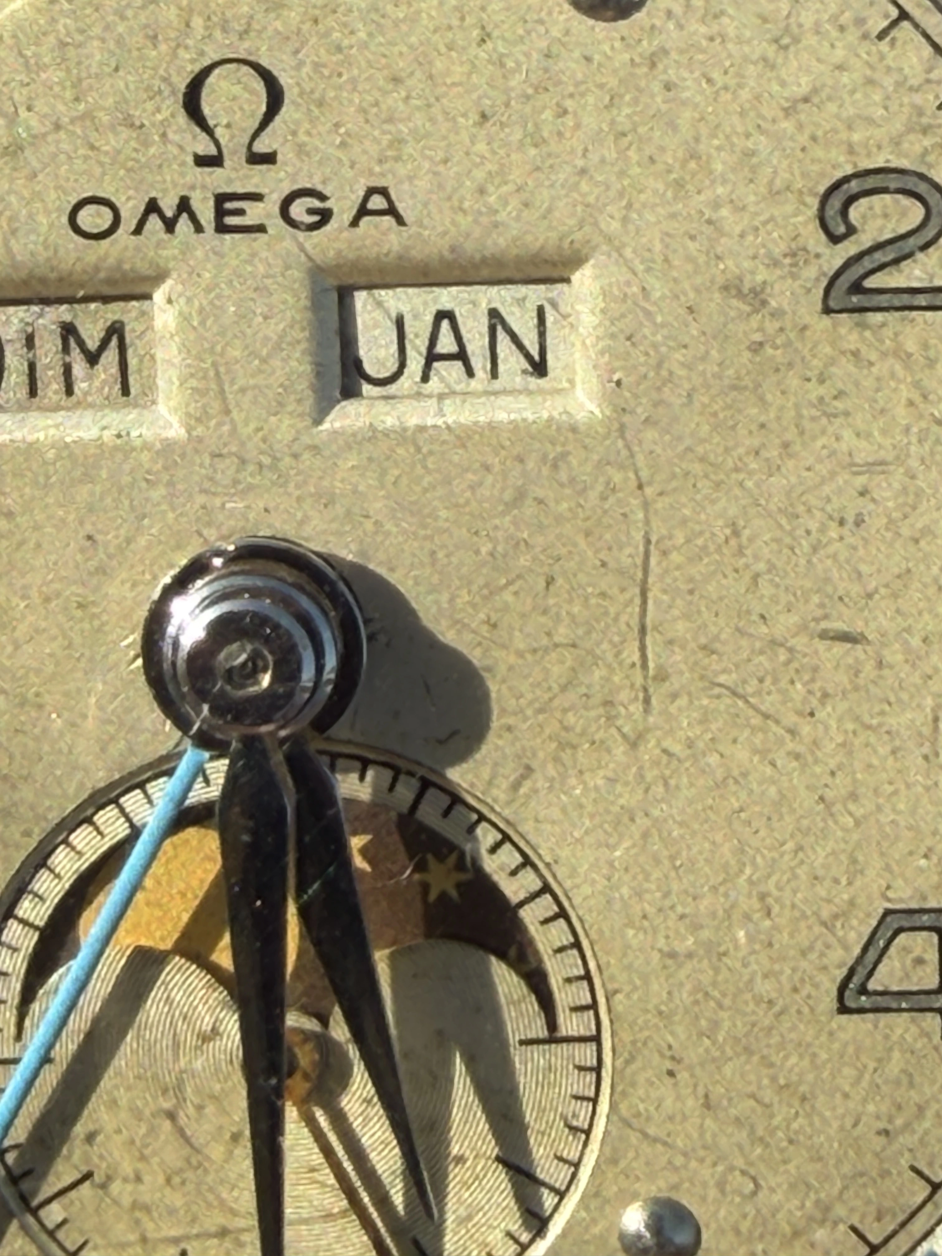

Hello, I did zoom in couple of the photos and try to see if A is aligned… looks ok to me but definitely not sure . thank you for the input.

To me it looks very sloppy....
