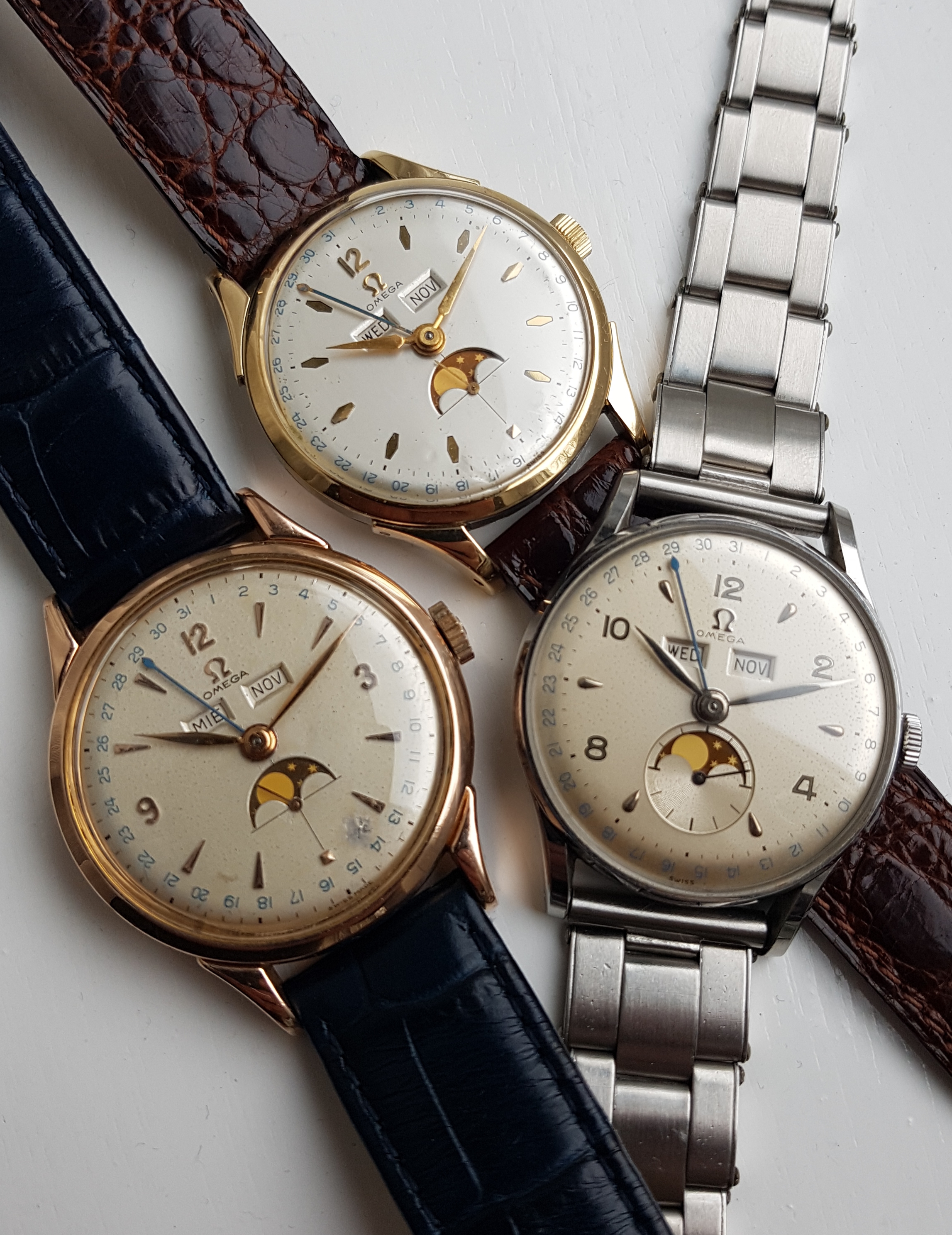

Here a few for comparrison including a 2471 on the right
Thanks guys! Yours, @cristos71 , are beautiful!
