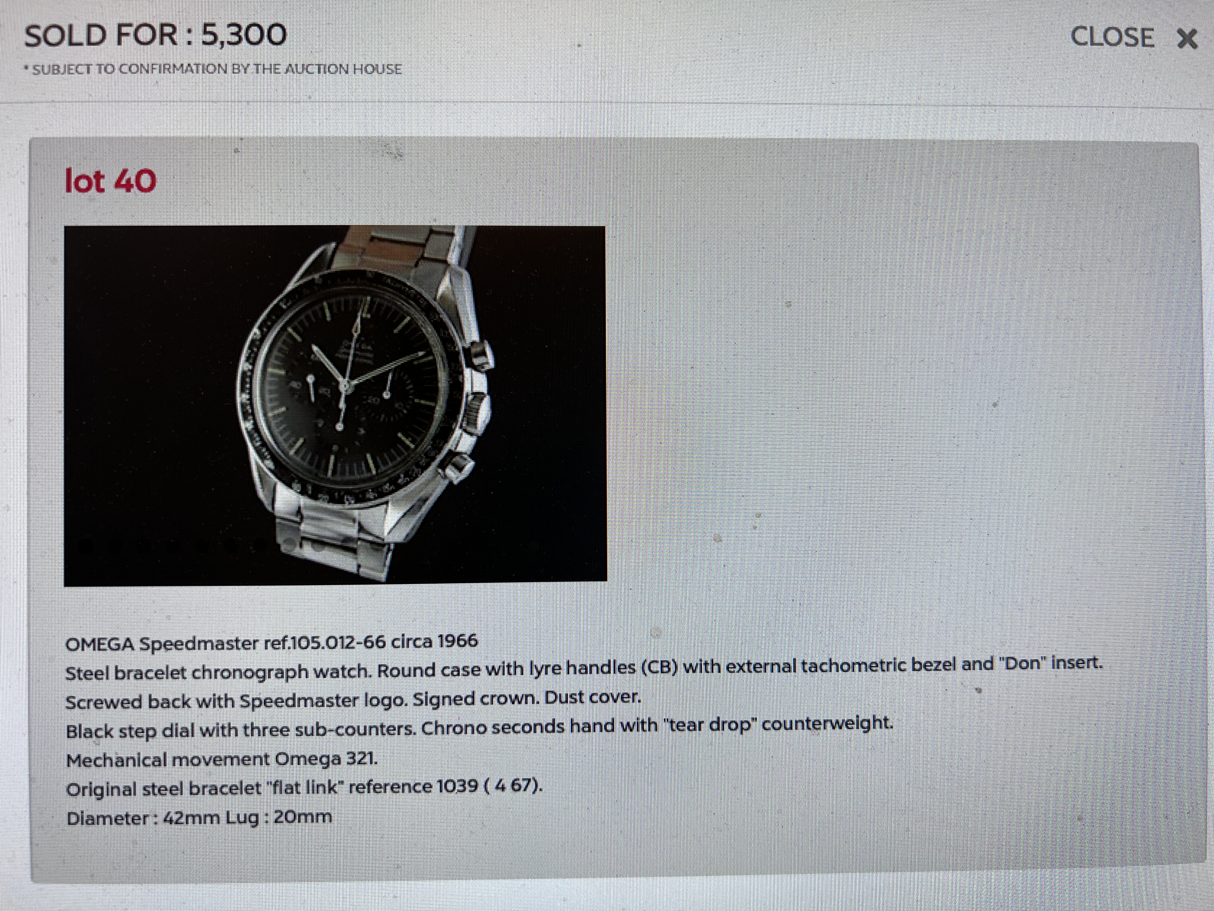

Well....
that was fun, a lot of bids, and raises off 100 € every time, so it took a while!
And the price landed at 5300 € plus a premium of 25%.
So there you have it!

I was a bit tempted to pull the trigger, it took a long time for the last bids to land, so I think 5400/5500 € would have done it??
But since I am not a "senior" Speedy Guy, and don't have so much replacement parts and connections - I passed on it...
Well - on to the next auction!😉

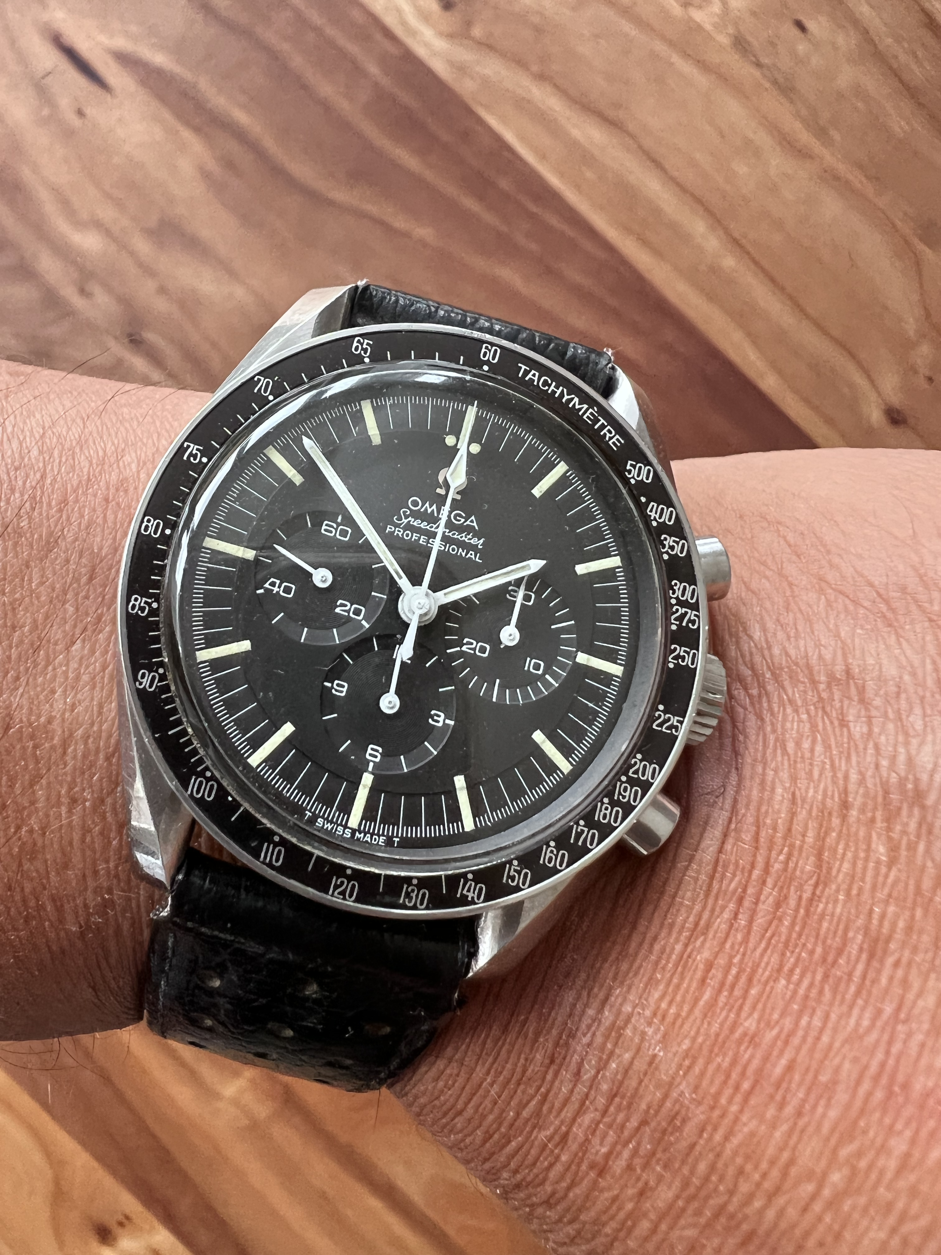

And here's my CB!
So this one is a wide T dial??
Learning by error..🤔
Looks like it to me. By the way, coming late to this thread, I have a CB and the facet lines are barely discernible.
