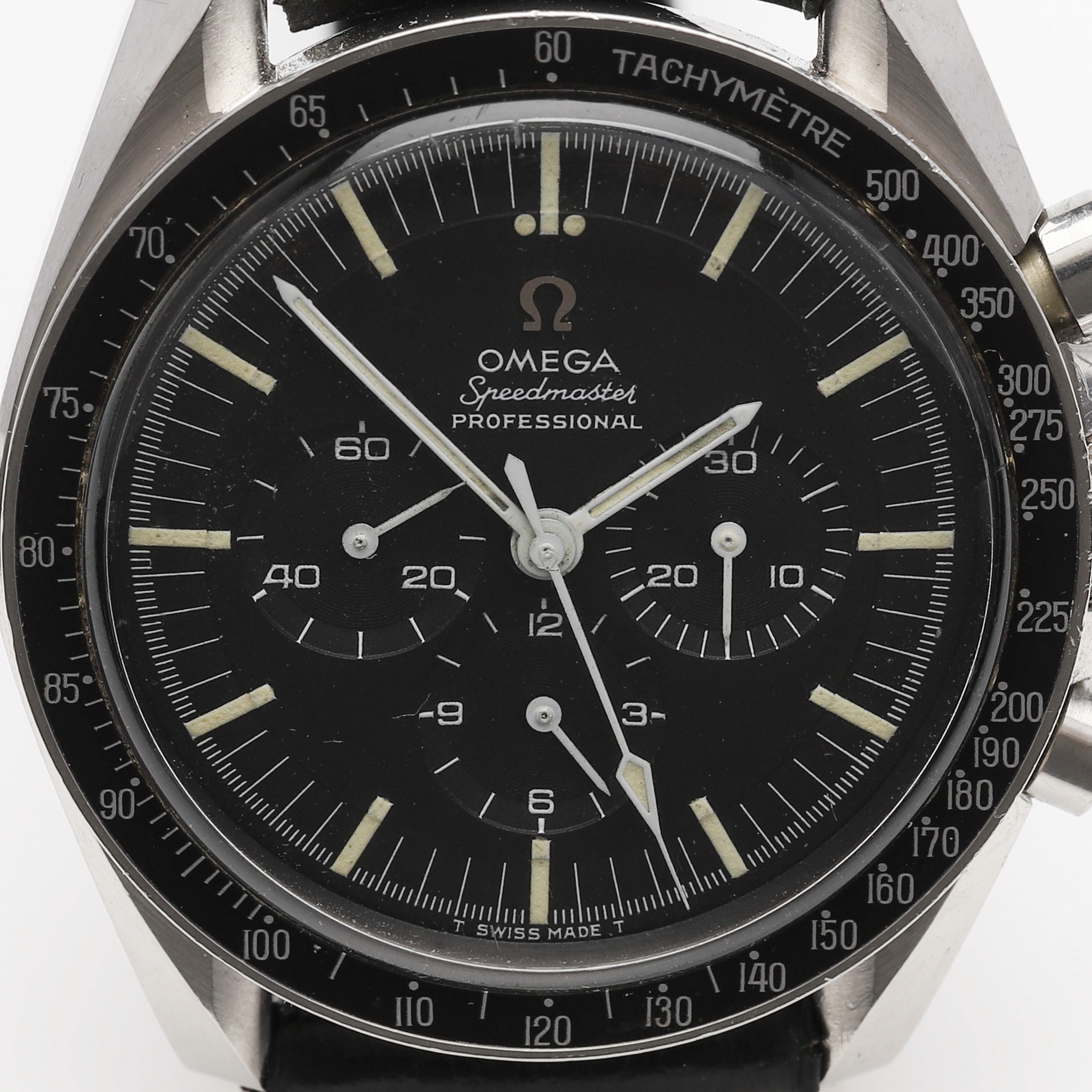

Omega Speedmaster 105.012-66, CB or HF case?

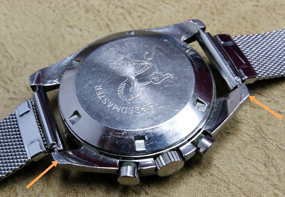

Here are a couple of 105.012-66 that i "snatched" on the web..

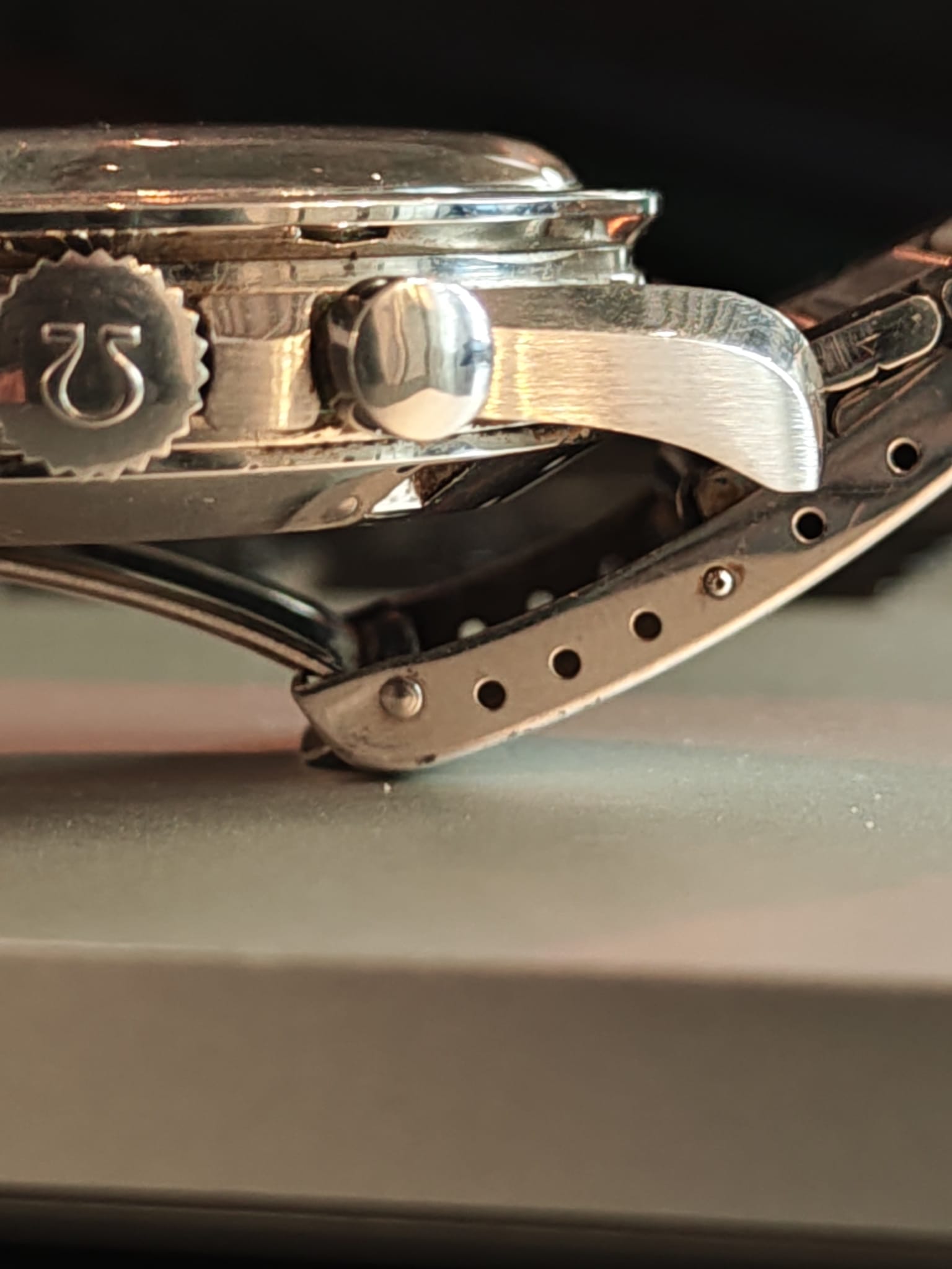

And here's my CB!
So this one is a wide T dial??
Learning by error..🤔

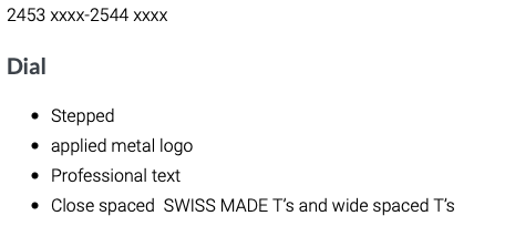

The serial nr is 2495xxxx, and the range for a 66 should be 2453 xxxx-2544 xxxx (Speedmaster 101 once again..😉)

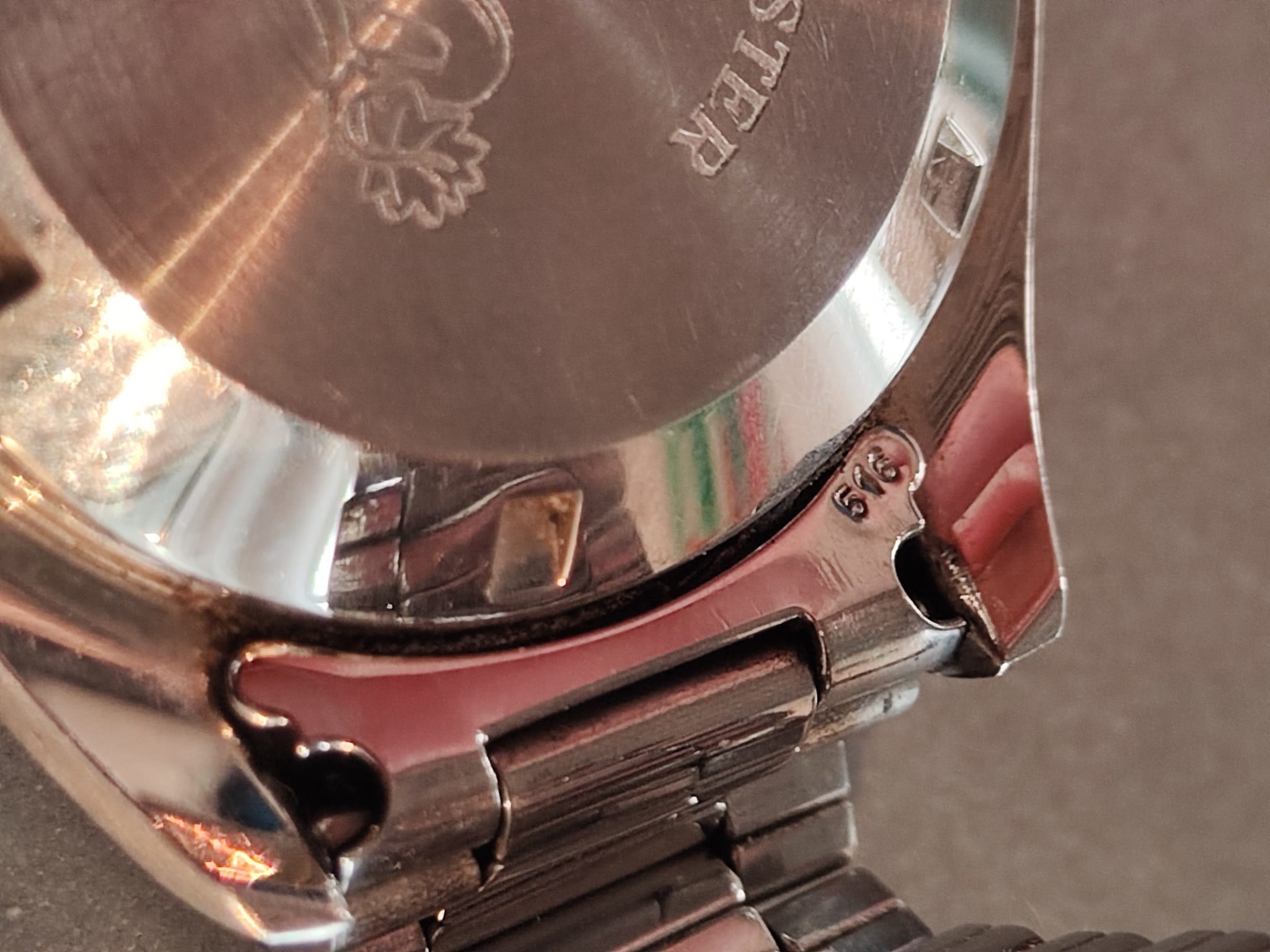

Aside from the lug facets, the case side profile is different on CBs. In this instance though it’s the facet on the underside of the lugs tips. They’re larger and more pronounced on CBs whereas the HF cases have small facets right at the end (as shown on the OPs watch).

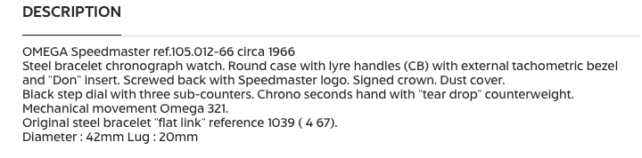

Hi there Forum Folks! Here is an update regarding the watch!
The auction house has now changed the description, from a HF to a CB....And from a 145.012 to a 105.012!
This shows once again that auction houses are a bit in "the dark" regarding what they are trying to unload??

@Davidt, are these the ones you are referring to as HF facets?
And this is NOT the watch that is up for this auction..
13,543
23,487
Yes those are the facets I’m referring to but that isn’t a CB case either.
