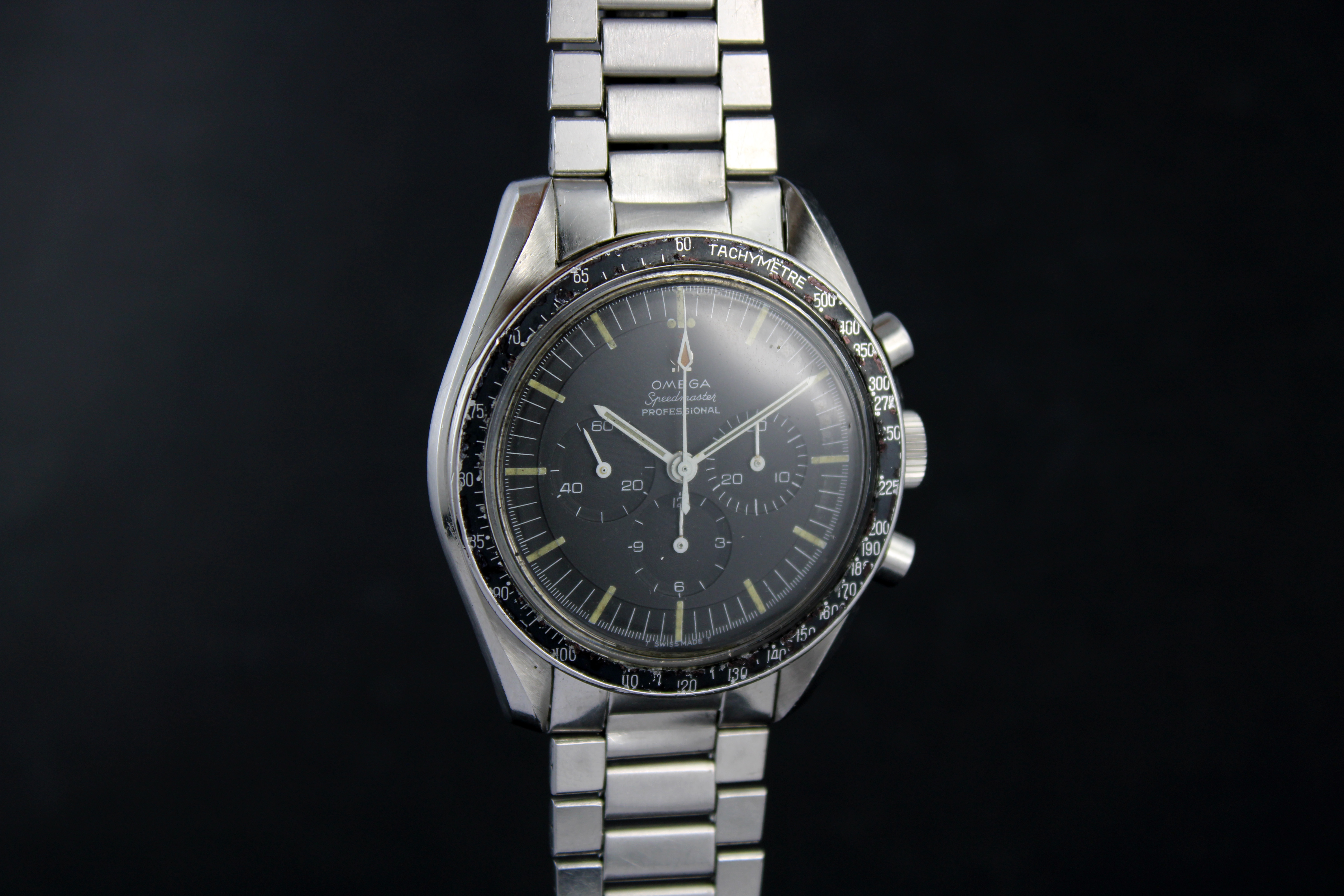

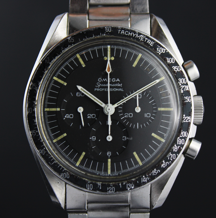

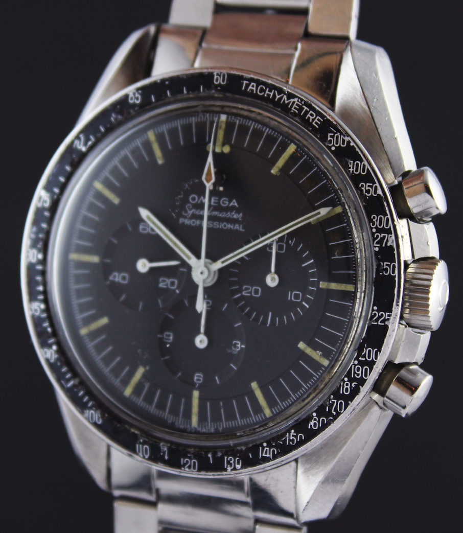

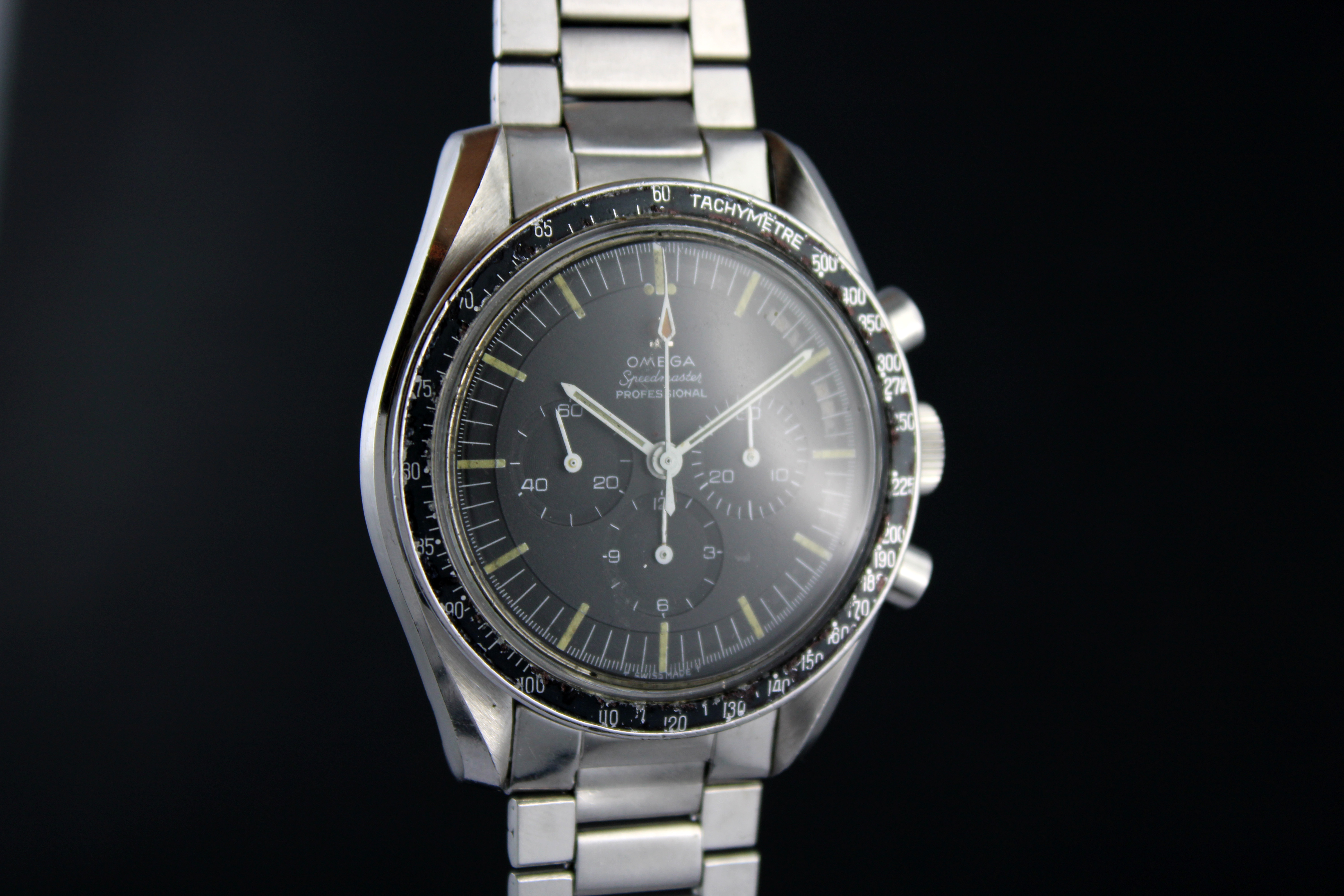

Hi Forum Folks!
I am looking at a watch that's on an auction, and I do need your help here.
The auction house states this a 145.012-66, but I don't think they have a clue?
Here is the description from them:
OMEGA Speedmaster ref.145.012-66 circa 1966 Steel bracelet chronograph watch. Round case with lyre handles (Huguenin frères) with external tachymetric bezel and "Don" insert. Screw-down caseback with Speedmaster logo. Signed crown. Dust cover.
Anyway..

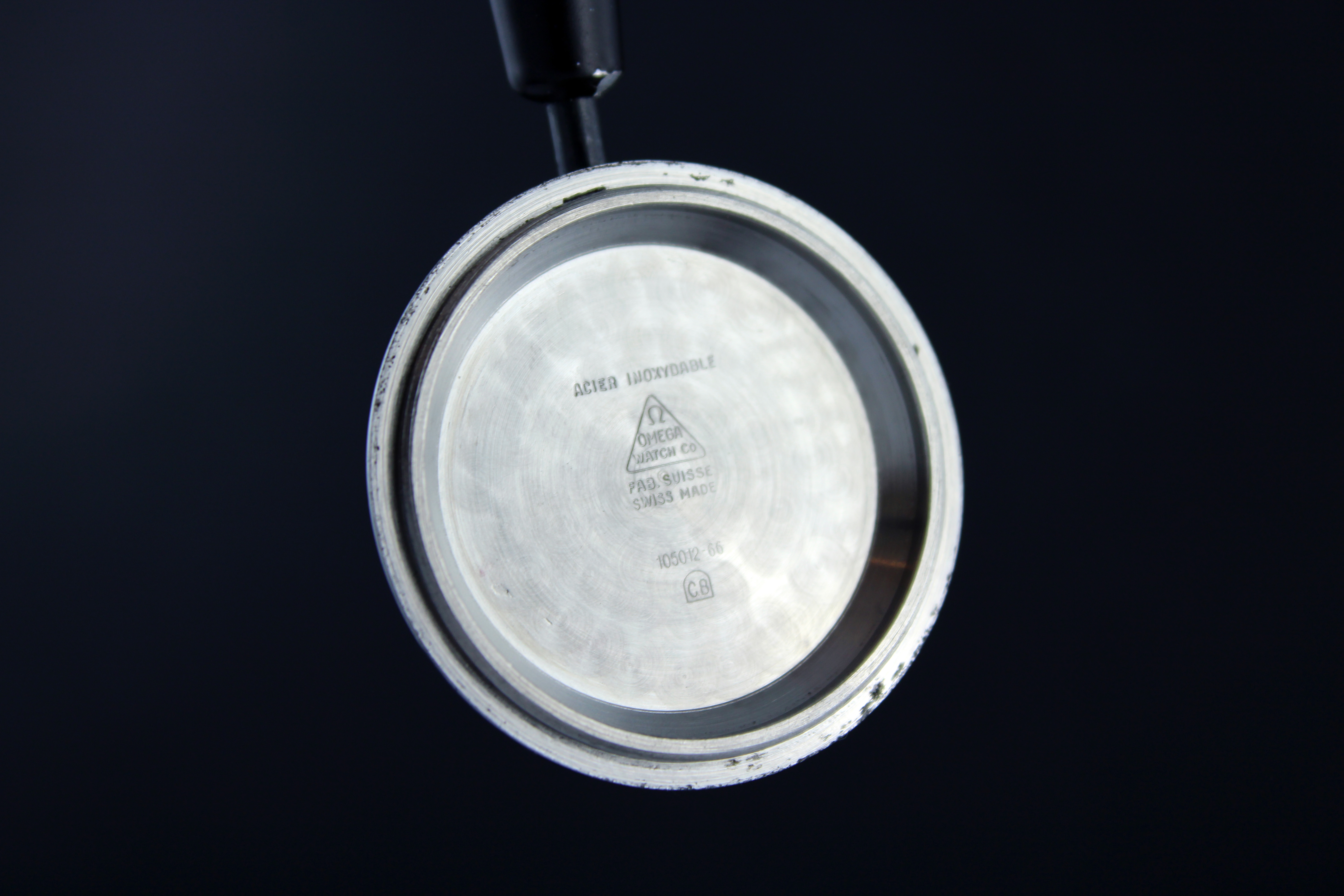

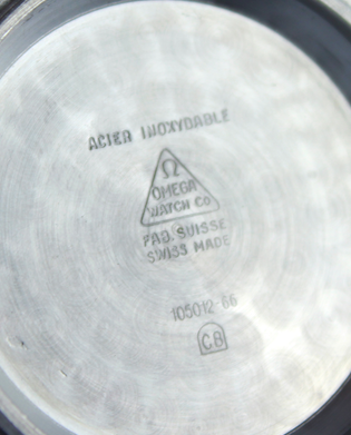

It has a 321 movement, and the serial nr is in the right period.

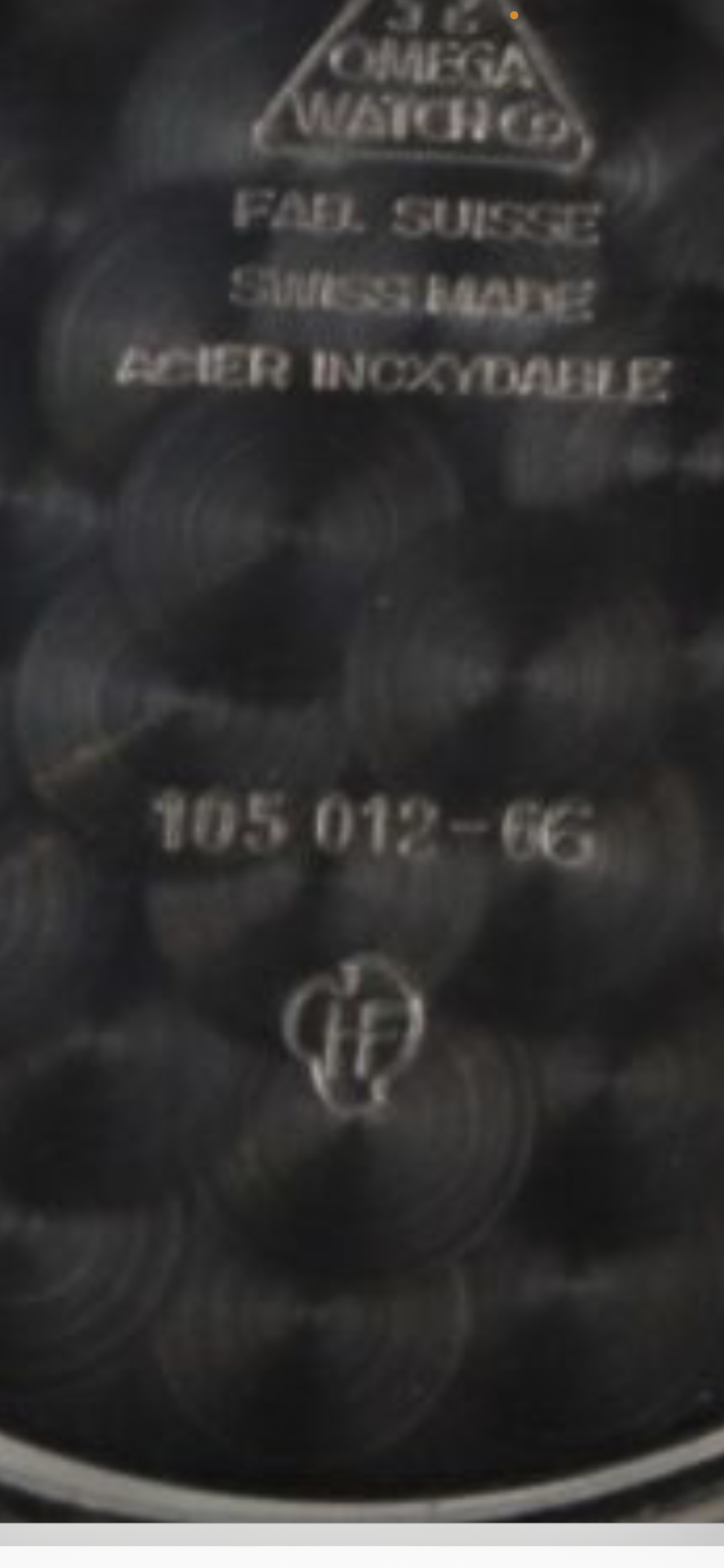

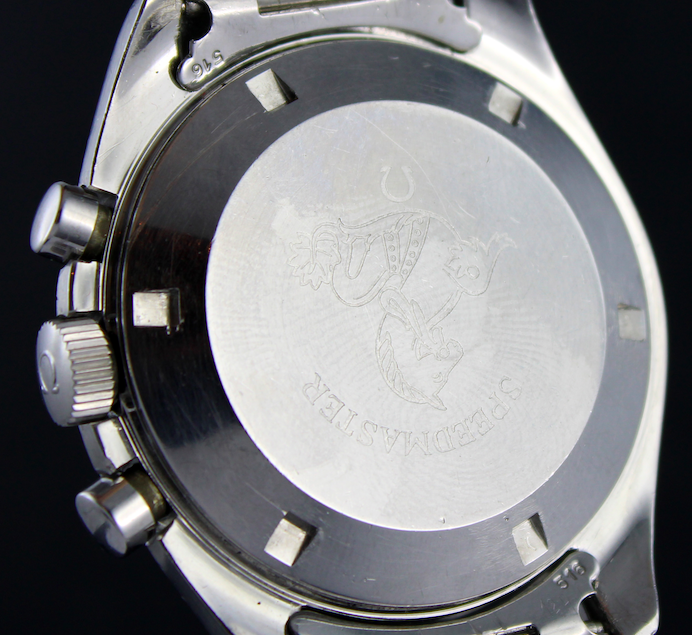

The pictures shows the caseback with a CB stamp, but the pictures of the watch doesn't (in my opinion) show the facet line on the lugs..
Could these have been shaved down, or is the casebook from another watch??
I know that the condition isn't top, but it would be a nice daily beater maybe?
But I need som help with this one!
What do you guys think?

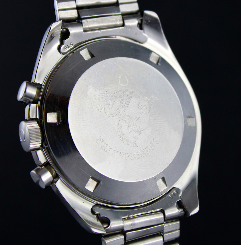

Can you get a picture of the side profile or the rear of the case?
2,625
5,863
Its got "fat neck pushers" (Speedmaster 101:s words..), single beveled caseback...
The crown i think is a replacement?
13,543
23,487
Unfortunately they’ve cropped out the important bit. The tips of the underside of the lugs have a larger facet/flat area on the CB cases. It isn’t really shown in your pic but from what I can just make out in the 7 o’clock lug, this doesn’t appear to be a CB mid case
1,785
5,586
obviously 145.012 is not housed in a cb66 case and therefore, should not have a cb-66 caseback. so the subject watch may just have a wrong caseback. if you get it for the right price, you can find a replacement with the right one later on. good luck.

Midcase is HF and caseback CB (must have been some FU during some service maybe?).
And a hunt for a correct caseback!

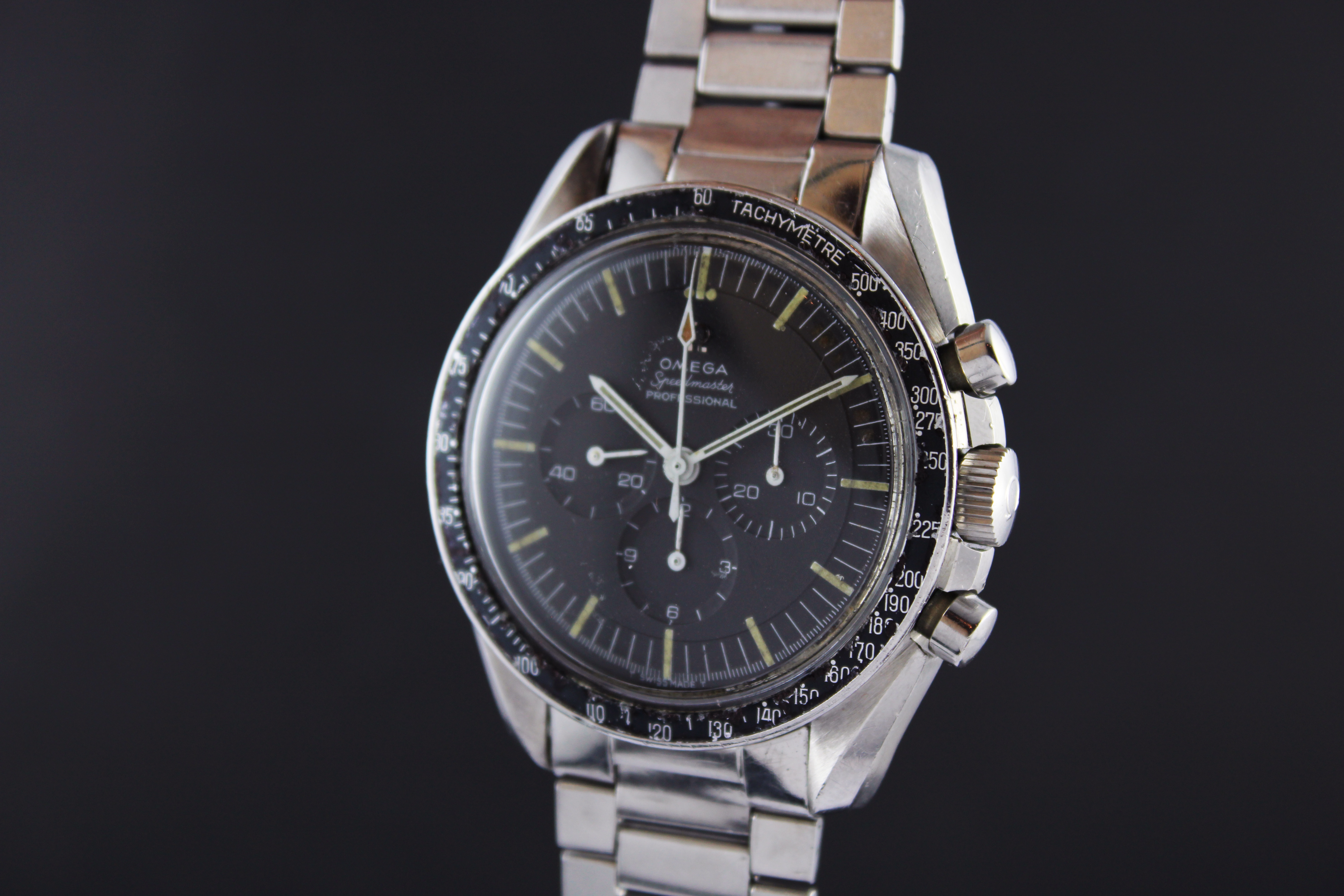

Any comments regarding the rest of the watch?
Please be honest since i dont have the watch yet!

The pushers do appear to be for a 105.012, so I don't see why the auction house is calling it a 145.012, unless the serial number is in the wrong range. Sorry if I missed that info.
2,625
5,863
@Dan S :
I do think it must be a 105.012-66? My title of the thread, but I could be WAY OFF...
The serial nr is 2495xxxx, and the range for a 66 should be 2453 xxxx-2544 xxxx (Speedmaster 101 once again..😉)
24,822
55,202

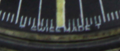

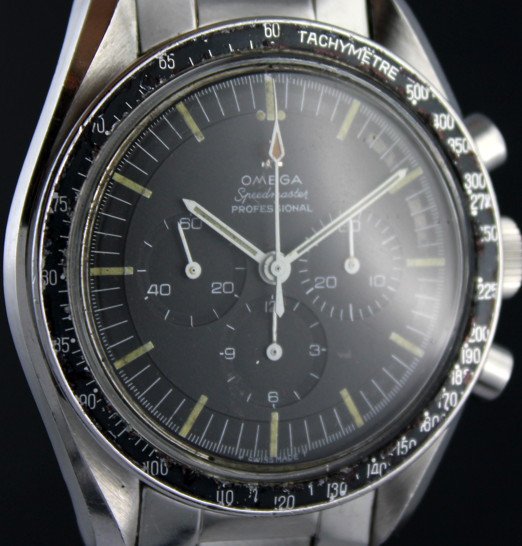

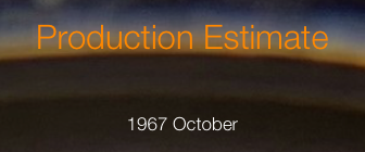

I have a 2495xxxx that is a 105.012-66 HF, delivered in September 1967. It has a wide-T dial, for what that's worth.
2,625
5,863
Thats really funny!
This one checked out as an Oktober 67 (Ilovemyspeedmaster.com)!
I don't have an extract...
So its should be correct!
And wide spaced T also..
So hopefully the reference nr is set now?
Condition is maybe not the greatest..but I do start to like the watch!
24,822
55,202
That appears to be a close-spaced T dial. I believe that the Ts are one tick mark farther out on the wide-T dial.
I'm not saying there's anything wrong with that, close and wide may have been produced at the same time for all I know. But I suspect someone on the forum knows for sure.
