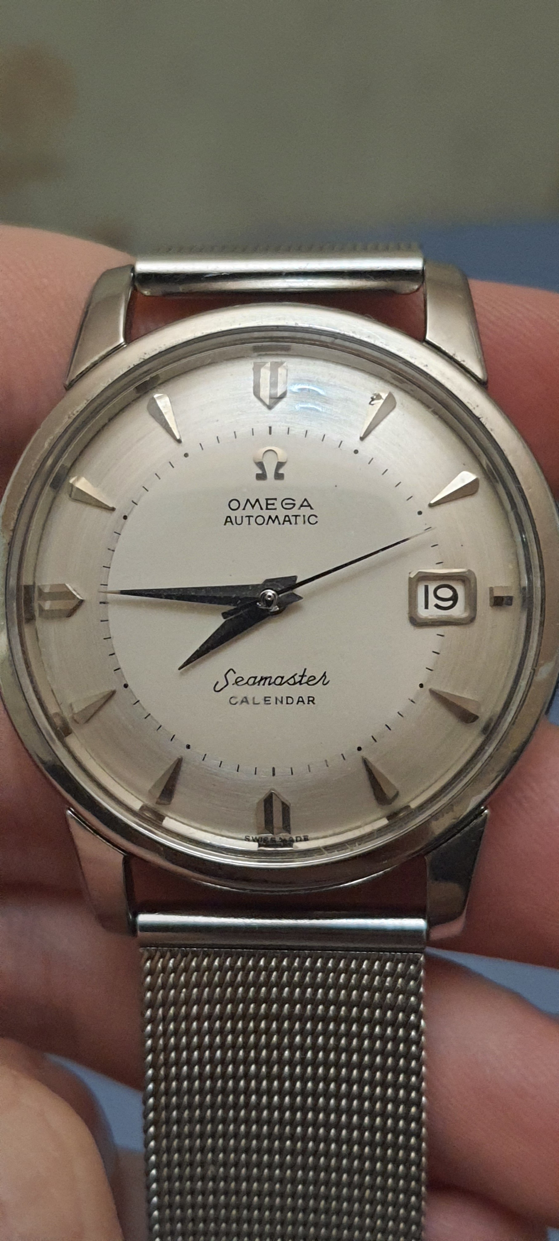

Всем привет.
Не так давно я стал обладателем часов.
Прошу помощи в выборе их независимости. Циферблат оригинальный? На роторе 503 калибра такой надписи не видел. Буду признателен за любую информацию!!

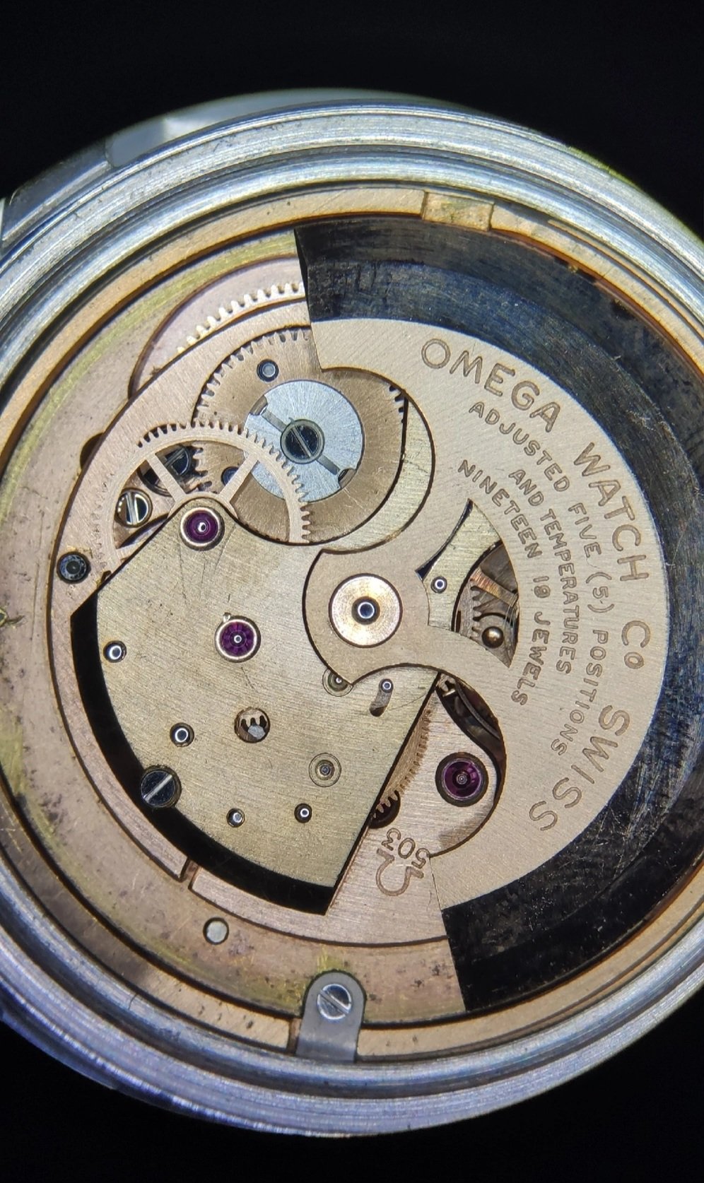

Hello everyone.
Not so long ago, I became the owner of this watch.
I'm ask for help in determining their authenticity. Is the dial original? I haven't seen such an inscription on the 503 caliber rotor. I would be grateful for any information!!

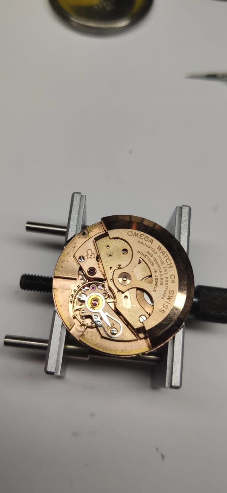

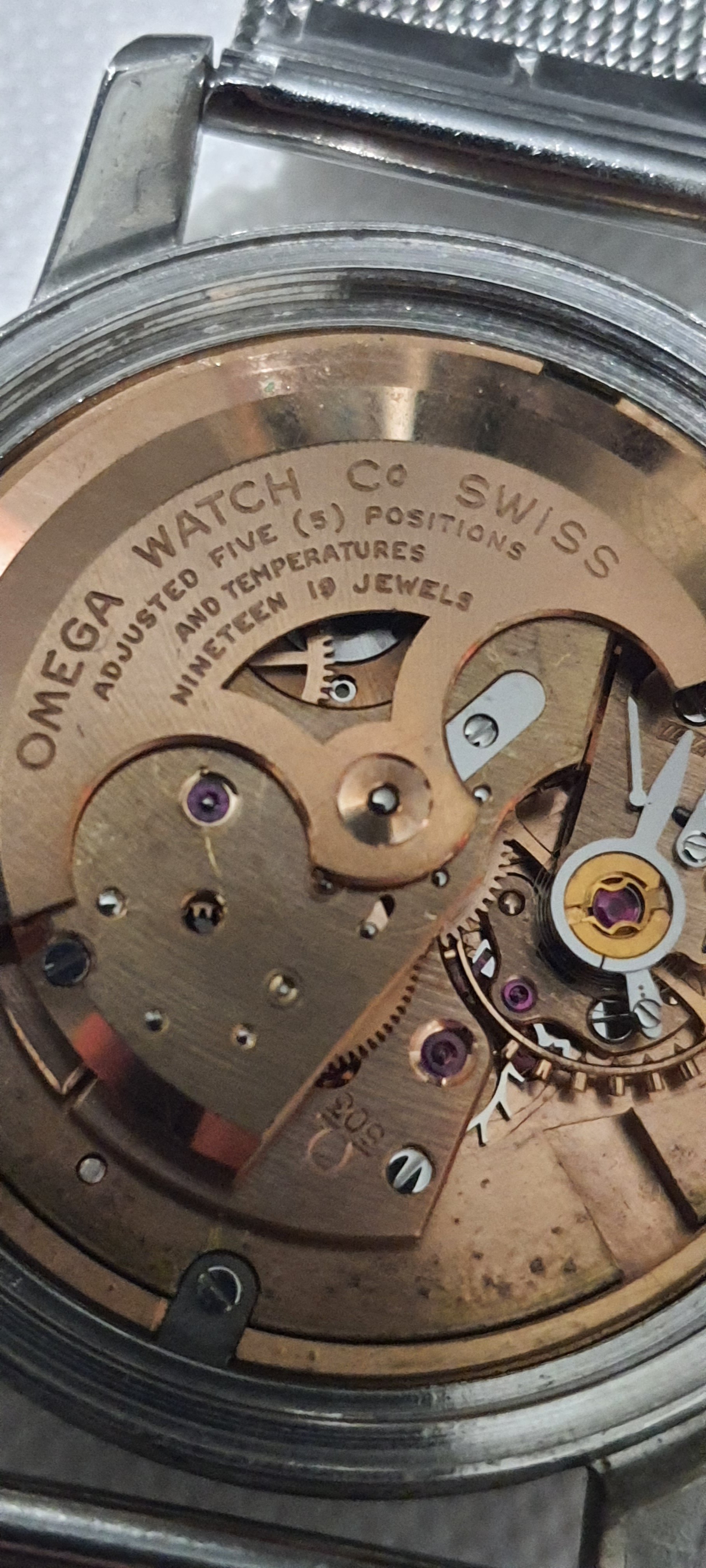

Genuine Omega, but the dial has been refinished and the movement has an incorrect winding rotor.
10

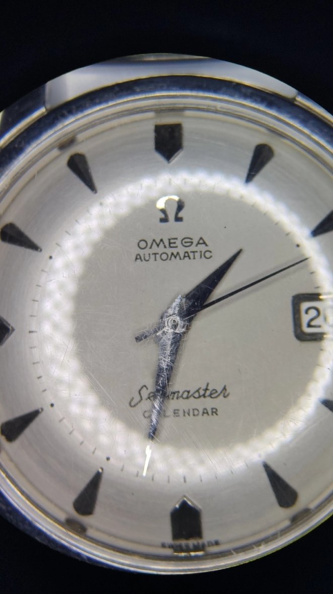

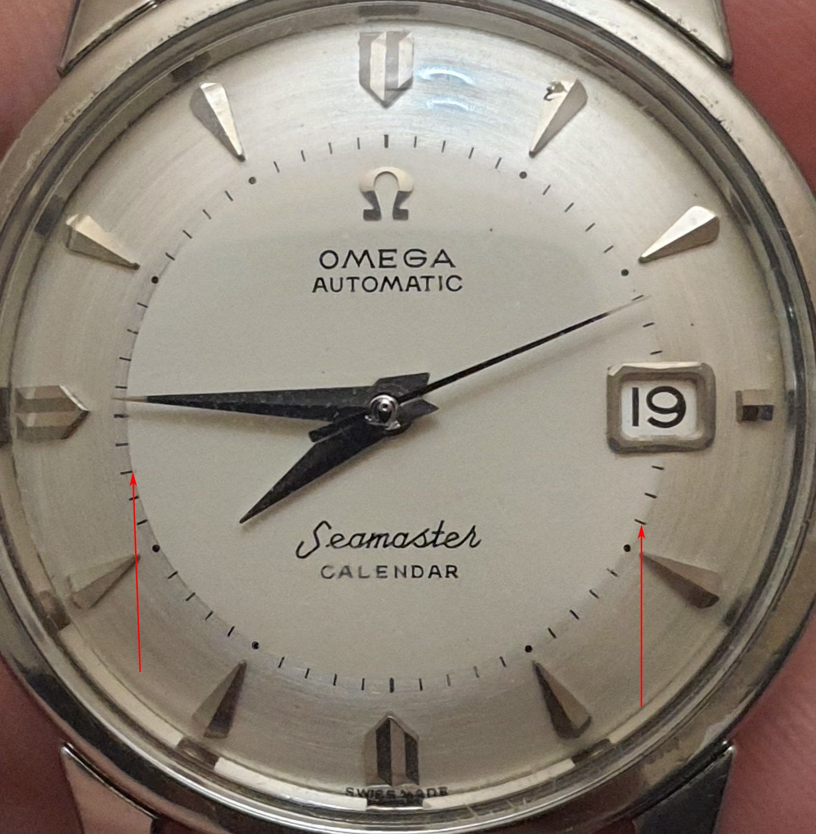

if not difficult, tell me how did you understand that the dial was restored?

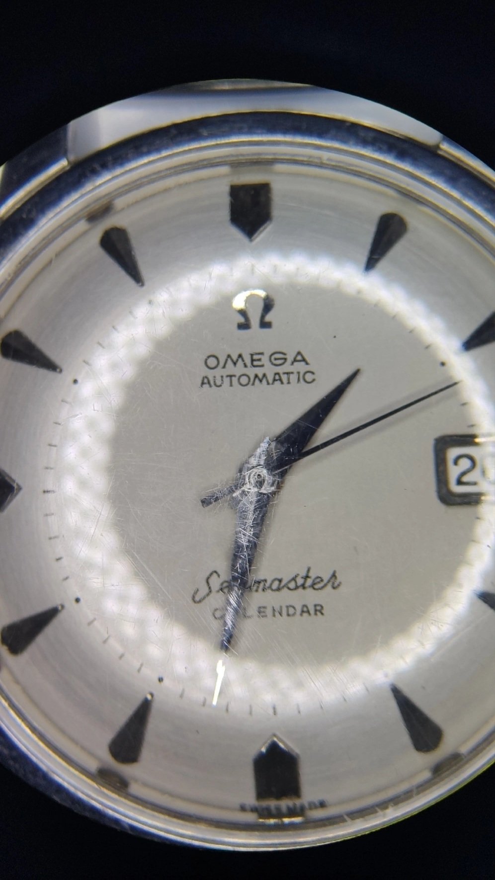

Notice how the minute marks do not align with the brushed portion of the dial, which in and of itself is not crisp as it should be.
13,556
23,504
And the font isn’t quite right. It’s over-exaggerated

Обратите внимание, что минутные метки не совпадают с матовой частью циферблата, которая сама по себе не такая четкая, как должна быть.
[ПРИНЯТЬ]1650274[/ПРИНЯТЬ][/ЦИТАТА]
да, теперь я вижу. большое спасибо за объяснение!

Are the marks on 12, 6 and 9 original? In those photos of 2992-1 that I find they are different. Or were there different options? And yet, I do not find completed sales of 2992-1 in the ebay archive. How much can they cost?
Thank you in advance!
