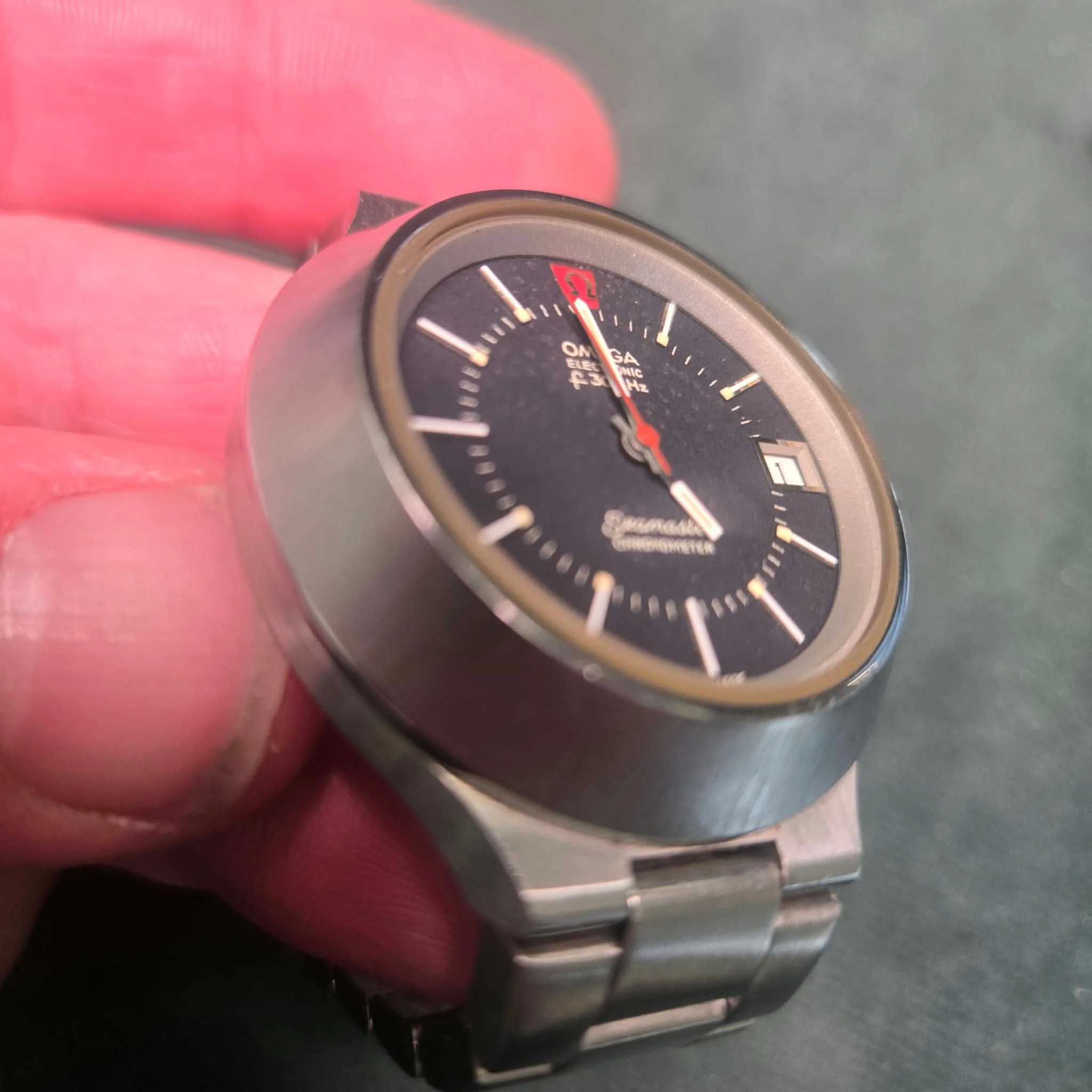

Hi all. I’m about to pull the trigger on this. I really appreciate some help and advice. Let me know if it’s a good one or should I pass?
I want to do better this time. Pun intended.

Unable to give an opinion on the tuning fork movement hidden in the case. Does it run? Externally, looks good. Don’t buy it if there isn’t a return policy. If you do buy it, be prepared for a movement that may need an expensive repair. Price?

It works. I’ve seen a video. I’ve purchased other watches from this guy and I haven’t had a problem yet. I don’t want to post the price but it’s very reasonable.

It runs, you say it is a good price, you’ve bought from the dealer before, so it is pretty much you call.

I appreciate that. But last time I bought an Omega I was told to ask here first before pulling the trigger. I just want to make sure it’s genuine.

No fear! I very much doubt that anyone would be able to copy that one. We do run into very clever fakes, but mostly on mainstream items.

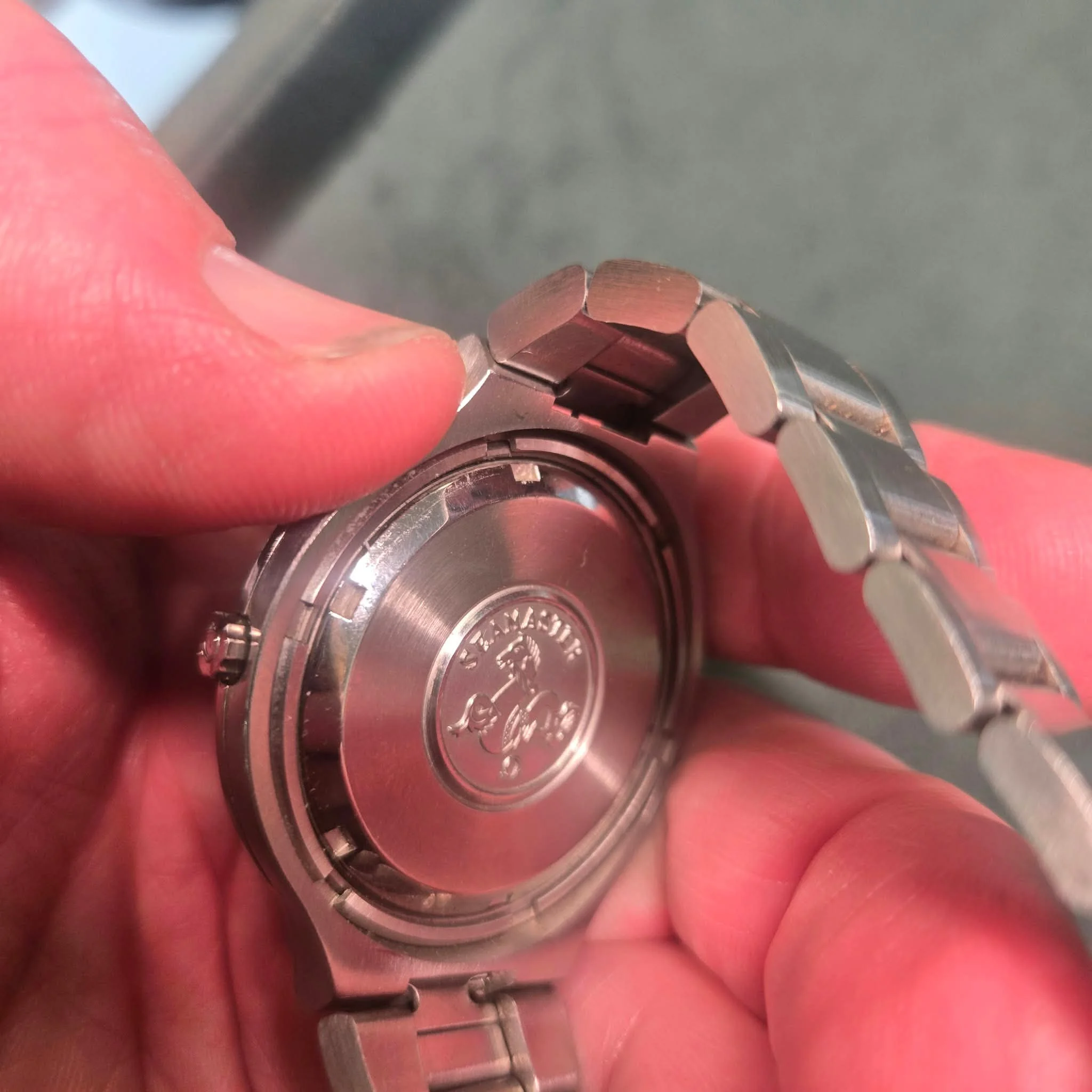

It's genuine.
But be aware that if it ever needs service/repair then the options are very limited, there are only a handful of experts across the world who can correctly diagnose/repair/service these tuning fork movements.

Thank you so much. That’s what I was hoping to hear. Very much appreciated. I am aware of the cost of repairs and the fact that it’s hard to find a competent watchmaker that can fix it.

Couple of things to check that will provide more detail than just seeing it run.
1. When setting time, does the second hand move? If so, the index wheel might have excessive wear.
2. Does the date advance cleanly through all 31 days? If not, the calendar wheel (which is plastic) may be worn.
Either of those problems suggests a service. There are still some watchmakers that can service that movement, but most local watchmakers do not have the expertise or specialized equipment that is required. You can search the forum to find recommendations.

Thank you. That’s a great reply. I’ll ask the seller. Much appreciated.

Yeah, the calendar wheel on these is prone to damage. Typically you'll find that it gets stuck on one day of the month. Replacements are difficult to find, but available and the work can be undertaken by a normal watchmaker - provided that you can persuade him to do it... The calendar wheel is a hands and dial off job, no different to a mechanical watch, no different to a quartz.
You just need to convince the watchmaker that there be no dragons on that side of the movement.

Thank you. More great information. You guys are very helpful.
