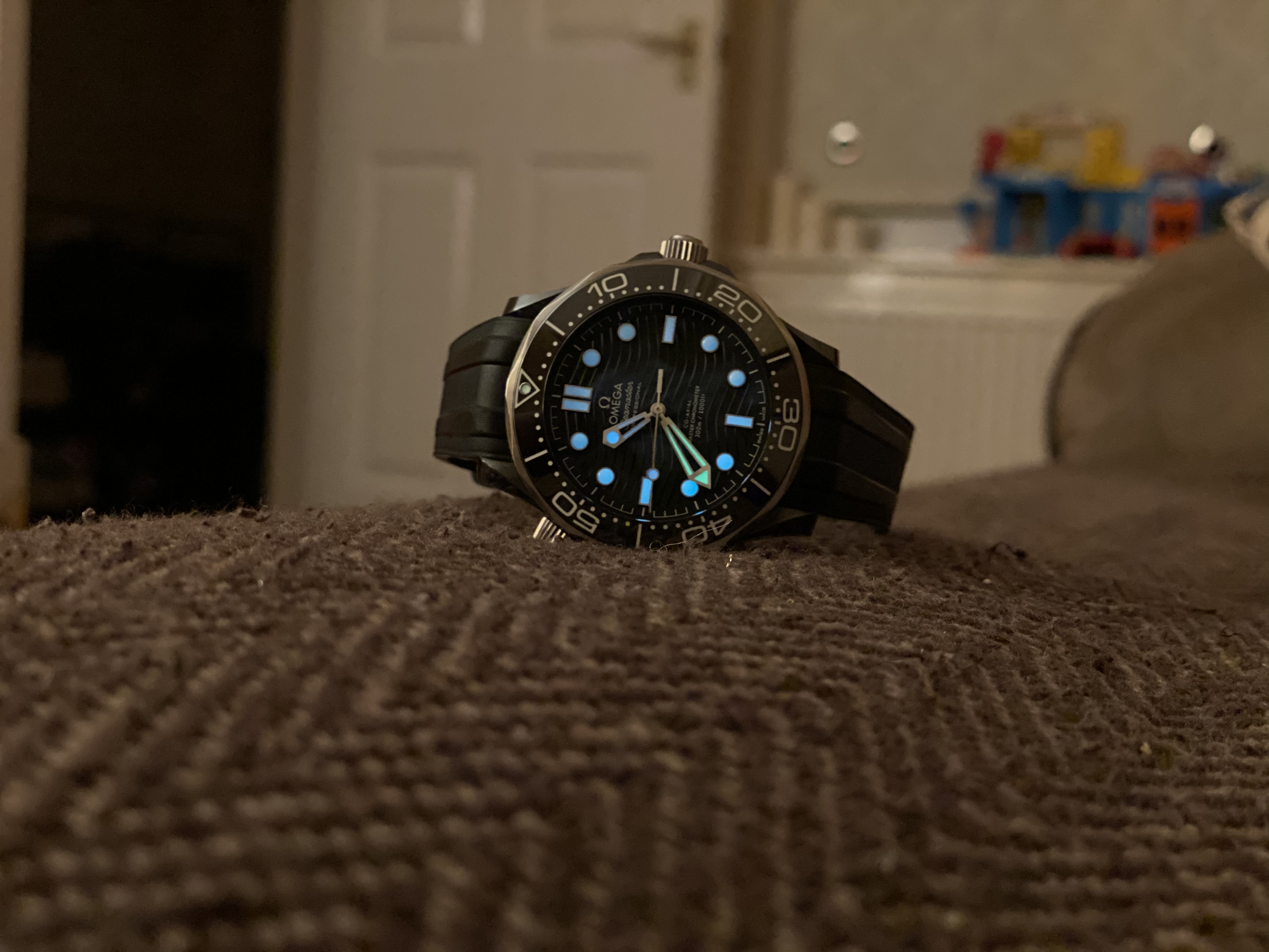

Hi guys, I have a ceramic seamaster Which I’ve owned since July, an amazing watch which I love and cherish, but today after winding and setting the time I tried to screw down the crown which isn’t screwing in at all. I even tried cleaning around the crown with a clean brush but the crown isn’t screwing in. Please can you advise me on what I can do to resolve this. Many thanks
When you say ceramic Seamaster, do you mean a steel watch with ceramic bezel, or a model with the ceramic case?
The difference will be in the case tube material, so the steel model will have a steel case tube and crown, where the ceramic model uses titanium for those parts.
It sounds like the case tube is like stripped - the threads are typically on the inside of the tube and when they are stripped, they look like this:
They should look like this:
Omega will replace both the case tube and crown - should always replace both when there's thread damage IMO. Is this the first watch you have had with a screw down crown? Typically stripped threads are not a big problem on Omega watches, but it can happen if you are not careful threading the crown back on. If you are just getting used to thread crowns down, you can press down lightly to compress the spring inside the crown, turn the crown backwards until you feel the threads click, then screw the crown down - this can prevent cross threading. You also do not needs to crank the crown down really hard - this does nothing to add water resistance, and only increases the chances of crown damage.

Thank you so much for the feedback guys, really appreciated. I have the all ceramic sea master with titanium. I believe the case tube is stripped as suggested by Archer. I called my local omega ad, however they aren’t open until another two weeks or so because of the lockdown imposed. Fingers crossed
