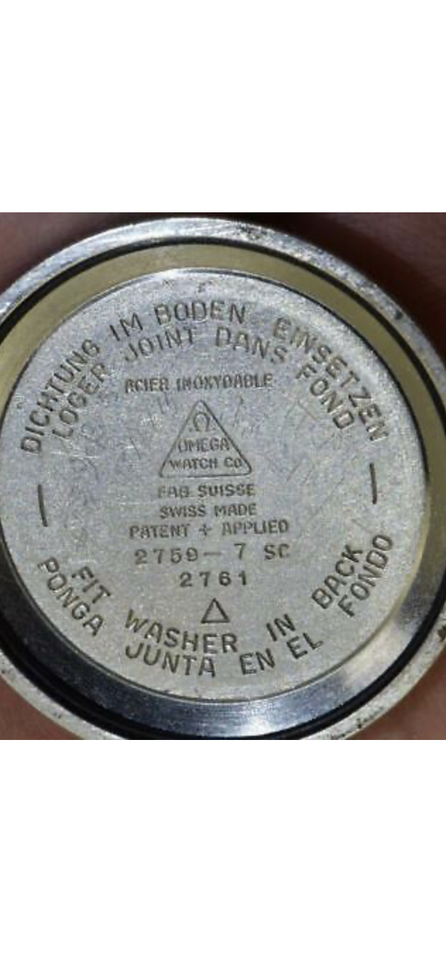

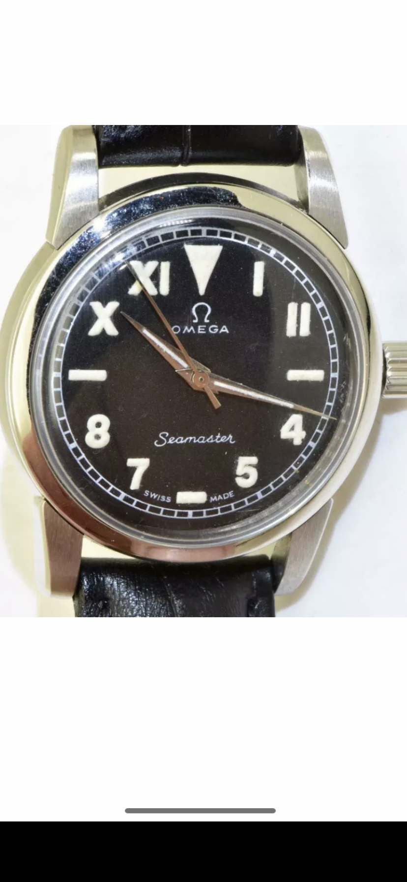

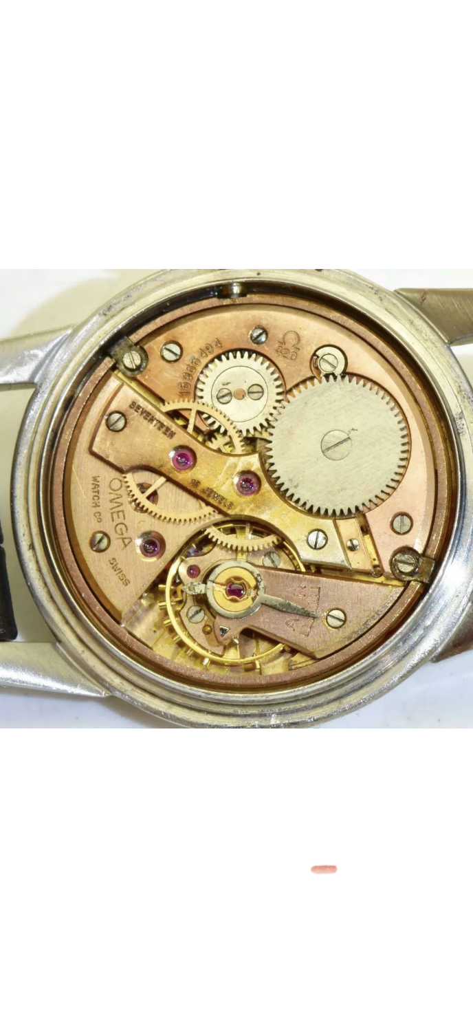

K Posts 1 Likes 0 kanga81 ·Apr 19, 2021 Hi all, if anyone could provide some information on this watch would be greatly appreciated. Ie year history and value. Can I get some help identifying this watch, Edited by a mod: Apr 21, 2021
Posts 18,840 Likes 39,182 JimInOz ·Apr 19, 2021·Melbourne Australia It's an Omega Seamaster reference 2759-7 with a caliber 420 (correct for this watch) dating to about 1957. It has the wrong crown and hands and it has been badly re-dialed. The condition of the case (brushed/polished) does not match the less than attractive condition of the movement.
Posts 2,816 Likes 6,951 seekingseaquest ·Apr 19, 2021 Legitimate Seamaster variant - ref number is inside the caseback - but the dial is a fantasy redial. Crown is incorrect.
Posts 2,815 Likes 3,747 Donn Chambers ·Apr 20, 2021 At the best, it’s a real Omega case/movement with a repainted fantasy dial. At worst, it’s a fake. Can’t really tell without pictures of the movement/caseback, but I would lean toward fake.

Posts 3,668 Likes 24,842 Dsloan ·Apr 20, 2021 There seem to be a few of these fantasy California dials going around. I saw a few Tudors redialed this way on Reddit recently.
