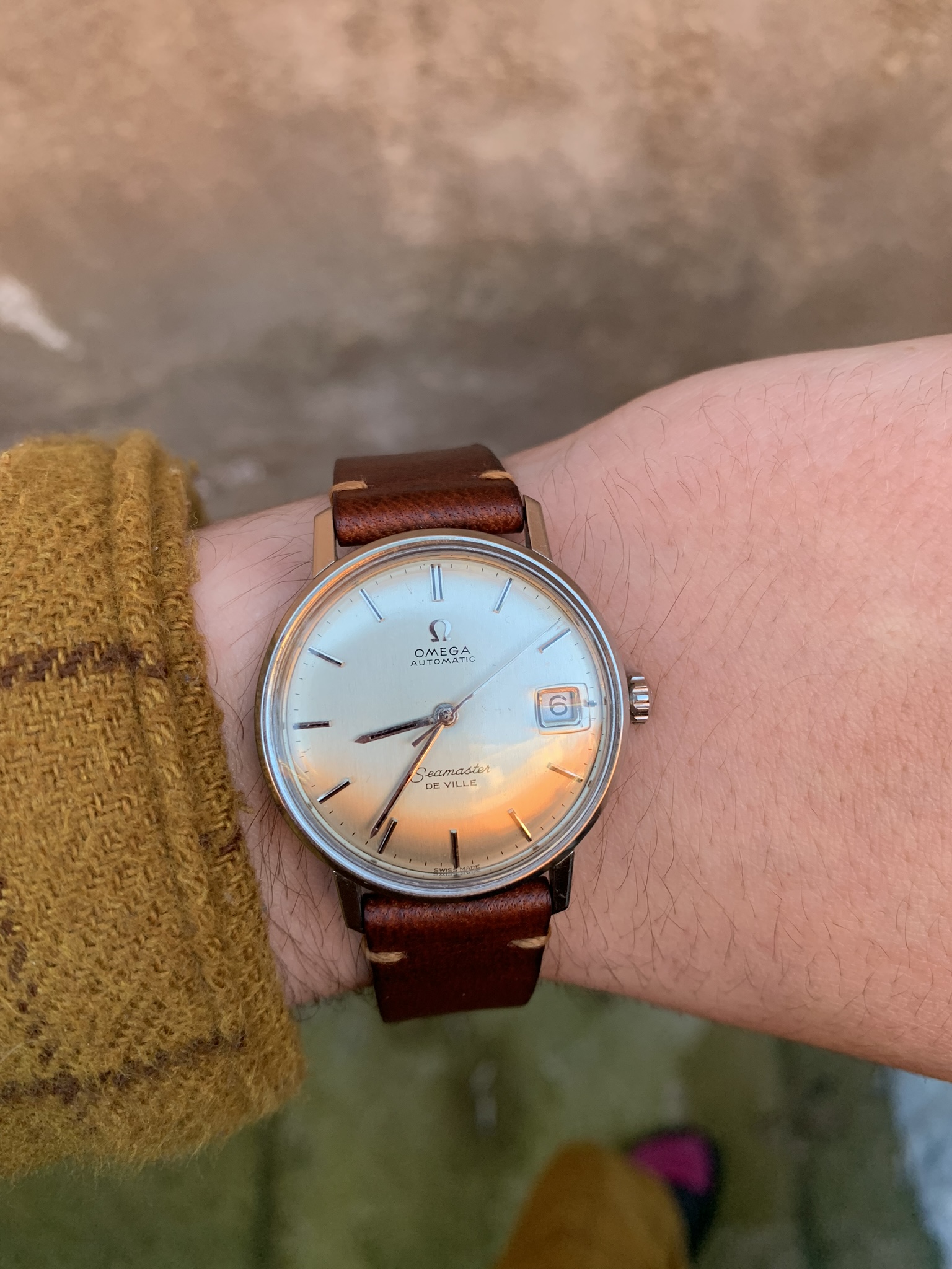

Hey there,
I’ve scoured the forums but don’t feel confident in my findings - can someone help with identifying the model of my seamaster Deville and secondly, if anyone knows anything about the end links it would take that would be great. I do fancy one of those beads of rice bracelets…

You need to remove the case back to find the ref. Number. Then you can search on it for end links.

No caseback on these as they’re a unishell case. Looks like a 166.020. Would take 570 Endlinks.

Very nice looking Deville, congrats.
As said 70/570 end links with a 1503 should be your choice for a BOR.

Thanks for this, I can’t tell you how much I appreciate it.
For my own education, what’s the difference between the bracelets eg 1503 vs 1037? Is it entirely just style and thickness etc?
And maybe this is even more simple, but what is a no12?

1503 and 1037 are the same. Both will with with your watch and 570 EL’s (or 70’s).
No.12 generally relates to the clasp but there are unmarked 1503/1037’s that are simply stamped No.12.

Thank you for your wealth of knowledge, been a great help!
