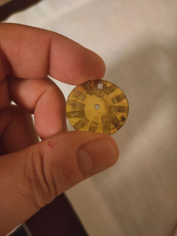

Guys, I think I found one dial on internet!!
See attached the pics they put on the description of the item I found. It has some damage but at least should be original. And it costs 100 euros.. I think it's worth...
Let me know what do we think..

Price seems to be on the low side.
I thought the filing on the back where the furniture rivets are is an indication that the furniture has been removed and replaced. I am not much of an expert though, as I come from the era of repainted dials.
I can not really zoom in on the photographs, but something feels off to me. Black dials are often suspect and need more examination.
Hopefully I am wrong here.
Not necessarily. The small feet on the markers protrude through the dial, and a common way of securing them to the dial when new is to grind them into the back of the dial...

I contacted the guy and I asked if the tritium is still present.. but he said no.. and the new picture I received honestly let me think a lot..... It seems no clear protection paint is present on this dial.. And the color seems a lot darker then before..

The hands and all the parts for this watch are only available for an Omega certified watchmaker or if you send the watch to Omega. They will restore the watch as needed. Please dont touch dials with your bare hands. Please dont buy that dial for 100 euro's, its crap.
