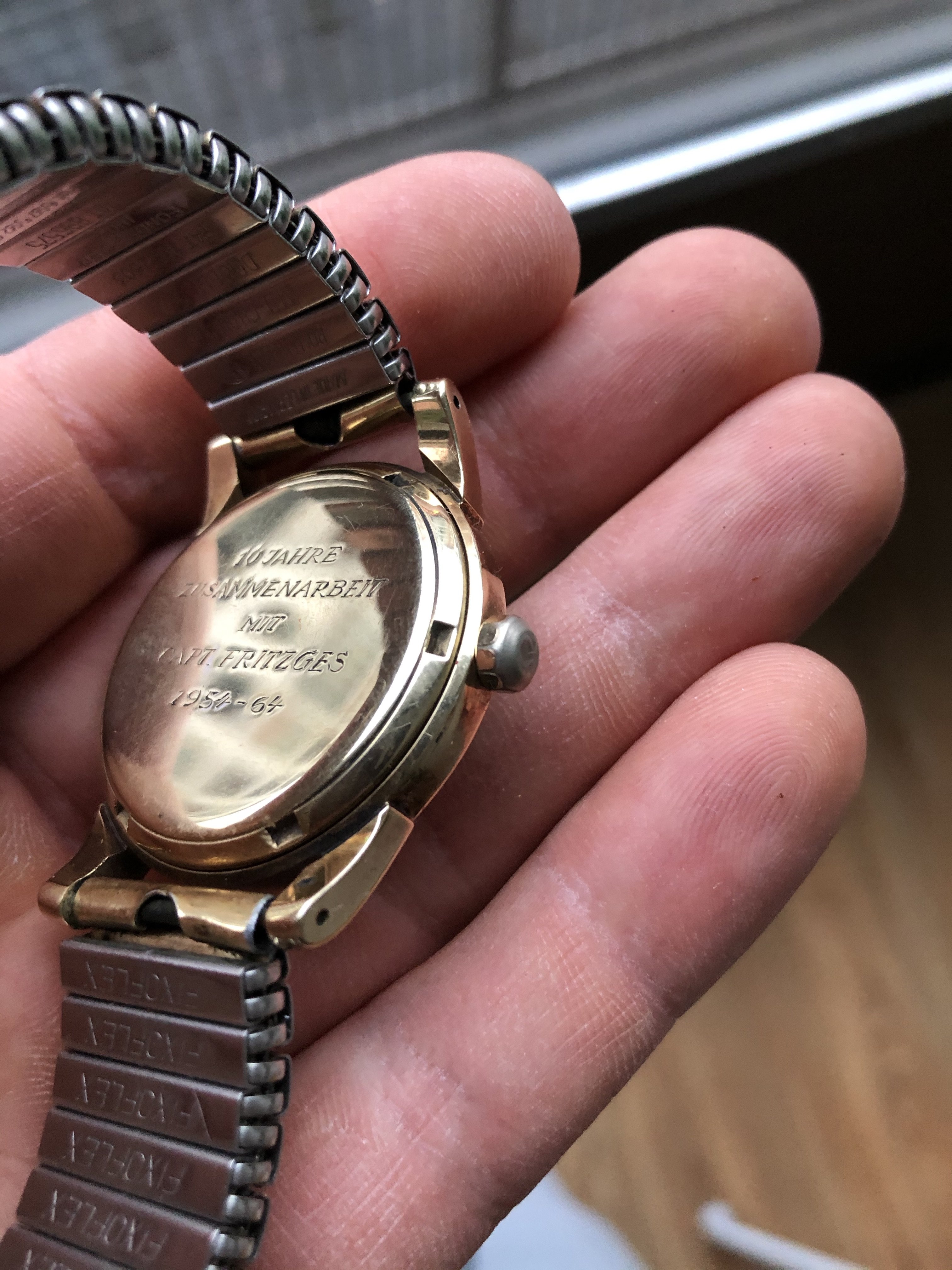

Hello,
I just discovered this old watch on my late grandparents attic and it still works. Sadly it is way too small for my wrist so I am thinking about selling it in order to fund a new seamaster diver. Depending on how much I can get I might also refrain from selling it though.
The glas should be replaced and I don't have the paperwork nor box.
Maybe some of you could help me estimate its worth?
Best regards,
Philipp

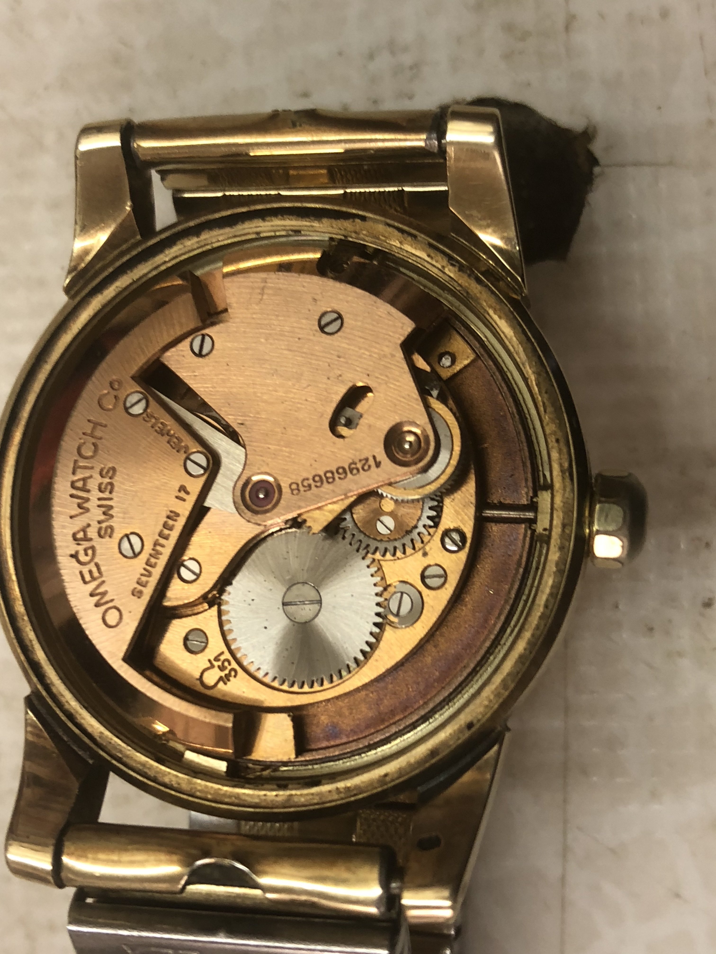

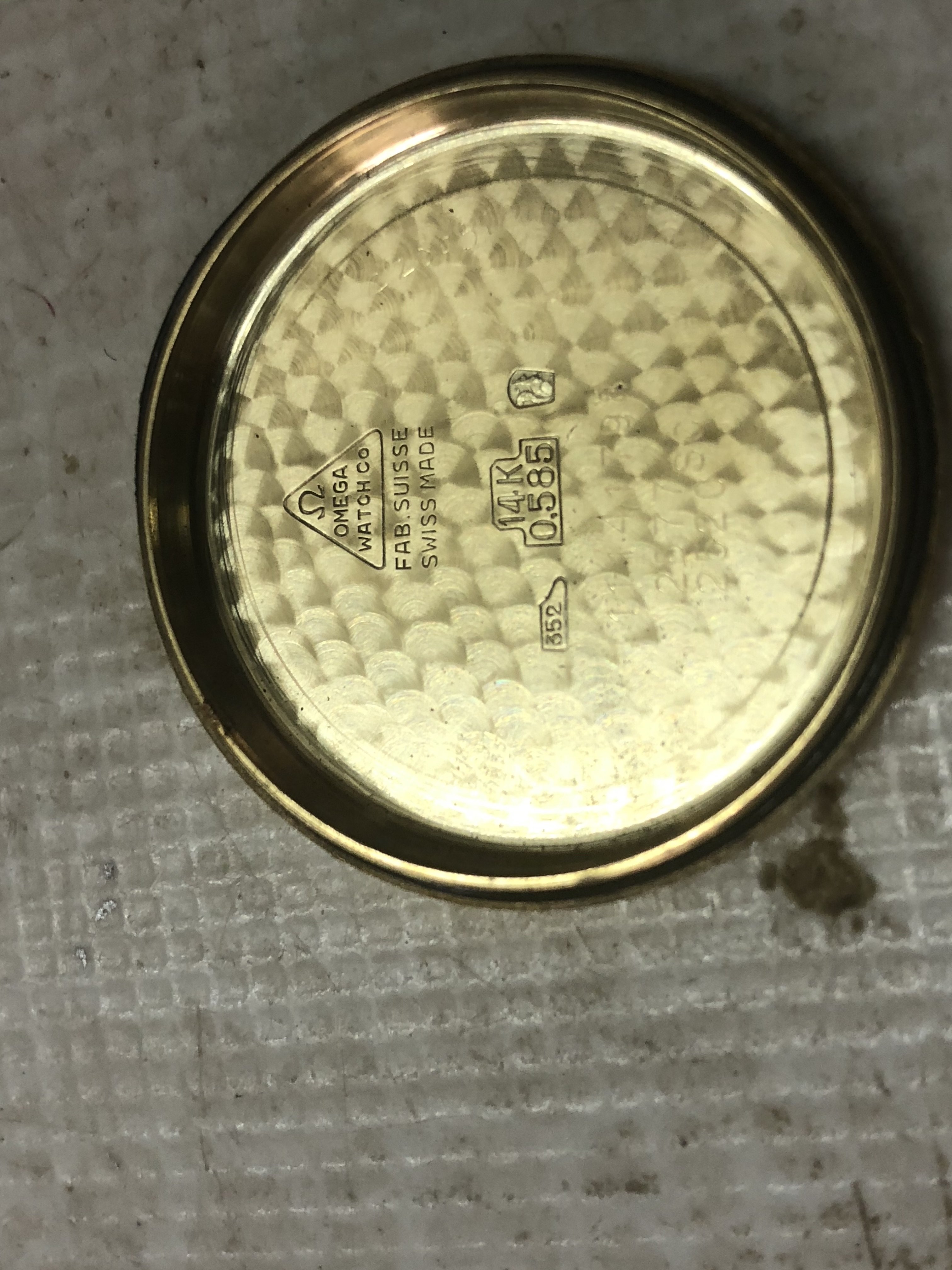

Your watch has double reference numbers 2577 and 2520.
Because it is powered by a non chronometer 351, it should be considered as a 2577.
The value of a watch like that with personalization on back is about $850 usd.

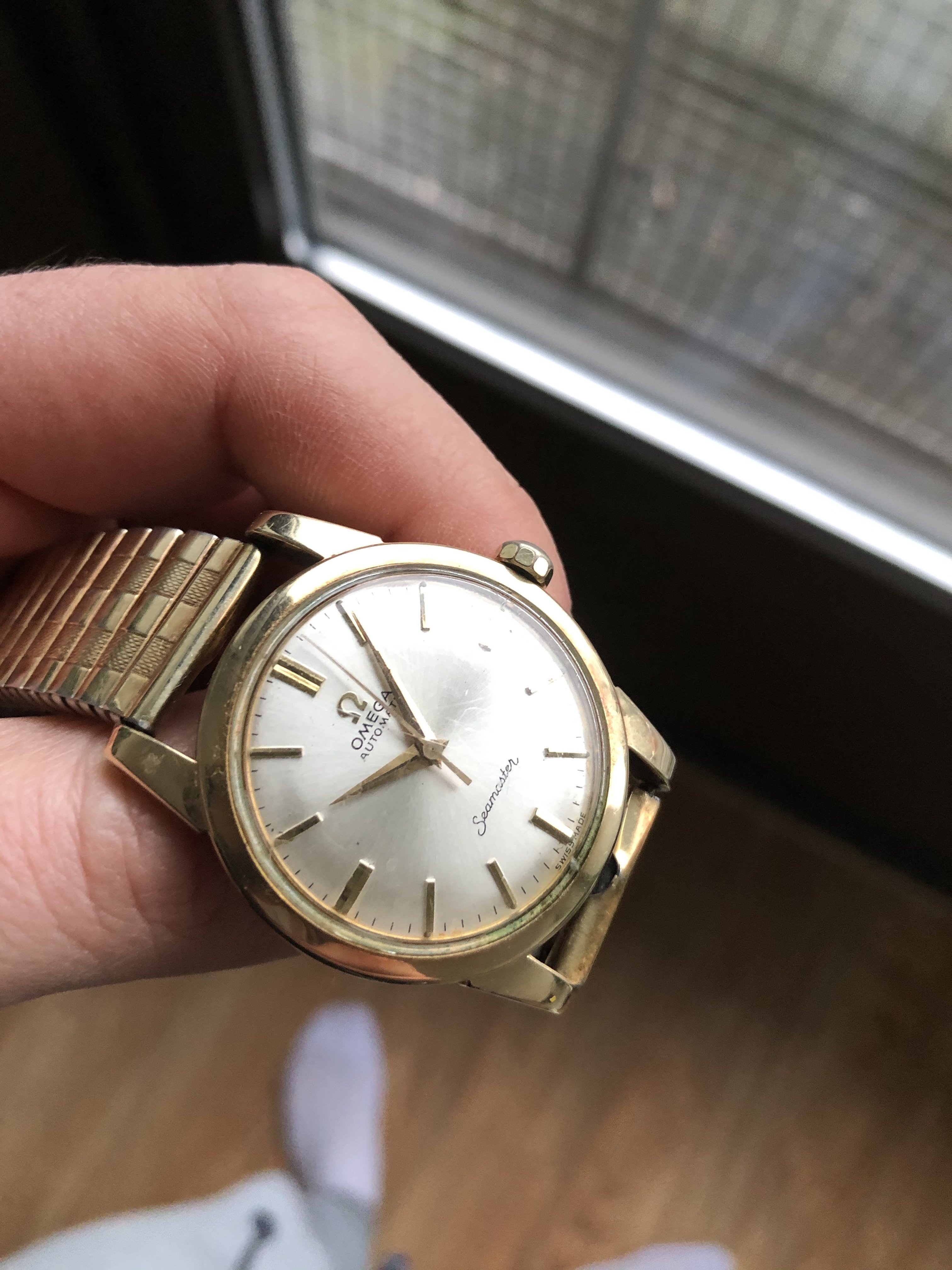

I think it is a service dial (likely from the 1960s). Not correct?

It's not the "Seamaster" font, it's the dial design, which is uncommon for an early 1950s watch, but very typical of watches from the 60s or 70s.
For this reference, I would expect a dial at least similar to this:

Could be. There were a lot of dial variations in the fifties but, I take your point that the dial is similar in layout to a 550 series. Difficult to know for sure but, it surprises me that they used some mid fifties fonts with a sixties layout.

There are lume dots at the markers and the dial doesn't have the "T" signs, so I believe the dial belongs to the early 1960s (up to 1963 production).

1950 serial...
1964 engraving...
Non hanger sea master...
A little odd....

That is exactly what the service dials looked like, as I had inquired into such a thing for a 353-based Seamaster.

My initial impression was/is service dial as well, they just have a certain look. Mainly they have bonded (for lack of a better term) rather than applied indices.
