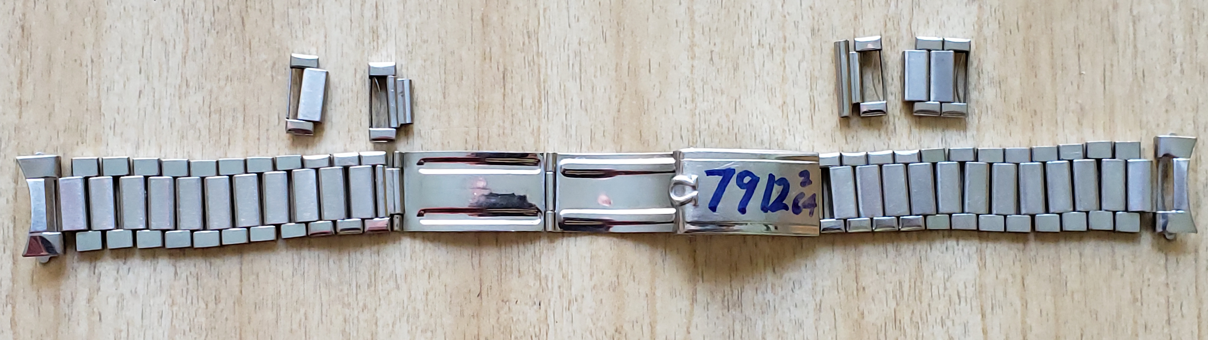

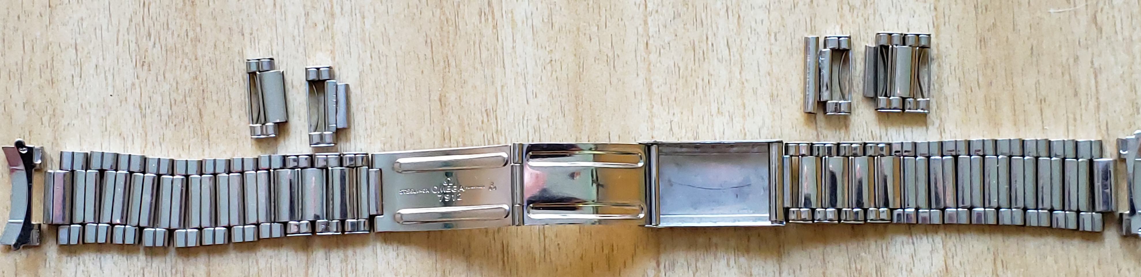

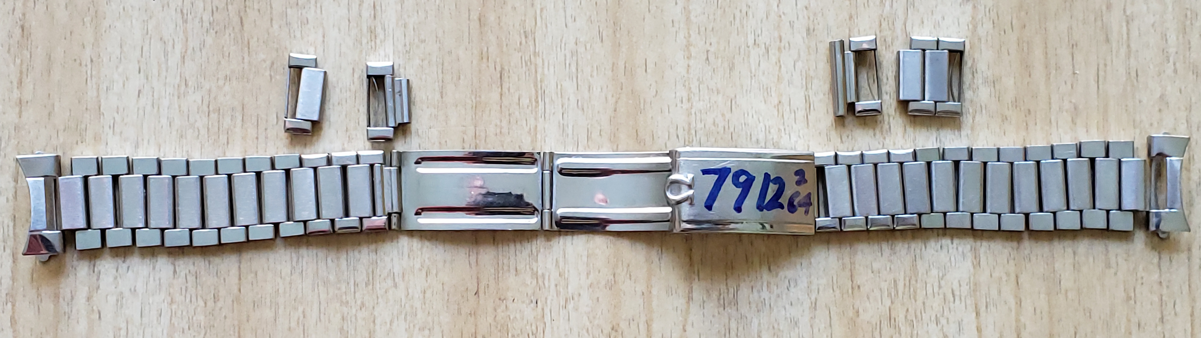

AS Gemini posted it is a 7912 buckle made up of the three pieces shown and marked same. My guess as to value will be $450 or more. Ebay and this forum are good sources for one. Post pics of the inside of your bracelet, both sides. Best to take the spring pin out of the buckle and lay it flat. Your bracelet looks like it also needs the spring links repaired or replaced or some added so it will fit your wrist. Search number 6 end pieces for sale and surprise yourself as to what people have paid for them. Those caught my eye right away. Super cool watch and as has been said, if you sell it, good luck finding another.

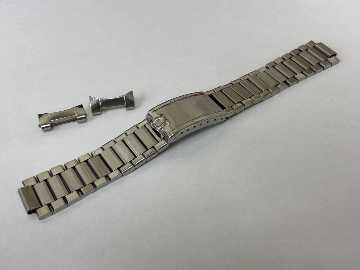

The original bracelet was probably a 7912 circa 1964 ish.
These bracelets, and sometimes only the buckles, pop up on eBay.

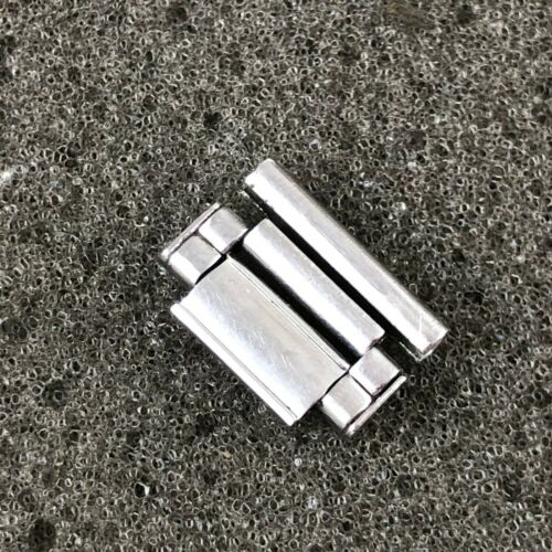

Hi, do you think this i the right part for my bracelet, connecting to the clasp?
OMEGA FLAT LINK FOR BRACELET 1035 1039 7912 1506 1067 SPEEDMASTER SEAMASTER
5,861
16,802

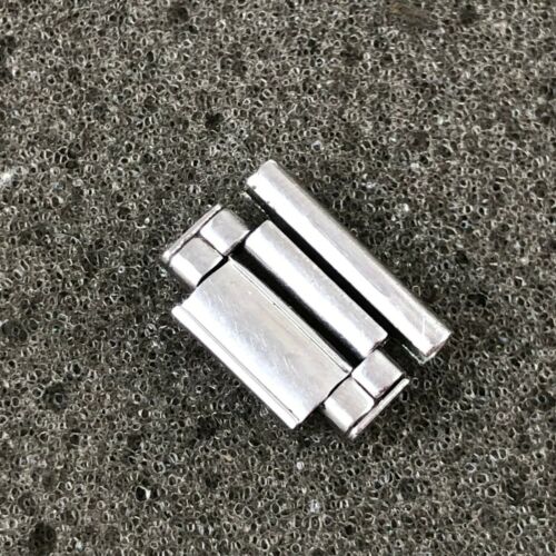

Yes, should work. Be aware, there is a spring inside that should still be working. Ask for pics of the link disassembled.

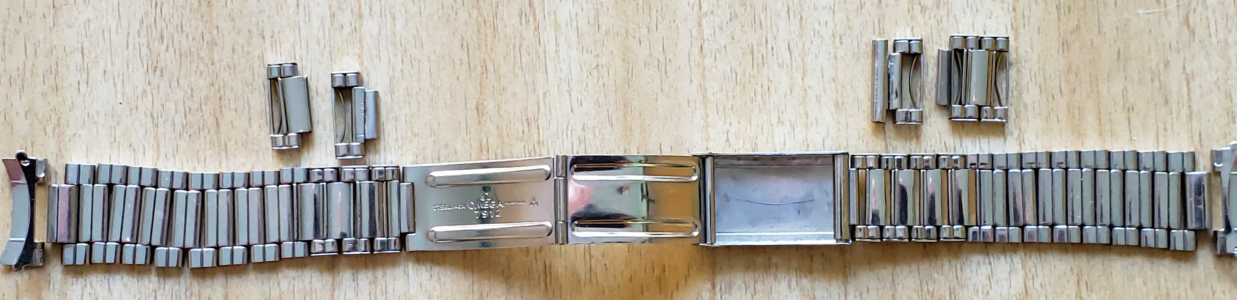

Unless I missed a pic somewhere, can you post a picture of all the sections of the buckle and how they do or don't connect to the bracelet links? Is your inner buckle marked 7912 and does it mate well with the other inner section or has the whole buckle assembly and clasp top been replaced? Gemini4 already posted a good view of the two inner sections of a 7912. Hopefully your current bracelet has 8 non-stretch sections on each side then some stretch link sections bringing them to either side of the buckle.

Looks really nice! I will clean up mine and take some pictures. What is the best way to clean it, hot water and mild soap?
302
1,185
Mix hot ammonia and water 50:50 and soak and brush away with a toothbrush. Works better if you have an ultrasonic cleaner with heater. Often a lot of crud will come out and you should change the solution and do again. A jeweler should do it for a very fair price as well as they usually have ultrasonic cleaning tanks set up all the time and then have a steam cleaner to blast it after. If dirt is really caked inside the links it may not all come out but you should be able to do a lot. Let soak for hours.
