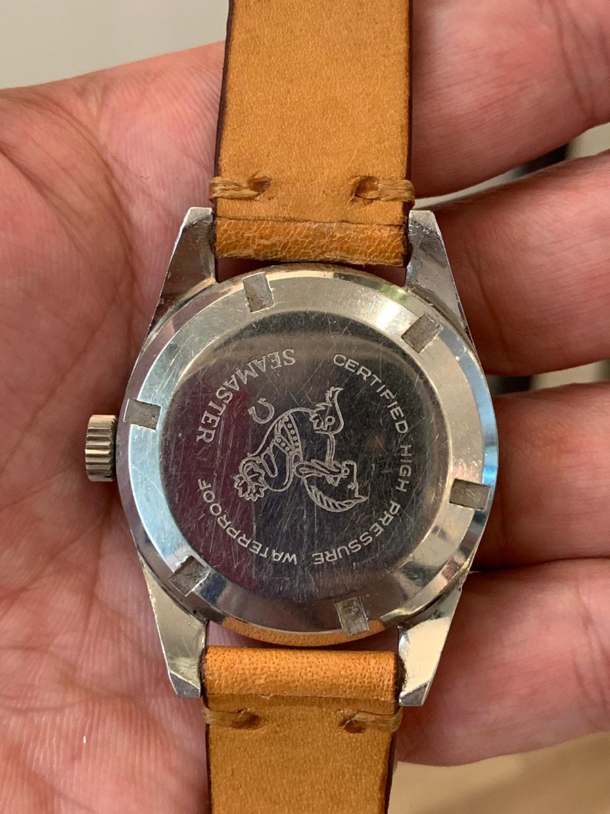

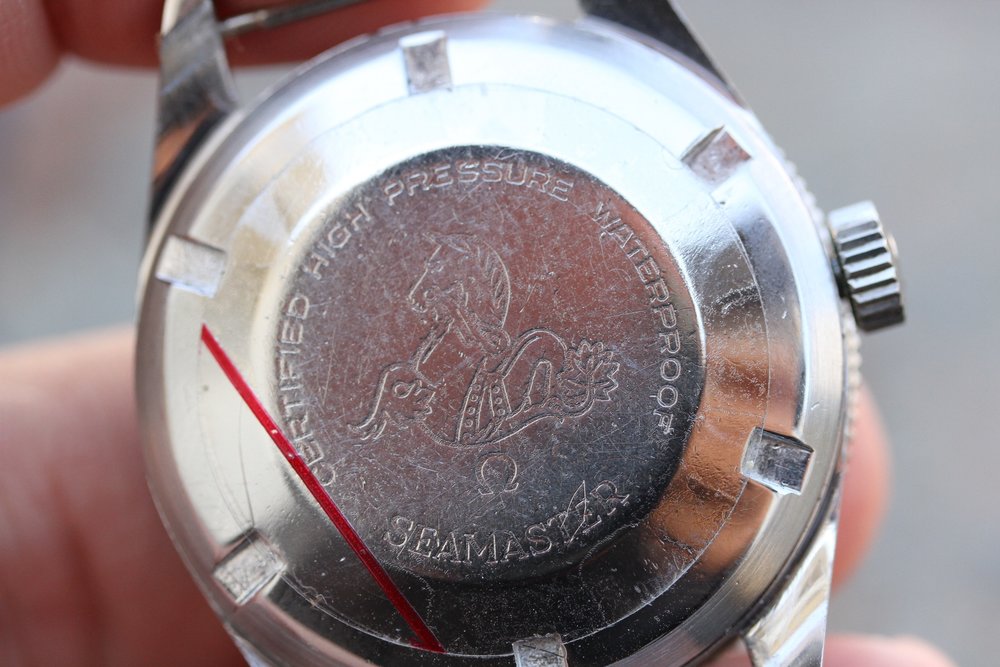

It is a 2913-6. One sold here before.

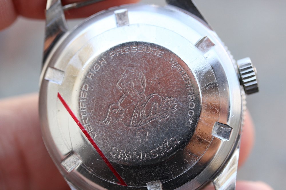

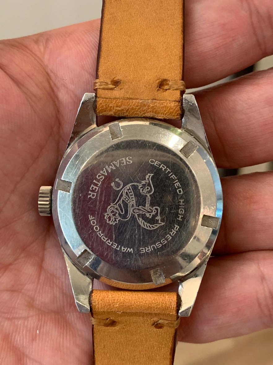

Judging by the caseback, I think the OP watch is probably a 14755.
Out of interest—very eager to learn—how can you tell the (outside) difference between a CK2913-6 and a 14755 @gemini4 and @redpcar? I've had a look at their respective case backs here and here, and they're identical to me. I know the two references use different movements, but I wonder if there are visual cues that I missed.
CK2913-6
14755
CK2913-6
14755
Notice the 2913 case bumps out at the center of the caseback. The 500/501 movement is shaped differently vs the 550/552
One of those "once you see it" experiences. Thanks! I was too much focused on the hippocampus and the inscription to notice 😟

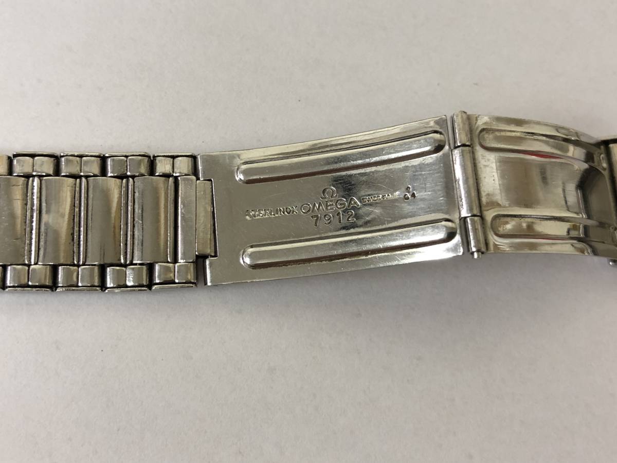

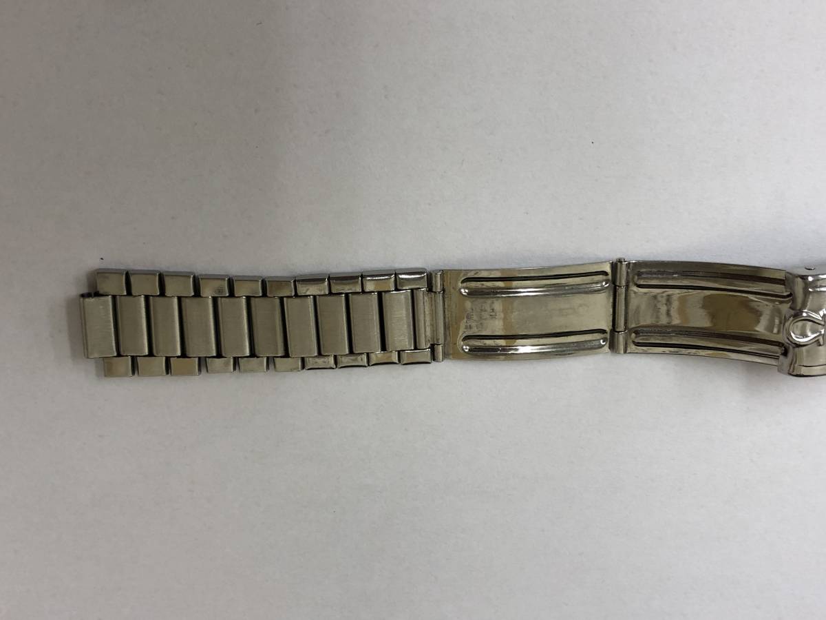

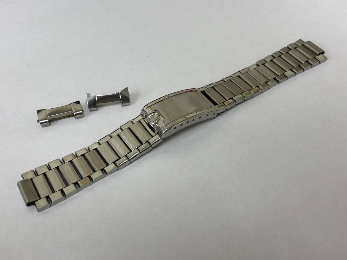

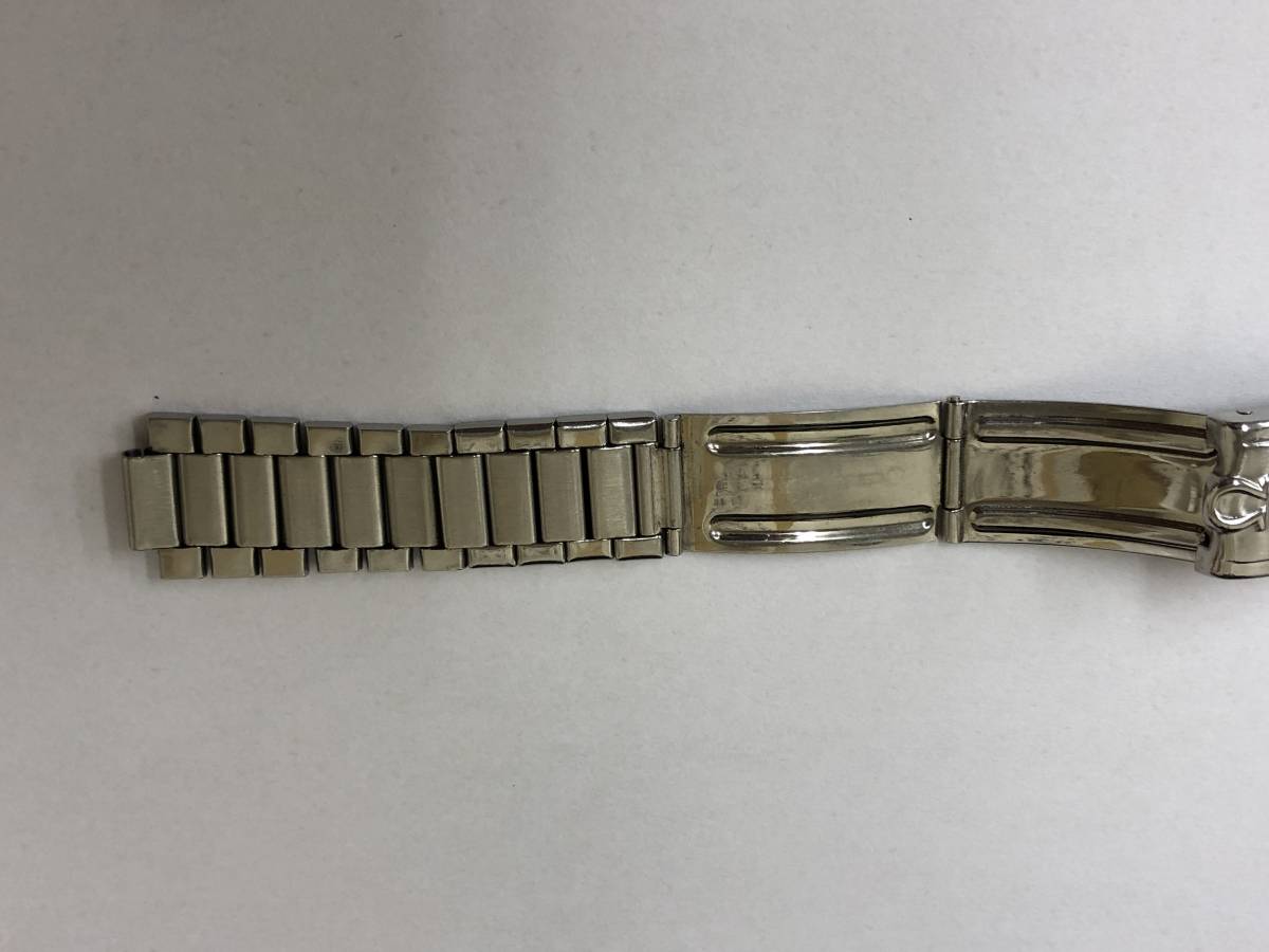

Cool watch. Unless I missed it, I'm surprised nobody has discussed the bracelet. No 6 ends and needing correct buckle et al. Happy New Year!

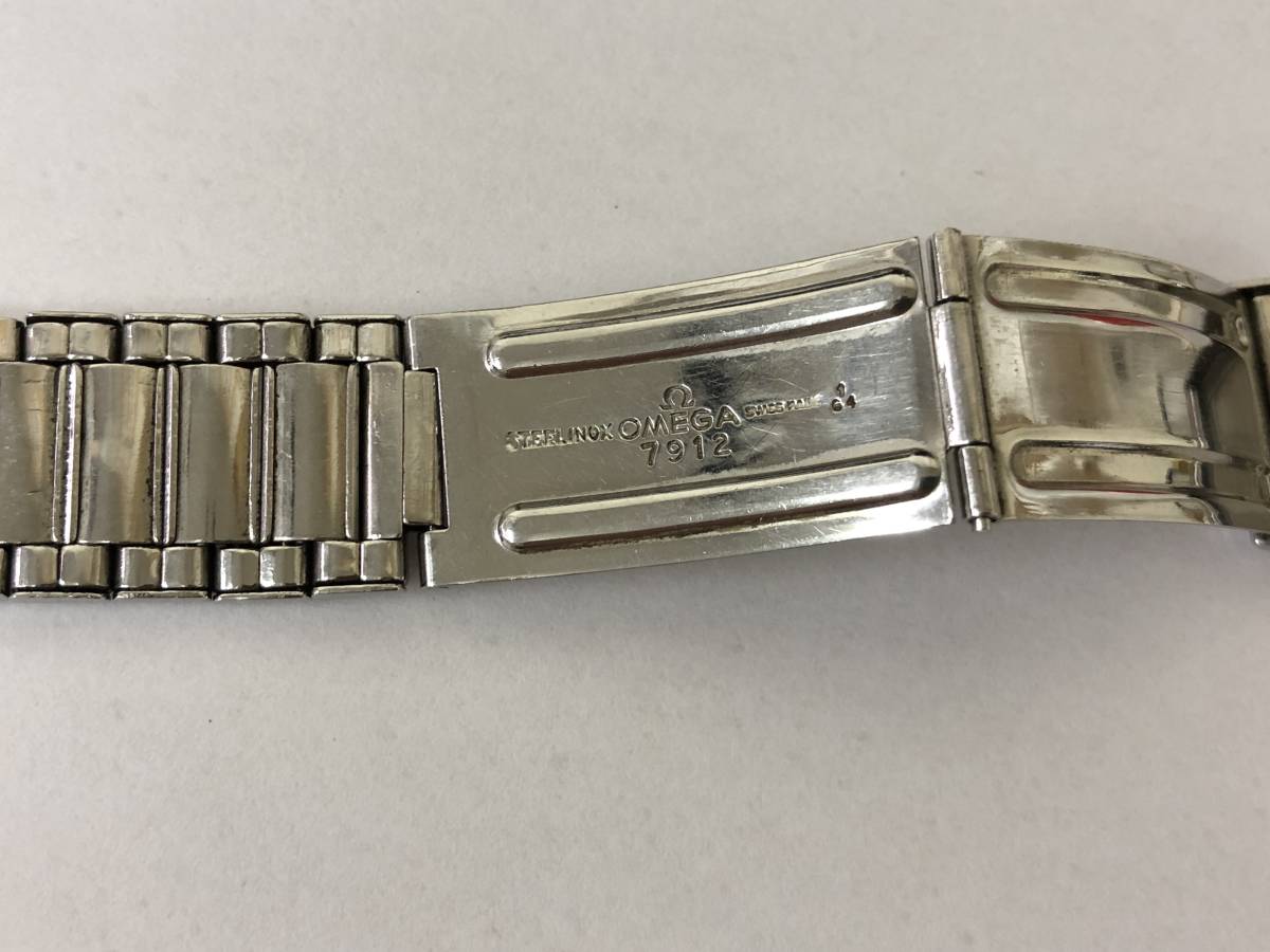

Is it possible to get hold of the right buckle? And what is the ref number on the bracelet
5,861
16,802
The original bracelet was probably a 7912 circa 1964 ish.
These bracelets, and sometimes only the buckles, pop up on eBay.

Any idea what a buckle might go for? Does the buckle have an sep parts number?
