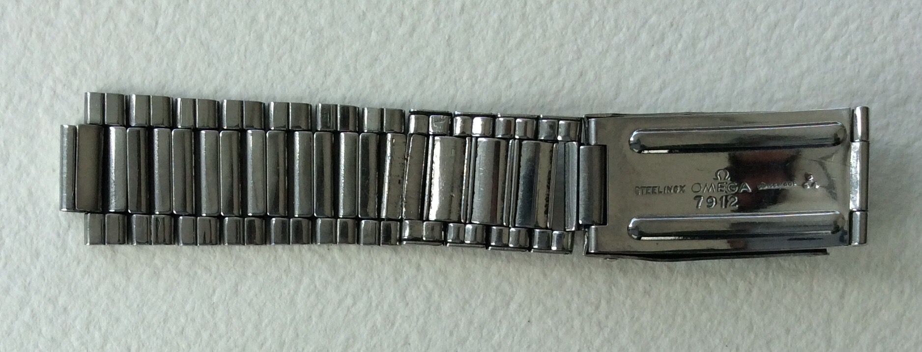

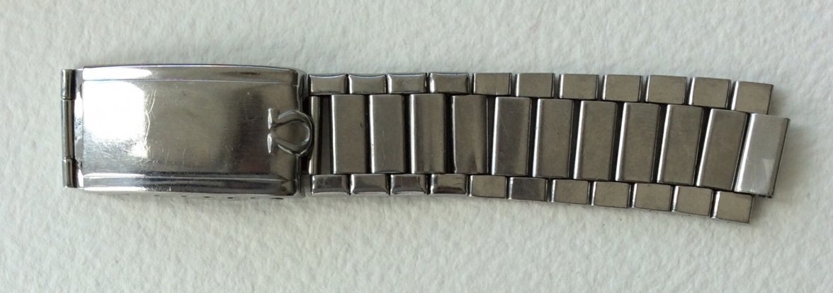

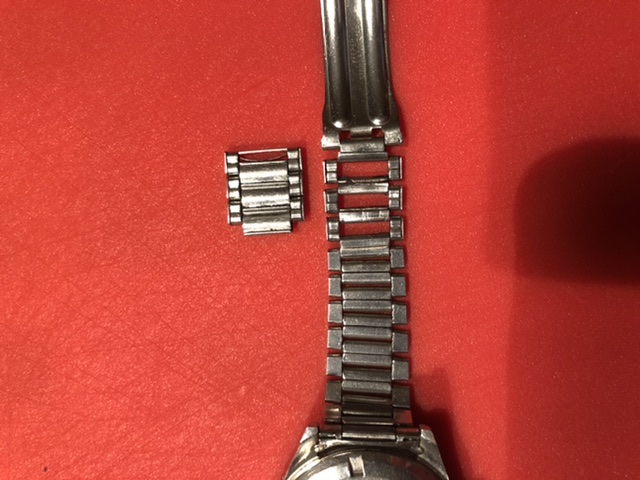

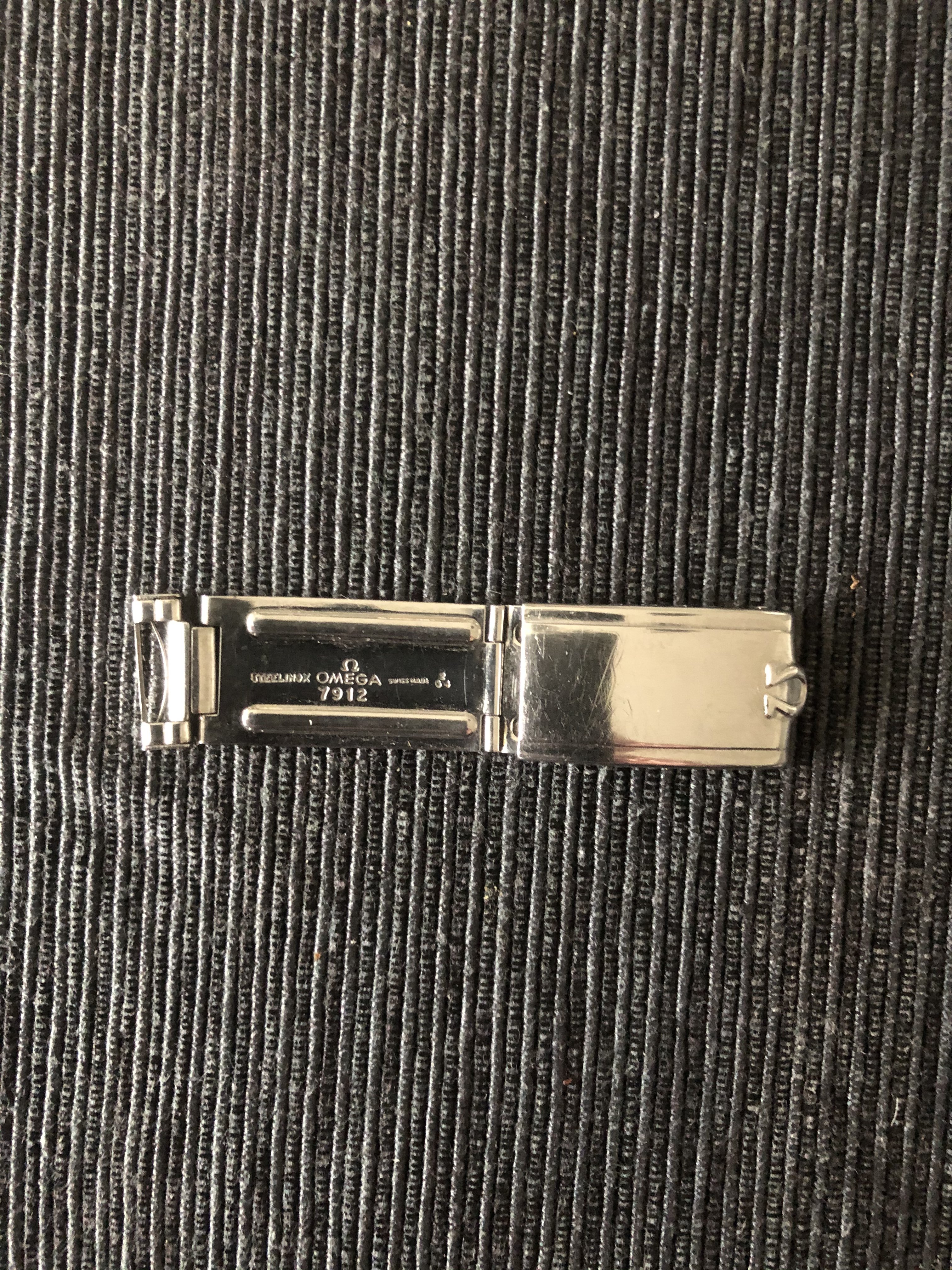

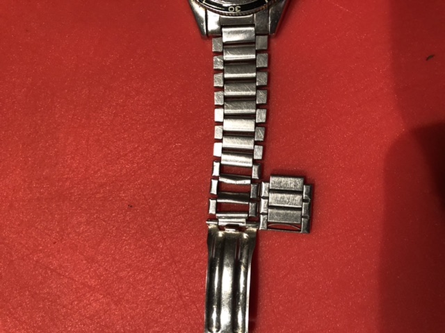

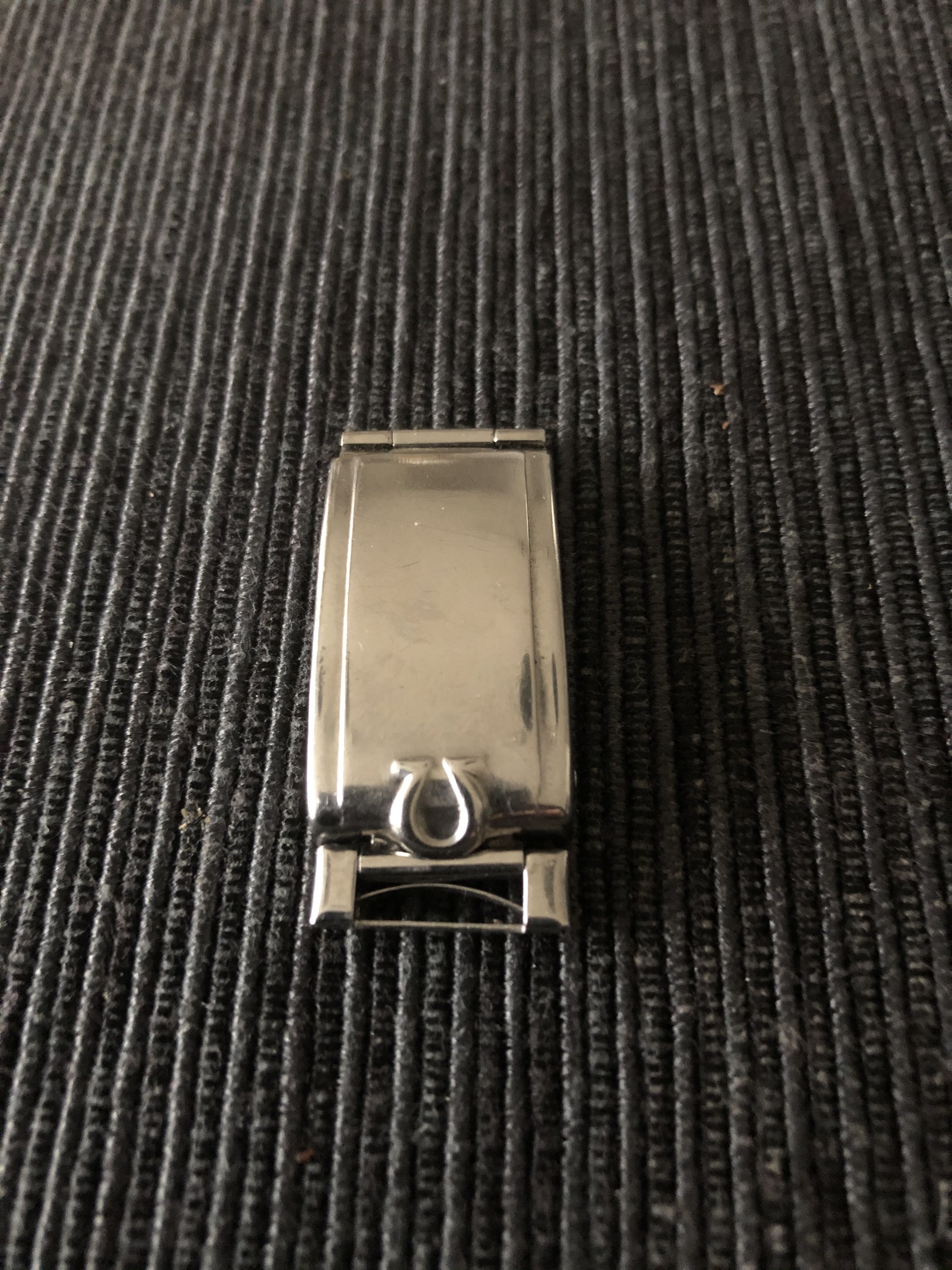

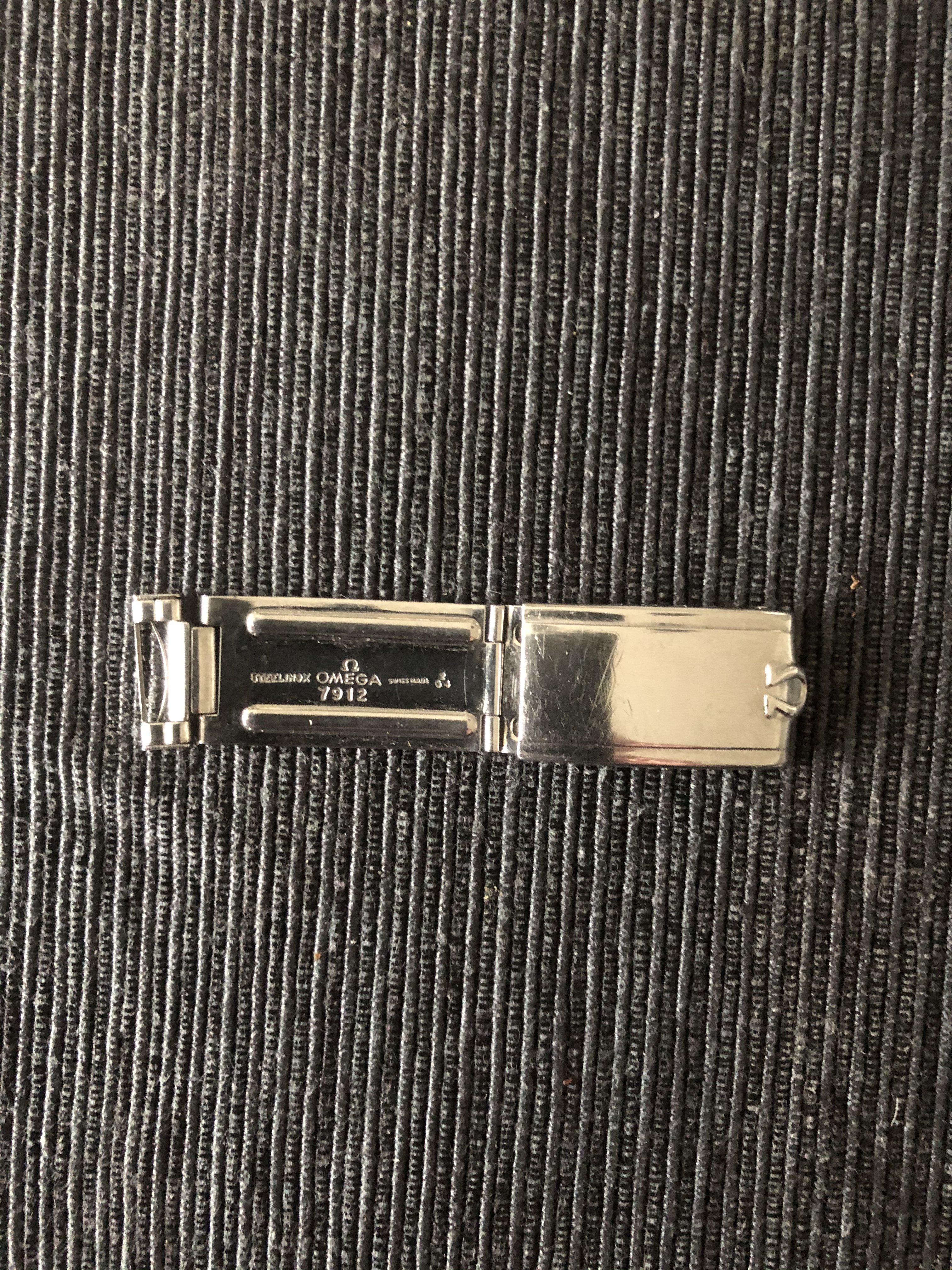

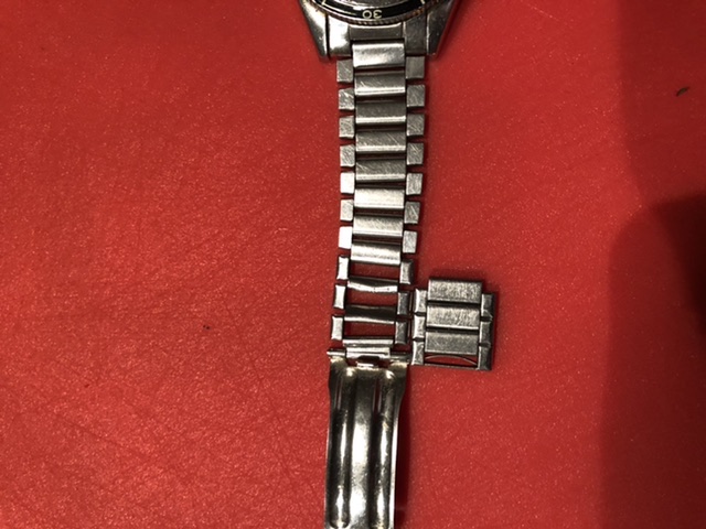

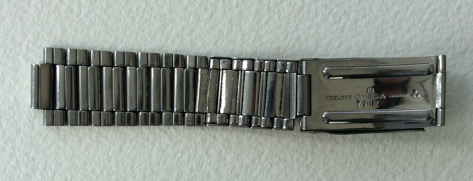

Unless I missed a pic somewhere, can you post a picture of all the sections of the buckle and how they do or don't connect to the bracelet links? Is your inner buckle marked 7912 and does it mate well with the other inner section or has the whole buckle assembly and clasp top been replaced? Gemini4 already posted a good view of the two inner sections of a 7912. Hopefully your current bracelet has 8 non-stretch sections on each side then some stretch link sections bringing them to either side of the buckle.

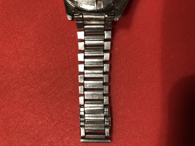

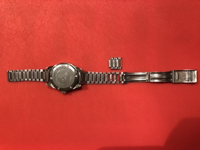

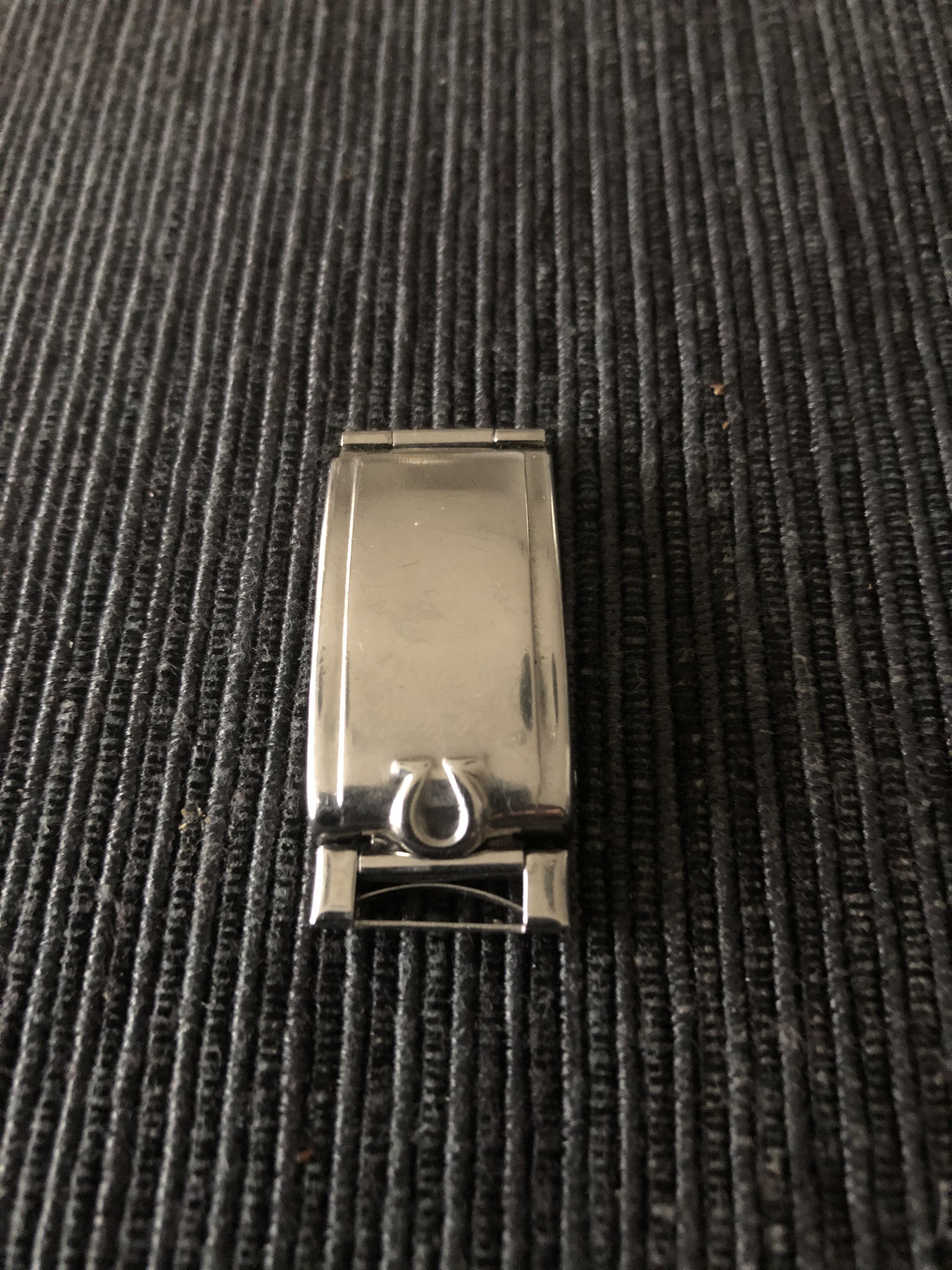

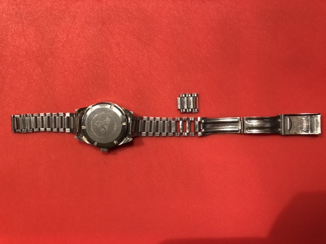

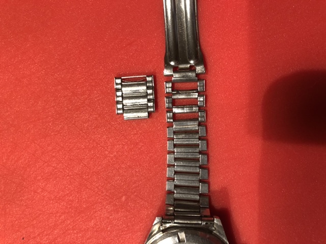

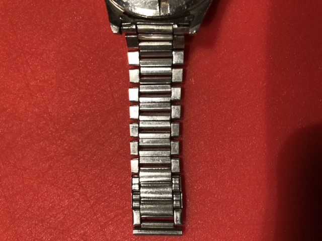

Ok here are some pictures from my bracelet. From my point of view i need the other endlink ( not the one above) and the complete 7912 clasp, together with the extra stretchlinks.
302
1,185
Ahh, You will need a 7912 buckle complete. They come up on ebay occasionally. I have a bunch of 1039s but no extra 7912s. I see you realize you need stretch links as someone crunched the U-shaped sections on yours to connect the links. I don't think you need that jumper link you posted earlier. You will have to drive the pin out of the incorrect buckle assembly and fix the spring link/inner buckle end that you have. Your bracelet is worn and may need more repair than that but it should work. You could replace the bracelet with another one and use your valuable number 6 end links but it is nice to just fix what you have since it has been together all these years. Happy restoring.

The right buckle/clasp arrived today! A 7912 / 64-2 is the perfect match
302
1,185
Nice buckle. good that it came with the stretch link for easy connect. Not that driving the pin is that difficult if it were needed.
