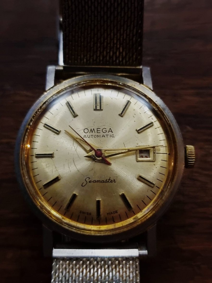

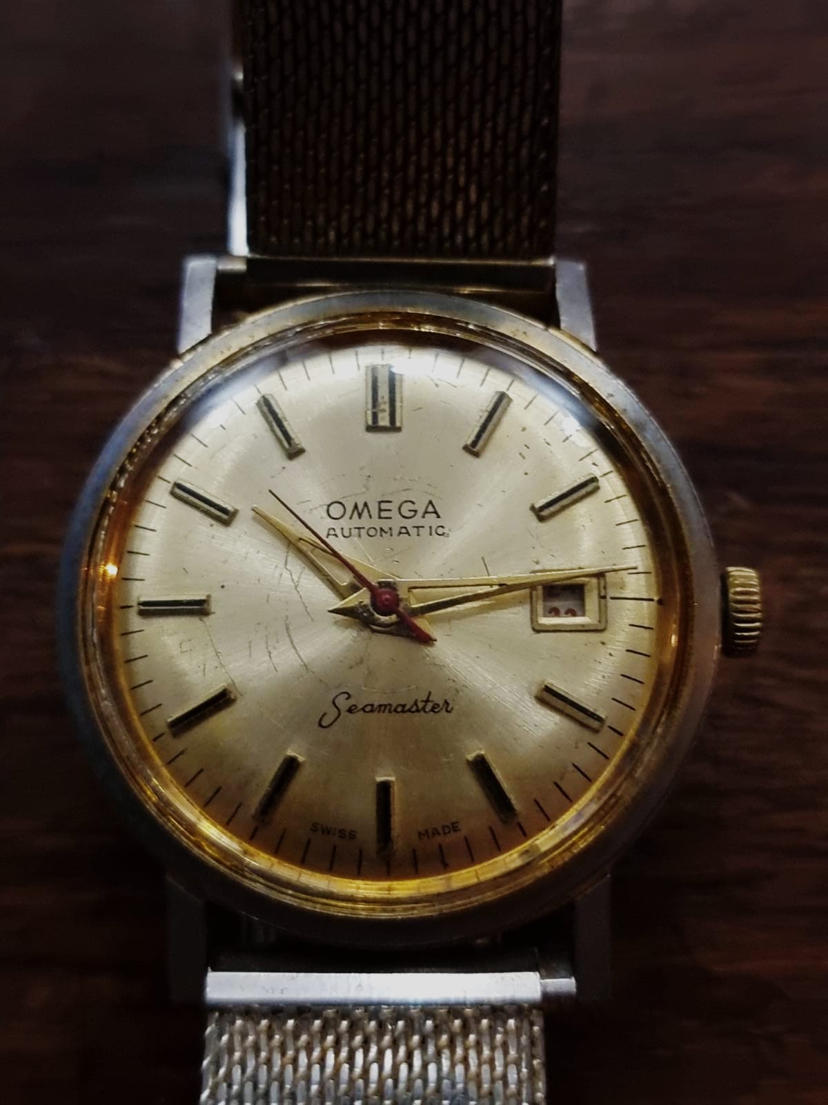

Hi All,
Can anyone tell me what my watch might be worth, I have no idea, any help appreciated.
Thanks in advance.

Sorry to be the bearer of bad news,
Don’t know if it’s fake but it’s horribly damaged.
The dial is refinished, the case is gold plated with the plating completely worn, the hands appear to be incorrect replacements— its only worth the value of the movement inside if it is indeed Omega.
I’d say it can’t be worth more than 100 dollars?
(And even that I’m not sure)

How is it decided if a watch is real, or a fake? People who don’t know if it’s is fake, or real, look for similarities based of visual cues they believe are real. Many of us look for differences! This is a fake, you can be certain. As to what it might be worth? Sentimental only, or if not sentimental, it is worth nothing to an Omega collector. To anyone else? Put it on eBay with no reserve, and if it passes the sniff test with eBay viewers, it is worth what you can get.....to somebody.

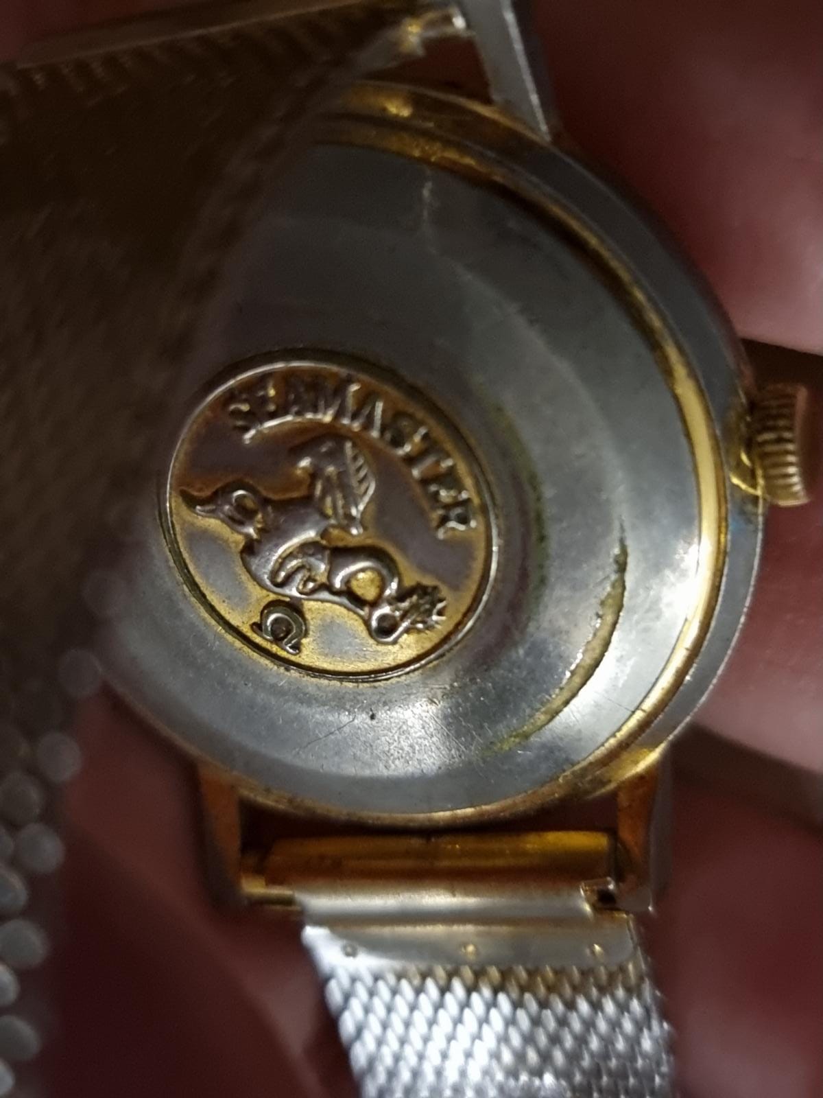

Sorry to tell you that it's worth nothing.
How do you know
Because it's supposed to be a stainless steel case, this obviously isn't due to the chrome wearing through and exposing the base metal shell.
Because the Hippocampus logo looks like it was made from melted butter.
Because the style of hands was never used by Omega on Seamasters.
Because the "Seamaster" script on the dial is in the wrong font.
When you've spent years viewing and collecting Omegas, you can usually tell at first glance.

Font looks the same ro me
6
Font looks the same to me
Also the hands could of been replaced by my dad, this is a very old watch, how long have they been making fake omega with automatic movement.

I'm sorry, but the dial and case are clearly no good. If you take the time to study thousands of dials, then you will immediately recognize when the font is wrong.
We have seen many of these fakes in the past, and they always have a generic movement. If you think that the watch might have a legitimate Omega movement, then have the case opened and post photos.
Similar, but not the same as a "coat hanger" Seamaster, which it's trying to imitate.
Also the hands could of been replaced by my dad, .......
That's quite possible.
.......... how long have they been making fake omega with automatic movement.
Ever since Omega produced real ones, mainly faked in the 1950s and 1960s.

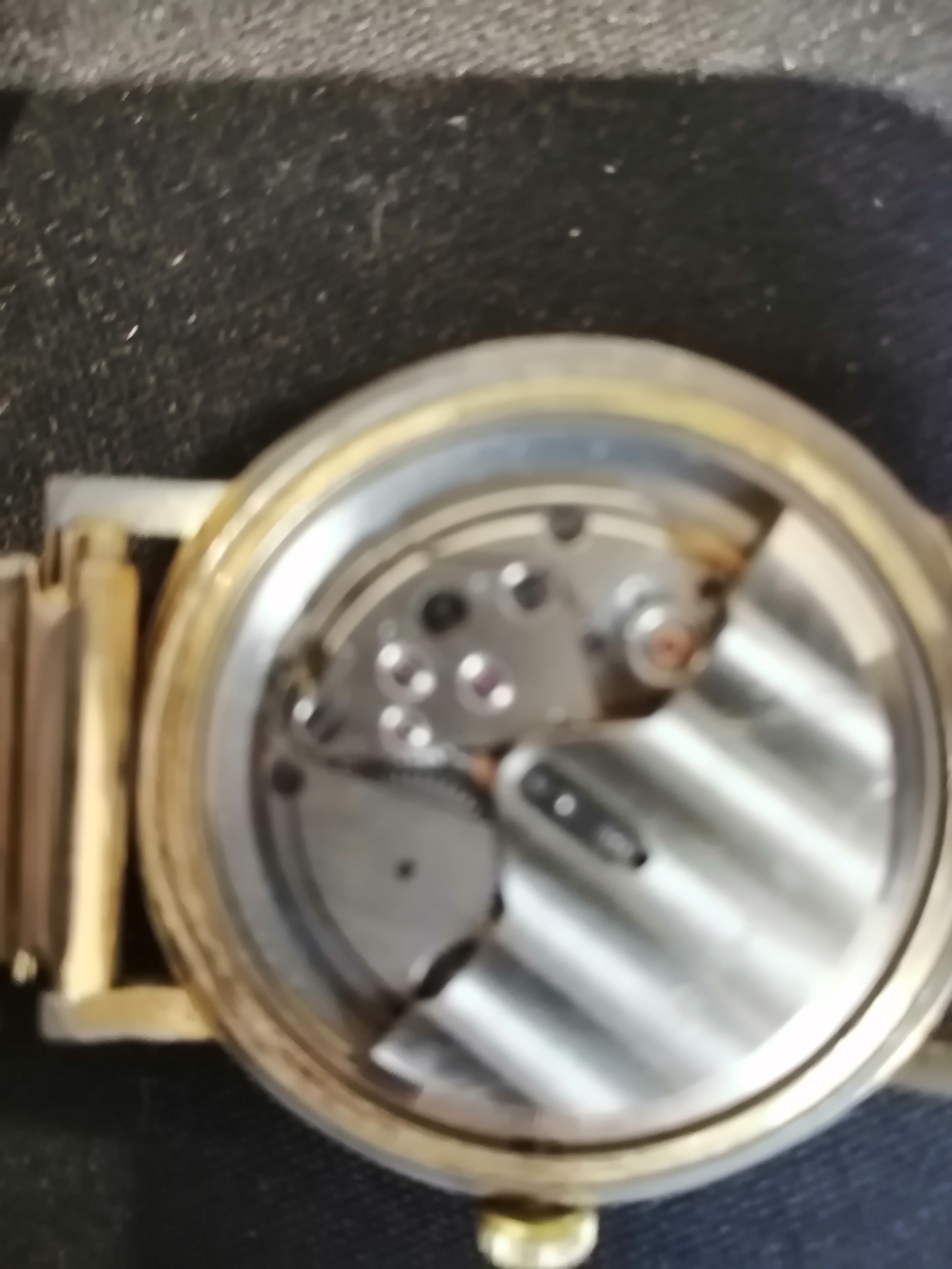

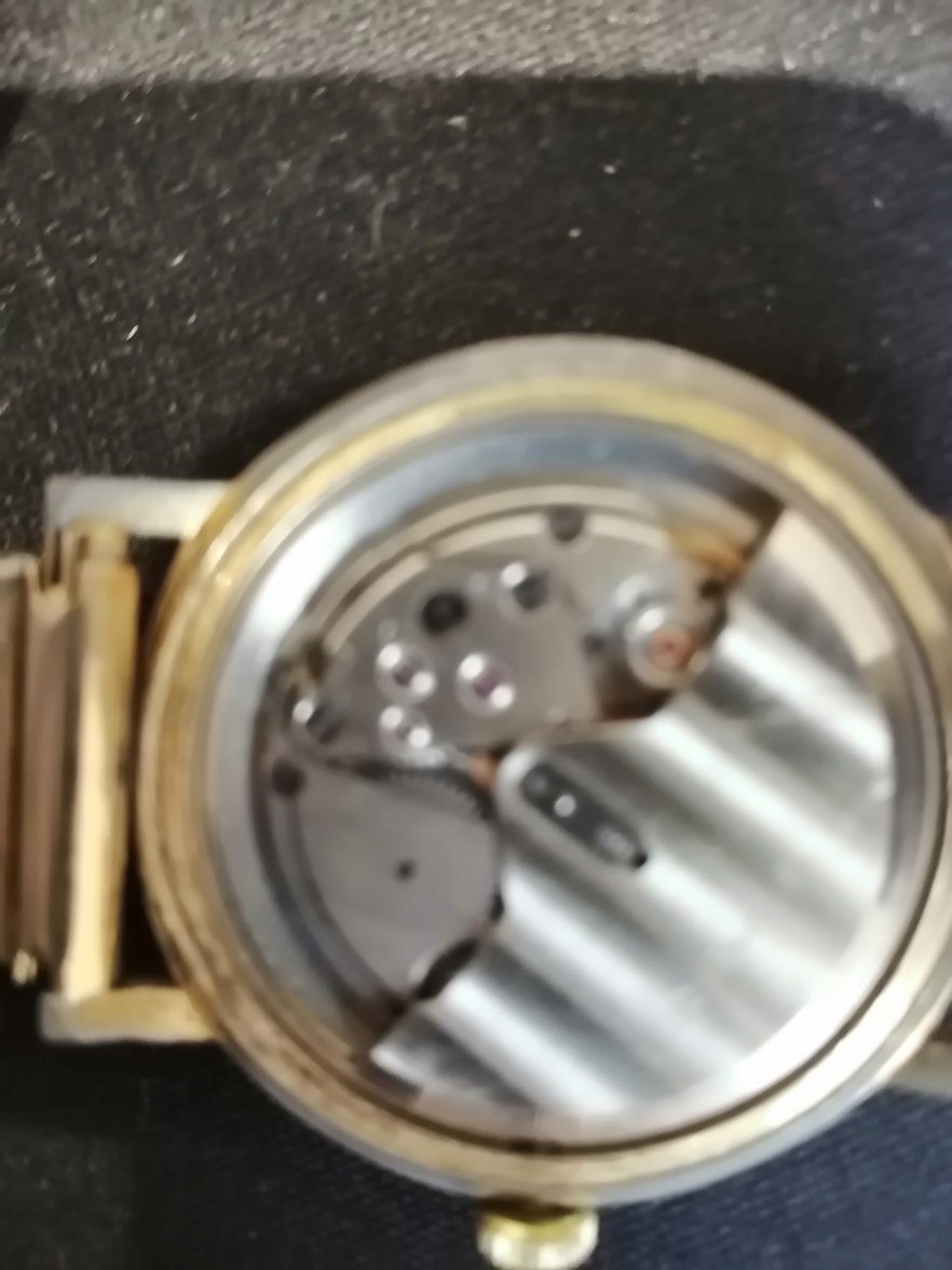

An in-focus photo would be better, but it has the look of a cheap pin-lever movement. Unfortunately, this confirms that the watch is a complete fake. As noted above, these have been quite common for a long time.

I’m honored by the vote of confidence-
in any event now with the movement shot it’s obvious even to me that the watch is not a real Omega.
